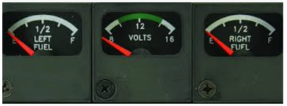

A lot of talk about fuel flow calculation not being exactly correct... Remember older Cessna float-style fuel gauges in the wing-root where you basically have no idea how much fuel you actually have onboard? Or, electric analog gauges in Pipers that were worthless?
EMS fuel gauge has hysteresis built-in to accurately depict fuel quantity remaining even when fuel is sloshing around in the tank. My RV-12 has four methods to determine fuel quantity. I can stick the tank, sight gage on side of tank, Mueller float gage on top of tank which can be seen in-flight, and very accurate EMS fuel gage. If I ever run out of fuel, someone should shoot me…
