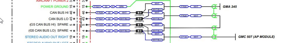

So the latest RV-12iS/Garmin wiring diagram from Vans has a couple extra CAN bus pins going to the MFD screen's connector that are labeled "G5". The engineers parked the pins on the MFD in positions that aren't used for the G3X.. So they're there to easily extend the CAN bus to a G5. Along with that, the EFIS power circuit (7.5A) is using about 3A in real life, so the extra 250mA for a G5 isn't a big deal...

Need to be a little careful, it isn't really possible to "park" the G5 can bus interface. The end of the can bus must be terminated with a 120 ohm resistor or the can bus wont work correctly. On a GDU that is done internally by grounding a pin. On the G5 it requires a termination plug (supplied in the G5 install kit).

I noticed the extra pins were only in the IFR avionics package diagram. Thought it was in the VFR ones too.
