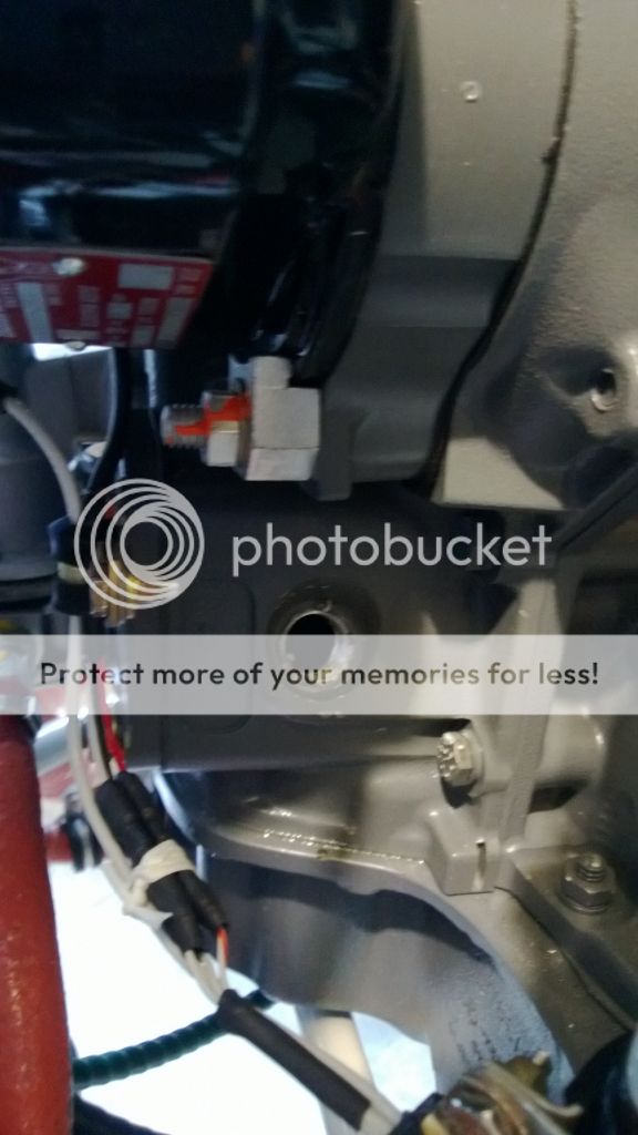

Hi there,
Does anyone know if the hydraulic pump drive pad on the back of the accessory case is accessible when installed in the -10? I can't find a great picture, but it appears that it may be blocked by part of the engine mount.

IIRC there's nothing blocking it, but I'd have to go out to the hangar to be sure. For those following along at home, the hydraulic pad is below the right mag and to the right of the fuel pump (when viewing the engine from the cockpit).

Ahh, so not the vacuum pad.
Yes, it's accessible. Here I removed the cap on the side of the pad for a Air/Oil return line, but the pad face is accessible when mounted.

Thanks a bunch for the information and pictures. It looks like it would be possible to mount something down there.
No rush, but if its convenient it would be interesting to know how many inches of distance are available before hitting the firewall.

David,
I just took some measurements. On my install (I have a C4B5) the hydro pad is mostly over the firewall recess, but it is close to the bottom and right hand edges of the recess (as viewed form the cockpit). As such it's 9-3/16" from the back of the recess to the face of the cover plate on the pad. The distance to the the firewall proper is 7-1/8". I also have the FS-1 on my vacuum pad and your comment about potentially mounting someting like it on the hydro pad prompted me to also measure the distance between studs and they aren't the same. The vacuum pad studs are 1-3/4" apart while the studs on the hydro pad are 2" apart.

David,
To actually use the hydraulic pad you need the drive assembly which has the gear and housing - similar to the vacuum pad. That drive assembly makes the actual mounting surface about 2" further aft.
Years ago I looked at putting a B&C SD-20 there but there wasn't room after factoring in the drive assembly. That was in the early days of RV-10s before B&C came out with the SD-20 spacer and new shear coupling to allow their angled oil filter adapter (with required spacer) to co-exist.
