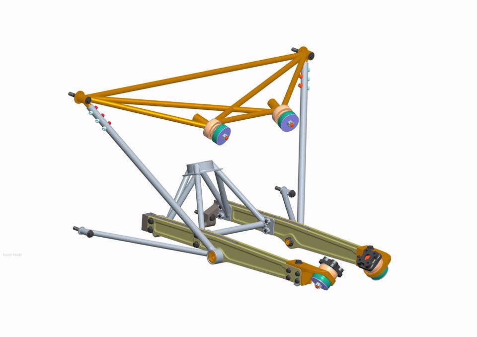

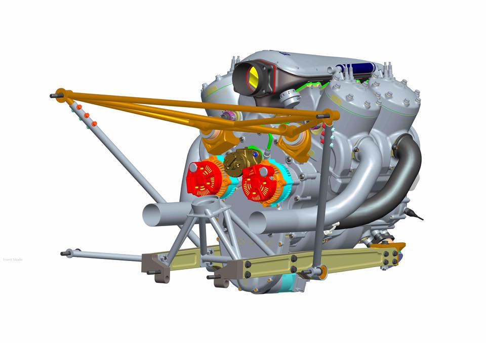

The newly launched Higgs Diesel E330 Hawk by AC Aero is a clean sheet, multi-fuel, spark ignited piston engine. While it is primarily meant to burn Jet A, a variety of fuels may be used with minimal performance degradation and no hardware/software changes required. The V4 design uses a modular architecture which is shown in the development of the larger E1000 V12 Condor design. A V8 version is also planned. The E330 Hawk will produce ~350 horsepower normally aspirated or ~500 HP turbocharged. It uses a unique stepped piston design and interconnected cylinders to help compress the intake air and scavenge exhaust gases. The two stroke cycle is designed to burn cleaner and more efficiently than other traditional diesel engines. This allows for lower parts count, simpler drive systems, and reduces vibrations. The crankcase encompasses the geared prop drive, accessory drive outputs, and uses a traditional pressurized lubrication system. The engine is liquid cooled using a closed loop coolant system as well as an oil cooler. It will be ~350 pounds including cooling system and accessories. Based on scaled test power plants, the Hawk will produce 275 HP at 80% power burning 8.5-9 gallons per hour. Andy is using a custom mapped ECU and closed loop systems to have a power control lever along with a prop control, eliminating any fuel mixture input from the pilot. He anticipates running a three bladed MT propeller on the non-turbo and a five bladed MT-5 on the turbo versions.
