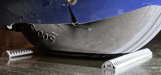

Update on Free VAF 3D Printed Wheel Chock.😜
Enjoying playing around w/this. Test printed the prototype and got a couple pics under the wheel pant of my RV-6 to see how it fits. Pushed and tugged. I intend for it to be smaller than the ‘usual’ chock…a complete 6-piece set should easily fit in your back pocket. The tailwheel chock is the same design, only not as wide. I plan on modding it a bit, but when I’m happy I’ll get them uploaded so you can download for free if interested.
Current print done with .4 nozzle. Using .2 next.
Fun times for sure!
More when I have it - having fun playing and learning as I go,
