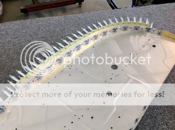

I made mine 25.5" just like it shows in Fig. 2. I then installed it with the hinge pin loop on the left end next to the nutplate just like it shows in Fig. 3.
From your picture it looks like the left end next to the nutplate doesn't have a hinge pin loop on it?
Also, I'm having a hard time finding reference to a 26" length that was mentioned earlier in this thread?

John... I tried again this morning and I CAN get the 26 inch hinge to fit if I jam it right up against the nutplate so there may be different versions of the upper firewall.
Jim... If you cut the hinge to 26 inches there is a tab on one end. If you cut the hinge to 25.5 inches there is an eyelet on both ends. I should know, I have both a 26 inch and a 25.5 inch hinge :)
