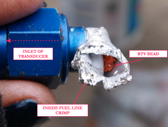

Here is one sad and notorious example with two fatalities that was caused by the builder who used the incorrect sealant in the fuel system:
The concern expressed in this thread so far has been the use of Teflon tape. This report indicates that the builder used RTV to seal fuel lines. Although this report is informative, the build plans I have do not state that the use of RTV is appropriate for sealing fuel lines. Section 8 of the Construction Manual says to "Use Fuel Lube (a sealing paste available in supply catalogs) when installing AN fittings with pipe threads. Do not use Teflon tape!" A search of Aircraft Spruce for the term "fuel lube" yielded the following product: https://www.aircraftspruce.com/catalog/cspages/ezturnlube.php?clickkey=9406 which is not RTV or Teflon tape.
Although I feel for the loss of this family, a cursory review of this information reveals that the builder deviated from the build plans and that this lawsuit is therefore frivolous. Yes, the loss of life is tragic, but the builder bears full responsibility here, IMO.
Unfortunately the builder deviated from the plans and did not follow good practice when sealing NPT fittings i.e. Loctite 565 or 567 paste (or fuel lube per Van's construction manual section 5). RTV and teflon tape can both cause blockages and in another recent example of a forced landing that was reported on VAF a loose particle of fuel tank sealant blocked the fuel flow sensor because it had been installed in the incorrect location, by the builder, against the recommendations of the manufacturer. These are just a couple of examples and there are certainly many more!
