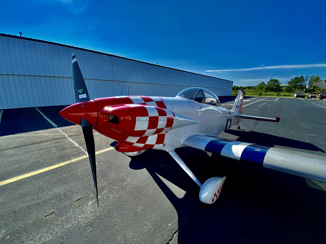

I built my RV-6 22 years ago, it first flew on July 1, 2002. It's been it's whole life in Florida so not only was the original paint beginning to show its age, but there were a few areas of minor corrosion around the airplane that needed to be addressed. It was time to give this airplane a new lease on life. I did an extensive condition inspection this year which included among other things a new cowl with Skybolt fasteners, new gear leg fairings with wooden stiffeners topped with new gear/fuse intersection fairings, new wing root fairings, and a whole bunch of other stuff including two permanent service bulletins to the horizontal stab. The paint shop I chose is located in Sebastian, FL, an airport that is about a 5 minute flight from my home base, Vero Beach, FL. After arriving at the paint shop, I completely disassembled the airplane so that each surface could be painted individually. The airplane was chemically stripped, but afterwards was completely sanded down to bare metal using DA sanders. Then alodine and Akzo primer, and the white base coat. Next, I had to make several trips to the paint shop to temporarily install control surfaces for masking purposes and then remove everything again. Final striping, then final assembly. This all takes a lot of time. Total time in the paint shop was about 3 months. While there, I removed the prop to replace the fan belt which I believe was the orignal belt on the airplane.
Anyway, finally got it home this week and I'm quite happy with the result. It's like a new airplane for me. A few pictures:

I built my RV-6 22 years ago, it first flew on July 1, 2002. It's been it's whole life in Florida so not only was the original paint beginning to show its age, but there were a few areas of minor corrosion around the airplane that needed to be addressed. It was time to give this airplane a new lease on life. I did an extensive condition inspection this year which included among other things a new cowl with Skybolt fasteners, new gear leg fairings with wooden stiffeners topped with new gear/fuse intersection fairings, new wing root fairings, and a whole bunch of other stuff including two permanent service bulletins to the horizontal stab. The paint shop I chose is located in Sebastian, FL, an airport that is about a 5 minute flight from my home base, Vero Beach, FL. After arriving at the paint shop, I completely disassembled the airplane so that each surface could be painted individually. The airplane was chemically stripped, but afterwards was completely sanded down to bare metal using DA sanders. Then alodine and Akzo primer, and the white base coat. Next, I had to make several trips to the paint shop to temporarily install control suraces for masking purposes and then remove everything again. Final striping, then final assembly. This all takes a lot of time. Total time in the paint shop was about 3 months. While there, I removed the prop to replace the fan belt which I believe was the orignal belt on the airplane.
View attachment 66532View attachment 66533View attachment 66534View attachment 66535View attachment 66536

Very nice Pat. What a nice, clean design that really shows off your plane. Are you bringing it up to OSH? Im still on the fence about going or not.
Very nice, and good of you to keep up on the mechanical and the appearance. The photo posing is a little "shady" and I got a chuckle out of the fan belt, not a lot of fans will do the speed your airplane will.

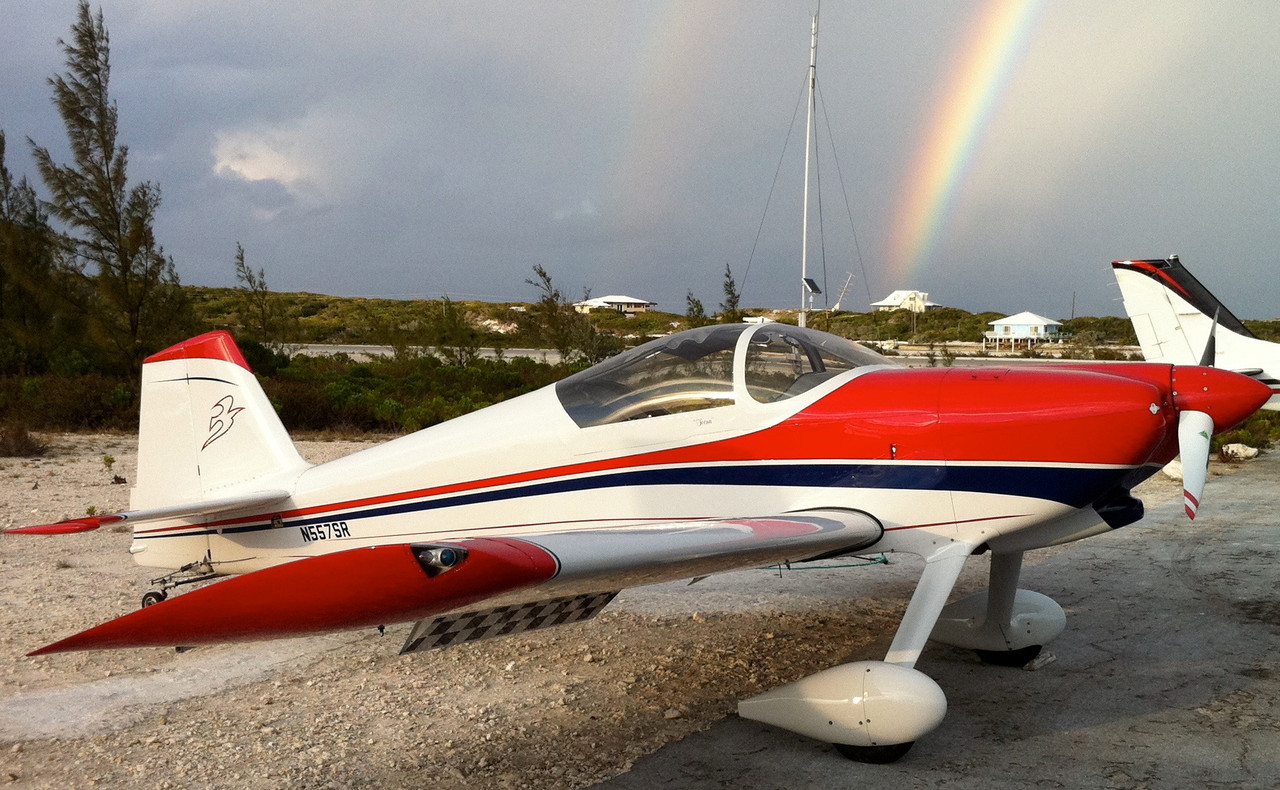

Your Six and my Six-X are the same age from the same State, albeit quite a distance NW of you. Reluctantly sold, the new owner reported the paint is showing the same age/corrosion issues. I’m hoping he will sell it back to me and I’ll do same! :)
My RV4 however was painted 27 years ago and still looks new. I used a process I will repeat with the next one I assure you, much like what you just did.

That is the most stunning paint design Ive seen in a while! congrats. All transparency I might steal a few ideas from your design. haha
My plane is unpainted and I’m struggling with the unlimited options of design ideas. Yours in amazing, I have no idea how you could decide what to do but it looks great!
Credit for the design goes to Autumn Baugh at Evoke, and the paint was done by Mike Dodson at AircraftersRefinishing in Sebastian, Florida. Highly recommend both of them!
