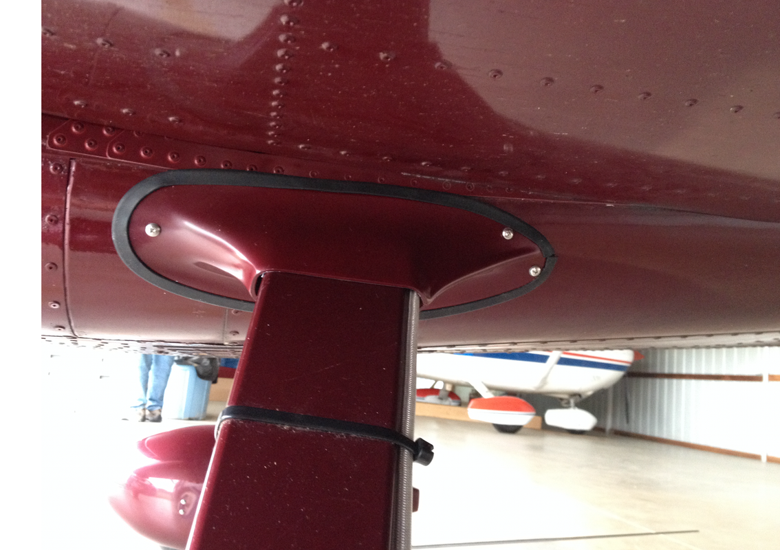

Noticed the 12iS KAI includes a nice & simple main gear seal assembly (reference RV-12iS PAGE: 38iS/U-11).
Would there be any issues fitting it to a "classic" RV12 ?
I don't see the required parts (F-01275H, F-12105A and BUNA rubber sheet) in The List.

I posed the same question to Van's support and got an immediate response ...
"this is one of the five items that are backwards compatible from the “iS” to the “classic”.
Others would be the egress handle, canopy latch, F-01234 gusset, and stabilator tip fairings."

Here you go...

Thanks for the photo. I was more envisioning a fiberglass aerodynamic faring. That looks like a rubber boot to reduce the air ingress / egress I guess that may be a problem in the colder climates.
easy upgrade for RV12 (from iS)
My initial interest in it was to deter intrusion by pesky mice (and it just looks aesthetically nicer to have those gaps somewhat closed up)
Like this...
BuyPlaneParts.com (2) RV-12 Main Gear Leg to Fuselage Fairings - $80.00
Not fiberglass - ABS plastic

Yes, the ones you have is what I had in mind. I am not a fan of ABS in this application. I may have to mold up my own fiberglass ones.

The plastic has cracked in a couple of places. I laid fiberglass reinforcement inside and no problem now. I guess no worse than all the cracked plastic on a Cessna...
