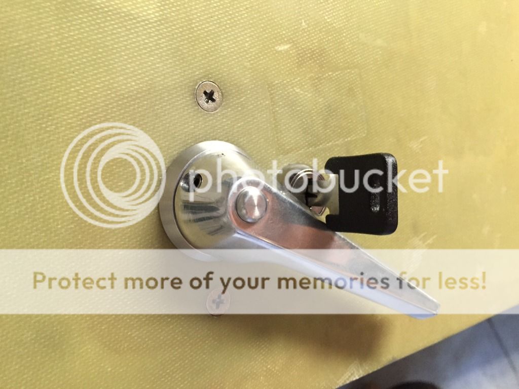

Finally got to install my own set of handles!!! And locks on our plane.
Based on what I've seen some others do, I had been planning on using the simple baggage door lockset to secure the door in a locked position.
I had specifically planned the height of the handles so they would clear the locks.
Turned out a little better than I expected.
For anyone wanting to do the same thing. I'll make up some directions.
The basics are: the lock center is exactly 1" from the door pin hole(double check your measurement), Bend the "tab" of the lock to hit the gear rack, also, we fount it works best and is strongest if you make the hole for the lock the actual shape of the lock. IE, flat on two sides, This will prevent the lock from spinning. It's a tight spot to get a wrench in to get very secure.
Locked, with lock hidden:
You can turn the handle just enough to get the key in to lock/unlock
In the full open position
Inside the door, Locked
In the stopped position where you can put the key in from the other side
RV-10 Door Locks in place!!
