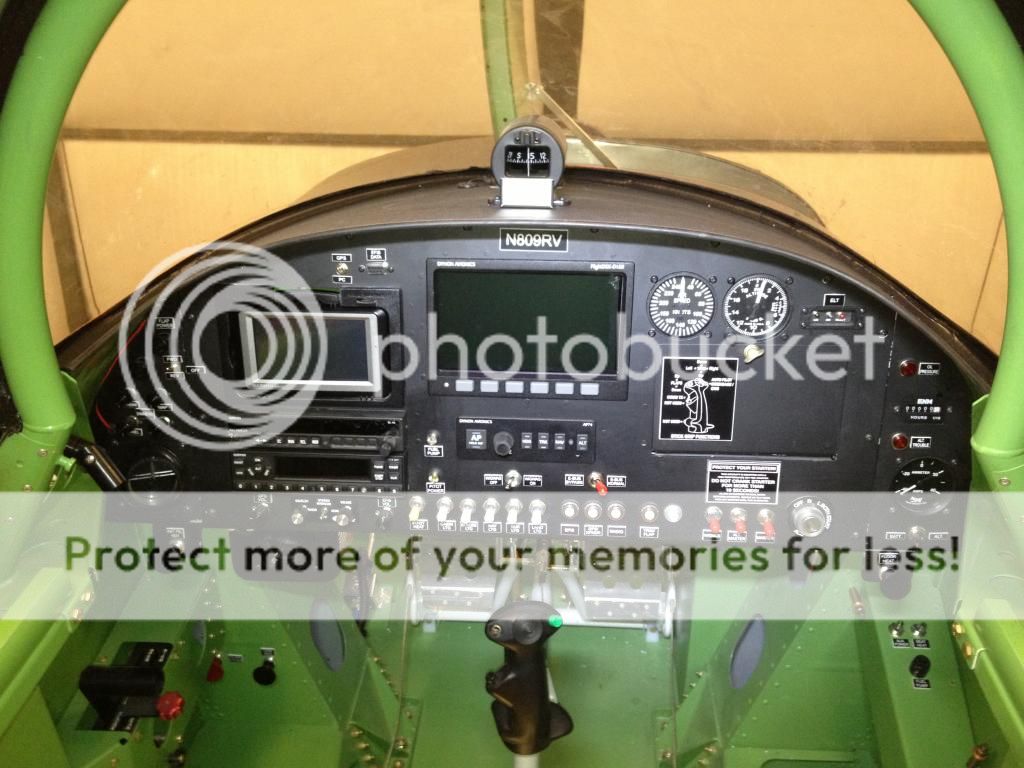

Concept and Reality
So - I'm days away from my certification inspection and getting my docs and ducks in a row. I came across my Panel Planner concept panel.
Looks like this:
Took this one at the hangar today:
So in the end - expectation meets reality - how cool is that!
Without going into a thread drift - PowerFLARM working well lots of good heads up with mode C. Gliders use FLARM but the few that I have seen were not transmitting/equipped. ADSB mainly airliners but I use my MGL EFIS GPS out to my Trig T21 for ADSB and that is working well as this electronic plane spotters website shows!

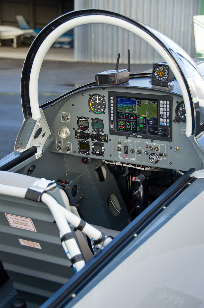

So, went with old fashioned steam guages for pretty much everything. Don't need much for a day VFR bird, really had extra space left over. Did give up on trying to fit the map box in there, will come up with something on the side. Painted with wrinkle paint from the auto parts store.
There will be the aerobatic placard under the transponder, and a mount for my handheld hiking GPS in the big space on the right. Planning on eventually putting a ADS-B moving map in there once prices come down.

bifft,
I honor and respect you for your simplicity approach to having real fun!
Nice job.
Mike
Near the capitol Bern in a small city called Grenchen (ICAO-locator LSZG) where Breitling watches do come from ;-)
Markus

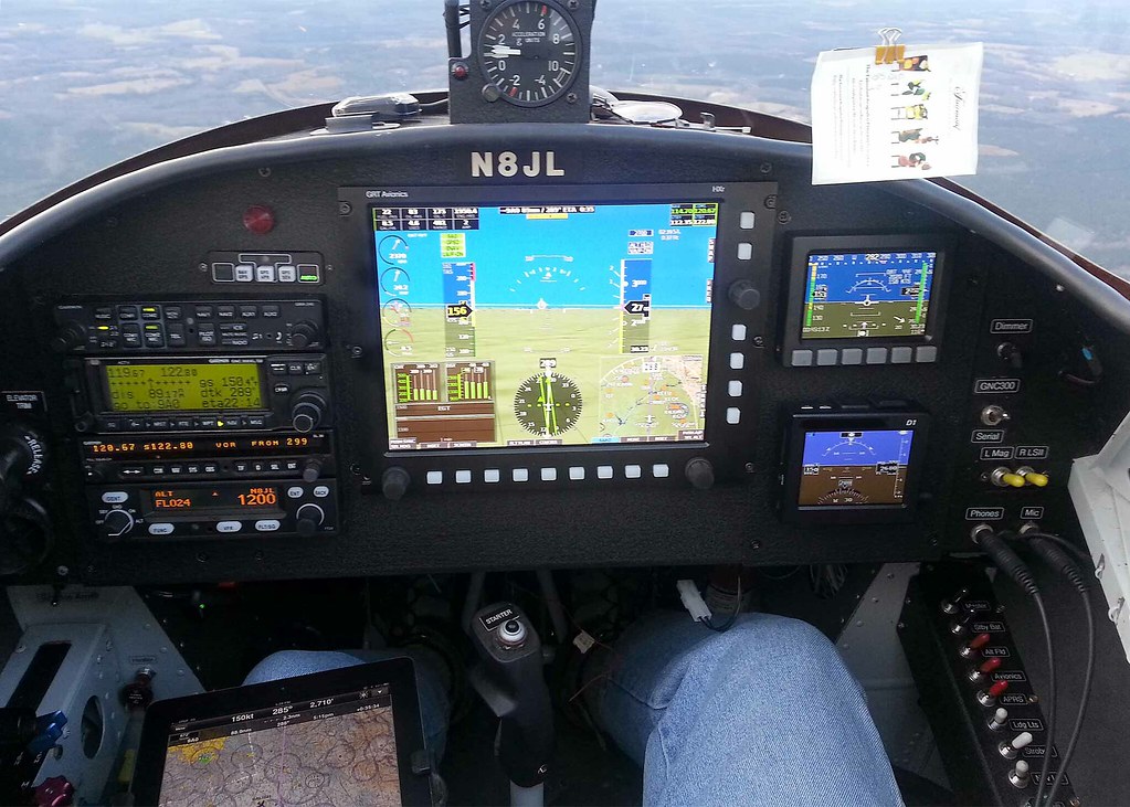

Just finished with GRT HXr
Just about finished tweaking my new GRT HXr installation. I removed my GRT Sport and replaced with the 10.4" HXr. That involved removing the ARINC module, replacing the compass module with one matched to the new ADHRS I had to install, removing the encoder and installing the external GRT GPS.
Setup was standard GRT. Serial in's and out's and configuring the display for the parameters you want. All in all an easy process.
I kept the D10A and installed a D1 for attitude/heading redundancy. I have and SL30 for ILS/VOR's, a Garmin GNC300XL for GPS ops, a Trig 31 for transponder with ADSb out/in and a Skyradar to display the ADSb weather and traffic on the HXr.
Dang Jerry that looks great. I've always liked the look of the GRT stuff but
I was pretty close to pulling the trigger on a dual display G3X upgrade. I now may take another look at the HXr.
I have one question, where did you hide the little EIS display?
I mounted it down on the right side panel under the switches. Made a canted panel so that it faces toward the pilot. Once programmed though, itI never even look down at it.
I am curious where you mounted the SkyRadar unit and if you used external antennas. I am going to be headed down a similar route so any info would be helpful.
pdj
pdj
I mounted the Skyradar behind the left lower part of the panel on a bracket under the transponder. I used Wifi antennae cable extensions and used the Skyradar antennas mounted beside the G meter on the glare shield.
Cool. Looking at upgrading my GRT to that display too. Can you take a few more pics cycling through the various display pages. Is the lower right box where traffic and weather displayed together? Can you take more pics of how/where the GRT display shows traffic, wx, winds aloft, metars, tafs, etc? What does your ipad that is on your left leg do for u that the GRT display doesn't?
Any other operational tid bits or purchase/installation advise you can share and give further updates on would be sweet. Now I have to go research what a Trig 31 is!

panel labeling
Fernando or whoever may have suggestions,
What did you use for labeling your panel? I am building the panel for my 4 now and need something professional looking to label the breakers and switches.
Mike
I recognize that approach. Haven't done it in awhile since they changed the equipment serving Santiago. Miss going there!
The panel is looking great. Can't wait to light mine up- hopefully soon. I think the Testors kit is brilliant way to do the labels. What program did you use to create them before printing them out?
I used Microsoft paint, I now is not the best but is what I have. If you fly down here again, send me a message so we could go flying in my 8

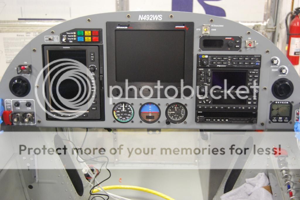

Panel placards done
I had Denny at AvGrafix.com make up my switch labels and a couple other placards. Came out great! Thanks Denny! :D
The small white dots are drill hole locations for switch guards.
Uploaded with ImageShack.us
