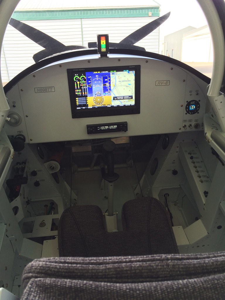

Are you removing or modifying any structure behind the panel to facilitate this modification? What type of fasteners typically hold in this panel section? I am guessing the RV8 structure has a structural member between the two landing gear uprights behind the panel somewhere. If there is a continuous piece of metal attaching to and running between the two uprights, and your modification changes that, then I would use caution.

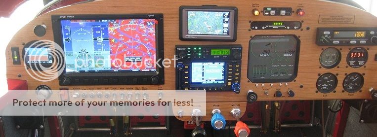

AAflyer,
Not a bad idea. I was in the same boat, with my legs hitting the bottom of the panel. My solution was what stein did for his customer. I made a panel with cut outs in the bottom. Just a one inch cut out makes a huge difference. In order to regain the strength of the panel, so it doesn't flex, I then recessed the entire panel back one half an inch and made this panel out of carbon fiber. Good luck!
[/URL][/IMG]
Panel Mod
Hello Bruce,
I don?t see anything wrong with what you?re planning. For the 8/8A, structurally, most of the loads are carried by the canopy hoop, the bulkhead behind the panel, and, of course, the skin. The panel mostly hangs there and goes along for the ride.
Just a thought: For climbing in the 8, you?ll probably need most of the clearance for your knees right at the outer edges of the panel where you have the two 45-degree indents now. You might consider make those indents a little steeper and deeper and then fill-in, or partially fill-in (stick clearance), the center section to give you a little more panel space.

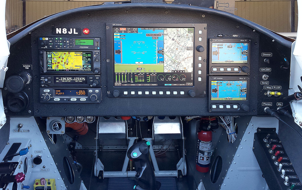

Here's a photo of my latest upgrade in N8JL.
I removed a GNC300XL and MD41 annunciator, and removed my SL30 and replaced them with a Garmin GTN650/GTR200 combo.
I am planning on the GRT Mini AP when it's released. The panel is already cut and nutplated for that unit but I made a plate to hold the Dynon D10A in the interim. The Dynon D1 is the tiebreaker if one of the ADHRs give bad info.
I'll be doing a detailed write up on the new install and what I gained and lost in the near future.
So far, I love the 650 and it's little brother 200.

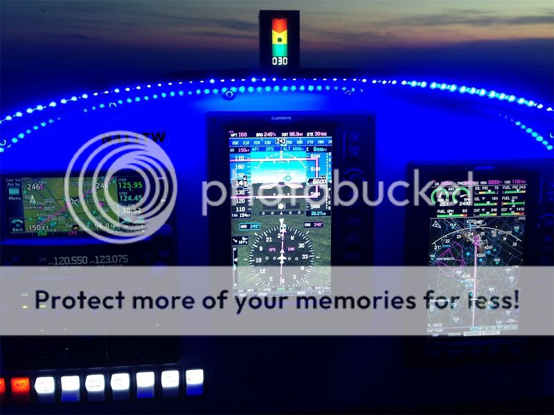

Panel for 369WR
Thought I would throw my hat in the ring a post a pic of my instrument panel.
N411TW
Wanted to get this posted before I do another upgrade :eek:
She underwent a major avionics upgrade in March of 2014 and now has the following Garmin equipment:
?GTN-650 NAV/COM
?GTR-200 COM 2
?GMA-240 AUDIO PANEL
?GTX 23 ES TRANSPONDER
?GDU 370 PFD
?GDU 370 MFD
?GEA 24 ENGINE MODULE
?GSU 25 ADHRS 1
?GSU 25 ADHRS 2
?GMU 22 MAGNETOMETER
?GTP 59 OAT PROBE
?GMC 305 AP AFCS
?GSA 28 AP SERVO
?GSA 28 AP SERVO
?GAD 29 ARINC MODULE
?GDL 39 3D ADSB MODULE
?TCW BACKUP BATTERY
