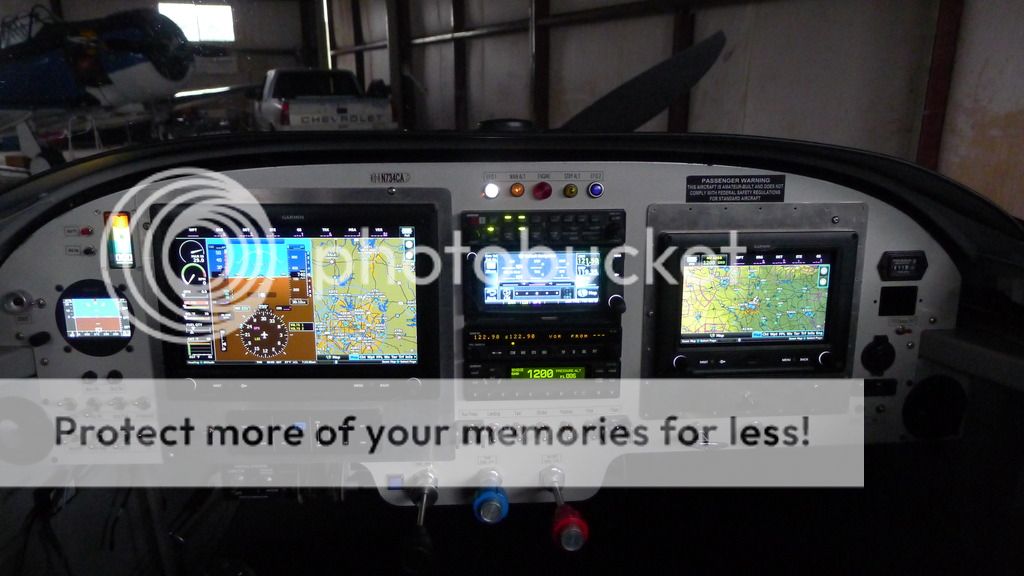

Just wired up and finished the SL-40 install along with the GTX-327....everything works as it should. Really like the HSI function on the D-180 with the G496.
Fired up the panel today...

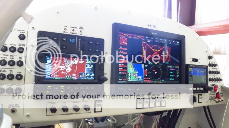

This is Bob Lund's RV-8 that I'm helping wire. Panel was done by Aerotronics. So we got it installed today and got the battery connected so we were able to turn the master on, avionics master, activated the start relay and got the starter-engaged light to come on. One wire at a time, lots more to do!
The G3X Touch is nice! I see an upgrade in my future.:)

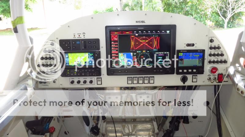

Hey Pat, I'm curious why you elected to install a starter engaged lamp on the panel? I have never seen this before except in turbine aircraft as there is a delay between starter engagement before the propeller begins to spin. Any particular reason for a piston airplane?
Pat, yes, it's just to make sure the relay disengages. Stuck relays are not good in this situation. :)
True but in 12 years of working on airplanes everyday, I have never seen that happen. It's a good idea though! That is why I love Experimental aviation! See an idea and put it to use.
Agreed, but it can happen. The way I look at it is you have the information sitting right out there on the "I" terminal of the relay, why not use it? Just one wire. But I'm with you, it's great that we have the freedom to make the choice, gotta love it!
Starter Engaged
I've seen this happen 3 times where the starter solenoid failed closed. Once was after a start and was obvious due to noise and pegged out ammeter. The others were before start. Anytime the battery master was on the prop was turning. Always a good idea to clear the prop arc of people, objects, tow bars ect before turning on the master. My plane will have a starter engaged light installed.

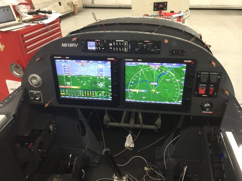

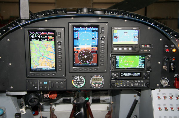

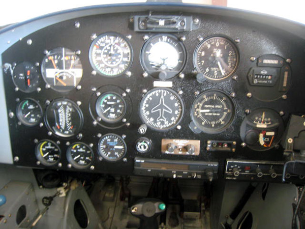

Our latest RV8 panel upgrade..
Before...
After...
G3X, dual ADAHRS, GMC305, Auto Pilot, GTN650, GTR200, GMA240, AOA, Heated Pitot, GRT Mini X.
Complete electrical system re-wire including new switches and breakers and B&C back up alternator.
Equipment and Panel CNC from Stein.

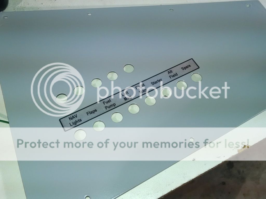

your labels---
Brother P-Touch? I'm almost ready to go this route, as Stein's printer that does white on clear decals is in-op with a now indefinite replacement time, and my local print shop can't do white ink.
I have a few more phone calls to make including an avionics shop at Twin Lakes to see if maybe silkscreening is within my budget, but I'm thinking a little lowering of expectations and a trip to Office Max might put me out of my misery and back on the road to a finished panel upgrade.
Your labels look like something I could go for, Walt. I see a little background carrier visible but not too bad. What are they? Did you clear-coat?

Yep brother P-Touch with TZe tape, no clear coat. As a practical matter I have found these labels to be legible, good looking, durable, easy to install and easy to make changes.
Are they as nice as some other methods.... no, but I'm a very practical guy and these work good, look good, they're cheap and easy to install, so what's not to like.
Of course for me it depends on what the customer wants, if he's ok with it this is my preference but I'll do it anyway he wants (I have no problem spending someone elses money!).
http://imagesupply.com/collections/shop-by-brand/products/brother-pt-d400vp-label-maker
+1 for the P-Touch. Many different label colors available too. The graphics software that comes with it is the key to custom labels. Here is silver material against my matt gray/silver cabin color;
I've adopted the theory that instead of printing on clear and hoping that it isn't recognized as a label I would print a "Placard" and flaunt it being a label:D
Panel CNC by Stein.
Hey that's a good idea, I might try some of that!
label color options
I'm all set to "Amazon" a P-touch that's Mac-capable and all that stuff. Wondering how White on Black would look on my satin black panel vs White on Clear. Anyone tried that?

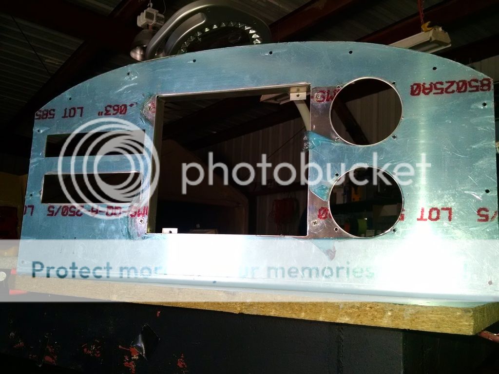

Panel cut
Not as impressive as the finished panels in this thread. Give me time......
Round holes
Hole saw in drill press. Had to dress the hole up by a couple of thousands with 80 grit then scotchbrite wheel. I was surprised at how clean it came out.
I read a thread about drilling the pilot hole then replacing the pilot drill with smooth rod so the hole doesn't drift. Didn't do that but cut the panel over a piece of 1" plywood. That helped hold the pilot drill in place.
If only the rectangular holes came out as well....
...if only the rectangular holes came out as well.
That's why the radios and instruments have flanges around the edge, to make us look good.

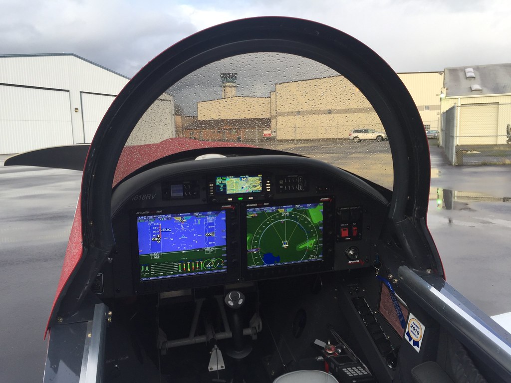

Here is my first fire-up of the G3X panel in my RV-8A. I had two immediate issues: one was a network error caused by connecting the shield ground of each device on the Canbus to its backshell, and the other was forgetting install the jumper defining which GDU was the PFD (it's the right one.) Had to call Garmin to get the resolution on the first error, I figured out the second. The Garmin guy seemed to know right away what the problem was - you only connect the shield grounds to the connector backshells at the beginning and end of the physical bus. Otherwise, you just connect the shield grounds together along the chain. The photo shows the screens before the fixes were applied.
Any chance you'd have a photo with a little more light in the panel itself? Looks cool and would be interested in seeing it all! Also, what's behind the panel and in the plane equipment-wise like for radios etc? Any photos from behind the panel on how you fit it all in?
Thanks!
Thanks!
I do have others. This particular photo shot with an iPhone had to deal with the bright sky outside the hanger, and the dark panel. Not my best shot (I taking these for documentation....) Give me a sec and I'll post a few more.

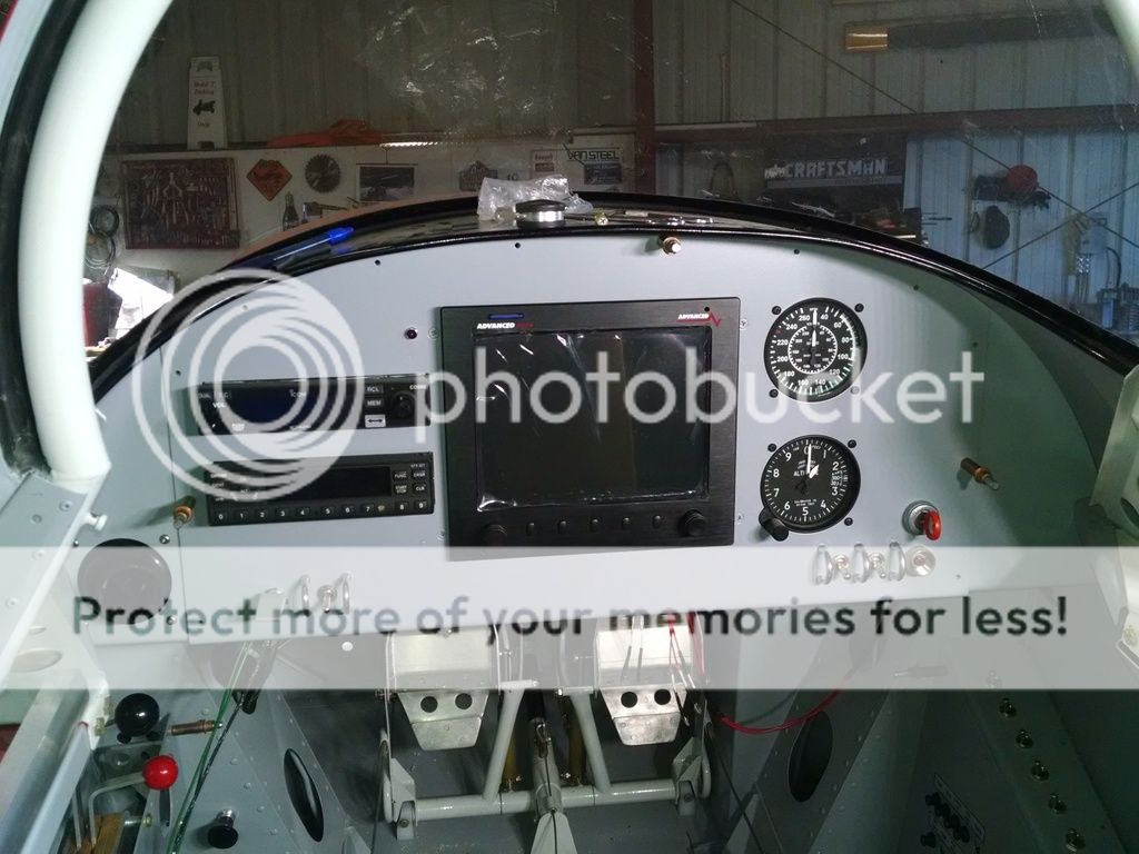

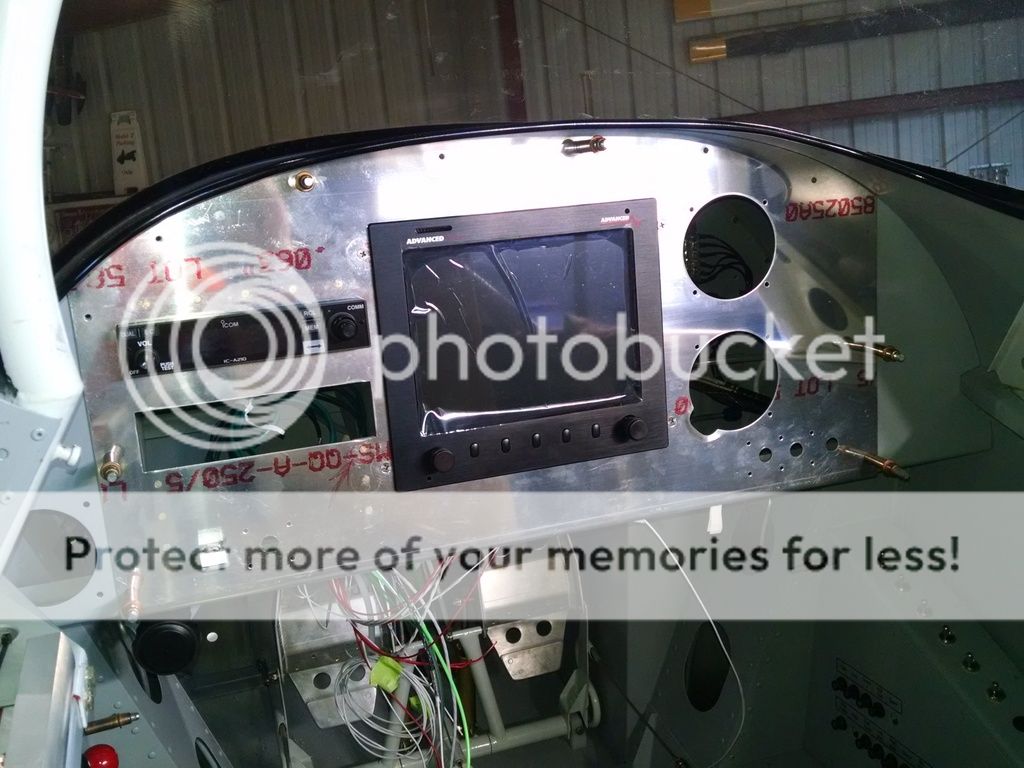

Has anyone installed a radio stack on the left, 10" Skyview in the center and a 7" Skyview on the right side of an -8 panel? I'm wondering if there is enough room?
Hey Brant
Here is my AFS4500 on center with A210 and GTX327 on left. Barely enough space to put lock nuts on the rack mounting and still get inside the panel header in the cabin. The Skyview is about 2" wider so unlikely you could keep Skyview centered.

Why you can upgrade the panel from VFR to IFR with a new Avidyne IFD-440. We sent a new powder coated and labeled panel center section, IFD-440 and PS Engineering PAC-15 remote audio panel to Synergy Air in Eugene Oregon.
Since this plane was built with our plug and play Advanced Control Module the panel "rewire" was as simple as plugging in the new GPS Navigator and Audio panel harnesses into the ACM.
Original Advanced VFR Quick Panel:

Label source?
Thanks, Andy. I think the most challenging part was the blasted labels!
So, could you please share your source for your labels? They look very professional, and will, no doubt, instill great confidence in their pilot, from your passengers. ;)
