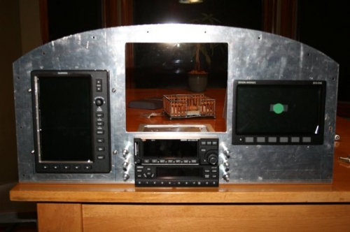

Thanks for the kind words guys. I am happy with the way it turned out, but.....
I do fly IFR/IMC and this panel is not adequate for that. A recent IMC flight caused me to reflect on the mission of this aircraft. Will I stick with VFR and keep the existing panel, or change it and thereby let me more safely fly IMC? I don't want to continue to fly IMC with what I have.
In this panel there is no backup AI other than the GPS derived six pack on the G696. And there is no room in the panel for a backup, other than the 2 1/4" hole on the left side panel where I could install an RC Allen electronic AI. But if the EFIS fails I really don't want to be IMC and try to keep the aircraft upright by gazing that far to the left. So, I'm probably gonna upgrade the whole panel.
I really like the G696 and want to retain that in the new panel. With that constraint, I started looking at dual EFIS systems. Dual (stacked) Advanced systems won't fit, nor will two of the smaller Dynon Skyview EFIS'. Plus Dynon has a long way to go to get the features active in Skyview that I desire. One consideration that I am currently looking at is to replace the lower EMS D-120 engine management box and replace with a Dynon Flightdeck D-180 box with battery backup. That would be the least expensive alternative that would give me a redundant and independent EFIS.
But another consideration is that my panel has only one legal IFR navigation system, the G SL30. I really want to add a G430W to the panel, but I can't do that without getting rid of the Dynon AP74. But I don't want to be fiddling around with the D-100 EFIS for autopilot control if I'm IMC. So I'm getting down to redoing the whole panel and put in 2 GRT Horizon HX screens with dual AHRS and backup batteries, and add the G430 and an audio panel. Lots of money for sure.
Meanwhile I ponder....
I am wanting to fly IFR and needed some additional instruments, I found this GRT sport 200 here on the forum and it made sense for me considering just the CDI and back up AH I need would have cost more than the sport.
I bought a new panel blank but after further consideration I thought I would be better off installing it, and see if this location would work.
My next Change will be a 430w in place of the GX 65.
The evolution continues.

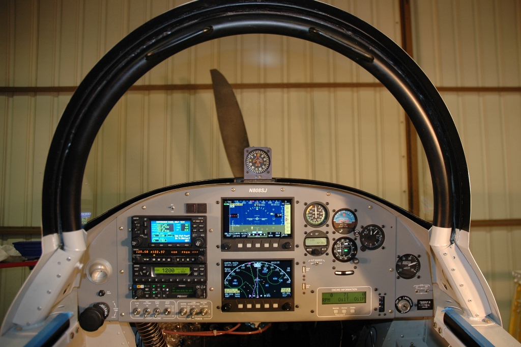

This is what I have in mind. Not finalized yet, and positions will be jockeyed around a little, but a general idea. The larger Advanced screen is a 4500 panel mount unit (same dimensionally as the 3500). I had thought about stacking 2 3400's in the center of the panel, and put all of the radios on the right, but I think I like the larger screen better because it displays info with a bigger picture, plus it has the newer device navigation knobs on the box. The downside is my radios will have to be scattered around a little, not a major drawback IMO. Comments/criticism appreciated!

The 430 and the SL30 are both really long, so I don't think you'll be able to mount them that low in the panel. Ask me how I know....
Chris
Chris -
The SL30 will definitely fit, took measurements today. It's in a similar position to where it is in my existing panel, see the picture in a couple of posts above these (previous page). Actually it will fit better there than it does in my existing panel. It will clear both braces. The dimension from the face of the baggage compartment z brace to the panel face is 10 7/8", and it's over an inch behind the z brace, for around 12" total. The SL30 tray to the back of the connector is about 11 1/2". The G430 will be close, but I think it will also fit. May have to do something creative for the antenna cabling..... Won't know for sure until I get the unit from Stein, this week hopefully. But if it won't go there, I could mount it above the right hand EFIS. That would not look so good in that configuration though.

Wow! That looks really great!
However, is it not a bit redundant? Your plan has two GPS units, two Comm radios, two Nav radios, and two MFDs.
And while your panel would provide a great deal of capabilities, do you think that it is worth all of the extra weight, the extra wiring, and all of the extra money issues?
As someone who is still in the 'Panel Planning' process, I would be most interested to find out why you want such a panel.

Crossbow, Bill & Chris -
I already have the 696 and the SL30 so I'll reuse them. I want to try to keep the 696 - it's XM weather is just awesome, and it has a battery backup which will provide guidance in the event of a buss failure. Also, it has approach charts, soon to be georeferenced. I know Advanced has this feature too, but my intent is to use the 3400 for a dedicated engine monitoring panel (but it is also a backup EFIS in case the 4500 goes belly up), and I'll mainly use the 4500 as a PFD. I also want an enroute and approach capable GPS, hence the 430. I realize this is a totally redundant panel, but I intend to fly IFR/IMC, and in that world redundancy is King! Take a look at anyone's panel who flies IFR....you'll find a redundant system....either another EFIS system with battery backup, or steam gauges.
2 vertically stacked 3400's would fit and definitely look better, particularly because I could then have a traditional radio stack, and having my radios scattered around does bother me. One thing I could do is ditch the 696 and use the Advanced XM weather module, or get a 496 and put it in the stack, if it would fit in the stack with the Air Gizmos mount.
Regarding radios left or right...in my existing panel I have the SL30 on the left, and being right handed I have found it is very awkward to use my left hand to tune frequencies, etc. Likewise, it will be awkward to take my hand off of the stick to tune radios. So radio position is still undecided, but am leaning to the right side.

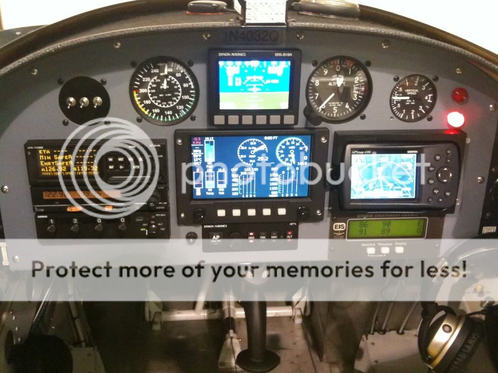

Panel coming along
Just thought I'd throw up a pic of my panel in progress.
Drew up the panel in AutoCad and then had the blank cut with a water jet.
Turned out great!
Waiting patiently for my AFS 4500 Deck to slip in the big hole.
Still need a 2-1/4" altimeter and compass.
This is the fun stuff to me. About to start wiring!!
Will post more when the panel is completely populted.
Me too.

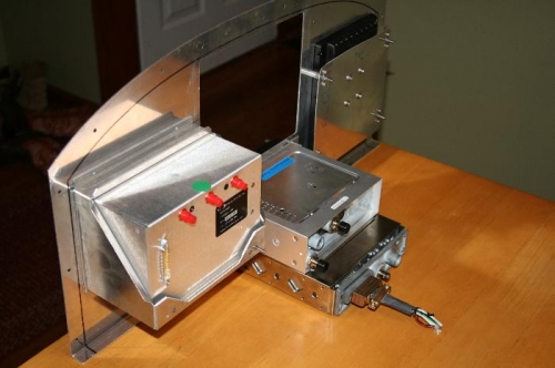

Here's my panel. I'm also waiting for my AFS, in this case it is a 3500EE (should be about another month).
Also there is view of the back if someone is curious about mounting the 696.

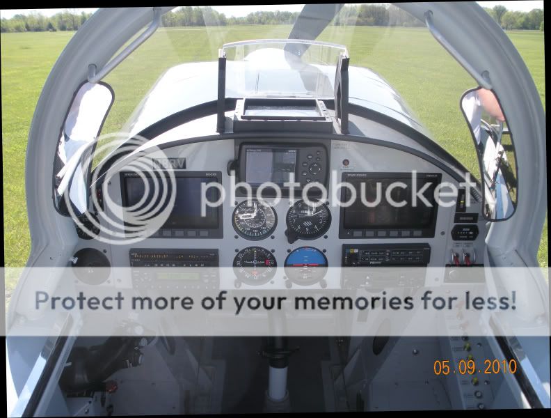

My Panel
Here is my panel in my [long] under constructions RV-8 "Quick Build" (7 years in the making and counting...).
I just finished installing it over the weekend...
Skylor
RV-8 QB
Under Construction
N808SJ Reserved
Absolutely wonderful panel. With dual ADHARS you are all set. Have seen dual GRT's in Jim Phillip's plane and they are terrific. Know you are going to love this setup. Nice labeling as well. When do you hope to fly?
Bill
...With dual ADHARS you are all set.
Bill
Bill,
Thanks for the comments. I just have the single AHRS since the dual wasn't quite available when I purchased my EFIS. I have no near term plans to upgrade because my current AHRS location doesn't have quite enough room for the dual unit and since I have a real attitude gyro plus the trutrak autopilot, I don't feel that I need the redundancy of the dual AHRS.
I hope to fly before summer. I'm just trying to finish up a few miscellaneous items before moving to a phase 1 airport and doing all the finally assembly/flight prep stuff.
Skylor

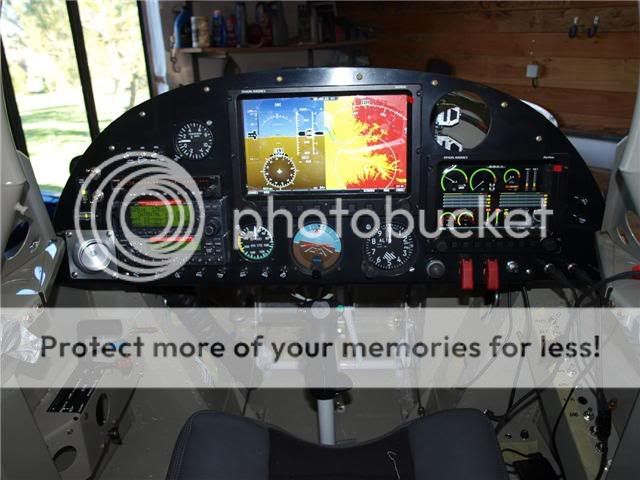

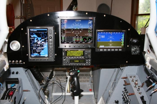

my panel
Just stuck my panel in this weekend. Not powered completely yet (only the dynon and xponder are wired completely at this point).
The primary flight display is an AFS-3500EE (w/internal battery). The GPS/MFD is a 696. GPS/Com is a GNC-300XL, transponder is a GTX-327. Backup platform is a Dynon D60 (w/internal battery)
More to come.
Very nice all glass cockpit Brent. I can't wait to see it all lit up. I like the openings in your gear towers. Wish I would have done that. I removed the web material between the bottom 2 holes, but leaving it completely open would have worked better. Looks like you must have a plate to cover the opening - great idea.
Thanks Scott! Yeah I 'borrowed' the idea from others on the forum. So far so good. I'll post another picture of the panel once everything is wired up.

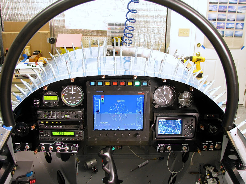

I'm finally done with Smokey's panel (for now). Had to finish some interior painting after the outside paint, and install the HUD. Still haven't figured out a way to get a really good panel pic without washing out the display ...
Best 8 Panel I've seen.
Don,
Congratulations on your panel. The best 8 I've seen.
Beautifully clean, elegantly simple and functional in layout.
Pete.
HUD
Don,
I love that HUD. It would be cool if you could tell us more about it. Also, that throttle quadrant looks like it means business! Your plane turned out awesome! Enjoy!
love the HUD! Please send a link to the vendor.
Where did you get those mirrors. Want to do the same thing.
Very, Very Nice! Well done.
You guys are going to be SOOOO disappointed. The HUD is fake. :(
Hey, you can't have a fighter without a HUD, right?
Actually, I found the vendor here on VAF. I searched high and low for the thread, but came up dry.
www.viperpit.org
A truly amazing site, actually. Some of these guys put a whole lot of work and talent into sims that will never leave the ground! The website owner has a business that makes various F-16 panels for simulators, and the simulated HUD was just what I needed for effect. Somebody out there will eventually make a working HUD for Dynons, I'm sure of it. Till then, it's just window dressing, sorry.
The throttle and stick grip are F-16 stock, and provide a pretty good HOTAS setup. I can start the engine and control trim, A/P disconnect, comms and flaps without taking my hands off the controls. The mirrors are from an F-14 and I found them in the Aeromart at Oshkosh many years ago.

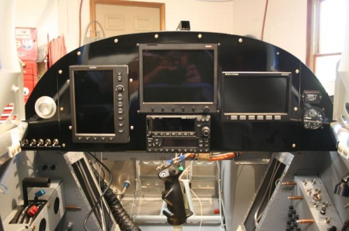

Here's my panel after I cut the panel blank this weekend (about 20 hours worth of work....). Still more to do, but I have already wired and successfully bench tested all of the electronics as a system. Hope to have it in the air in 3 - 4 weeks. My plan is to have only about 1/4" or so of the avionics bezels protruding from the panel. The Airgizmos 696 panel dock has been slightly modified to allow that. The aircraft is powered by a Vertical Power VP-X system...received the VP-X box last Thursday, and all circuits worked perfectly, except for having to reverse the elevator trim motor wires for proper direction. The panel has the AFS 4500, but it is in the 3500 form factor. A tray mounted style 4500 would not have fit in this panel....as you can see panel real estate is at a premium. The autopilot is an AFS branded TT DigiFlight II VSVG (with pitch auto-trim), which is mounted in the left side panel. This panel replaces a VFR panel; the airplane has been down since mid March for the re-do, and the project included totally rewiring the airplane. The only original wires are the mag harnesses. It is coming together, and so far so good! :D
nice!
Jim,
That's looks great! You certainly shoe-horned some nice equipment into that -8!
Can't wait to see it finished!
Brent
Thanks Brent. It took HOURS of planning to get it all to fit. I hope to have a picture of it all fired up in a week or two.
