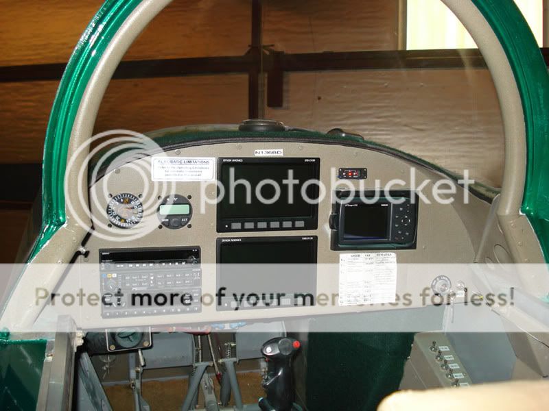

Why is it that everyone seems to install mechanical Airspeed and Altimeter gauges in panels with full EFIS screens? Is it an IFR thing (to have a TSO'ed altimeter or something)?
I'm planning a VFR only panel with an AFS3500 and no other dials. Am I missing something?
Backup, Backup, Backup
To me, nothing more than backup in case of catastrophic electrical failure.
I plan on having steam ASI ALT VSI and a compass. EFIS yet to be determined but am currently leaning to MGL Voyager. I am still a couple 3 years from writing a check. MGL should also have black box Comm units by then. No panel space needed.
In the UK we have to... In fact, I tend to use them more anyway than the EFIS ones - much easier to read / interpret.
Also, if you place them correctly, they can easily be seen from the back...

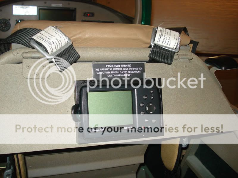

Here is a pic of my latest and hopefully last(at least for a little while anyway) panel in my newest RV8. After building a super panel for 3JT(RV6A), a minimalist panel for 4JT(RV8), an IFR panel in 5JT(RV8 modified for the person who bought it). I have come up with what I believe, after considerable experience flying these planes, the ultimate bang for the buck panel.
Fire away!
Jon,
I see you are using a "Panel Dock" for your 496. It appears to be tilted "up". Do you have a sketch for your bracket? How much did you tilt it? Was this angle based on experience?
JB

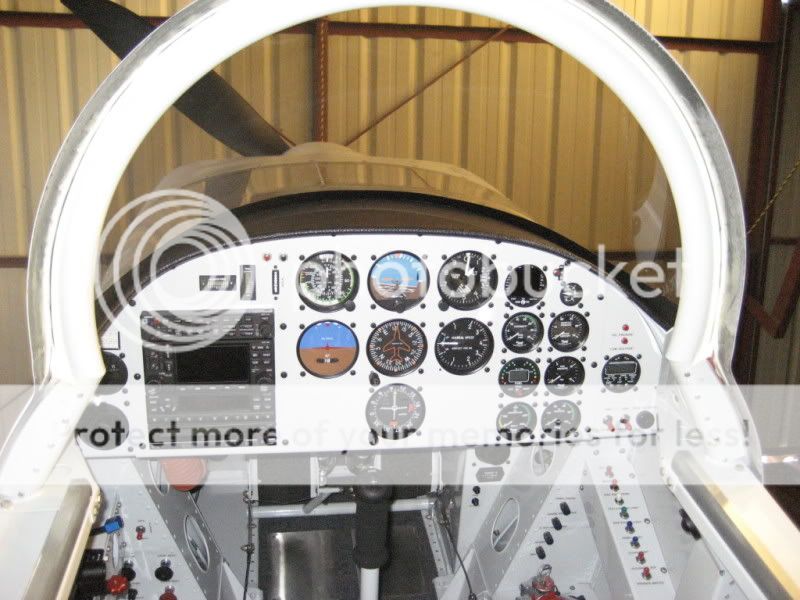

Here is a picture of the newly "lit up" panel in my RV-8. The panel features a Vertical Power VP-200 electrical system. Installation was very straighforward with the control unit installed in the "well" in the forward baggage compartment. The standard Vans RV-8 panel would not accomodate the Dynon D-180 and the display unit for the VP-200 within the vertical dimensions. Experimental Air fabricated a panel with the center widened by one inch in order to make it work. In addition to the Dynon and VP-200 the panel has a Becker 4201 Com, GNS-430W, GTX-300 Mode S Transponder, PS Engineering PMA-900EX audio panel, TruTrak ADI as the back up horizon, TruTrak Digiflight II VSGV 2 axis autopilot, GPS-496 in the Air Gizmo docking station and "steam" backup altimeter and airspeed.
[/URL][/IMG]
Tom - you beat me! Nice job, I like the custom panel with the little extension.

panel dock
JB
Sorry it took so long to reply.
I'm using the AirGizmo's vertical tilt adapter.
I really like it.
Best regards
Jon
tilt adapter
Thanks Jon,
More questions;
- Does the angle seem about right?
- Did your's come pre-painted to match the Panel Dock?
JB
