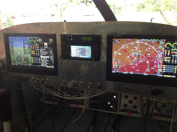

Getting close to the finished line with my panel!! That was a LOT of wiring! The camera flash made things look harsh... sorry. Overall, I'm pretty happy with the result. The GTN750 feeds data to the Pilot EFIS with a AFS GPS as backup if ever left to backup power (backup battery powers pilot EFIS only). - Mark

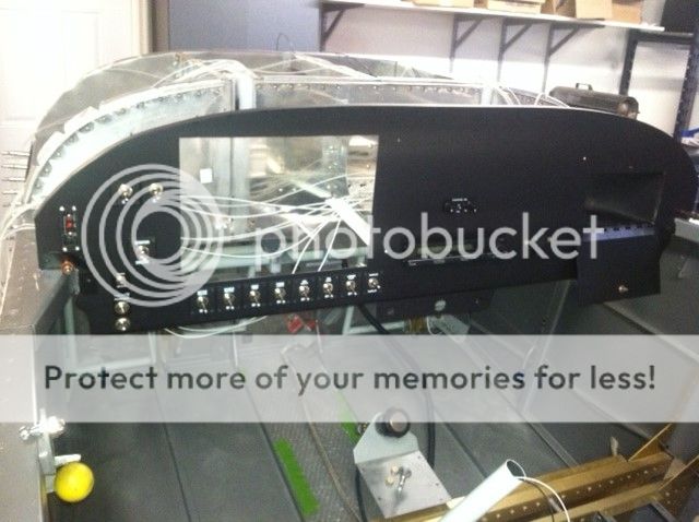

Wow, that's for a -7? I would've guessed a -10. Drop dead gorgeous, it is. It also raises a question in my pea brain. Is there any provision to isolate the aluminum from the carbon fiber on these panels? It may be of little or no consequence, just influence from some of my background where Al + C was always regarded as a battery. Small, to be true, but current nontheless. I would be cautious to avoid using it while immersed in salt water. :D
This is not a problem as long as you do not try and turn it into a U boat or submarine.
Many of the new aircraft use carbon and aluminum together. As long as it does not see salt water and seal or isolate with primer or paint things are good.
Aluminum and stainless have the same issue when in water.
(Galvanic corrosion requires an electrolyte. You can have a dry bin of aluminum and stainless fasteners... no big deal. Immerse them in water, you have an electrolyte and corrosion will occur. This is why galvanic corrosion is a big deal for marine applications. When possible, keep water away from metal. When not possible, try to use the same metal. .)
Geoff
If there is salt water contract we've got bigger problems!
The aluminum is going to be painted, carbon will be clear coated.

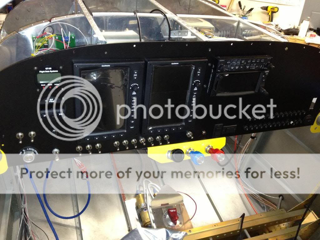

You seem to have 2 autopilots there (Trio pro pilot and Garmin 305 if I am seeing correctly).
How is that set up, and how will it be used?
John
The GMC305 is not an autopilot. It is simply a dedicated control pad for the autopilot/flight director controls of the G3X system.
It can be used with either the Garmin built in autopilot/servos or an third party autopilot like the Trio or GX Pilot. In either case, it is an optional component.
It also enables some features that are not present in the standard configuration.
