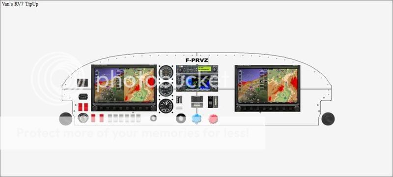

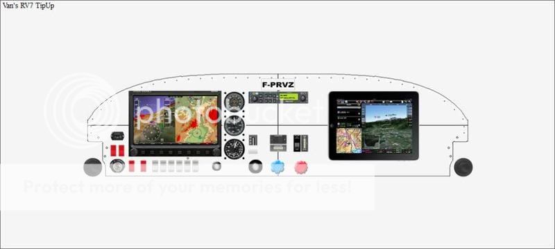

I bought the licence for Xpanel and I played a bit with the software today.
Here is the panel of my dreams:
Here is probably what I will be able to afford:
Similar, but on the second one the GNS430 is gone and an iPad replaces the 2nd Dynon Skyview.
Tell me what you think.
Important to me is panel symetry, functionality and logic.
On the left are switches for battery, alternator, start and mags. Below the skyview are switches for avionics master, fuel pump and misc switches for lights etc.
I would either:
1.) ditch all the analog standby instruments for something like the Dynon D10, D6 or Trutrak Gemini or
2.) Replace the compass card with a standby attitude indicator. If your screens go blank keeping the blue side up and the airspeed under control are the two most critical items. A wet compass located somewhere else or a handheld GPS will provide you the back up directional/nav control.
Otherwise I love the simplicity. :)
Stby instruments
I would either:
My RV7 can only be certified for day VFR in France, so keeping the blue side up will be done mainly by looking outside. In that sprit the Skyview is overkill really, but I just like it. However standby airspeed and altimeter are mandatory. That can be done with a single unit such as the dynon D10 as you suggest, or by putting a second Skyview (plus a backup battery in the primary Skyview, as in the "panel of my dreams"). But I'm also looking at total cost. It will all depend how much I have in my wallet at the time of ordering...
Solves that!
Tassilo - very nice panel!
I'm not at all familiar with the EFIS you are using and unfortunately their web site does not go into alot of detail.
So out of curiosity, may I ask what is it about the FlyMap EFIS that you liked over the ones that are more commonly seen in RVs (Dynon, GRT, MGL, etc...)?
HI Scott,
It is a very easy to use by touch.
It has an ICAO map and all the engine details.
The autopilot is also touchscreen.
It is the prototype for Lycoming engines.
The ultra-light scene, it is very common in Germany and Europe and enjoys a great popularity.
I'll report if it works.

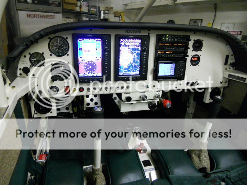

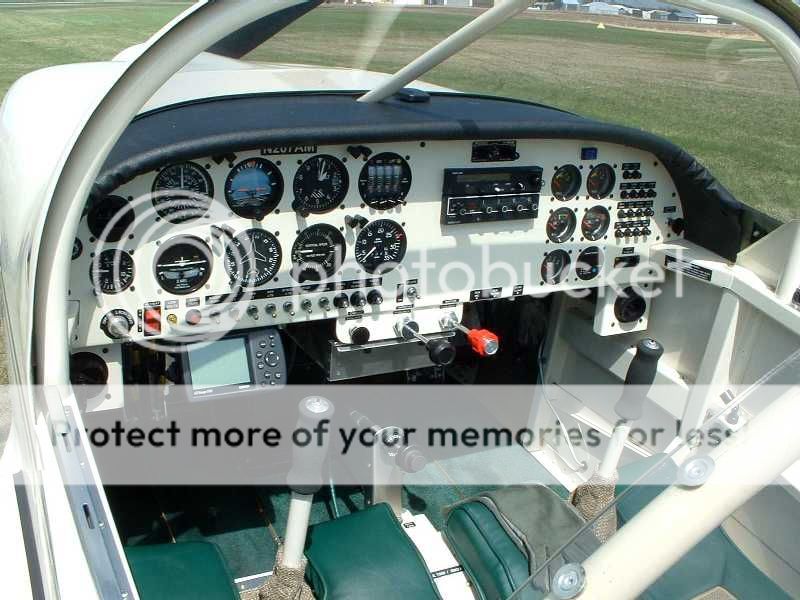

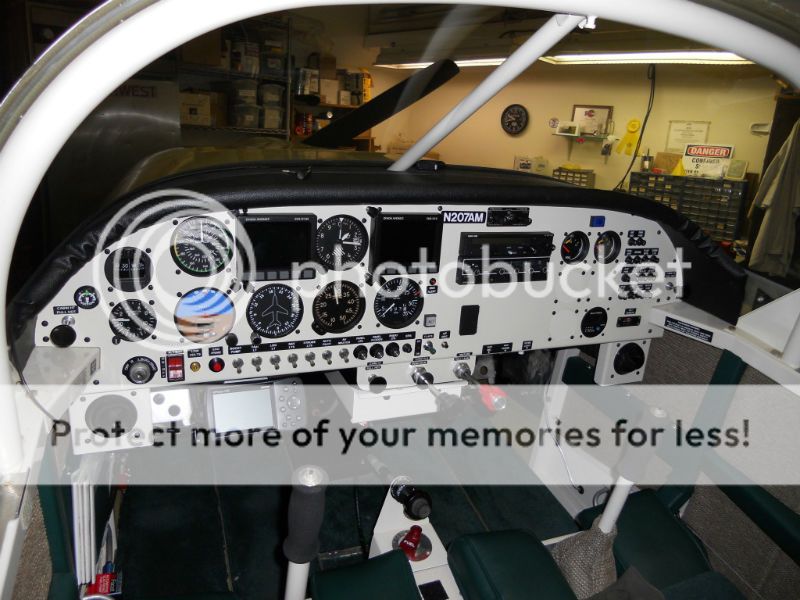

My RV-6 first flew with this panel, in 2000:
Changed it a little in 2010:
Finally built a new panel in June '12:
I guess I'm a little bit more critical now than most re interior layouts as a result of being involved as a passenger in a violent RV6A accident some time back. Your new avionics look great but in upgrading it might have made some sense to consider eliminating a few of those quite sharp corners you have in the vicinity of your knees at the bottom of the panel. We aim for the best, but sometimes it's also good to plan for the worst. ;)

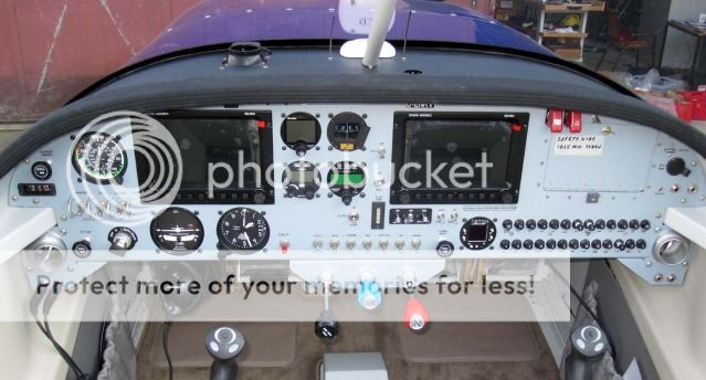

My Panel
I recently finished my panel. I have two 10" SkyView displays, a PS Engineering 8000BT audio panel, Garmin GTN-635 GPS/COMM, and TruTrak Gemini PFD. I'm using the Dynon autopilot and transponder
This is the upper left of the panel. All of the switches here with red boots are only manipulated during startup and shutdown. The other switches should only be used in emergency situations. Separating these switches from the others in the panel means that there is no chance that they will ever be accidentally hit in flight since I have no reason to even put my hand up there on the panel. The Gemini PFD is also right in my line of sight in case I ever need to use it due to a SkyView failure in IMC.
Below the Gemini are a couple of control cables for the alternate air and oil cooler butterfly valve. The alt air cable is red because it's for emergency use only (since it can't be reset from the cockpit). To the right of the control cables are the exterior lights. These are both three position switches.
To the right of the exterior lights are the interior lights (both with dimmers) and the fuel pump and flaps switches. The flaps switch is easily reachable while my hand is on the throttle.
The top of the radio stack has my custom annunciator switches as well as a test button and a dimmer. This dimmer also dims the Gemini PFD screen since it doesn't auto dim.
The engine start switch is near the mixture control which should make starting a little less clumsy. I normally wouldn't have considered putting the engine start switch within reach of the passenger, but the VP-X disables that switch once the engine is running. The parking brake cable is just to the right of the engine controls.
The far right of the panel has the heater controls. There are dimmers for the seat heaters as well as a control cable for the cabin heat.
The top right of the panel has the only two breakers (both pull-able) as well as the Hobbs meter, ELT remote and passenger warning.

Jason and Tassilo, beautiful panels both...BUT, both of you guys have the throttles moved far to the left.
I recently checked a new owner out in his new-to-him -9A and when I showed him the correct way to check controls...all the way right and then forward, the engine revved up, much to our surprise! The pilot's stick hit the throttle smack-dab head on and pushed it forward an inch or more.
Carefully check for this before first flight, guys.

Pierre, the engine control bracket is shifted to the right so that the prop control is centered. The pilot's stick misses the throttle control in all positions.
I painted the panel with Stewart System EkoPoxy paint that I had color matched to the leather I'm using. I used the DecalPro system to label the panel with a clear coat over it.

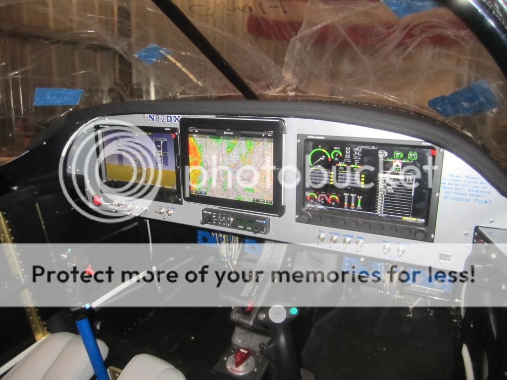

This is the second panel for N941WR. The original is back on page 15 of this thread.
That is a 10" Dynon SkyView on the left, Garmin 496 at the top of the radio stack, Sigtronics 200S and ELT panel under the 496, and iCom A210.
On the right side is a Dynon D1 PocketPanel and below that is the EICommander.
Further to the right is my dual power port and last but not least is the Carbon Monoxide detector.
In the center is a DJM throttle quadrant, which I highly recommend.
The 496 was left in the plane because I knew how it worked and it gives me weather.
Missing from the picture is the transponder. That is now incorporated into the SkyView, thus no panel space is taken up by it.
This has turned out to be a very functional VFR panel and easy to fly with, not to mention easy to make.
