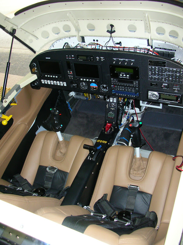

OK, Here's mine
I reassembled the panel today for final fit checking with the finished canopy frame. It will come back apart for painting and decal lettering later. There are a couple of holes to drill yet (heater control and map box lock)
This dual screen IFR panel is squeezed into the standard Van's TU panel without relocating the left support rib. The rib was modified but remains as structurally sound as original.
Since nothing is labeled, here is some description:
Ignition toggles (mags + start) upper left. Starter run-on light.
Dual alternator switches at lower left
Modified endurance bus sys that allows 2 power sheds and avionics bus function, one shed for B/U alt operation (main alt failure) and second for battery only.
Further to the right is nav/strobe/landing and 2 dimmers
The last is the flap switch located above the missing throttle
The fuel pump switch will be to the left of the throttle. Complete, just not shown.
The single master caution light is top center. Messaging will be EIS/H1s
The open instrument hole is for airspeed.
2 USB ports left of the EIS connected to H1s
Audio system is a 2 seat intercom with music and cell jacks on the passenger side and an Aeroelectric Iso amp buried behind the panel. One switch to select COM1 COM2. Simple.
12 volt jack on passenger side connected to battery bus so I can trickle maintain battery through this port.
All Illumination is LED.
Panel will be ivory with black lettering.
And YES I DID SIT IN THE SEAT FOR A WHILE TODAY :D
The fan??
Peter,
Is the fan (edge shown in the picture) to improve the builder experience of sitting in the seat during construction? Blowing you hair back like an open cockpit?????:)

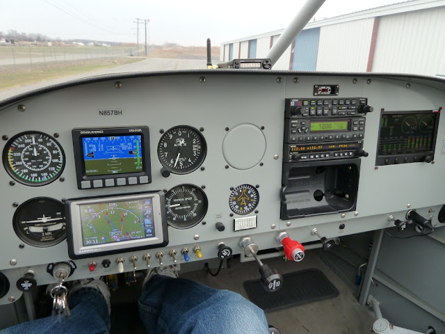

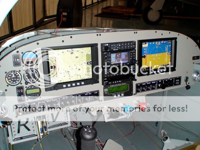

Here's the latest pic of my RV-7 Panel... I just finished up most of the electrical/electronics and am about ready to mount the engine. Everything's going very well and all the components seem to be communicating well with each other.
Very nice, very clean, very good!
Lean mean VFR cruising machine!!! Oh wait, that is an SL-30....swap out VFR and put in IFR, that is if you have the dual AHRS...
Those are the 10" SV's right? Thanks for building that panel, I was wondering how two of them would fit! Add a VP-50 to eliminate the switches and a GNS-430 and I've just built my dream panel!!!
Yes they are, It's a stock panel too. I was worried that the switches wouldn't fit
but no problems. I would love to put a GNS-430 in there, But no more money!
Sully that's awesome. Exactly the switch free clean panel I'm going for. Why the EIS and the VP200. Kind of redunant isn't it?
My attempt at overkill, still trying to fit the TruTrak:D
Have you looked at the flat pack A/P that TruTrack has?? It will fit right over the EFIS screens.
Here is one installed in my plane.
EIS is what gathers engine, and fuel info for the EFIS screens, feeds them the info to be displayed graphically ----Take a look at the photo of my panel above, EIS has lines of digits, EFIS has graphics.
I guess my question is then, why the redudancy. The VP-200 has phenominal capability already... just seems like money better spent on avgas. To each their own, it's a flippin sweet panel.
Mike
That is exactly what I was going to try, it's getting a little tight but I think it will fit there. Thanks for the kind comments the panel has been the most gut wrenching in terms of decision making
My understanding was that I needed the EIS to process the signals from the probes and sensors to feed the VP and EFIS. If not I'll call it redundency for safety, can't admit to the wife that I spent money I shouldn't have;) I will most likely add 2 or 3 switches for back up circuits but otherwise it should stay pretty clean

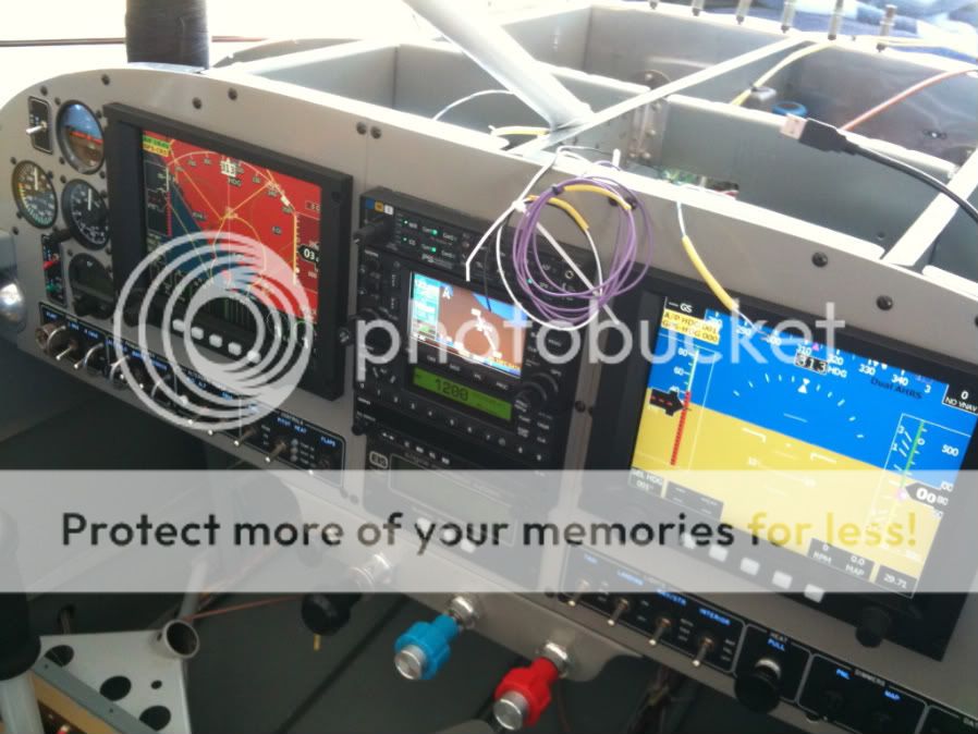

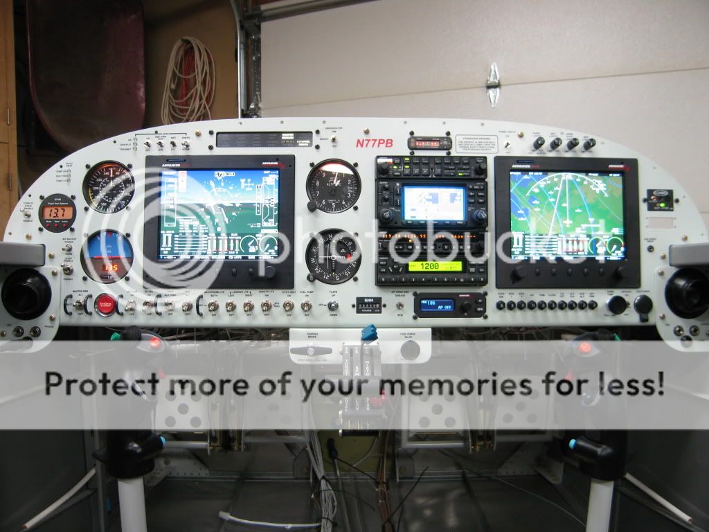

Here's a shot of this evenings progress. I have yet to flip the switch, though. That reminds me, since I did the "heated seats" systems check the other night, I should probably attach the battery charger before going through a full avionics systems ground check.
For the most part, everything turned out Ok. I took a chance and laid out the avionics stack using only the trays, various measurements, pictures, and documentation. For some reason, the PSE-8000B audio panel sticks out an extra 1/8" - oh well. I do not think it is worth the effort to move the tray back an 1/8". Also, I am suspicious that the unit is truly seating as far as it can go. I'm wording if there is an adjustment for that. Other than that, everything else lines up great.
To all you folks who provided feedback and access to your avionics - Thank you!
I flipped the switch
I flipped the switch today, and had an interesting moment.
My EFISes wouldn't boot up due to low voltage and soon after that a faint burning smell could be noticed. My bench 12V supply had decided to quit.
After wiring the battery, the second try was the good one.

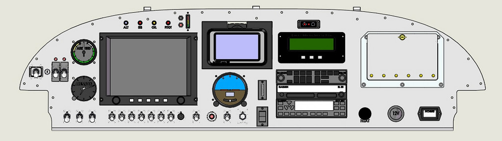

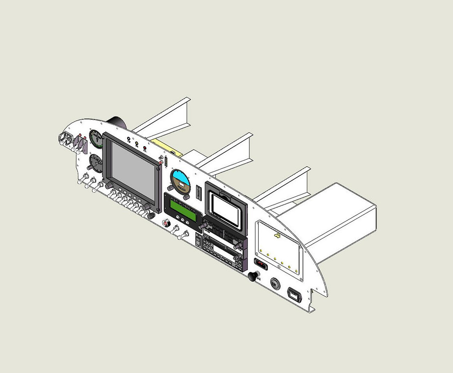

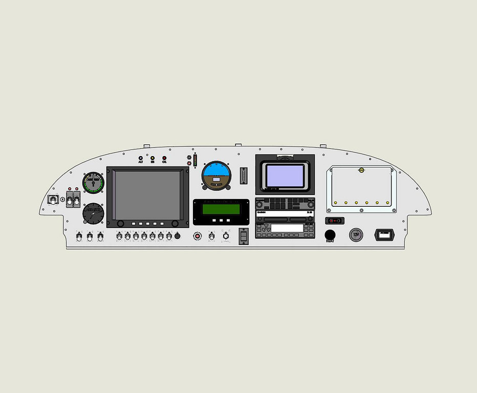

Fun with SolidWorks
Since I use SolidWorks all the time at work, it was a natural for panel design. Except of course that the software is so powerful it lets me do way more modeling than may be strictly necessary to get 'er done.
Here are a few screen shots. My video card isn't the best, apologies for the smudginess. Comments, critiques, random slings and arrows all appreciated!!
Planned equipment (I have most of it now) is
GRT Sport SX, large screen, with EIS
Backup 2.25" altimeter & airspeed
AFS AOA Sport
Trutrak ADI Pilot II
SL30 nav/comm
GTX327 transponder
GMA240 audio panel
Garmin Aera in Airgizmos mount
Lots of switches, still need to work on placards/labeling

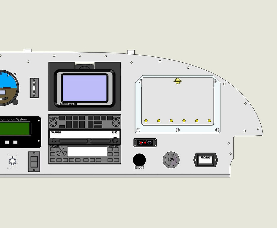

Changes

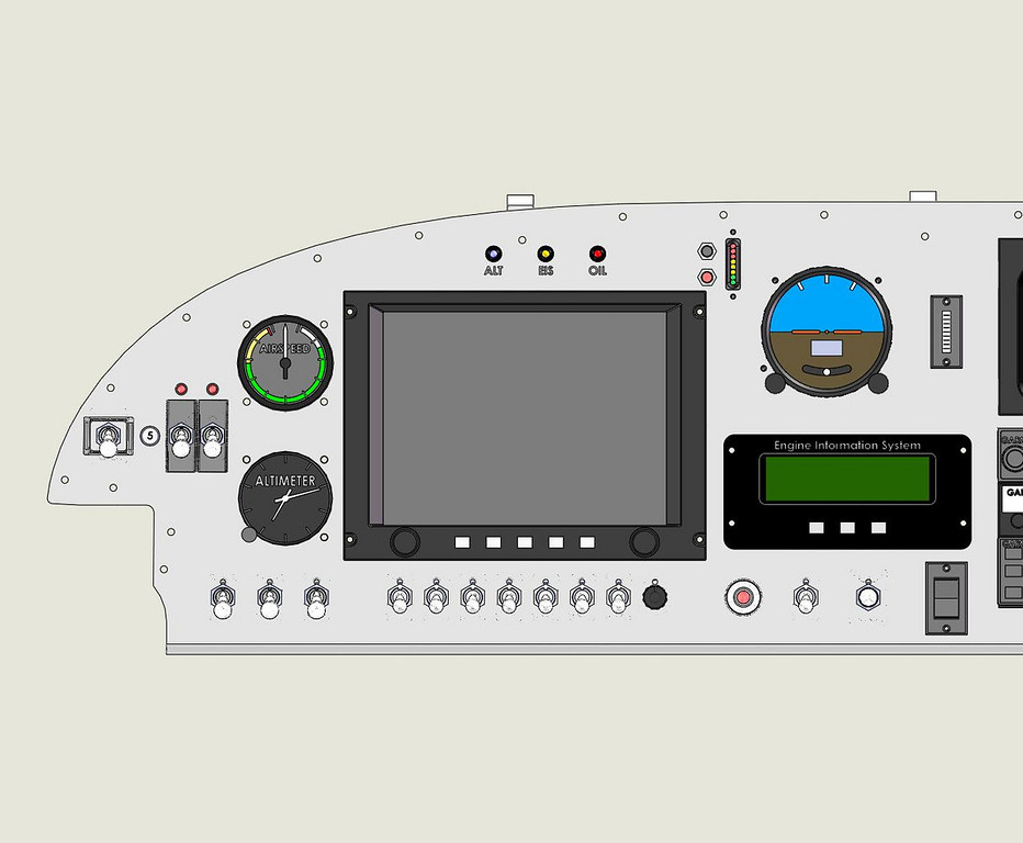

Here are the changes I would make. Your going to want your GPS closer to you, easier to see and operate. I moved mine, after I started flying.
Here's mine:
Helpful information, thanks for that feedback!
That ties in with something I was pondering last night. I don't actually have the Garmin Aera (or the mount) yet (I don't have the Trutrak ADI Pilot II either, but that's on the must-buy list). I do have the GRT Sport SX, SL30, GTX327 and GMA240. The GRT has a built-in GPS and XM weather, so technically the Aera would be redundant.
I am a VFR pilot; I plan to get my instrument rating and will fly the plane IFR, but out west here, for me at least, that means VFR on top of low stratus (fog). I am a certified sissy and will likely not attempt the more manly sort of IFR that y'all in the midwest and back east yawn at. However, there is a lot of complex airspace around here which I have flown in and will continue to fly through regularly.
Sooo... another option might be to delete the Aera altogether and instead go with a second comm radio. Or neither (cheapest) or both (budget busting, but that happened awhile back).
Thoughts?

Lars, the internal GRT gps is really good, in fact, I wish I had a third GRT in my plane, so I could have the map up all the time. And, I have the first generation GRT, so I can only imagine how nice the big screen hi-res units are.
As it is, I have the engine stuff on one screen, and the flight stuff on the other.
I have played around with split screens, dont like it.
I am really glad I have the AvMap for the gps mapping as it is always there, no need to switch it around to see a map.

Moved a few things. This is scary. I can see space for a second comm without giving up the Aera. My bank manager will not be pleased.
Lookin good!
Here is a thought. Move your radio stack up, leave enough room for a SL40 to be added later at the bottom of the stack. Get the wiring harness setup now so all you have to do is slide the radio in if and when you decide to add it. Remember your SL30 has the capability to monitor your stand by freq. So you can listen to two freqs.. I fly from a non-towered airport, in an Alert Area with some MOAs, so I'm on Unicom and monitor Campbell Approach when I'm not on flight following with them. I have a SL30 and I have the wiring harness for the VOR control head, but have not added one yet and might not. If I ever do all I have to do is plug it in. Less money now so you can buy gas for your 40 Phase I.
Thanks Bobby, appreciate the feedback. The layout you recommend is pretty much what I concluded after moving stuff around. Good point too about waiting on radio #2 and saving a few bux. I not only have to get into Phase I, but I have a whole lot of catching up to do before I even begin to consider flying this thing. I had forgotten that the SL30 lets you monitor a second frequency. That removes some urgency. I'm right on the edge of Sacramento Class C airspace, and of course the whole SF bay area airspace is close to the west.
You can buy trays and backplates separate. Build the stack you want with the trays wired up, then buy the radios when finances allow. You will not be digging back behind the panel again.
