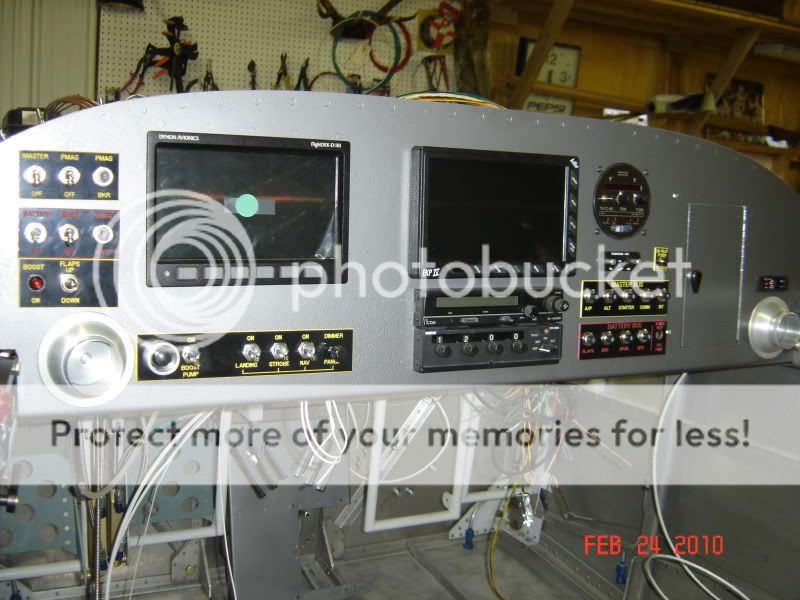

Mine's pretty basic - no-nonsense day/night VFR panel built around a Dynon D180 with some backup steam. I made the modular panel and centre-console myself. The passenger side panel removes independently providing easy access to the fuseblocks. I will also use this panel to mount a GPS when I get one.
Ricks panel
Rick
I dont think you will be able to have your radio stack components come that close to the bottom of the panel, unless you are going with a throttle quadrant. The nutplates and screws that hold the throttle bracket to the bottom of the panel stick up close to 1/2". Unless you rivet...
I like the grouping and colour differentiation of the switches. How deep is the Dynon. It wont hit the tip up hinge will it. I dont think it would be too hard to shorten the map box so it clears the tip up hinge. I wish I had thought of placing it vertically.

I have been flying my new VFR panel for the past 20 hours now and love it. My Lowrance 600C was replaced with a panel mounted Garmin 696. The switch required building up a new panel but it was sure worth it. When I get around to working on an IFR rating the four steam gages will be replaced by a GRT EFIS. Until then my horizon is the earth and the first backup is the electric turn coordinator, second backup is the panel display on the 696 and the final backup is the Tru Track Digiflight II two axis autopilot. The 696 panel mounted front and center is a dream to fly with.

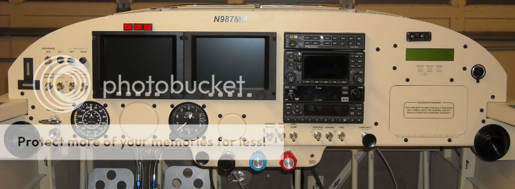

panel critique needed
Here is my panel, designed in Visio. I'd love any comments before I cut metal.
Thi is an IFR panel, based around an AFS-3500EE and a Garmin center stack with GMA 240, GNS 430W, and GTX 327. An ICOM IC-A200 provides the 2nd COM. Backup EFIS is a Dynon D6. The Garmin 496 acts as a mini MFD with XM, and is mounted in a tilty but rigid mount (Angerole) to the left of the AFS.
Not shown are push pull cables under the panel for park brake, carb heat, cabin heat.
I'd especially like any comments about switch placement and switch legends.
If you can't read them, here is a high resolution PDF .
Thanks!

whoa - that is creepy :eek:.... but of course I like it!
If you put the map box that low, won't you have to cut the forward canopy deck a lot?
You are right, it is too low in that picture. I hadn't thought that far ahead yet, thanks.
A couple thoughts on your panel, if you put in a D-10A, then you also get and HSI which would be handy if you are flying on it 'partial panel'. Also, I am planning to get a GNS-420 (comm and gps only), and have the second radio be the nav/comm. That way if the display of the 430 ever dies, I still have the nav to fly with...
Thanks Bob - you can't really tell from the drawing, but I have the start button inside one of those round guards. Also it won't do anything unless only the right mag is on.

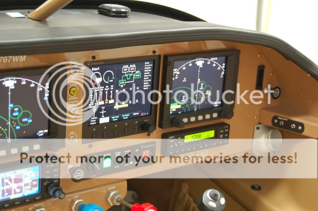

All the holes are finally filled. The 3500's will be upgraded to 4500's soon and the GPS400 will be swapped with a GNS430W when the piggy bank fills back up. An ADI will also replace the clock.
Mike:
Beautiful work! I really like the back-lit switch plates shown elsewhere in this thread. Question about the planned upgrade. I thought the 4500 was equivalent to the Advanced Deck which has a larger form-factor than the 3500. Is this not the case, or can 3500's be upgraded to 4500 processor and software without necessarily going to the larger size unit?

Hi Kliff,
If you look closely you should be able to see the separate aluminum frame from AFS that's around the outside of the 3500 bezel. This allowed me to cut the panel with 4500-sized openings (and with their 4500 tray riveted in place) while using the smaller 3500 screens (actually - I think the display is the same size, but the bezel is larger). Once I'm ready to upgrade I'll send in the 3500's, get the larger 4500's back and slide them in place.
BTW - The 4500 is the same as the Advanced Deck. You can see a pic of the trays attached to the back of my panel here: http://mikesrv9a.com/pictures/electrical/100_2571.jpg

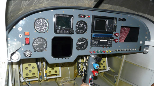

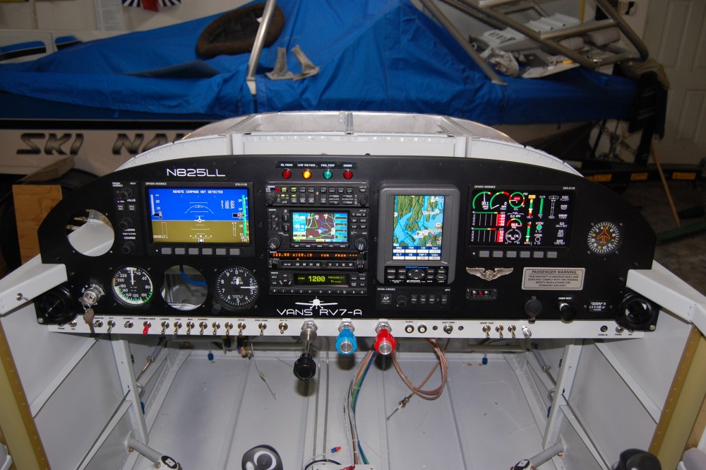

G-HUTY - A Panel is Born!
The panel has still got a lot of growing up to do so thought I'd share my panel layout so far for some validation of my ideas on what I have left to do....
This is the first time I've shown any of my build photos on VAF.
G-HUTY will be an RV-7 with a tip-up canopy and TMX-IO-360M1B built under the UK LAA Permit To Fly regulations.
Panel blank is a hand-made one which is a fraction under 1.5 inches deeper than the Van's standard panel.
LAYOUT:
P1 Left is an ASI & ALT. (Backup instrument are mandatory in the UK.
There?ll be a mandatory compass on top of the glare shield too).
P1 Centre is an AFS AF-3500 with VSI, TT ADI and AFS AF Pilot underneath.
Centre is a Garmin 695 in an AirGizmo with a Garmin 240 Audio Panel under
and throttle, prop and mixture at bottom (yes, I know, in the wrong order in the photo). Controls are fitted flush in the panel rather than setback as in the plans. I've seen plenty of people fit the standard bracket flush rather than setback so am happy with my configuration.
P2 Centre is a hole for the (on order) P2 AF-3500
with COM1, TXPR & COM2 (all from Funkwerks) underneath.
POSITIONS STILL TO BE FINALISED (current thinking):
Switches:
Battery/Alternator Master, AV Master, AUX Bat Master, Autopilot - on the left at bottom of panel below ALT
Starter, Left Mag, EI - to go on the left, beside the ASI/ALT
Lights - P2 centre top above the P2 AF-3500
Flaps ? between AutoPilot and Throttle
Fuel Pump ? between Mixture and COM1
CB's: in rows on the right side of the P2 AF-3500
Annunciator lights: in a row above the P1 AF-3500
Traffic Warning (Monroy): on the left immediately beneath the ALT.
Air Vents: in the standard place as per plans
Headset Jack points: under the air vents.
CONTROL CABLES:
Alternate Air - immediately to the right of the P1 Air Vent
Oil Cooler Vent Shutter - immediately to the left of the P2 Air Vent
Park Brake - farthest left corner
Cabin Heat - farthest right corner
So, there we have it. As you can see, what?s in the photo is already cut so they?re staying put.
But I?m open to amendments on the ?TO BE FINALISED? list.
I would be grateful for any constructive comments.
Steve Hutt
G-HUTY RV-7
West Sussex, UK
looking good.
Steve,
Congrats on the great progress. Keep posting. Some comments:
- To save some space in the panel, you might consider an off-panel location for parking brake and cabin heat. I put the cabin heat and parking brake on the subpanel side bulkhead. See pic. These functions aren't used that much. The location has proven to be good ergonomically, and routing and installation of the cables was easy.
- I'm a fan of keeping all/most of the switches reasonably concentrated in one area, usually a row at the bottom. In your case, you've only got the space at the lower left, so it might mean two smaller rows. Usability is subjective, but this seems to be the typical design pattern for most cockpits. Having the switches concentrated to one area makes it much easier to scan the switches for the expected on/off state.

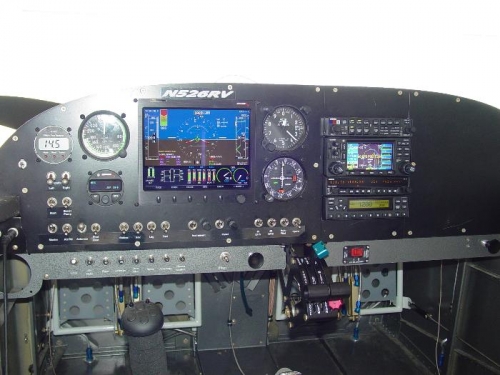

After just over 4 years working on the project, I finally have something suitable to post in this thread:
Dual GRT Sport EFIS's
GRT EIS
PS Engineering 7000B Audio Panel
Garmin 430W GPS/NAV/COM
ICOM A-210 COM
Garmin 327 Transponder.
Steam Altimeter and Airspeed Indicator

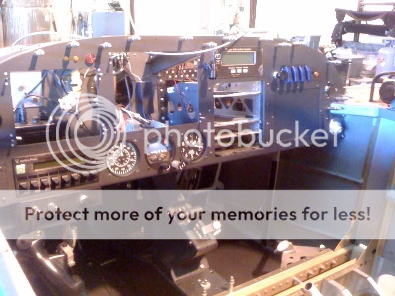

panel planning has reached the cutting phase!
panel planning has reached the cutting phase. layout mock ups are now in CAD and i am ready to drill, cut, file and fit the 696 and vp50 along with the stack... the skyview is backordered so i may hold off finishing until it is in hand.
using the base from vans the actual cutout locations have been coordinated with my plan for mounting. i am very pleased with how closely the vision has translated to hard numbers.

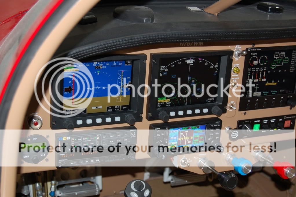

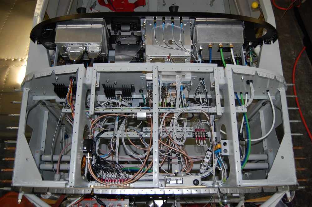

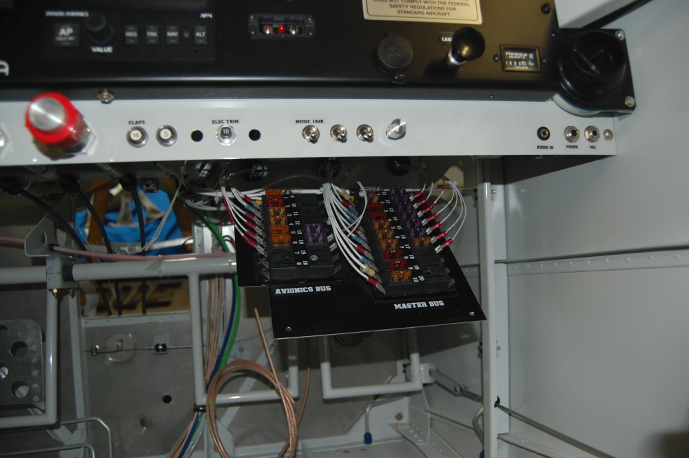

Getting There - Panel Powered Up!
So I told Stein that I wanted a "Day VFR" panel for my RV-7 because all I plan to do is go get pancakes with my RV buddies and this is what he recommended. ...think this is overkill?
We powered it up for the first time yesterday. ...and in all seriousness I have to thank Stein and his team as well as Tom Berge of RV Transitions for all their help in getting this panel to the power up phase! This was a fun day!
- Peter
Wow Peter....all I can say is......
Those Pancakes better come with Genuine Maple Syrup. Stein is a Rock Star.!
Bob
Panel
That looks like a great panel. Did you ask how much more it would have been in IFR? I mean it looks like you have a real good basis already.
I think for IFR you will need to add the back up steam gauges...airspeed, Altimeter, Attitude...:D and make sure they are TSO'd gauges..
seriously though that is a sweat panel.
