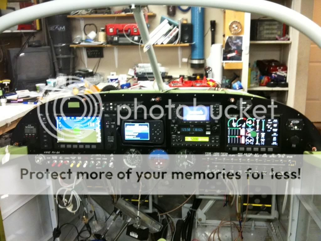

Panel is finally done! I haven't lit it up yet, but that's just around the corner!
The light is VEEERY dim at the end of the tunnel, but I know it's there!
:cool:

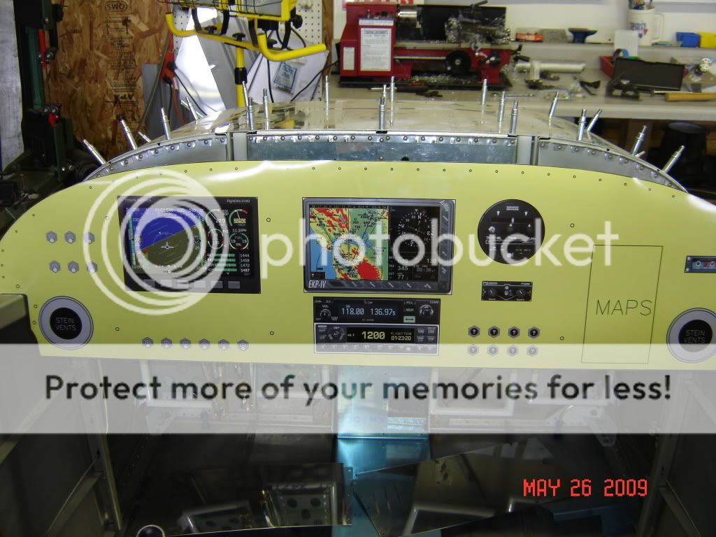

panel looks great!....are yu going with a mapbox or somesuch right hand side...or future efis addition?....been following your moves with interest....the light is getting very bright !!!...rgds stanman!
Hey stanman! Thanks! The right side is for future EFIS expansion...no mapbox. I have side pouches in my interior kit, so I opted not to go with a box in the panel.

What's that thing?

OOC, what's that thing on the lower right, below the panel? A hinged drop down access for fuses?

Bendix av80r in airgizmo, garmin comm to come later, garmin trans and vertical power 50.
New mgl comm with intercom to be installed/used first. If not perfect may add audio panel at a later date.
This gives me two glass panels, plus 2 gps, aoa, synthetic vision, ap, blah blah. Mounting the map box as planned is not easy but it looks doable. I know there are some things to add, but need to know if my plans are looking ok or need major work. Need this for spring 2010, so a fair bit of time to modify.
