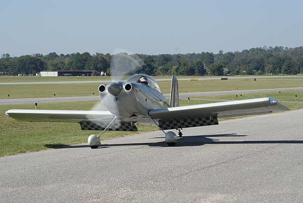

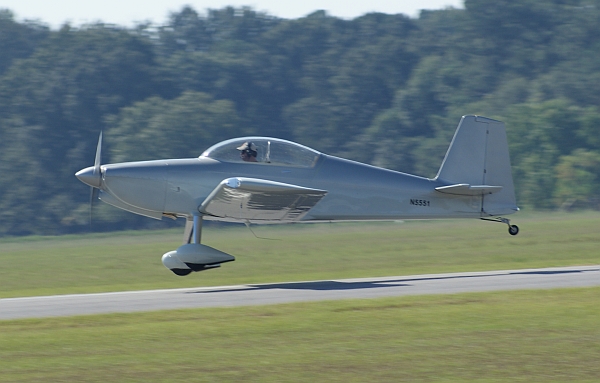

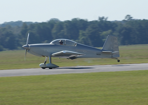

Well, it flies......

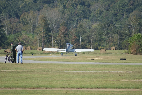

Running checks at the hangar...:
.....take it out and show it the runway:
....gas it.....:
....and a half hour later a genuine gold medal 9.9:
Temperatures and pressures were all very good. It was about 80F on the ground today. Cruising at 24.5/2550, oil was 185F and 78 psi with all CHT's between 298 and 310. A level run at 4.5K using 24.5/2650 indicated 185 knots on both the analog and digital airspeeds. With CHT's that low I'll run a few hours and then start squeezing down the exit area per plan .....me like ;)

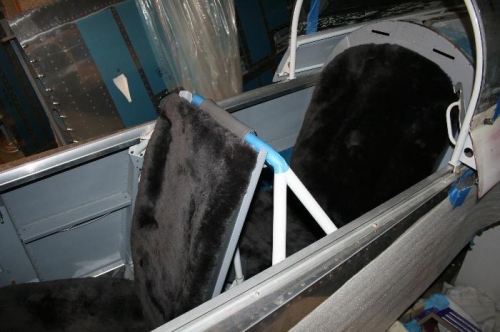

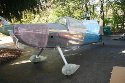

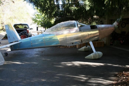

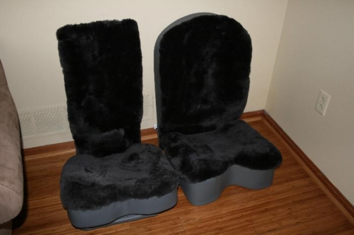

Well in anticipation of having a bunch of folks over to the house for a Fall Party, I stuck the cowl and wheel pants on, layed the floor boards back down, and put the seats and panel back inside so folks could get a look of how it supposed to be when completed - sans wings. Well I couldn't resist rolling it outside and grabbing a couple of photos. Abby had just finished my sheepskin seats - there are SWEET! Thanks Abby at Flight Line Interiors!

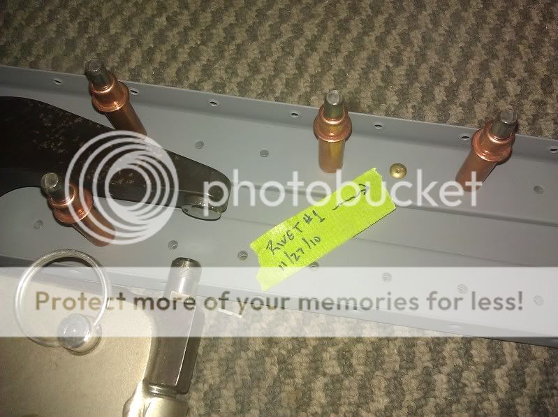

After 6 months of not being able to touch the plane I was proud Saturday to
squeeze the first rivet. A bit later when installing the hinge bearing I realized I had squeezed a few last Spring. The left side is almost done. 20,000+ rivets to go :)
(Wing kit gets ordered this week)
Doug,
Way to go! That rivet looks very airworthy. Repeat as necessary and soon you will have a plane.:D

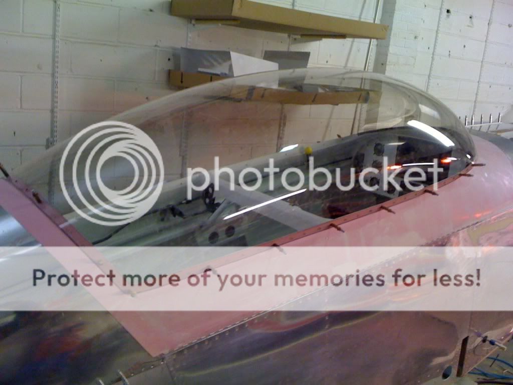

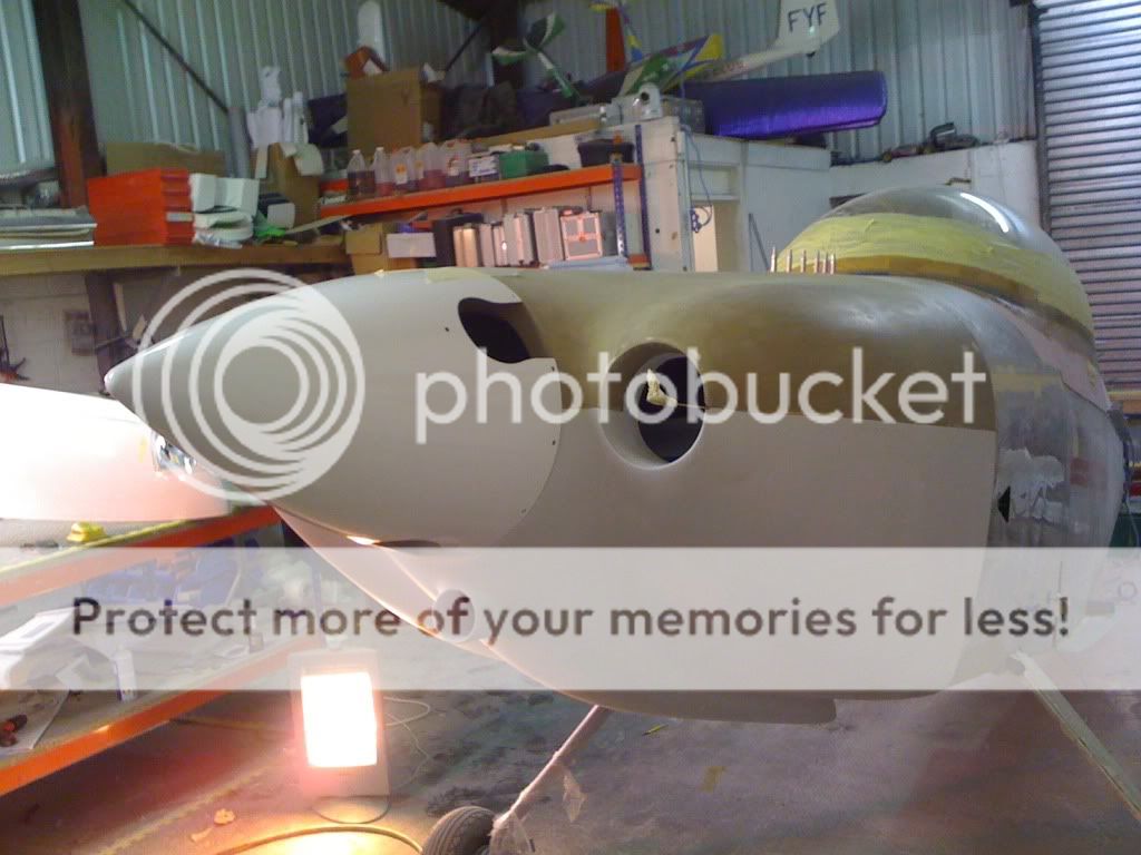

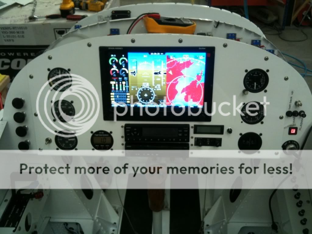

New on here, From England and building an RV8 with the showplanes Fastback and cowl with Grove Streamlined legs. I have loads of pictures of progress but as I am new on here it wont let me add atachments :(
Still gives me time to go through all pages on this thread!
Dave
Photo links seem to be working Dave - just have to copy and paste the img tag lines from your Photobucket account.
