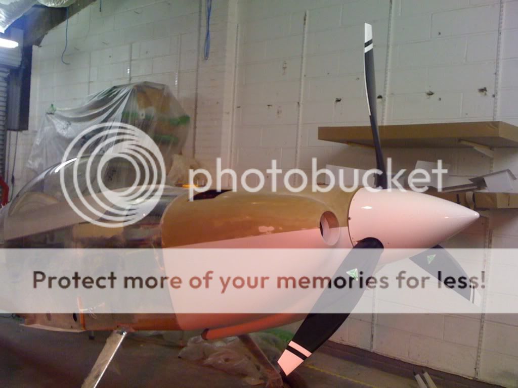

I took delivery of this kit in June this year, and have been working on it full time + since then! prop went on today (MT 3 blade C/S) and will be running the engine up later in the week.

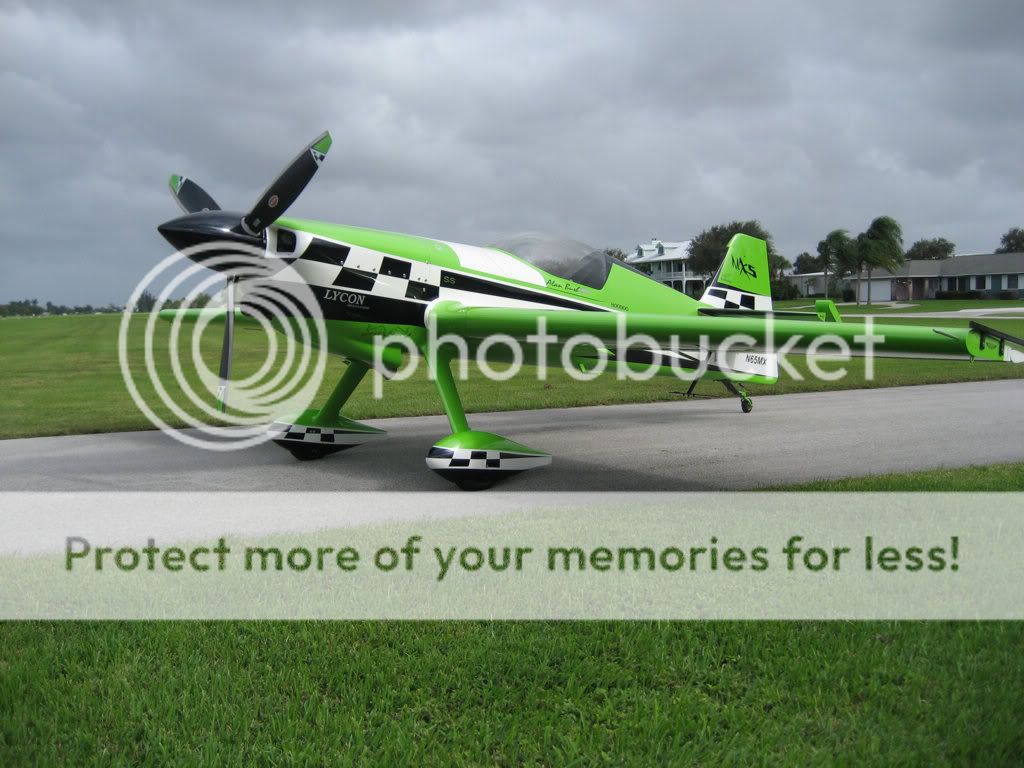

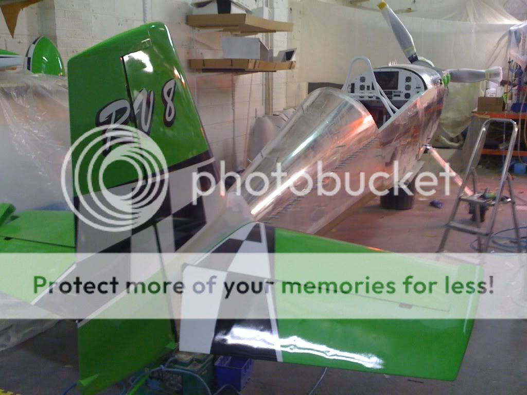

i am going for this scheme. I am no painter, and my workshops a bit dusty, I am fine with base coat but as the clear coat takes a while to dry it picks up dust. I just make sure i put a good coat of clear on and i will (eventualy) 1200 and polish the entire plane to ger rid of the dust.

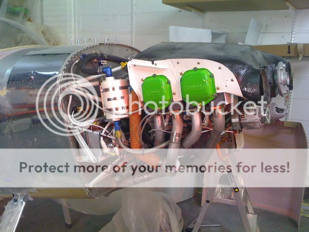

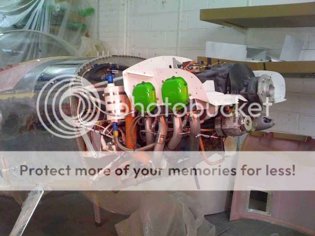

Wow that paint job is going to be awesome. I was looking at your pic of the engine without the cowl and I noticed you are using some kind of flexible material for the front baffle that goes right behind the spinner. What kind of material is that? My engine has a prop gov accessory port right there which results in a ugly baffle mess. I would love to copy that design. Also, could you post some detailed pics of your inverted oil tank mount setup. I am going to mount my tank in the exact same place on my -3.

Either way... awesome! Before I saw the MX, I new the paint scheme. Giles 202, MX2, MXS. Love watching the Red Bull races and seeing the light weight MX come through the gates.

Rob, I built my own Carbon Plenum, the flexible stuff is standard Vans baffle used to help seal the carbon onto the engine
The Invert tank is held onto the engin mount with Adel "P" Clips
Dave
Dave, might want to consider some sort of attach point for the top front center area of the plenum (where you have the circular rubber sheet seal). Rmember, with good recovery the plenum pressure is about 136 lbs/sq ft at 200 knots. The plenum lid will bow upward if it can.
The engine is mounted as standard, not canted.
Dan, i moulded a return lip on the piece of cowl that goes over the crankshaft, with the intention of putting a strap around the crankshaft housing. i just have not quite sussed out how to implement it yet!

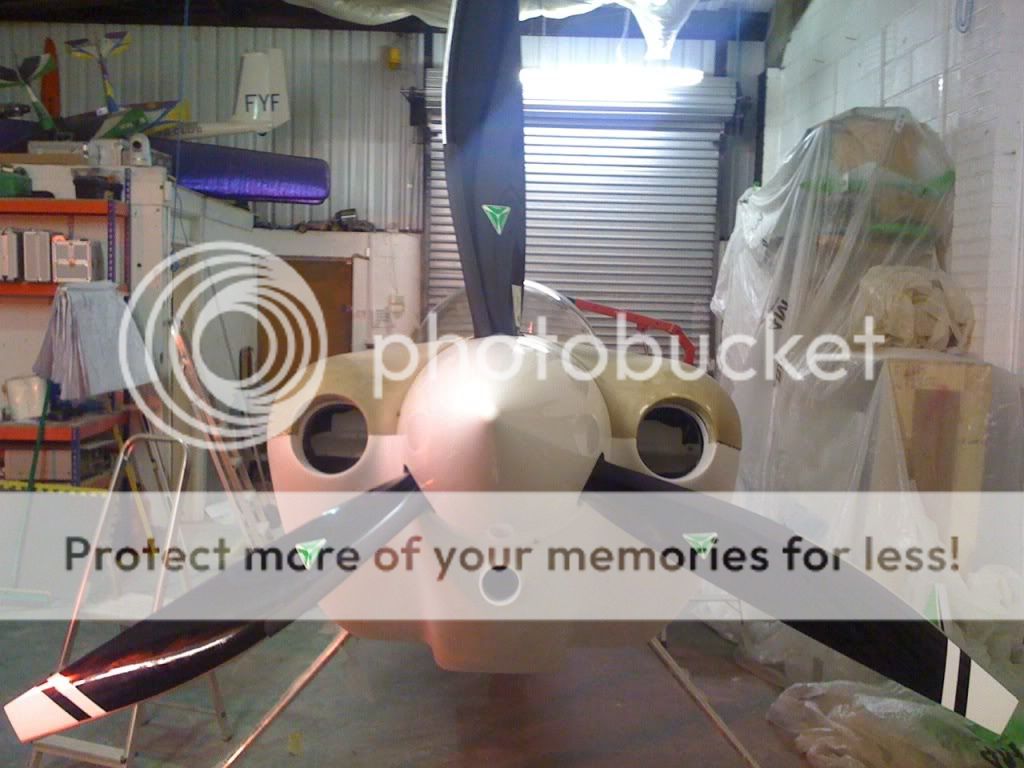

the cowl is from Showplanes
Dave
Dave: The raw cowl has round intakes as for a plenum but the painted aircraft has more conventional intakes that are not round. Is this a different cowl? Is the plenum still in use? Bill

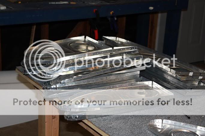

So tonight, I once again started to deburr wing ribs.

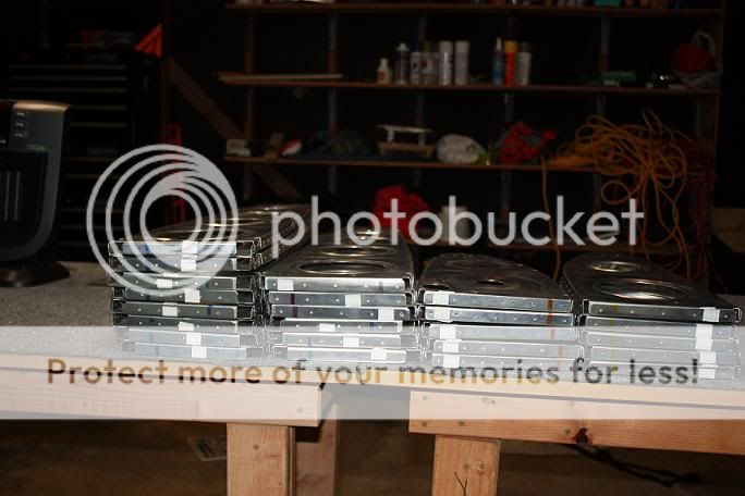

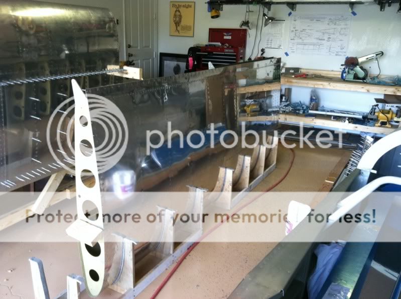

Well after about 7 months of starting the wing rib deburr/fluting process, i'm done. Who needs a quickbuild.... :p

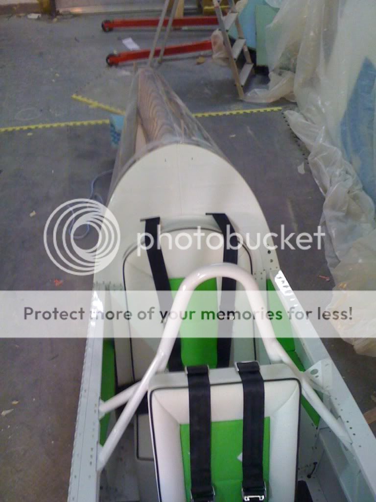

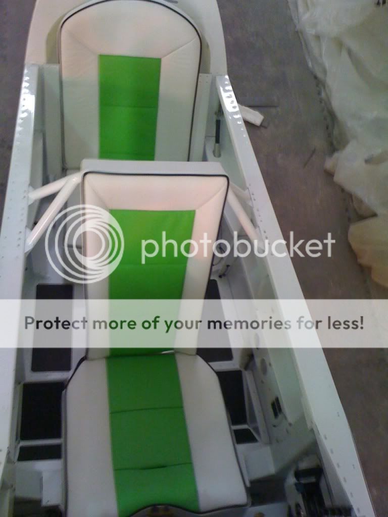

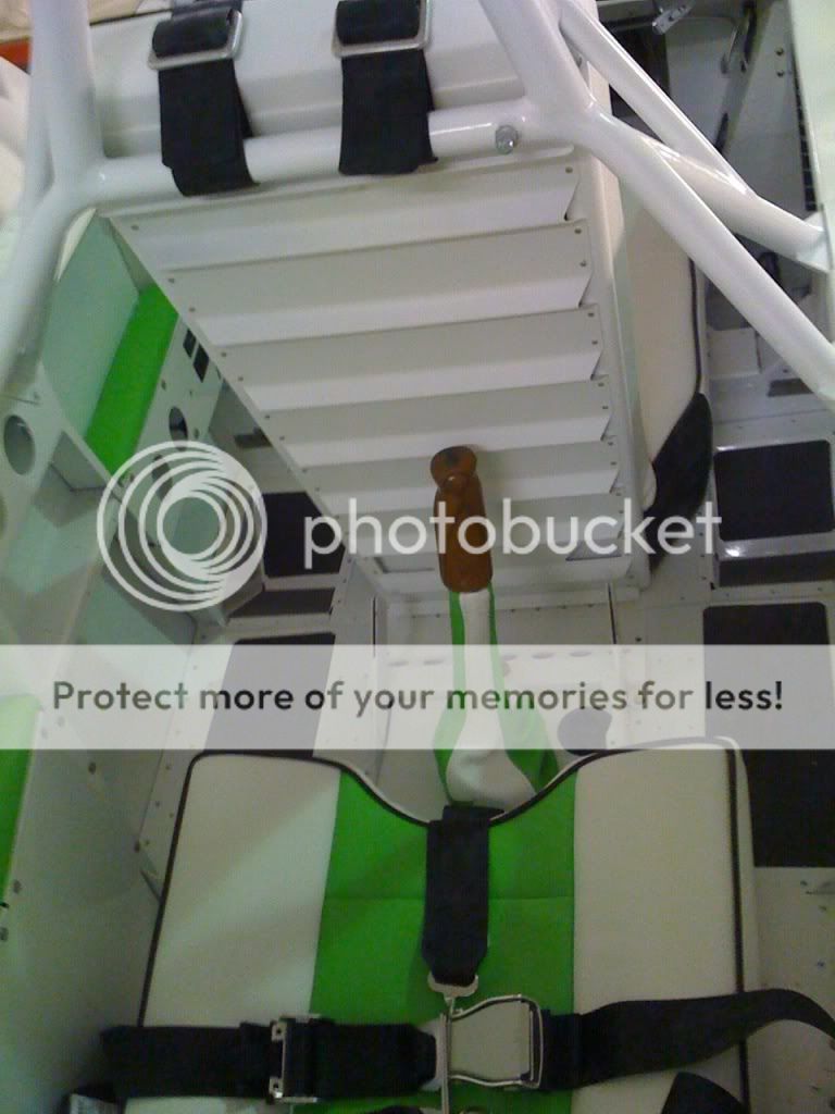

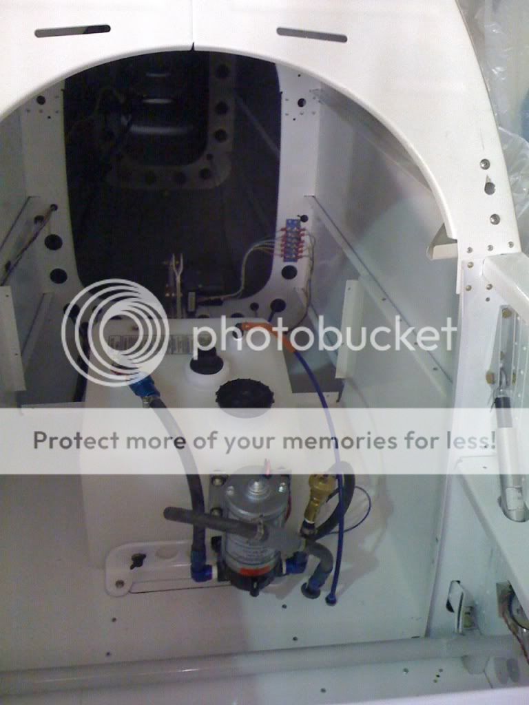

Finished my roll bar and did some more to the interior. Hopfully I will run the engine next week if the snow clears. I also fitted the exellent Smokin Airplanes Smoke System. I fitted it in the rear Baggage for CG reasons (my Batt is on firewall) and run a 3/8 Ali pipe to the bulkhead where i fitted an Andair One way valve (used the plastic one that comes with it at the tank) and fitted the twin injector kit

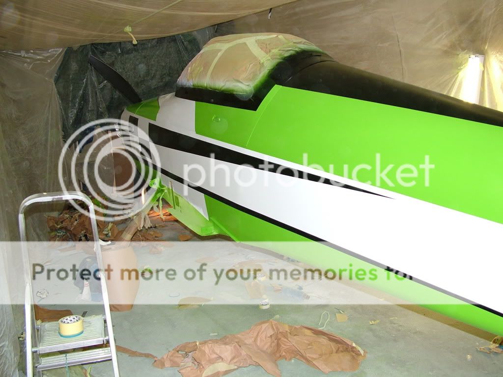

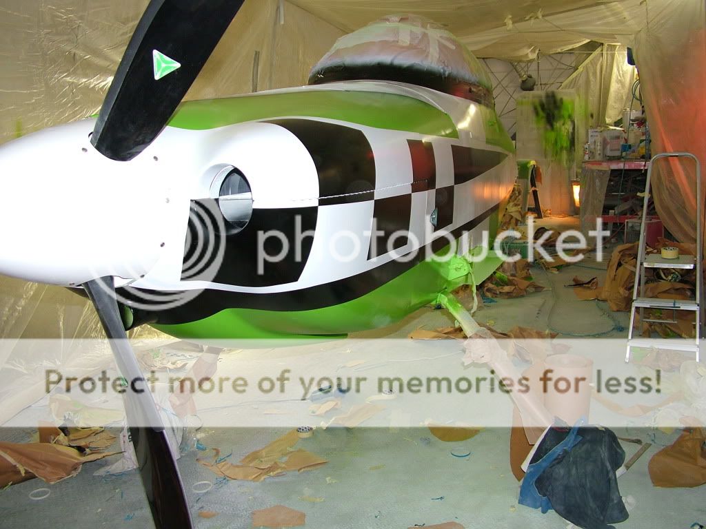

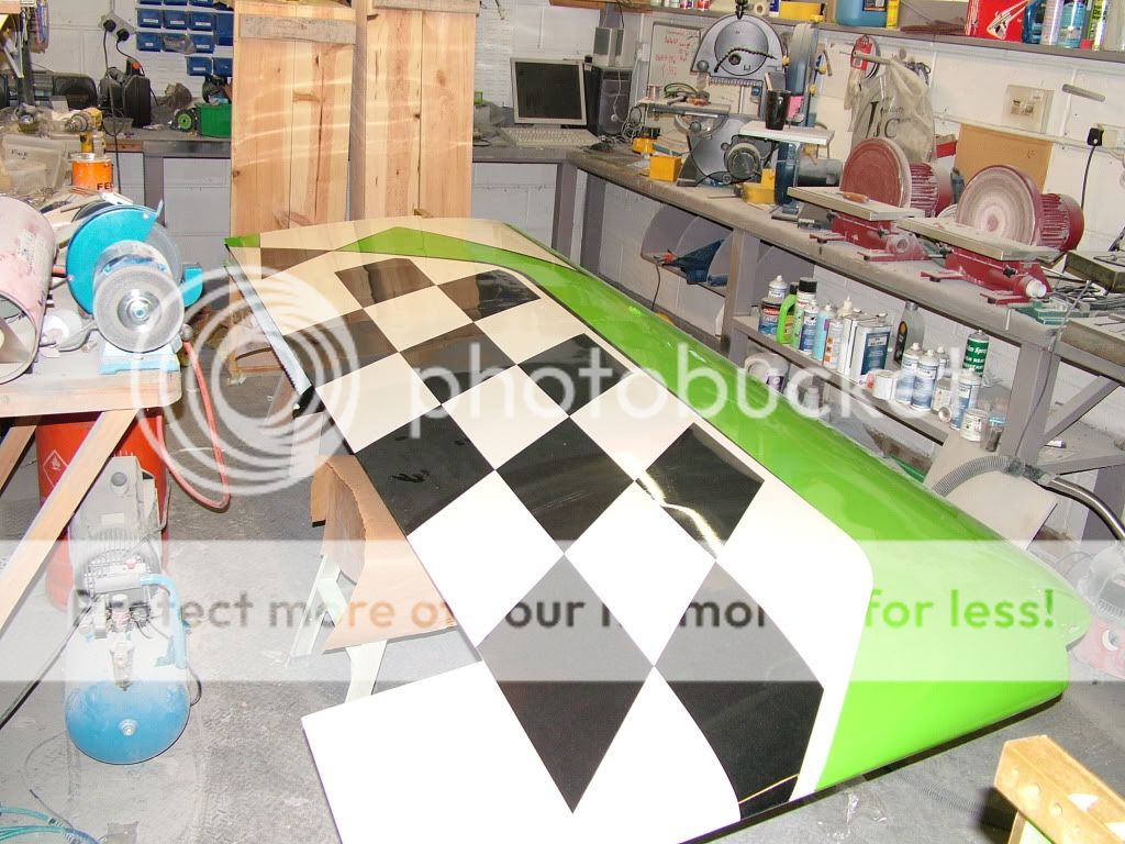

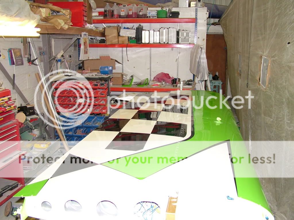

I have been beavering away! fingers are very sore from all the masking (why did i chose this scheme!!)
I have clear coated the wings, Fuse is still in base coat at the moment

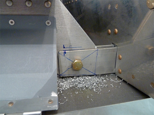

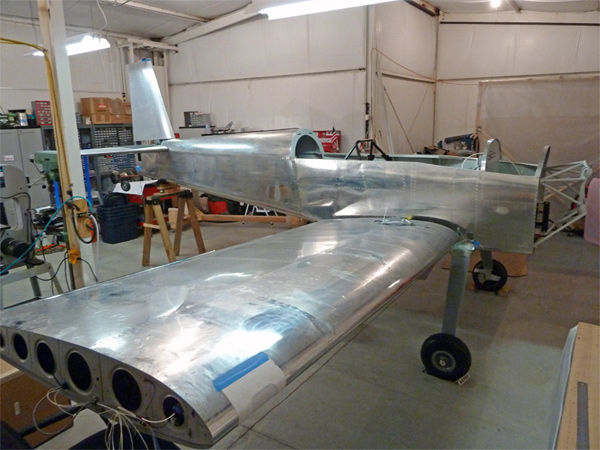

My wings are on, with the help of fellow homebuilders Tom, Chris, Luke and Eric. Everything went as well as I could have possibly hoped.
One of the aft spar bolts, installed. The result of a day's work, and lots of careful measuring and fussing:

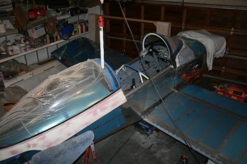

Canopy

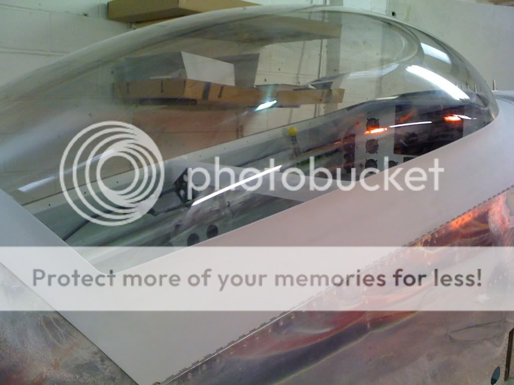

Foster,
This is a tinted canopy from Todd's Canopy,the skirt from Van's did not fit.My buddy Jerry,who is building a plastic airplane (Cozy) showed me how to build the skirt. Find a local plastic plane builder,their knowledge is invalueable.I painted it insignia blue.

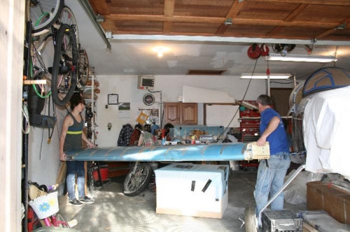

Last night me and the family put the wings on the RV-8 (temporarily) . I thought it would be fun to make it a family affair. My youngest, Mary who is 6, was the 'photo journalist'; Syndey, 11, had hole line up duty in the cockpit (I helped); Mitchell, 15, had heavy lifting along with me and Mom. It all came out pretty good in the end and it's was exciting for everyone to see it in this 'new' form.
I have yet to drill the rear spar so this is only a partial victory. More to come...
