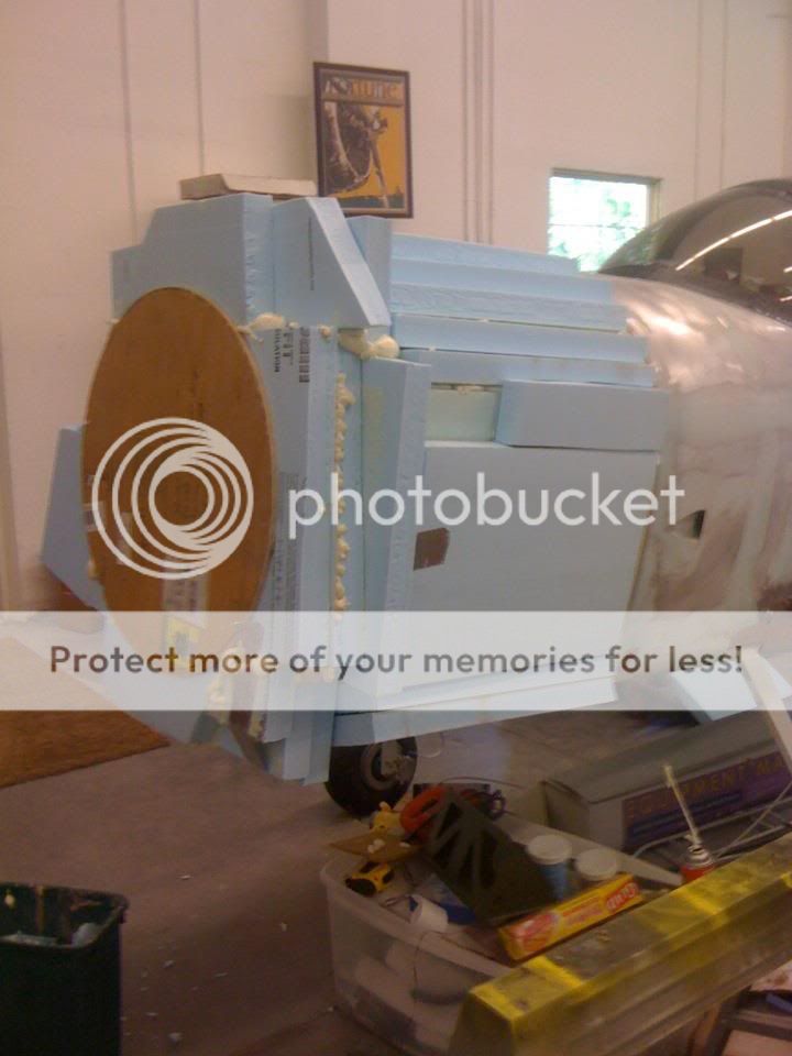

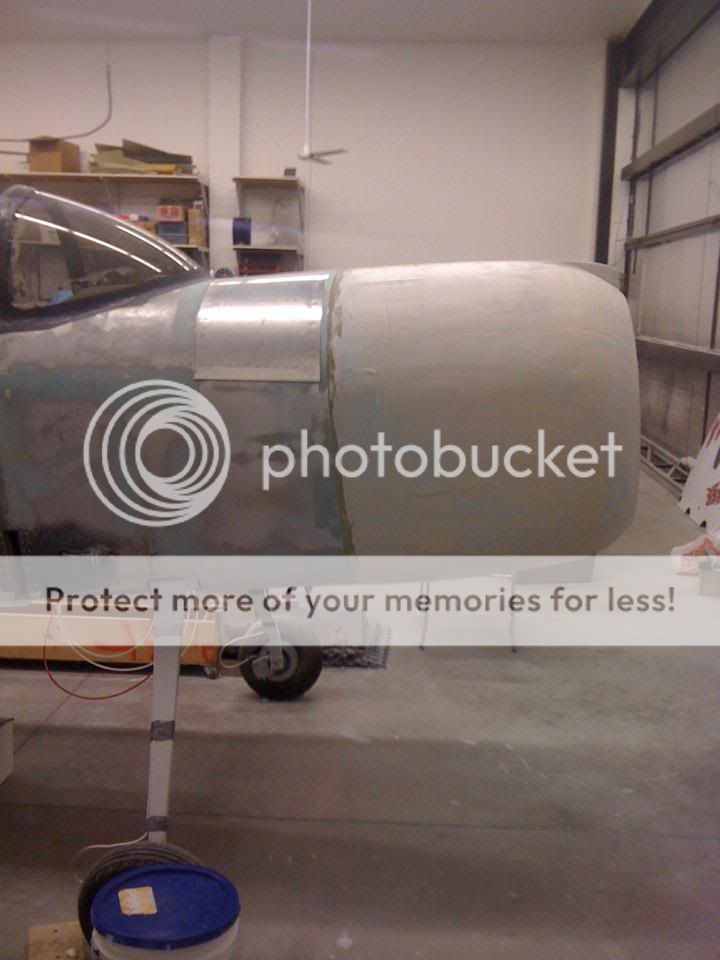

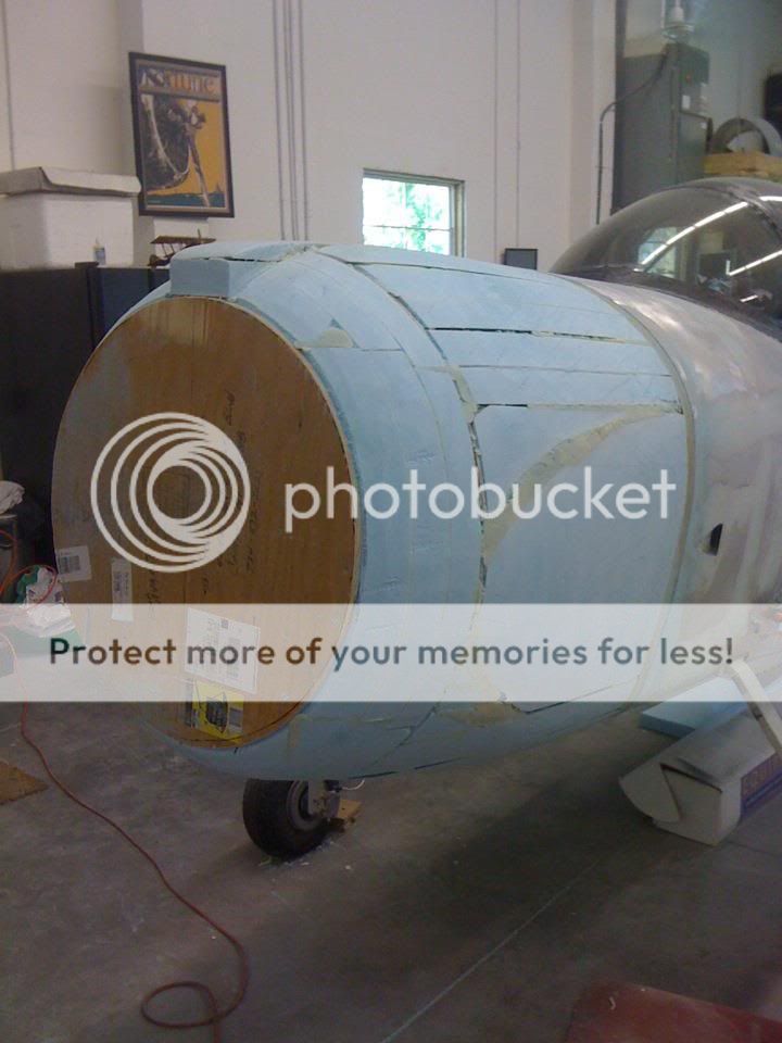

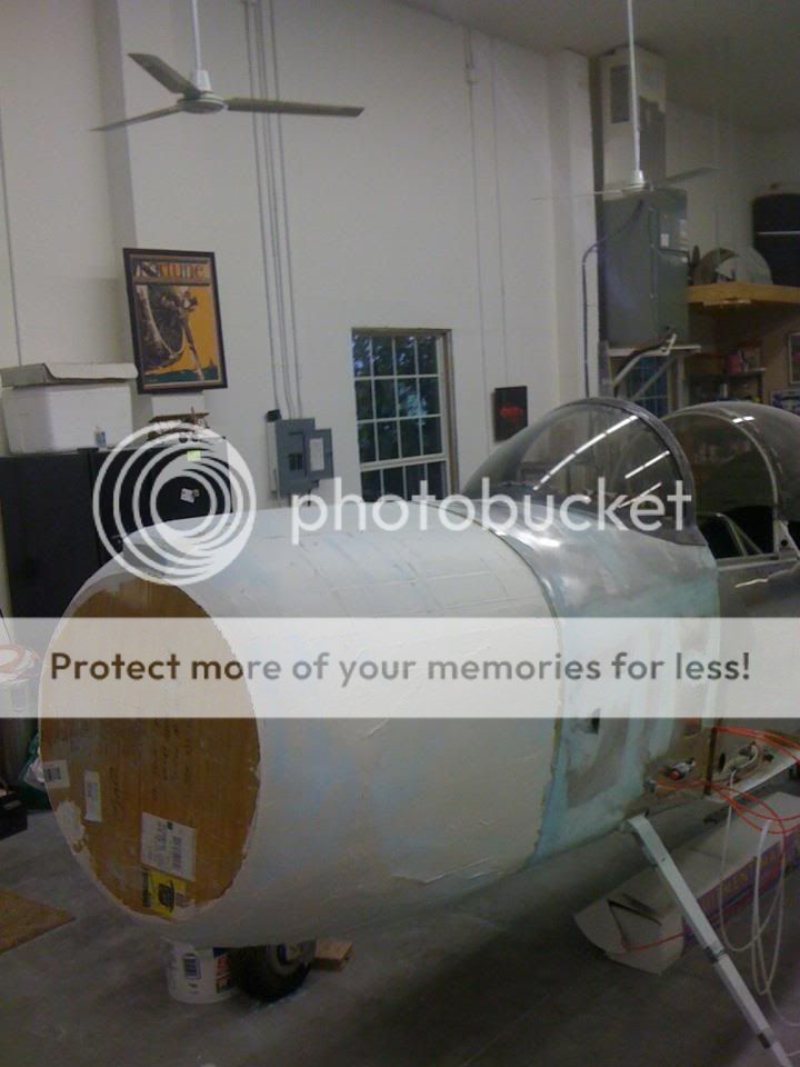

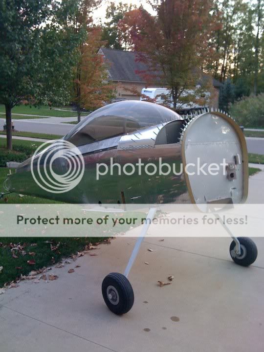

Instroducing the RV-8R
This is my project 6 years in the making to this point. So far the emp, wings, and most of the fuse is done. I'm currently working on the fiberglass components. The engine is a Rotec R-3600 9 cylinder radial engine.

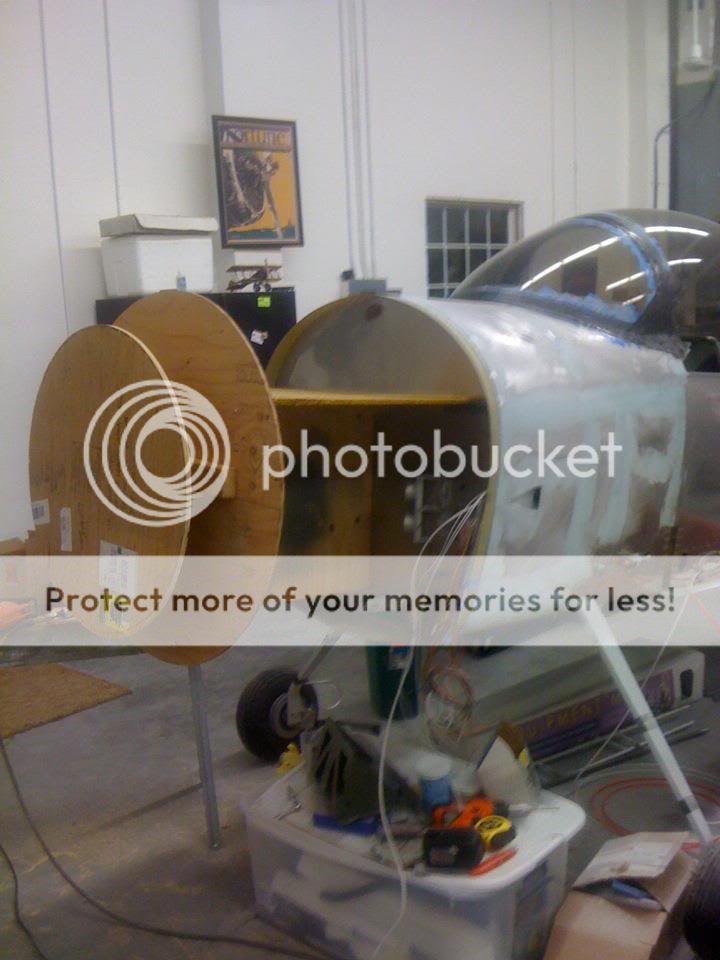

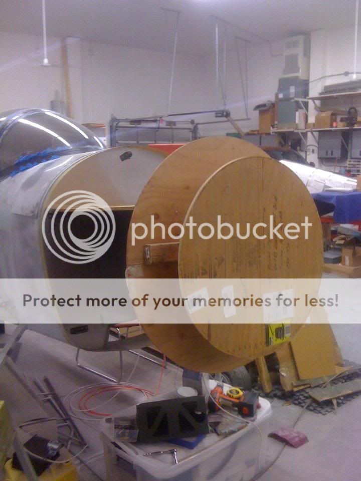

Mods to the fuse to fit the engine include a new top to the firewall, a new intermediate bulkhead between the firewall and instrument panel, a new top skin, new stainless tunnel and bottom skins, and a new cowling. As you can see in the pictures I am currently working on the cowling.
I will be producing a conversion kit for the RV-8 in the future, and will post updates as I get them. In the meantime enjoy the pictures and Message me with any questions you may have.

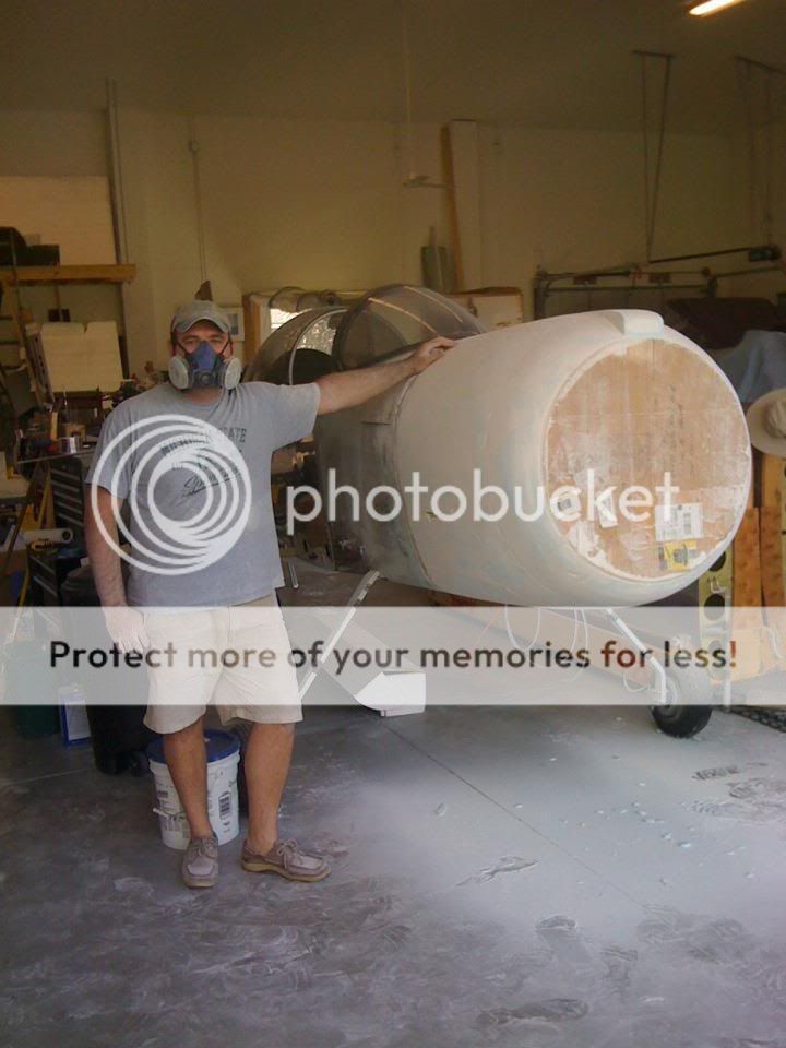

Some advice from somebody who has done a couple of plugs like the one for your cowling: Don't scrimp on the fiberglass skin for the plug. Go with six or eight layers of 9oz cloth or so. If necessary, sand the foam down a bit further to allow for the extra thickness of glass (about .011" per ply). Also, use an even mix of 0-90 and 45-45 fibers. Once you have a nice thick-skinned plug, then worry about fine contours and surface finish.
The reason to use such a thick skin is to keep the exterior surface smooth while the stuff inside it (the styrofoam and spray foam and wood) tries to change shape and shrink and grow. It doesn't change shape much, but when it does the different materials will all do it at different rates, giving what we came to know as the "Michelin Man effect."
If you make a nice smooth, well-fitting plug, you'll get a nice smooth mold, and that mold will yield parts you'll be proud of. Email me offline if you need any help. Experience is what you get when you don't get what you wanted, and I have lots of composites experience.

How on earth did you get such an even and symetrical result just by doing it by hand.
That is a GREAT job.
That is exceptional crafting
Thank you to everyone....
For the kind comments. This has been a fun process and I can't wait to get her in the air. The cowling symmetry came from hours of careful carving and sanding as well as some templates. Bob, I'll definately take your advise (btw your glider project is really awesome!). I believe this is the essence of homebuilding and I want to thank DR for a wonderful platform in which to share this project with the world.

The prop disk area in front of the cowl does produce thrust, assuming the prop designer found it possible (a structural issue) to maintain an efficient airfoil near the root. However, a dig in the NACA archive will turn up a detail.
Typical prop design assumes propeller disk inflow will be uniform across the whole of the disk. However, with a radial cowl the inflow near the center is something like 70% of freestream velocity, with the percentage rising as you move outward along the blade span. So, a really well done prop for a radial needs to tweaked for less pitch near the root, rising to "normal" pitch near the cowl diameter and hence all points outboard.
There's no tip speed issue at 7 feet or more because of the R3600's 2400 propshaft RPM at redline. However, I'm guessing three blades because of landing gear length.
Brian, Don Bates was good enough to modify his Prop Optimizer Pro software for radial cowl inflow when I was working on a biplane project. If you want to buy a copy of the program I'm sure he could tweak the code for you too.
