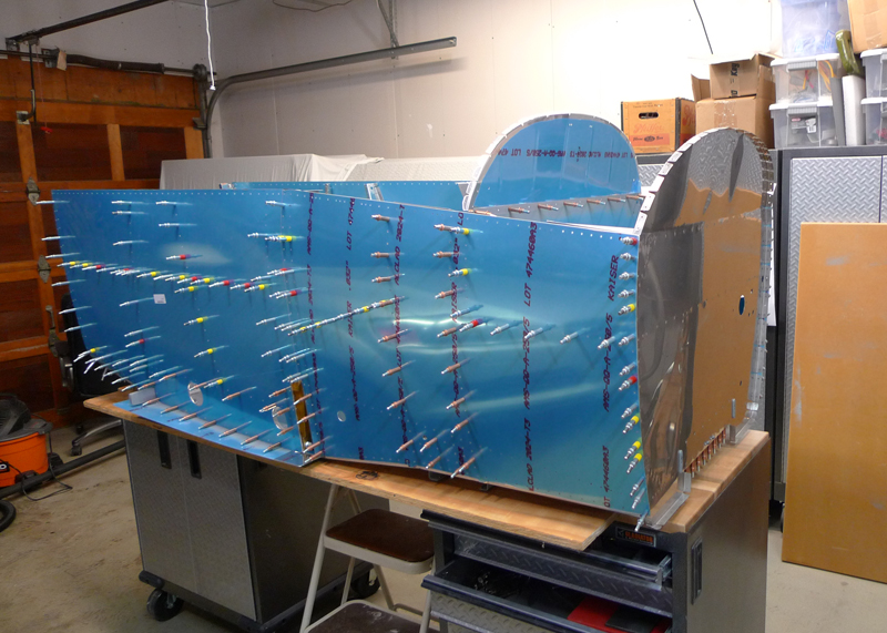

.. got the left horizontal stabilizer skin clecoed on to the skeleton tonight! It looks like airplane parts! :D I was surprised that it took a little bit (not a lot) of "grunt work" to get it all aligned and clecoed into place, but everything appears to be straight as an arrow.
Hey - it's minor - but it's been a learning journey thus far. :)

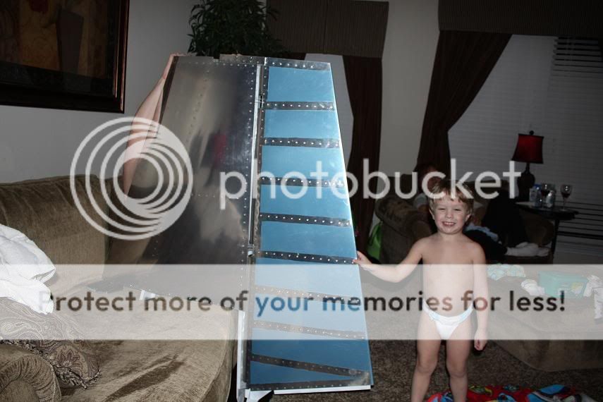

Wings are done
I finally declare the wings done. It only took 15 months. I think this qualifies as slow build. Tanya hefted her end as we hauled them upstairs where they will be stored for the rest of our build.
Yikes!
I assume you are married to Tanya, and that Tanya is a pilot. I can't even IMAGINE the conversation I would have with MY wife (Who loves me very much by the way.)
-Dkb
<chuckle> Uh, yeah. It helps that this isn't her first rodeo either. When we built the -9A, they were stored in the (small) living room within arms distance of the couch, coffee table, and TV. When it came time to buy a new house, she knew precisely the kinds of square footage we needed for the garage and house so that didn't happen again. She still declares it was totally worth it when we're on a long X/C leg at 15000', sucking on O2, A/P engaged, XM radio in the ears, eating a sandwich and some grapes, watching the ground go by. Oh, she prefers to warm her sandwich on the black glare shield for a few minutes, I like mine cold out of the cooler.

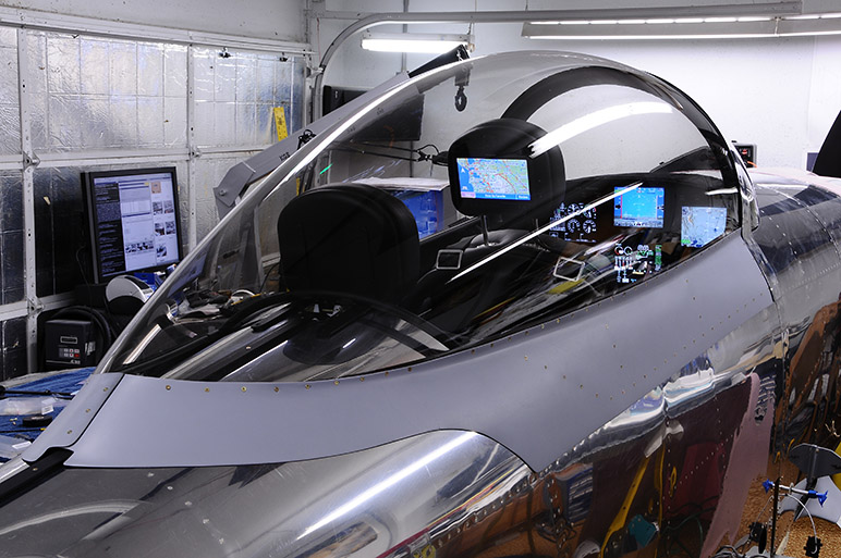

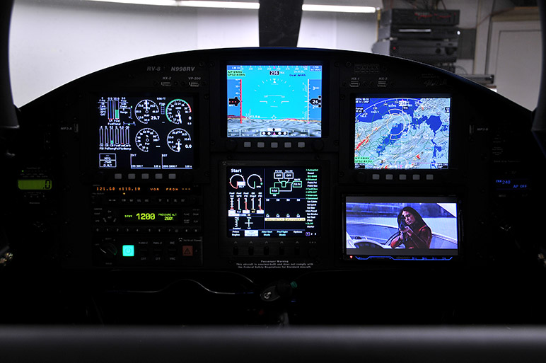

Matt Dralle's RV-8 Project Status 03/06/2010 (Part 1)
Well, I pulled the 'ol RV-8 project out of the shop yesterday to take a couple of pictures of the current status. That got me to thinking that I should probably post a couple of pictures here. Let me know if you have any questions. There's lots more pictures here: http://www.mattsrv8.com
Best regards,
Matt Dralle
RV-8 #82880 N998RV
http://www.mattsrv8.com Matts Construction Blog

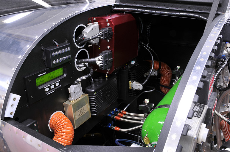

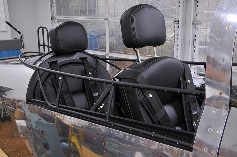

Finishing Up...
2010.01.01 - RV-8 - Front & Rear Throttle Quadrant Installation Complete (2).jpg
2010.01.01 - RV-8 - Front & Rear Throttle Quadrant Installation Complete (3).jpg
2010.01.01 - RV-8 - Oxygen System - EDS O2D2 Pulse Demand Unit Final Installation (2).jpg
