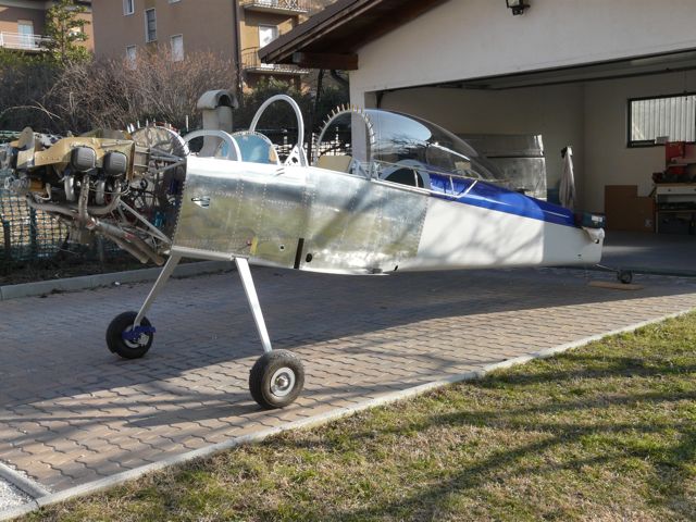

DAR coming on the 10th
By cdwambolt, shot with KODAK DX7440 ZOOM DIGITAL CAMERA at 2009-01-31
That is one good looking plane :eek: Can you post more pics?
Joe, my guess is the Show Planes cowling.
Look at the size of the spinner, and the straight line of the cowl top.
IIRC, the SP cowl is set up for a 15" spinner. And a 4 cyl engine needs a prop spacer-------the crank flange is not visible in the photo either.
Yes, it is the Showplanes cowl, and it does require a 2.5" spacer for a 4 cyl. We have an MT and they actually build the hub to your spec up to 6" longer, so not a third party spacer, but a custom hub. No extra charge from MT BTW. The canopy is from Todds canopies, I think he called the tint "titanium". The plane was painted by Drew Brothers Customs, a muscle car/ hot rod shop here in Chandler, AZ. I will post more pix when I have time to take some better ones. There is a shot of the panel in "show us your panels" and an artist rendering in the Poster Child thread. Oh yeah, there is a rollbar with the Showplanes kit, not installed in these pics. Thanks for the positive comments, we really are proud of her, the pics don't do her justice!
Yes, I was thinking SP cowl based on that HUGE hole in the front :)
Charlie, as far as the canopy goes, did you have any trouble/extra work fitting it to the SP frame? I say extra because I know there is a bit of work involved. But, and it may just be the pics, but the "bubble" looks higher/larger than the stock canopy. I've been thinking about Todd's and different tints lately, so thanks for the hints!
Joe
You have a keen eye. Todd was experimenting with a different profile to lengthen the nose of the canopy a bit for improved aerodynamics for RV8's and it resulted in what you see here. The showplanes kit uses the standard bubble with the back cut off. The high point of the bubble isn't any higher (had a stock canopy originally--had a little accident and got to redo it), but it is forward of the stock profile, which I like because now the highest point is right above my head, whereas the stock ones highest point was midway between the front and rear seats, which didn't benefit anyone. It definitely has a unique look, but I like it. I'm sure Todd can make it for you if you like.
HA! Keen eye or obsessive, compulsive internet research? I'll let you decide:D:eek:
I'm pretty tall, so I like the idea of the high point over my head, but I have to ask, does the SP roll bar have to be modified so as not to touch?
Also, I assume the bottom flange is similar to Van's since it still meets the basic opening of an RV-8...so no problems fitting the SP fiberglass frame?
