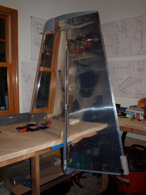

Flipped my Canoe!
From this morning:
To this afternoon:
Spent the rest of the day leveling the plane and getting ready for a right-side-up world! Woohoo

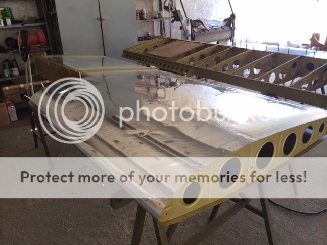

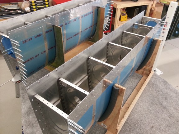

Tanks
Yea! I have two leak free tanks. I know it's no big deal but to me it rates as a pretty big accomplishment.
Stupid phone won't give me a vertical pic from Tiny Pic. Sorry
Larry, congrats! I'm going to be finishing up the sealing and leak testing on mine soon, hope they go well.
tanks
They will be fine. After this I think I stressed way too much over them. Watch the four corners of the baffle where it mates to the inboard and outboard ribs. I actually built that area up a bit when I installed the ribs so the baffle wohld have some proseal to seal against.
Keep us posted.
I think mine are just leaking around the access plates. I put the cork gaskets in there -- obviously not enough. I'll pull them apart, use tank sealant to seal it up good and try again. The first time around I had to seal up one of the rear baffle corners, but found no leaky rivets anywhere.

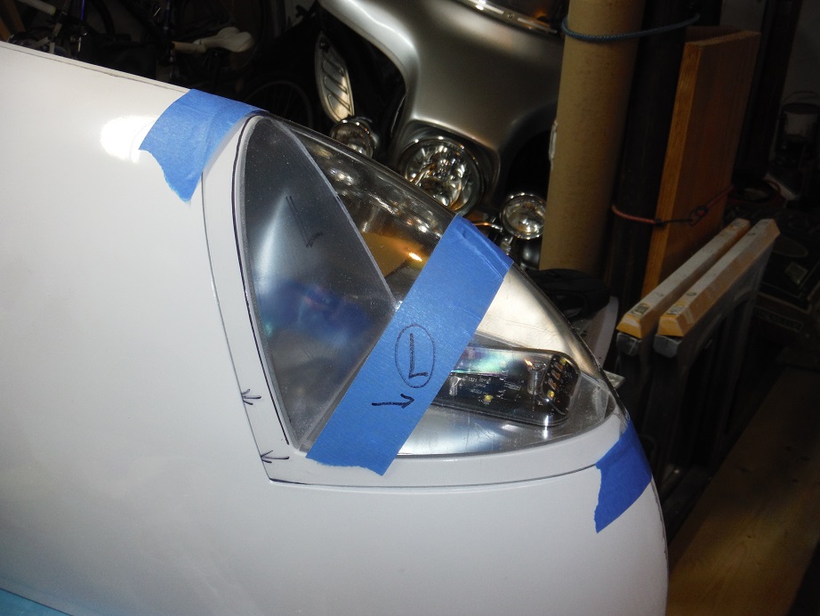

Last night I did the wingtip lenses, tonight I cut out mirror acrylic for my wingtip cutouts to go behind my Ztron Labs LED nav/strobe lights. Cutting and finishing the acrylic was not nearly as difficult as I thought, and I didn't create any unintended scrap along the way. Hence, I think I have enough 1/8" mirror acrylic stock left over for 3 more sets. I'll probably use some for another project.
This pic looks less than spectacular because I still have the protective plastic film on the acrylic. Tomorrow night I'll finish and polish the edges and see about securing the plastic to the wingtips with some nut plates and #6 screws.

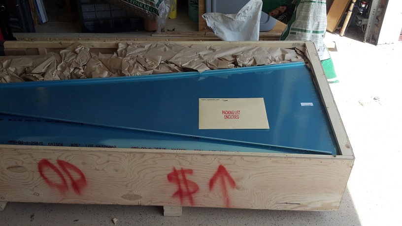

I moved the wings to my storage unit last night, and this came off the truck today:
This is actually the very first Van's kit crate I have ever unpacked. I'm running a special on brown packing paper, come and get it.

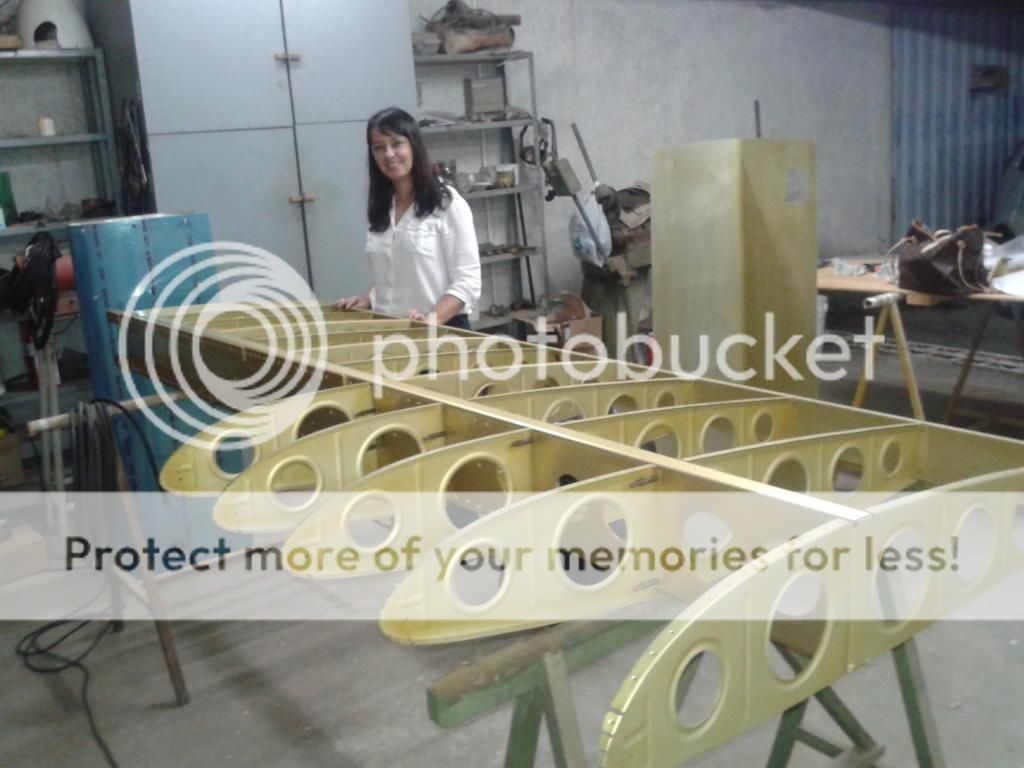

Lucy has wings
Finally. Lucy has wings. I had so many life interruptions. It feels so good to see these done. Sorry I couldn't get the image rotated correctly.
