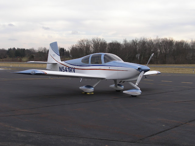

N541RV is complete and flying
8 yrs later.... 40176 has been transformed into a flying machine.
Bob Newman
TCW Technologies
Very nice, Bob.
Q: Did the DAR give you any grief over the placement of the lower of the two Garmin radios? Technically it's too low to meet the ifr TSO without a remote annunciator.
N541RV
Thanks for all the complements, I certainly have enjoyed every aspect of this project, from the build to the technical layout and ergonomics to now the flying.
The DAR had no issue with the dual gns-430s, (however, all info on the 430's is avialable on the EFIS screens) he was incredibly picky on everything else (which was fine), his favorite nit to pick was ensuring the ELT antenna was installed per the TSO, which included drilling the only hole that now existis in the top of the plane!! For all of you that got away with putting the elt under the tail fairing, congratulations! after a lot of research and arguing it was a battle I couldn't win.

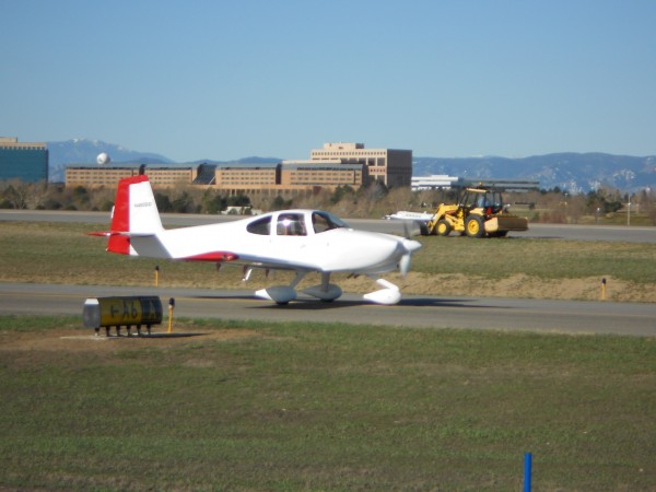

Yesterday on a warm and sunny Denver morning, N400DD took her maiden steps into the air after 4 years and 5 months and 2750 man-hours of building. Short flight due to very high CHTs, but it flew nonetheless. Can't wait for more!
Dwight
Looks fantastic! Congratulations on a beautiful bird. I see the old rv grin is in full blaze :D Keep us posted on those CHT's...

And, tell us about the prop, and blocked cooling air intake.
Congrats
Dwight,
Congratulations on first flight. Maybe the high CHTs had something to do with the cooling plugs?? I think the consenses is that it is better to limit the exit than to limit the intake. But I think the CHTs are easily fixed because the RV10 is well proven. Thanks for adding another tick mark to the meter.
Ellipse, AC
The prop is an Elippse prop, designed by the late Paul Lippse. Haven't had enough time to gauge how well it's going to work.
I have a Flightline AC compressor up front, which moves the alternator to the other side of the engine using a big, beefy bracket. That bracket plus the two belt tension pulleys (one each side) and the belts block the air inlets quite a bit. So, I decided to try a non-standard inlet layout hoping it would not make a significant difference, or that I could offset the airflow loss with other improvements. It blocked a lot more flow than I originally envisioned when I made that decision, and when it was going together for the last time I was thinking "duh, why did I do that?!" I pretty much knew it wasn't going to work, but since it was done, I gave it a go. I'm halfway finished with modifying it again to take the covers off, and we'll see how that does. May end up having to do something more drastic to get more airflow, we'll see.
