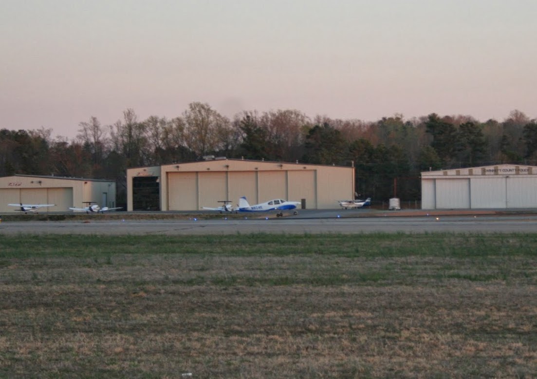

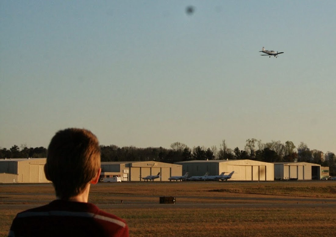

Plane ready to go.
sw6ptuOO7_ioVED0kl8ib4-EuhrJ6zWr3jvKlesH7zc=w1102-h779-no
In the Air!
J-86HQAMouVT_HwHAY3U07xDBhNdZ03U2SShJhjBmHI=w1103-h779-no
Landing
Taxiing back in with the RV-Grin
And since I did not have a chance to go on an aerial deer hunting photoshoot the deer came to visit me just after landing.
Hopefully will get 1 or 2 more flights in this week before going on vacation. Hope to have my 40 hrs (39.3 left) flown off by the end of April.
