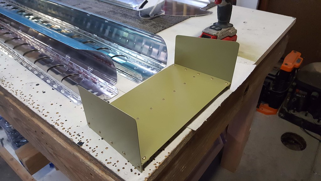

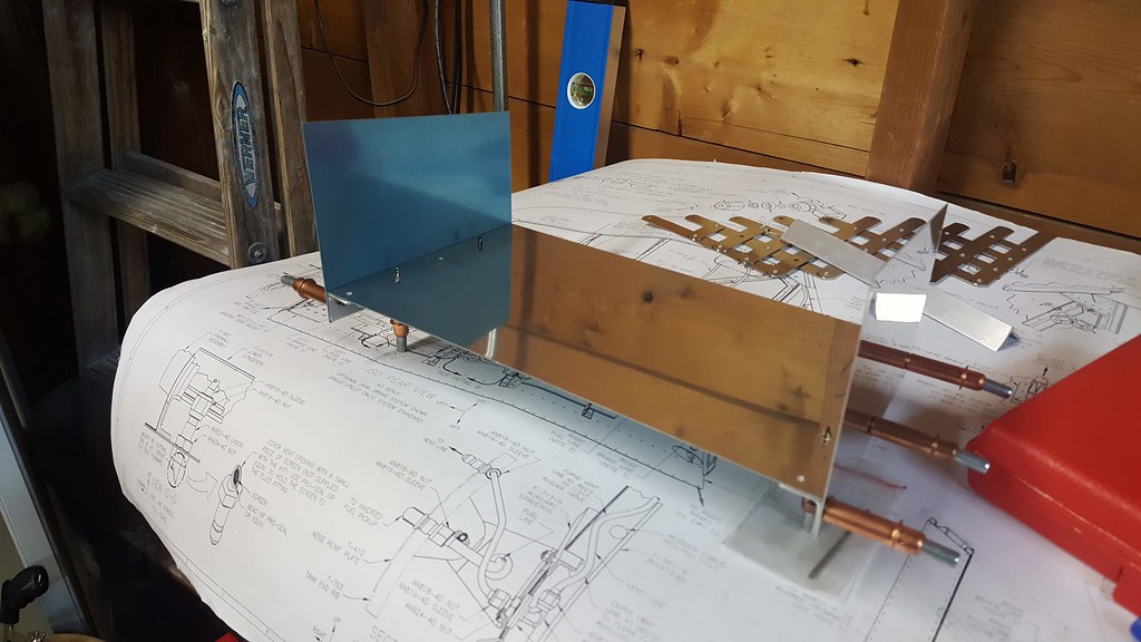

Started fabricating the mount for the ADAHRS unit.
20181008_194240 (1) by Jereme Carne, on Flickr

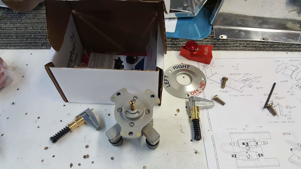

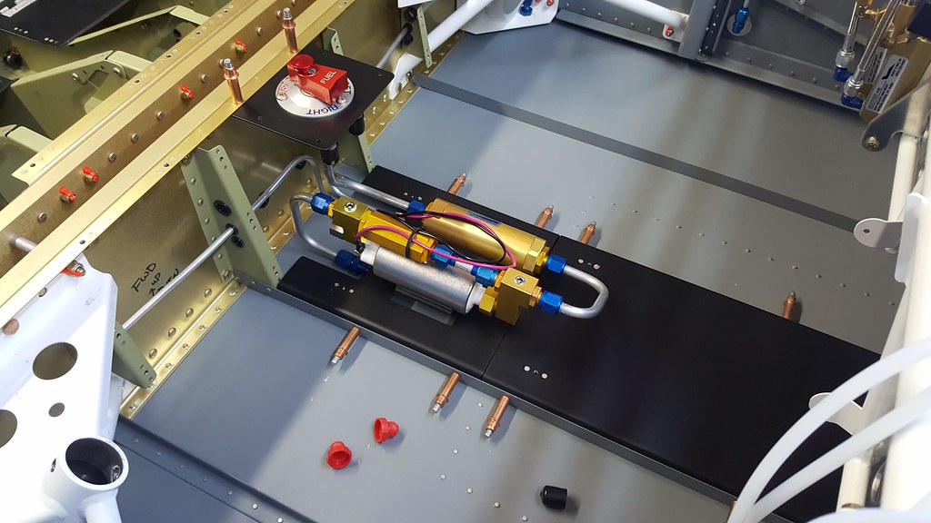

Riveted nutplates to the fuel valve and finally got the right screws shipped in, I didn't want the look of AN3 bolts here.
20181010_182448 by Jereme Carne, on Flickr

Test fitting all the fuel lines I ordered from Tom S. Great guy to deal with!
20181021_141157 by Jereme Carne, on Flickr

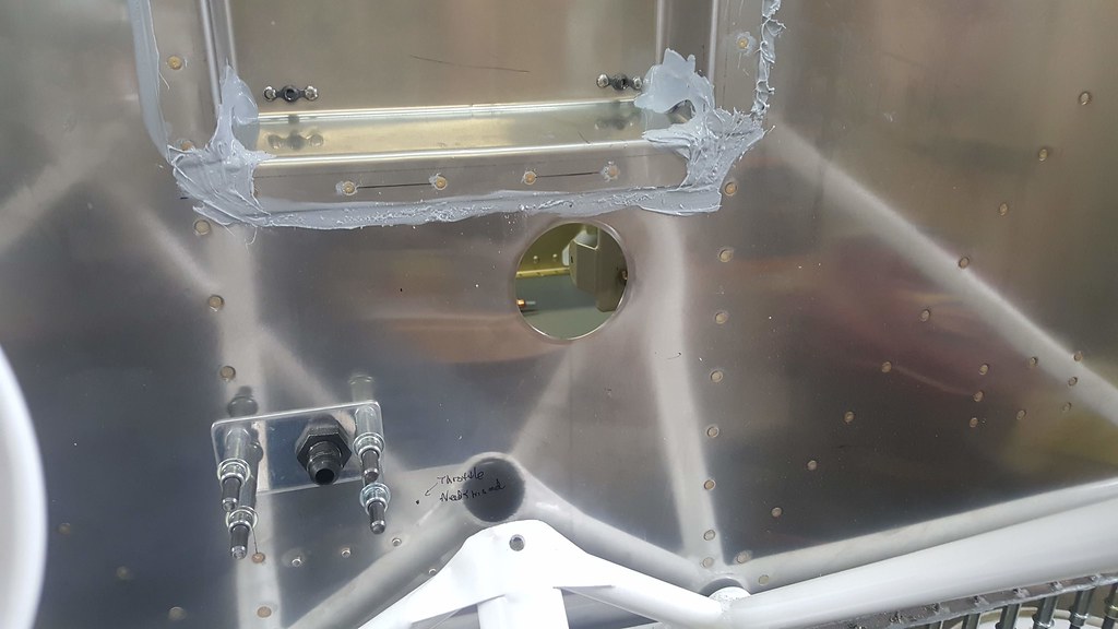

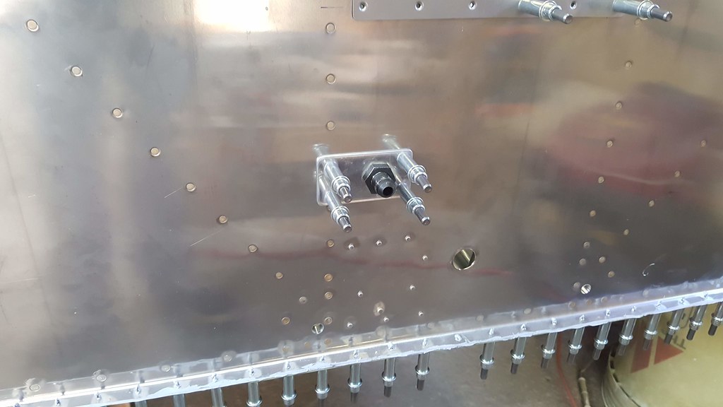

Fuel pass through on the firewall, went with the steel fitting here.
20181021_154454 by Jereme Carne, on Flickr

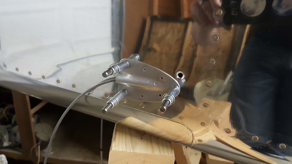

Trimmed up some rudder cable fairings and drilled them to the fuselage.
20181021_173825 by Jereme Carne, on Flickr

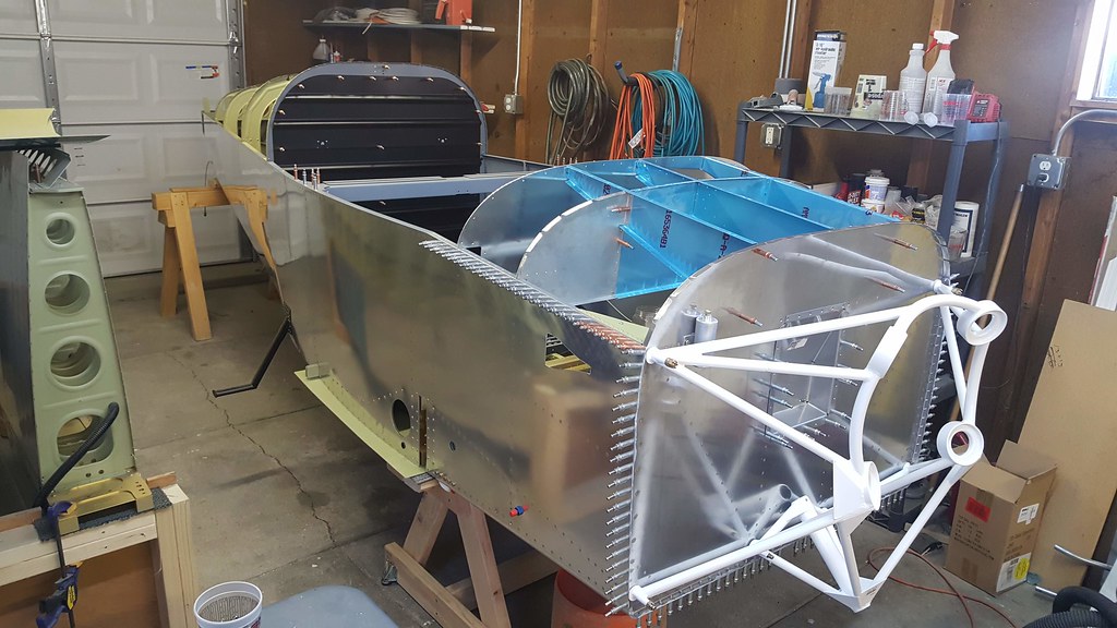

Installed the controls after spending quite some hours getting the fit of things just right with the brass bushings. It was time well spent, these things feel like they glide on air.
20181025_181520 by Jereme Carne, on Flickr
Started yesterday on the front deck, crazy to think that this section is the last of the major metal work.
20181026_162955 by Jereme Carne, on Flickr

Just a suggestion Jereme, you can mount the rudder cable fairing on the inside of the fuselage.... You only see the part the cable comes through. Just have to massage that hole a little bit. Doing a nice job.

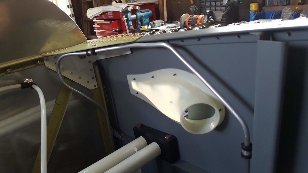

Decided to drill the air vent intakes to the fuse. I will proseal but I wanted a few rivets to hold them as well.
20181027_135821 by Jereme Carne, on Flickr
20181027_135826 by Jereme Carne, on Flickr

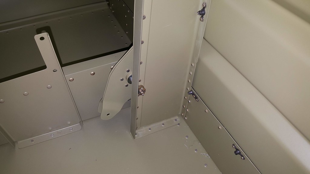

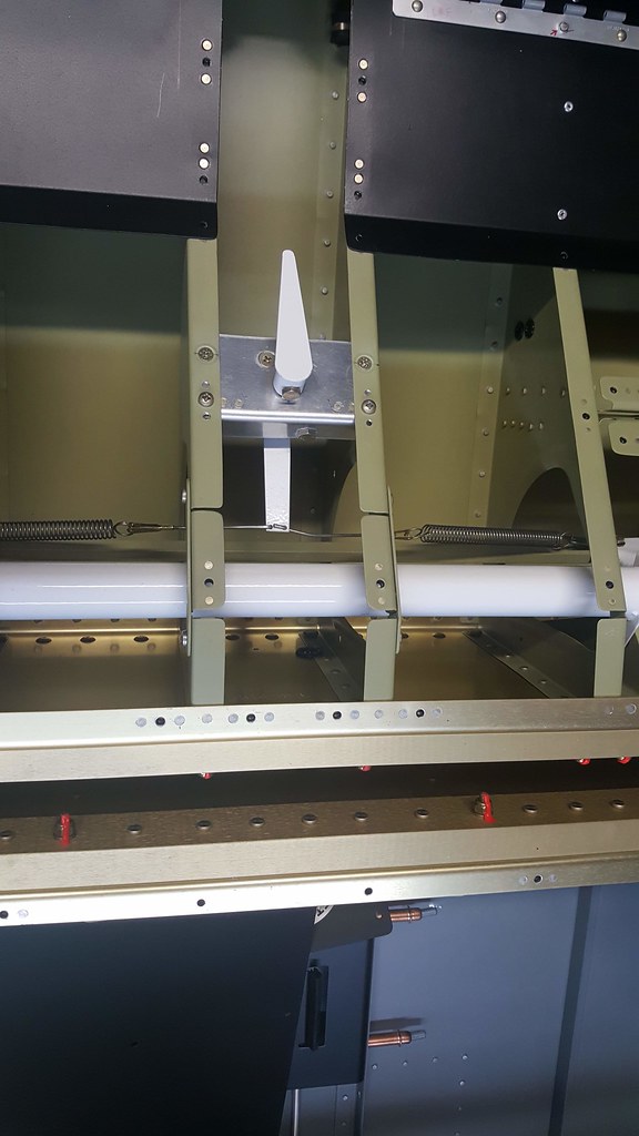

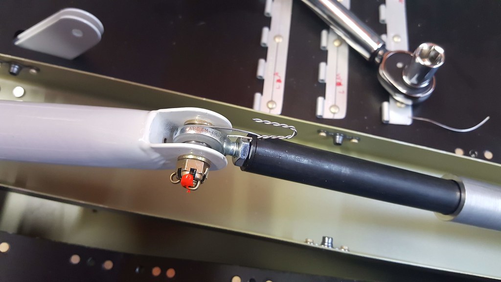

Elevator bellcrank installed, torqued and cottered. I used an MS17825 here.
20181027_145512 by Jereme Carne, on Flickr

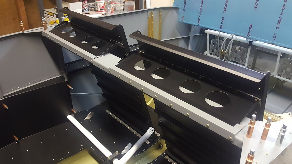

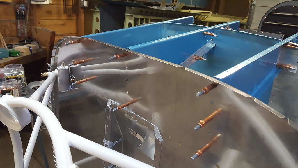

I riveted the canopy decks on as well, boy did these take some time. Some of the rivets are hard to get to. Had to make a custom bucking bar for two rivets!
20181028_150718 by Jereme Carne, on Flickr
20181028_171105 by Jereme Carne, on Flickr

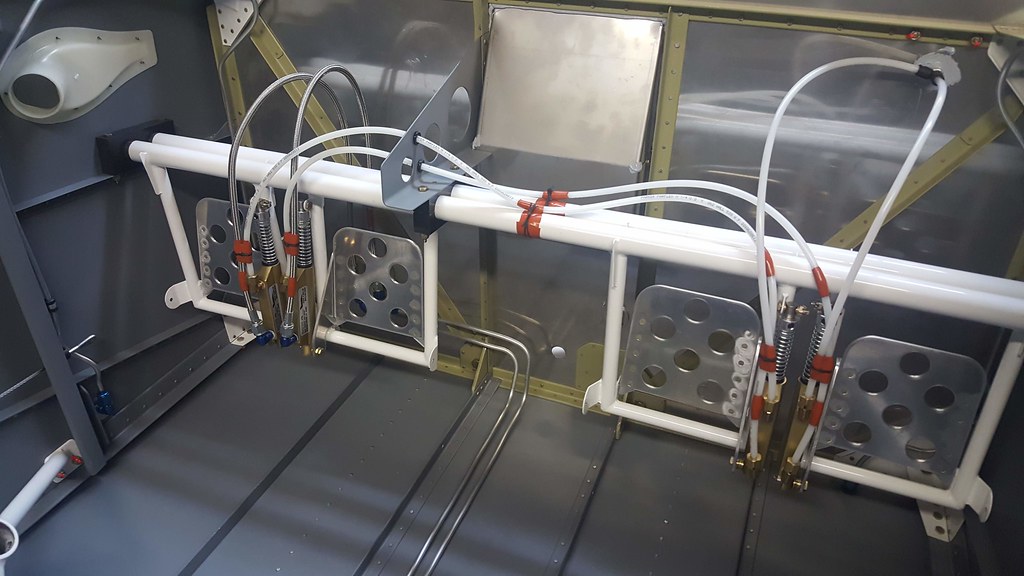

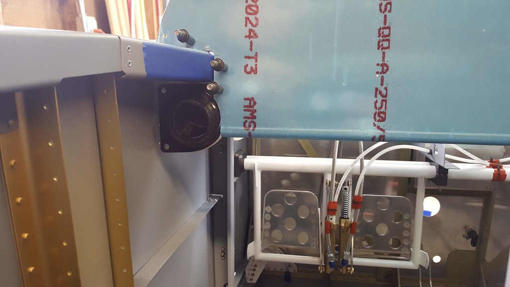

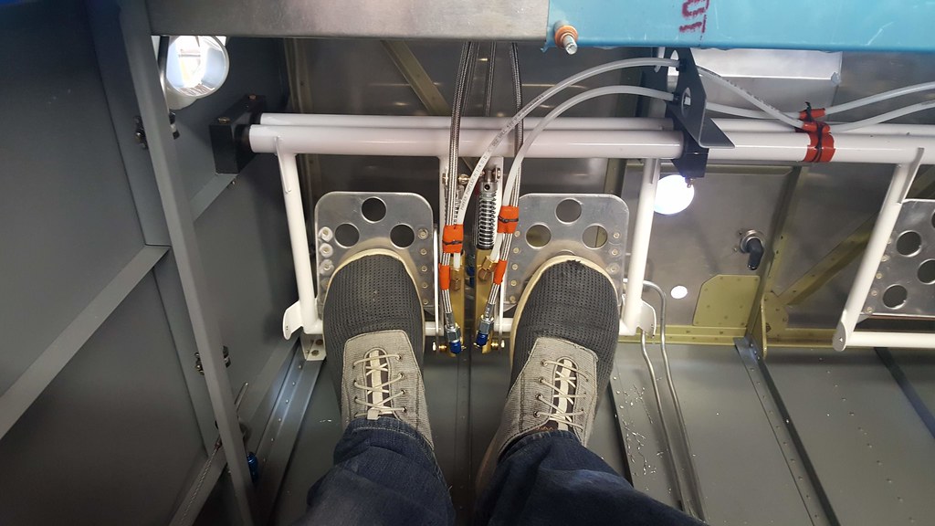

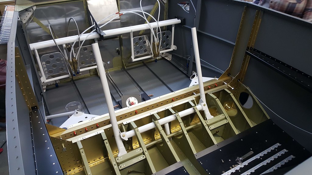

Finally you can see the work on the rudder pedals that I did this week. Learned how do some lacing. I'm still trying to figure out how to address a couple of rub spots on the pilot side.
You can also see the spring setup on the brake cylinders, the spring force stock just wasn't doing it for me so I added these at quite a low cost.
20181102_180554 by Jereme Carne, on Flickr

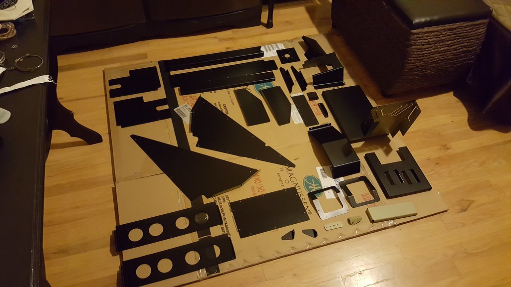

Well the work continues. I'm ordering all of the stuff for fireproofing the fire wall, I'm going with .010" titanium because a sheet of it is still cheaper than the 0.005" foil from Titanium Goat that some have used. I also don't like the look of the 0.002" stainless that a lot of people use. I know I know, no one will ever see it; but that's not true, I will see it... I guess this also means I have a somewhat large order to place with Van's for things like cables and battery box.
First up was the two inch hole for the vent. What a bis-natch (haha take that auto filter!) it was to cut this guy. I have seen others use a flycutter with success so I tried; ummmm flycutter bit definitely needs replaced now. :) Finally I ended up using a unibit to make a bunch of holes. Then I went to Ace and found this $25 guy. Holy smokes it is awesome, cuts through the stainless almost like butter!
20181103_143607 by Jereme Carne, on Flickr
Here is the final result, nice and deburred.
20181103_144103 by Jereme Carne, on Flickr

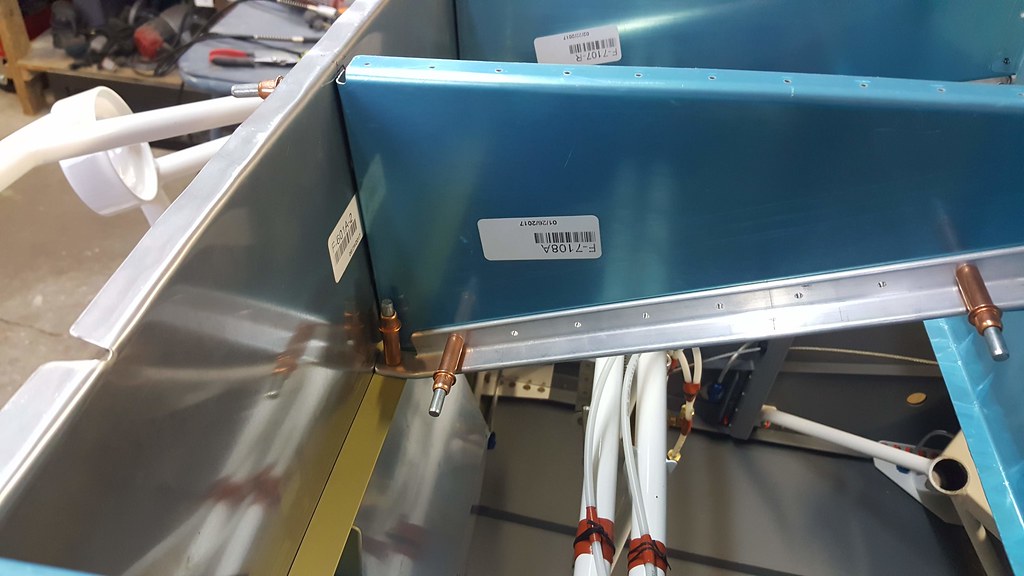

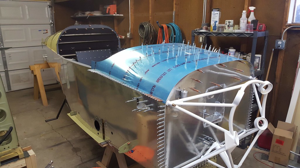

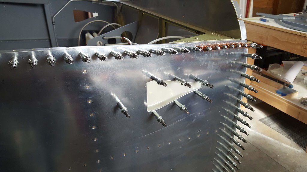

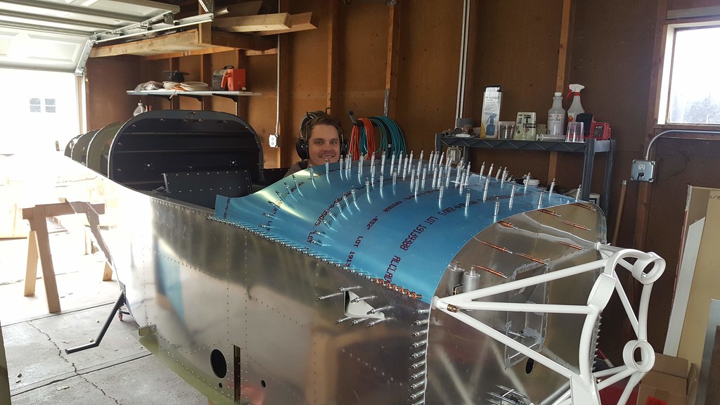

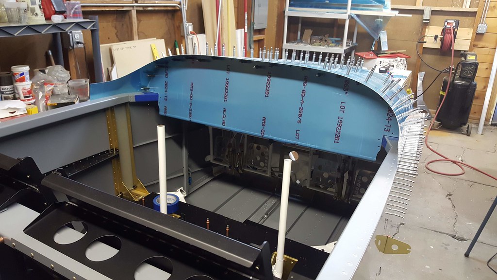

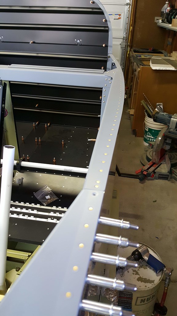

Next I started working on the deck. When drilling the five holes for the center rib the bit walked, so I up sized them and will be installing AN470AD5 rivets instead.
20181103_164936 by Jereme Carne, on Flickr
Had to bust out the 12incher for this one.
20181103_164942 by Jereme Carne, on Flickr
Let me tell you... getting that skin clecoed on was quite a bear. It is 0.032" and does not like the bend by the longeron, I'm going to try and pre bend it a tad next time.
20181103_172344 by Jereme Carne, on Flickr
Man this looks cool, a blank canvas. The wife said "It keeps getting smaller", to which I responded "I think you mean it keeps getting closer to done." :D
20181103_174616 by Jereme Carne, on Flickr

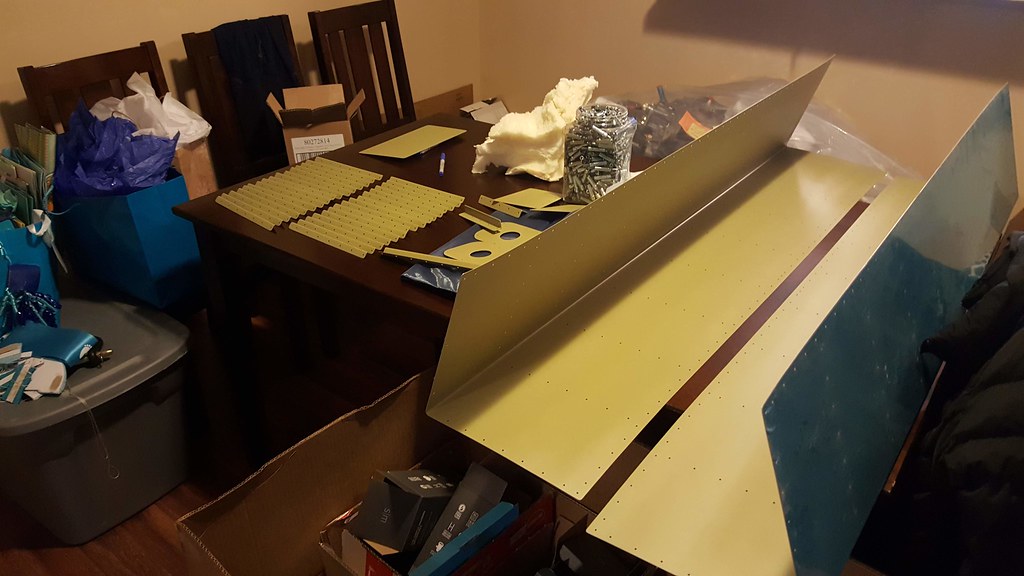

This last picture probably has you wondering. Well my wife had her baby shower yesterday and my mom made some clothes as a gift. It you look closely you will notice an RV-7A slider complete with my tailnumber! I wondered why she was asking me about the tail number. I also traced this image back to an image on VAF, it's actually a -6A, thanks Doug!
20181103_175623 by Jereme Carne, on Flickr
Whoops sorry I missed this post back then good sir. I never thought of putting them guys inside the fuselage. Thanks for pointing this out, I will have to take a look.

I also quickly learned that these vents supplied in the kit are a joke. I'll be going with some Stein vents now. Unfortunataly they aren't cheap!
20181104_145221 by Jereme Carne, on Flickr

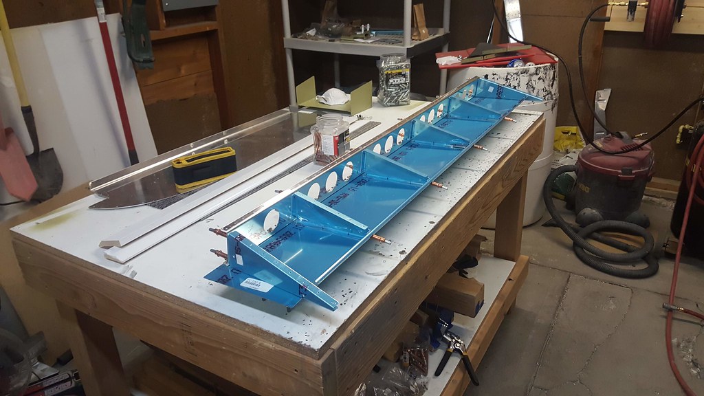

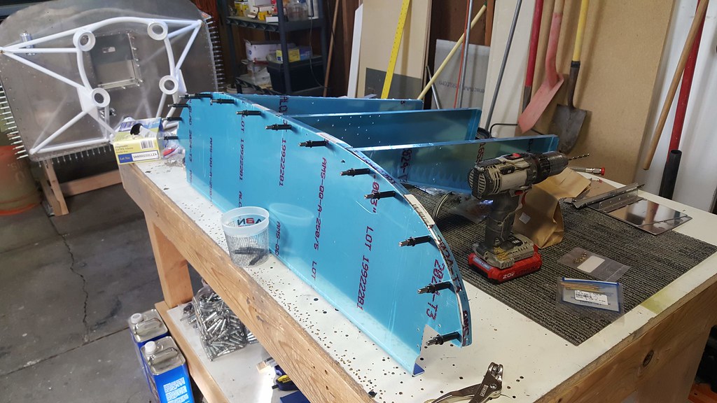

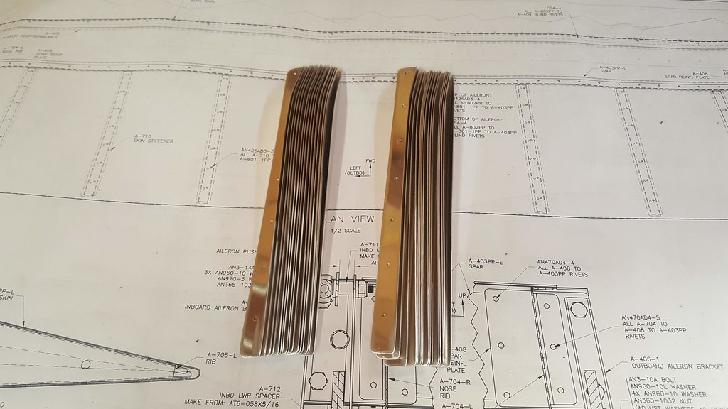

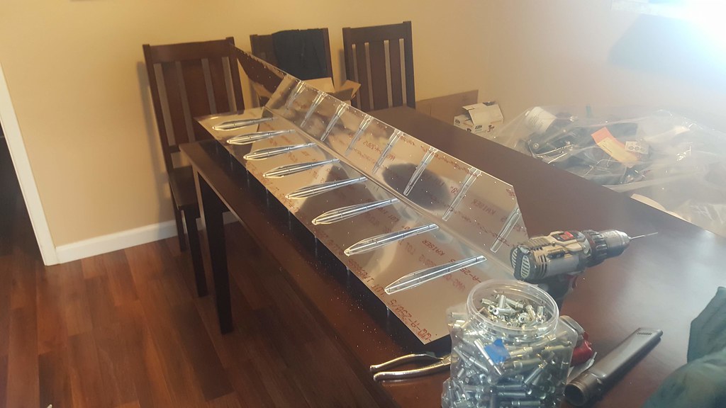

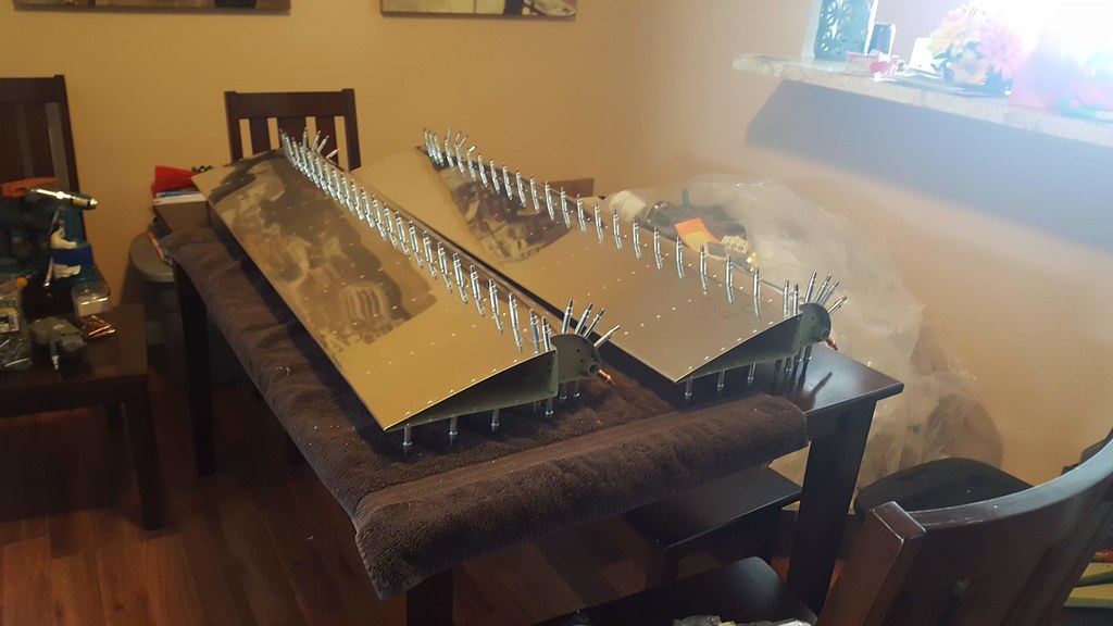

What are these you ask? They are aileron stiffeners but I don't see them that way... I see them as 2 hours of deburring. :D
20181110_154840 by Jereme Carne, on Flickr
Fun!
Uhhh.. Did those a few month ago. So much fun! But the flaps are nice part to build that do go together really quickly.

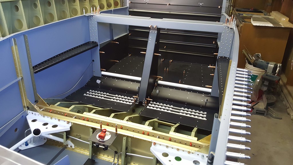

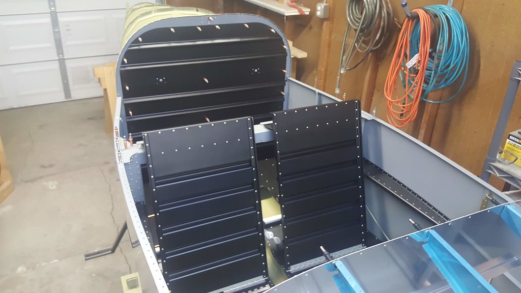

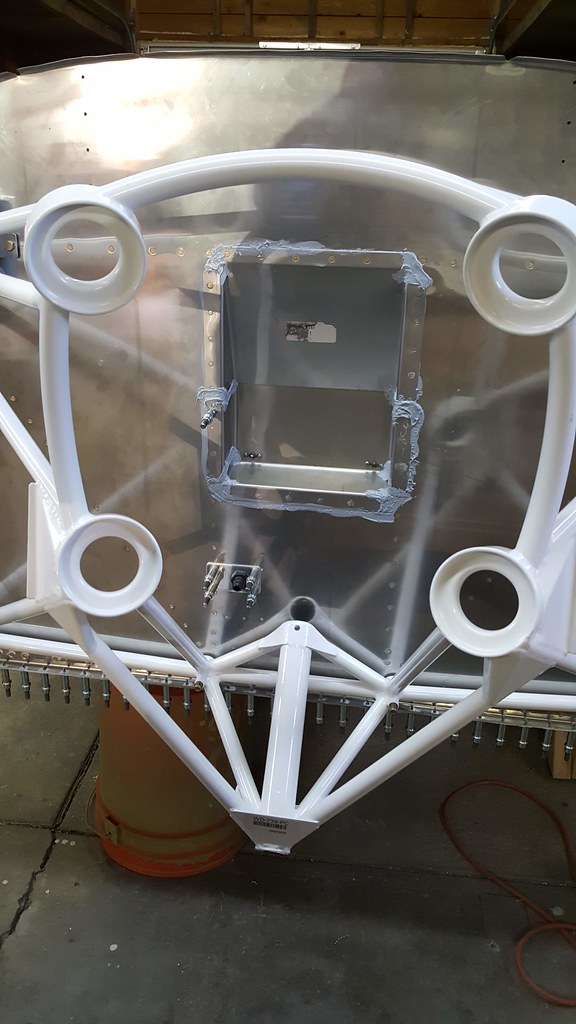

Firewall environment

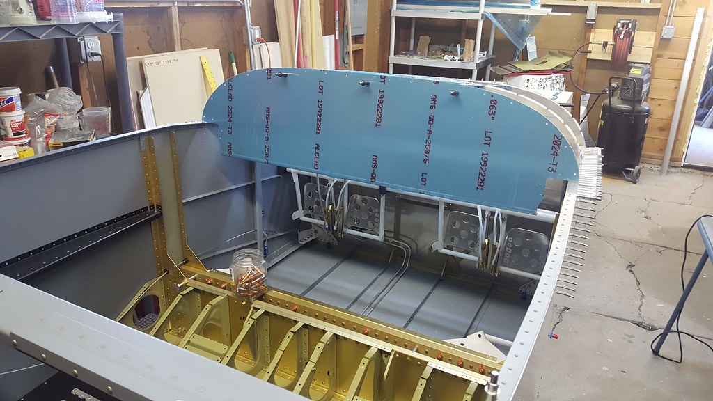

I would like to make some comments based on the front view of your fuselage.
1. You may find it very difficult to rivet the F-7107-L, F-7107-R and F-7108A ribs to the firewall with the engine mount installed. The top two rivets on each rib are OK but the remainder lower rivets are the problem getting a rivet gun into those locations. Ask me how I know.
2. Before installing the front top skin I would suggest you complete fitting all your instruments and components to your instrument panel and back panel. Having the top skin off makes it much easier to complete the wiring as you have better access.
3. Following on from item 2 work out where you want them and then make the the holes you are going to put in the firewall for the engine wiring harnesses (e.g. EGT/CHT, oil pressure and temperature, fuel pressure, magneto leads, etc). I used the Aircraft Spruce 3/4 inch kit P/N: 09-00978 (they also come in 1/2 inch and 1 inch sizes) as they are made of steel and utilise Fire sleeve. Ease of access again is the benefit.
Enjoy the building process and post some more threads showing your progress.
Cheers,

Thanks for the comments Gordon! I am on the same page on 1-3. Top skin is slated to be one of the last things done so that I can do all the wiring in peace. :D I'm in the process now of gathering all of the stuff that needs to be placed on the firewall as I am going to fibrax it and attach what I can before I put the mount and engine on. The mount right now is only loosely held on so I can attach all of this stuff. I'm trying to get them ribs to a point where I can rivet them to the firewall. After all of this stuff goes on the firewall I can put the mount on for good. It's mainly there right now as I'm running out of room in my house to store it all. :D

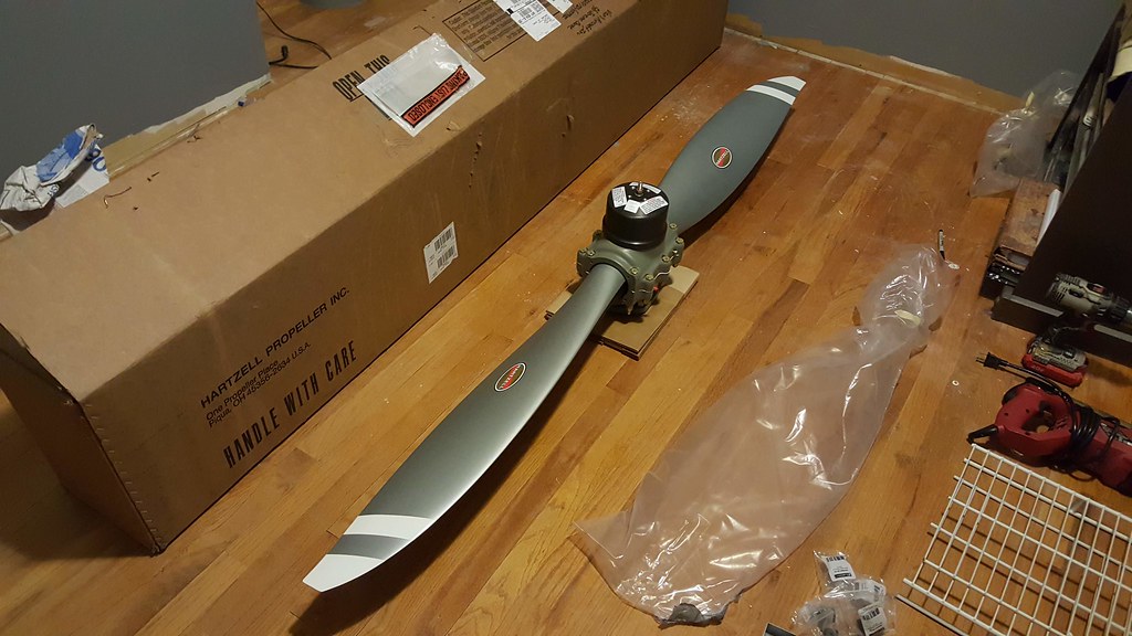

Yep, you guessed it. My Hartzell constant speed 74" prop arrived! :D
20181129_172323 by Jereme Carne, on Flickr

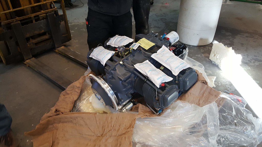

Oh this you ask? No big deal, it's just an engine! Haha My IO-360-M1B arrived as well. The sealing bag was compromised so I said, mind as well open it up and take a look. I resealed it with some new desiccant. My wife is pretty awesome too, she let it go in the corner of our dining room since the humidity inside the house is only 25%. :)
20181207_140045 by Jereme Carne, on Flickr

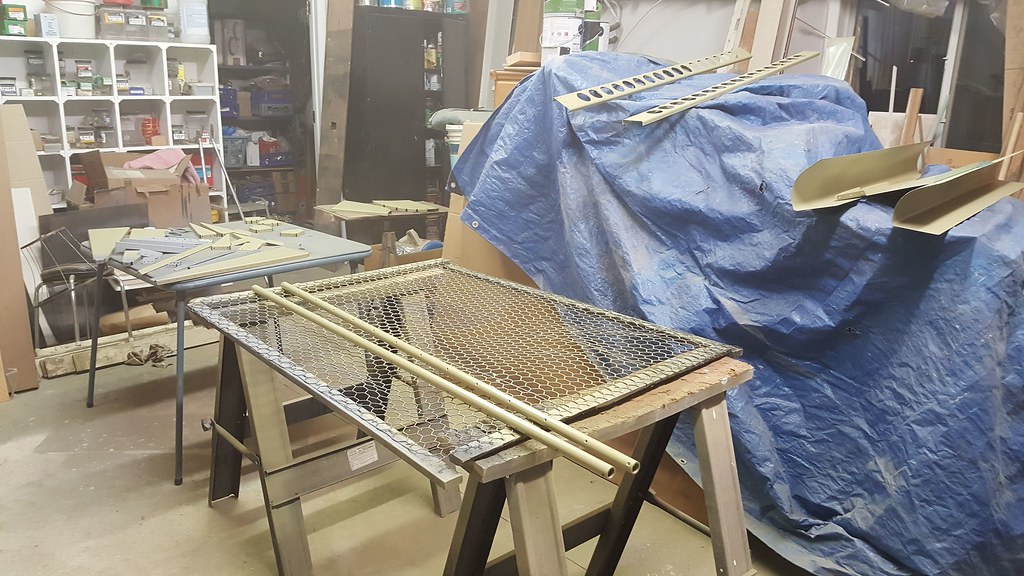

Finally, I'm trying to make this winter a productive one with some inside work. I saved the flaps and ailerons so I could work on our dining room table like I did with the empennage. I started with the ailerons yesterday. I have had a hiatus recently due to remodeling our baby room, now that that task is done back to building!
20181215_105901 by Jereme Carne, on Flickr
20181215_110424 by Jereme Carne, on Flickr
Got some priming done today. I had some extra primer so a tip for those coming into building, there seems to always be little things that need primed, since I had some extra today I primed the parts for the ADAHARS shelf and a couple of covers.
20181216_163039 by Jereme Carne, on Flickr

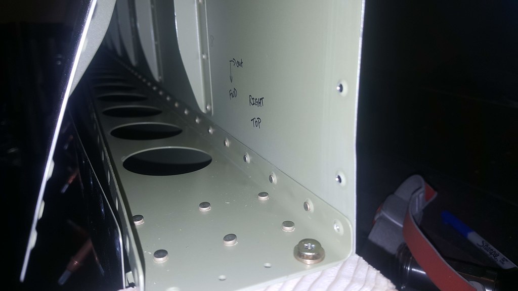

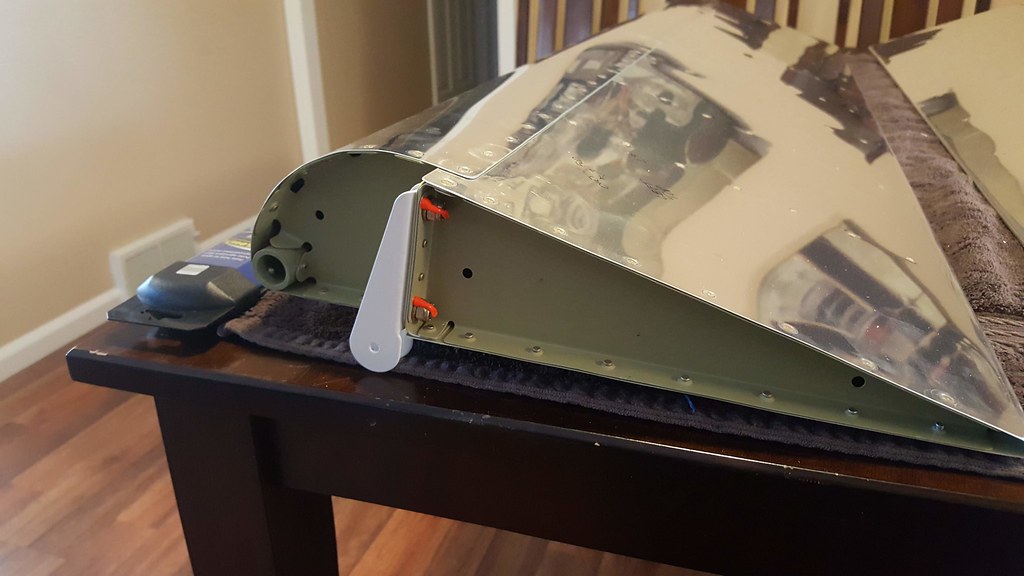

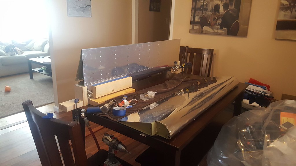

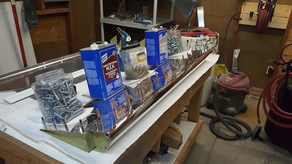

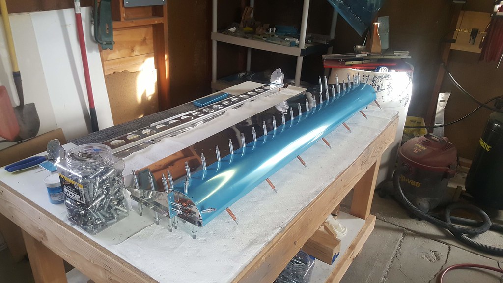

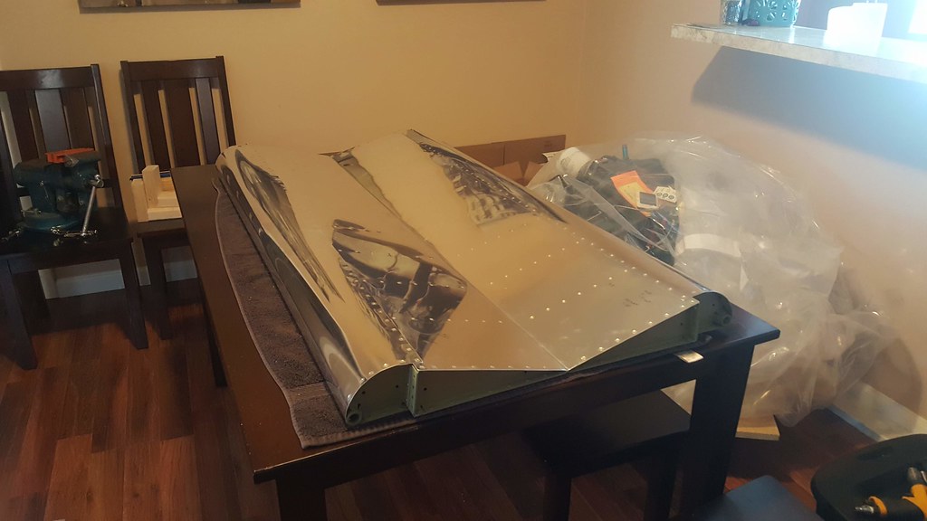

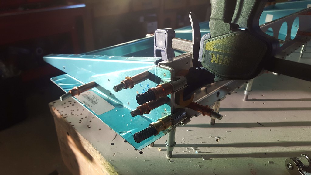

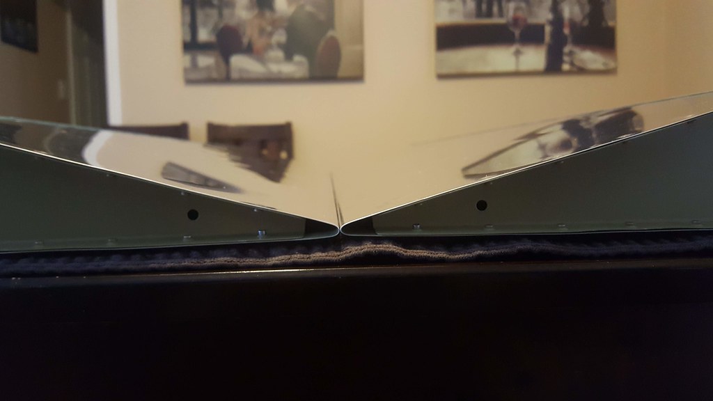

After some dimpling and riveting it was time to for the ever stressful bending of the aileron skins. Seemed to go off without a hitch, they came out great. I still have some tweaking to do to make sure a straight edge will sit flat but I will wait until they are done for that.
20181219_204836 by Jereme Carne, on Flickr

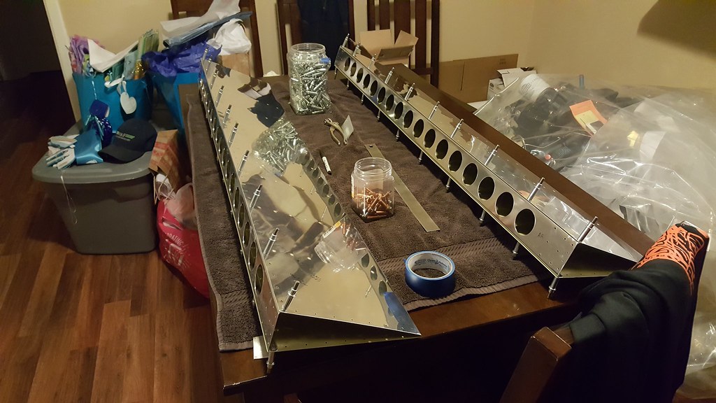

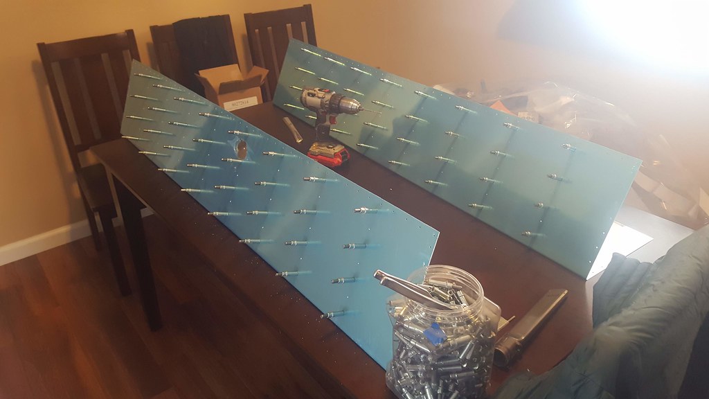

Then it was time to put things together and start drilling! Some things can be a real beotch to cleco together and I thought the ailerons would be another one of them tasks, turned out to be easy as ever to put together!
20181222_104154 by Jereme Carne, on Flickr
Figured it's been awhile since I took one of these. It's a whoping 24 degrees in my garage right now and the wife is baking cookies so I guess I have no choice. haha
20181222_104206 by Jereme Carne, on Flickr

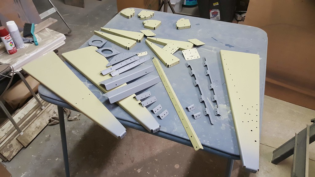

After riveting the ADHARS mount it was time for a mega primer session.
20181224_170826 by Jereme Carne, on Flickr
As you can see I also painted some parts for the fuselage. I probably didn't need to paint some of the parts in their entirety but I wanted to make sure I am not going to stare at one spot of primer while flying, an OCD thing I guess.
20181224_170832 by Jereme Carne, on Flickr

Well after clecoeing parts back together it was time to start riveting.
20181228_135000 by Jereme Carne, on Flickr
I started by putting the aileron on a couple of blocks that the spars get screwed down to.
20181229_121502 by Jereme Carne, on Flickr
Your hand comes in from underneath so I recommend putting something between the skin and spar to keep the two peeled apart, I didn't think to do this until after my wrist was all sore and scratched up.
20181229_121525 by Jereme Carne, on Flickr
Finally after the top is riveted to the spar you rivet the tops of the ribs and then weigh it down on a flat surface. (I also checked for twist to make sure there wasn't any, first checking the table then the aileron) From here it is quite easy since riveting is mostly blind rivets. My Harbor Freight pneumatic rivet puller made it not only easy but fun too.
20181228_173256 by Jereme Carne, on Flickr
Repeat for the other aileron and wham you got some rolling devices! :D
20181229_151000 by Jereme Carne, on Flickr
As you can see from the end I still need to tweak the trailing edge just a bit to get a straight edge flat but that's no big deal to do. The other end matches exactly up with each other so either these things are perfectly straight or both twisted the same amount haha. Checking for twist while riveting was worth it.
20181229_151018 by Jereme Carne, on Flickr
All I have left to do is bolt the brackets on and I'll be on my way to working on flaps next.
