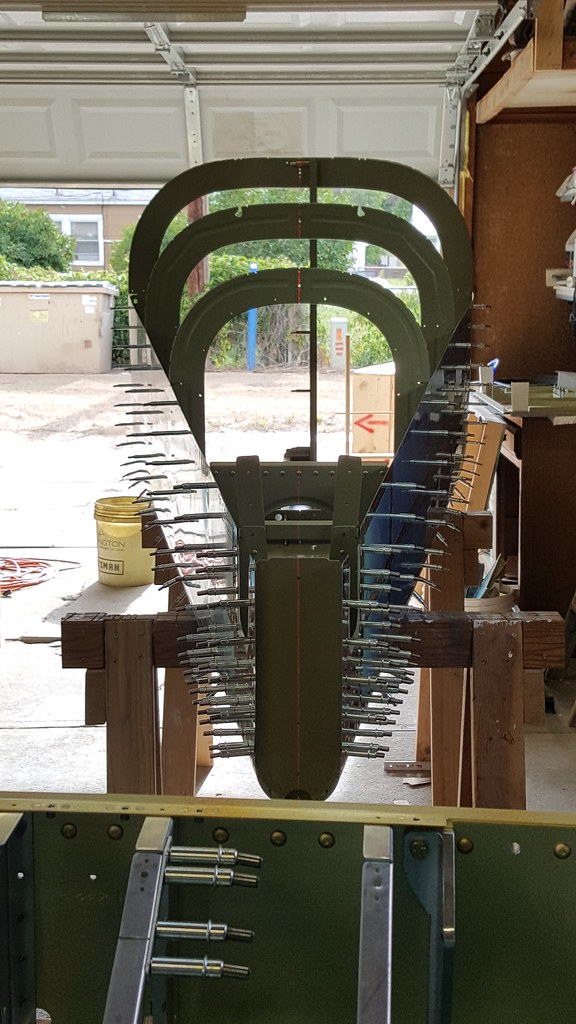

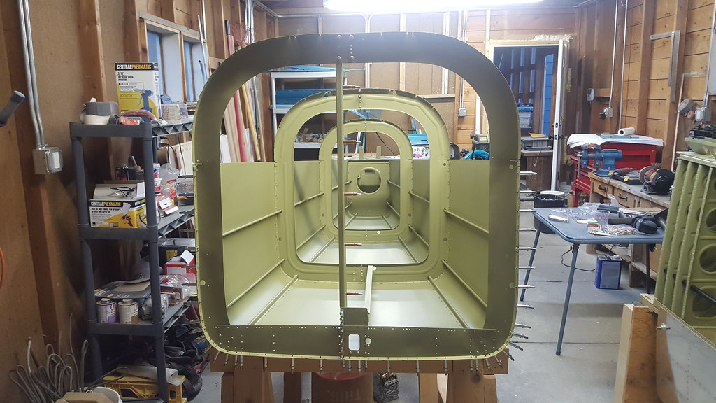

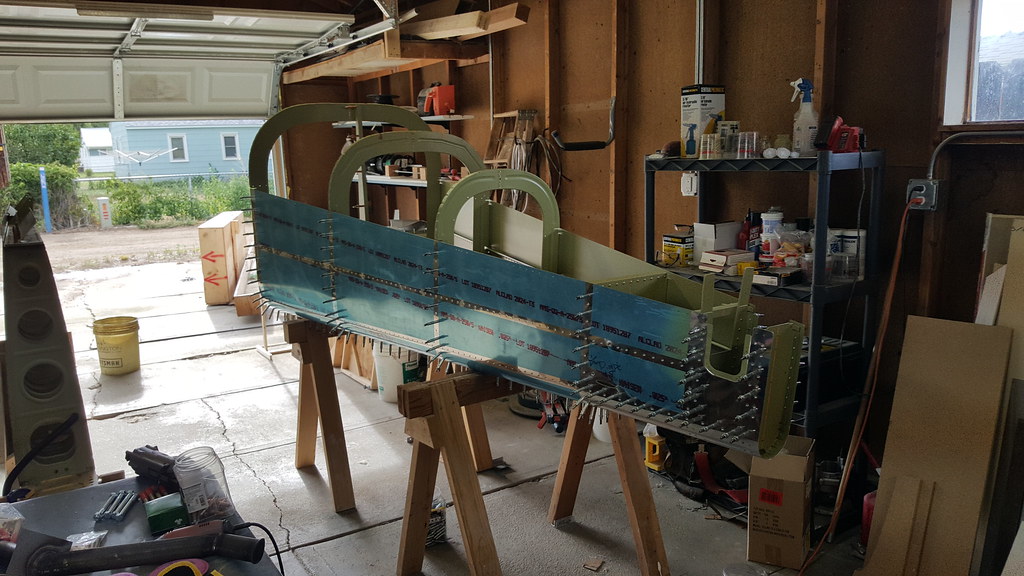

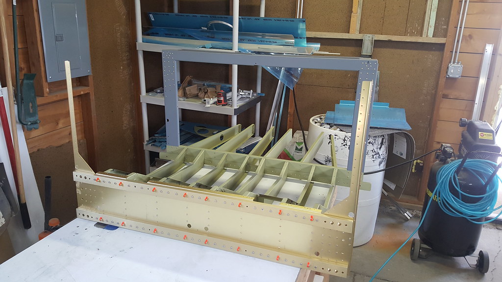

Time to put the aft fuselage back together, for the last time! :D

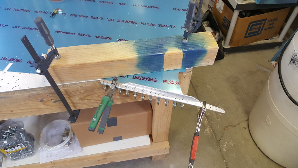

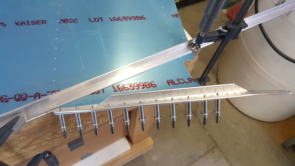

Riveting the last two bulkheads to the thick bottom skin was a nightmare!!!!!!! I want to meet the person who enjoyed that part of the build and buy them an ice cream cone or something. I have about 3 rivets that aren't perfect by any means but I suppose if they ever give me problems I can drill them suckers out and put a cherry max in there and be done with it.
On a brighter side, I started riveting a little on the main part of the aft fuselage and those are a breeze so far.
20180629_181719 by Jereme Carne, on Flickr

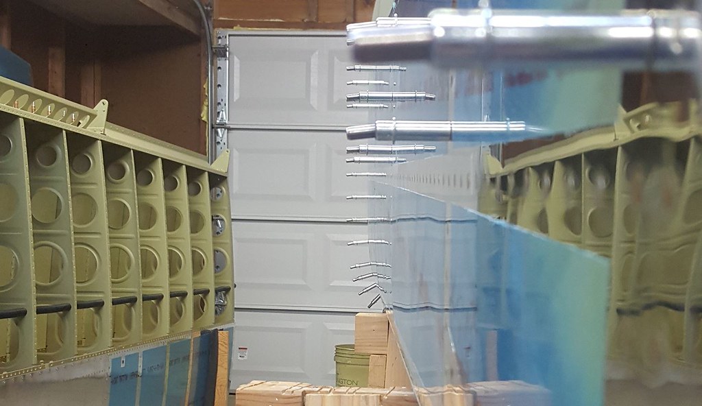

Using a laser to make sure all of the bulkhead tooling holes are lined up, indicating no twist. I struggled with a little bit of twist before taking it apart but it has worked itself out. I'll keep an eye on it.
20180629_181711 by Jereme Carne, on Flickr

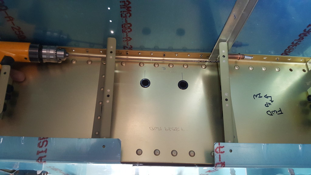

Started riveting the aft fuselage, going good so far, got the bottom skins done and a few bulkheads up to the upper j-stringer. Pics coming soon, can't ruin the grand reveal.

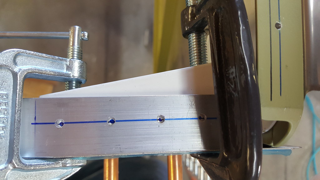

Almost finished everything for the crotch strap kit. This is super time consuming if you don't have a tight fit right angle drill! You basically have to take it apart and put it together about 6 times so you can drill everything properly.

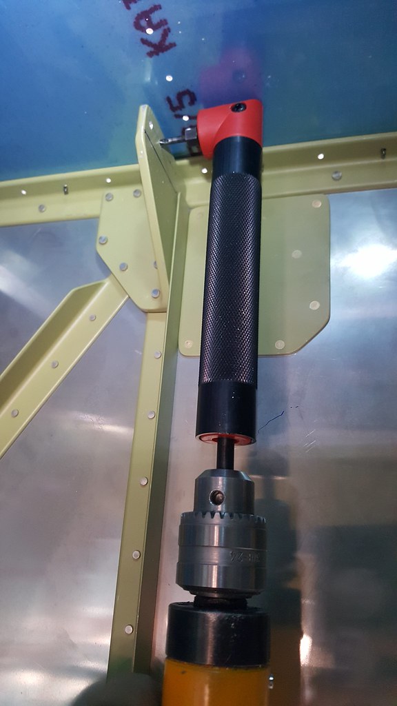

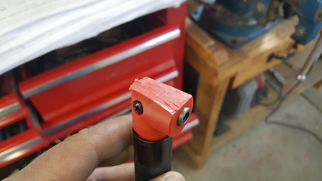

Gotta have a right angle drill...I got one off eBay under $100. I use it all the time. Looking good!

So what drill sizes do you need for right angle drilling the crotch straps?
I got my attachment on order as we speak!

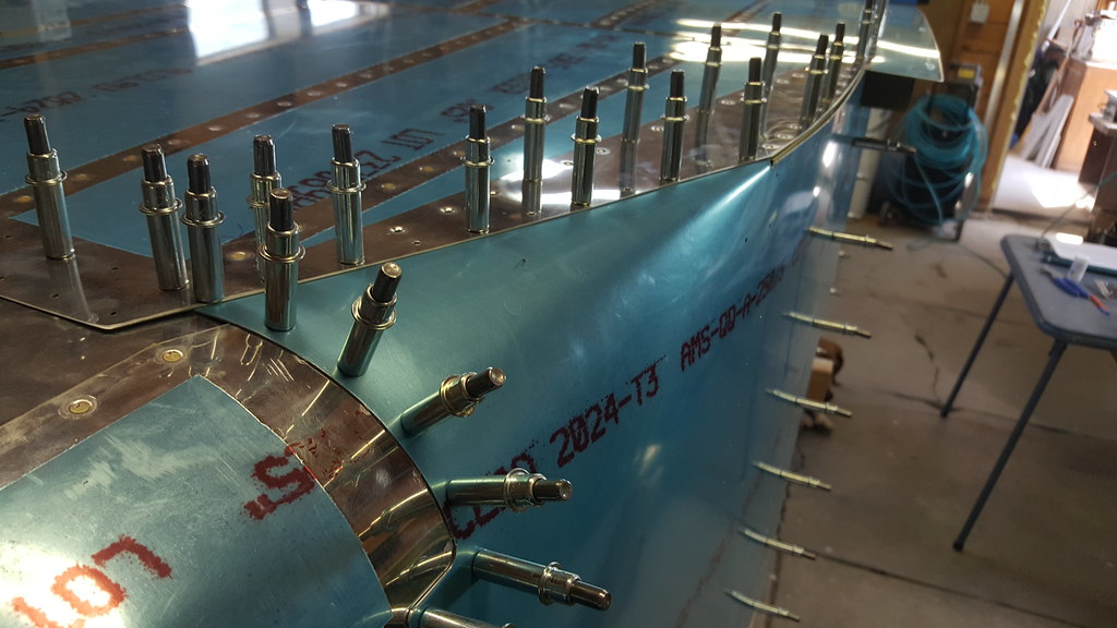

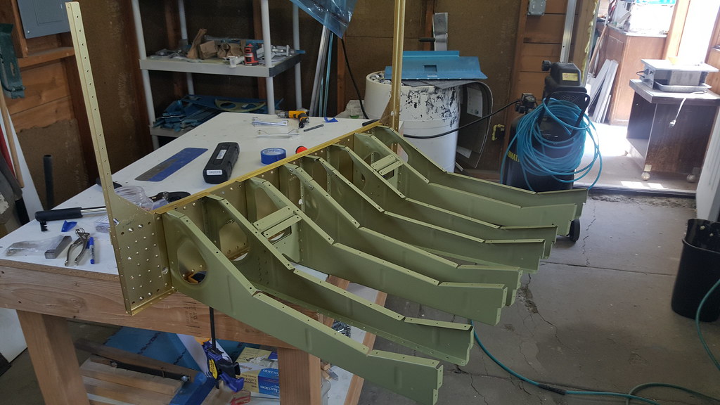

Well my rivet buddy decided to go to the mountains today so I started working on the "fun" part of the center section... deburring.
I got half of the 18 ribs done and also decided to take a break at one point to rivet the F-705 bulkhead. I'm REALLY glad I went with the paint before rivet idea, the contrasting rivets looks next level cool to me.

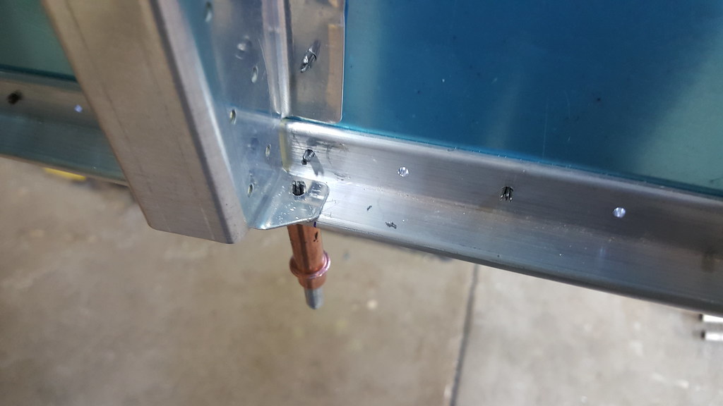

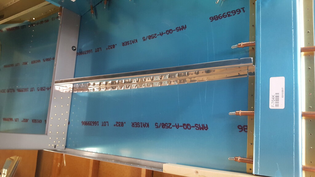

As a tip to others, don't forget there is a rivet under each of the bar doublers that MUST be set first. Luckily I only set two rivets before realizing this.

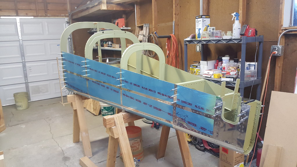

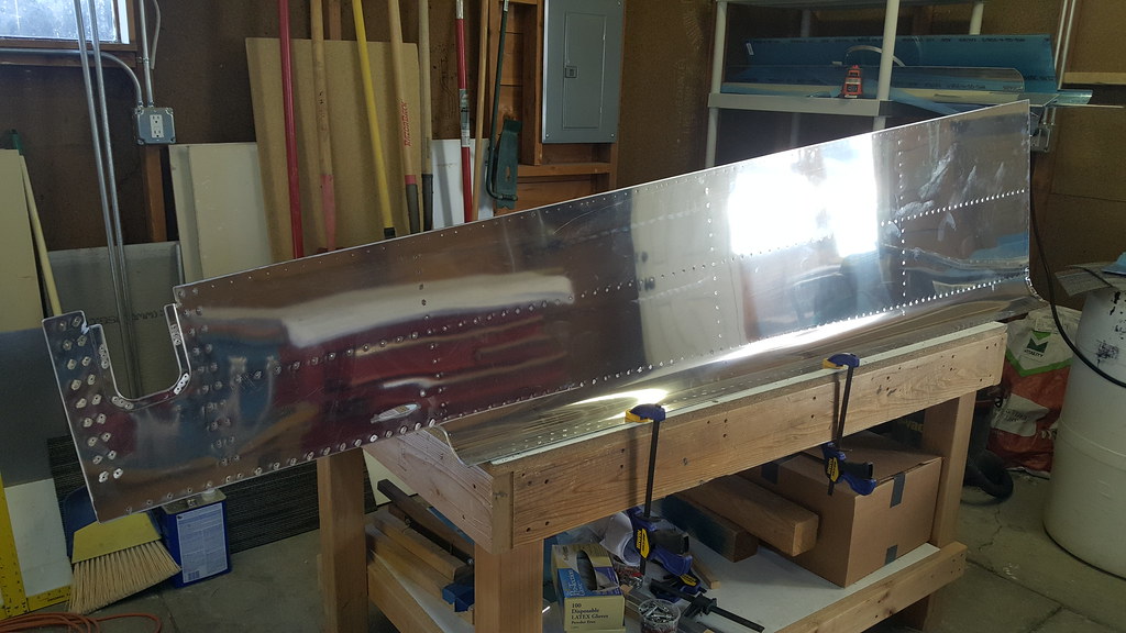

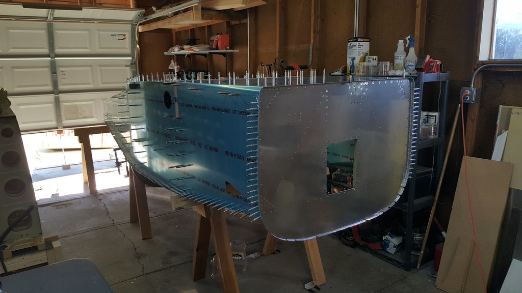

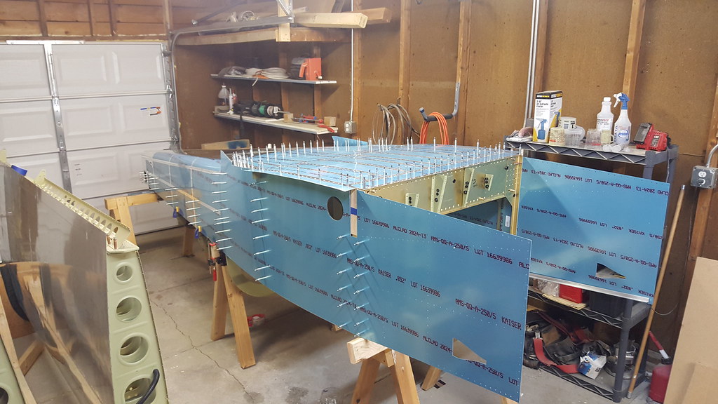

Well my rivet buddy made it over yesterday so we finished banging out the aft fuselage rivets. I am quite happy with how things turned out. There is a little light distortion of the skins around the aft two bulkheads but luckily those are covered by the horizontal stabilizer. It's really not bad, I'm just a perfectionist.

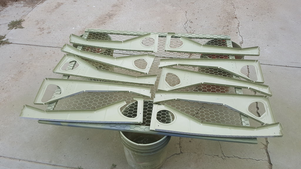

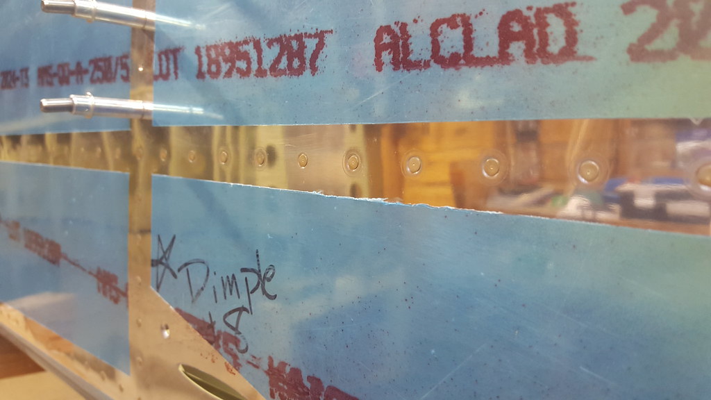

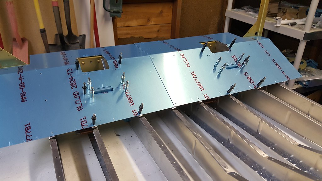

Today I got all of the parts for the center section primed with the exception of the skin. Tomorrow I will prime the skin and start putting things together. Getting really close to making things nice and big!
20180703_163224 by Jereme Carne, on Flickr
Well I have been logging about 6-8 hours a day for the past week so I'm really getting things done! Unfortunately I have to take a week off next week to go take a college class. At least it pays me though, more funds for the project! :D

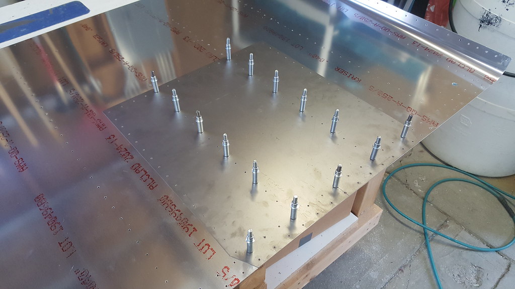

I got the bottom center section skin all primed up and dimpled.

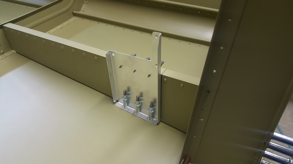

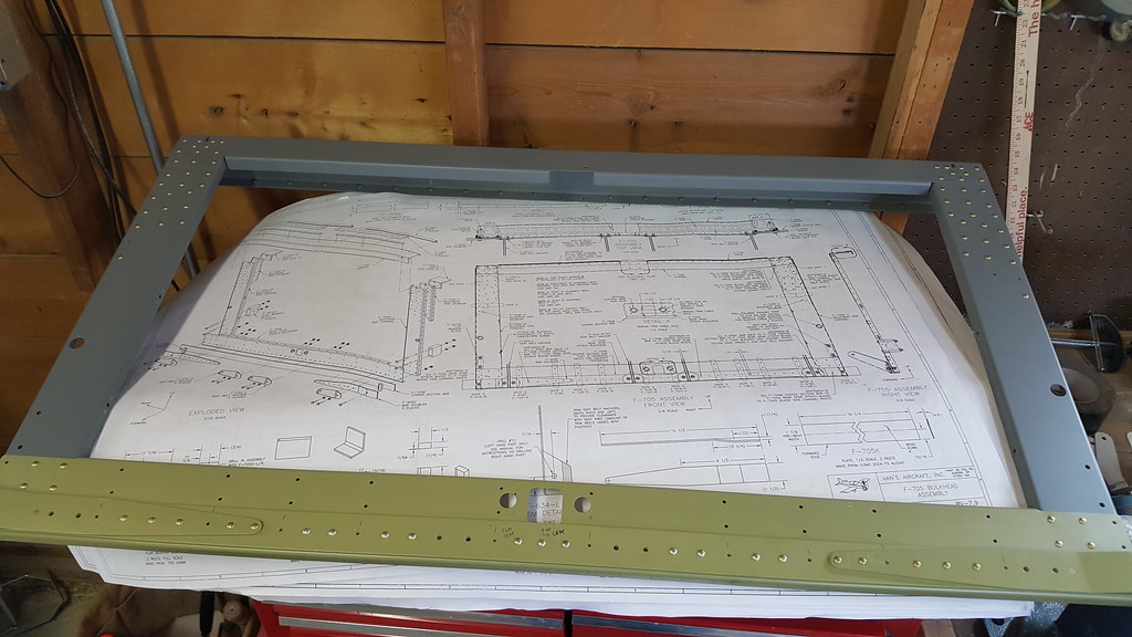

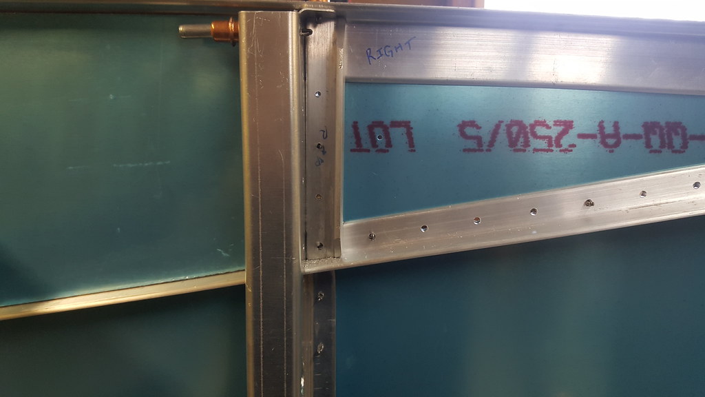

I fitted and primed the autopilot pitch bracket. Way easy to install before things get mated together.
20180703_230701 by Jereme Carne, on Flickr

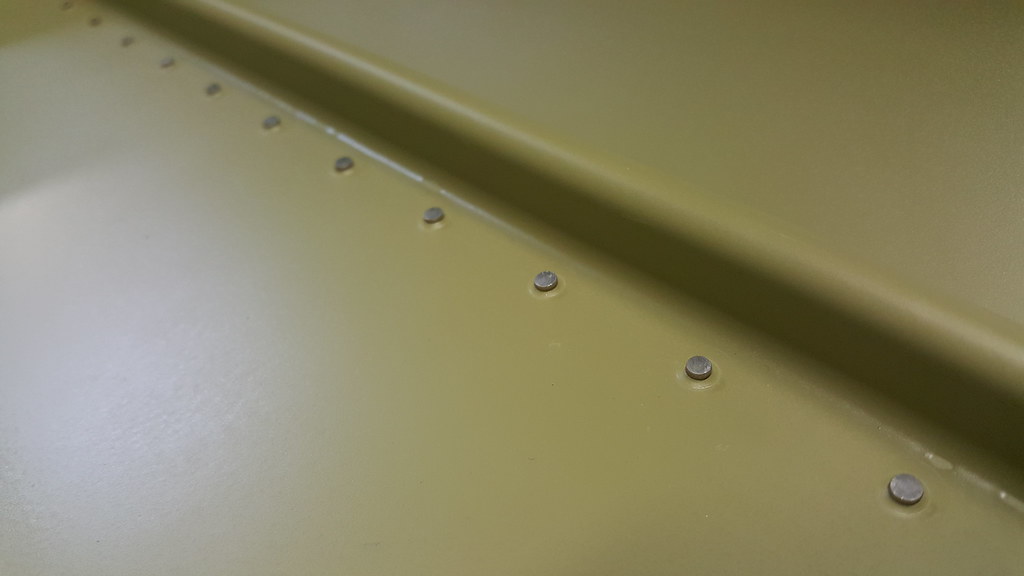

You're making good progress and it's looking good.
One tip: The torques seal is not supposed to be on the bolt. It's between the nut and a solid surface. See http://www.eaavideo.org/detail/video/29739769001

I disagree with this method on using torque seal. I think it is more important to know if the nut has rotated with respect to the bolt (theoretically if it's not on the threads the bolt could rotate and the nut remain stationary and you wouldn't know). If I have to remove a bolt with torque seal on it I am just going to replace it anyways.

It should be a line from bolt to nut to surface. Anything turns and it's easily noticed.

I agree the torque strip should be from the surface onto the nut to the bolt. I think the video is mistaken in that the torque strip should not be on the “bolt” side of the fastener; but it definetly needs to indicate if the nut has turned on the bolt.

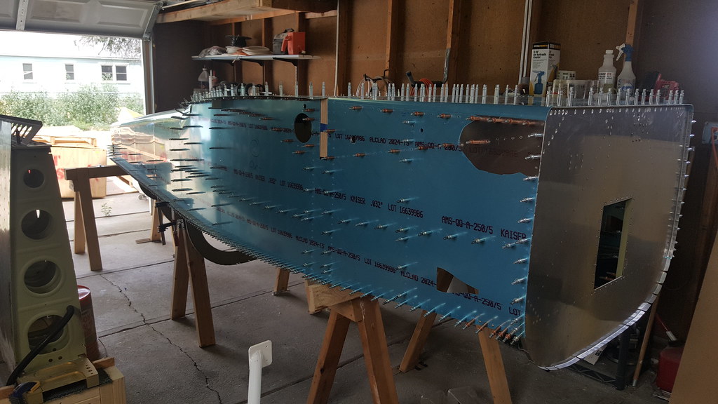

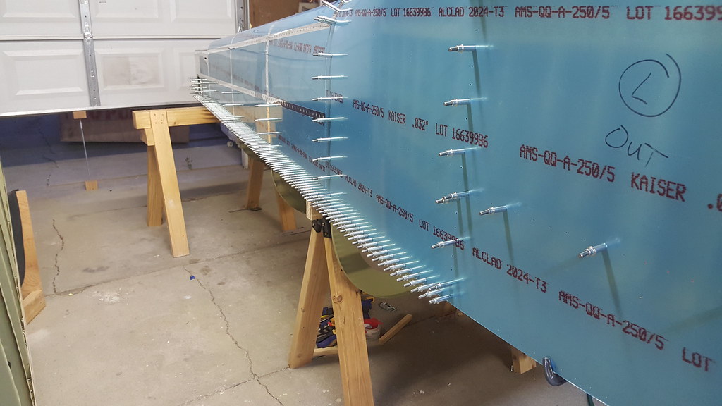

Mating the center section to the aft fuselage was a pain, the side skins were easy. Let me rephrase that, clecoeing the side skins was easy, I'm not trying to jinx myself for the conical bends tomorrow.
20180717_210140 by Jereme Carne, on Flickr

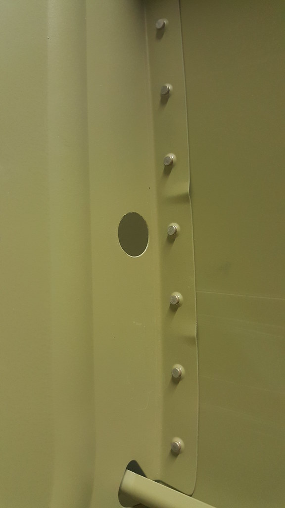

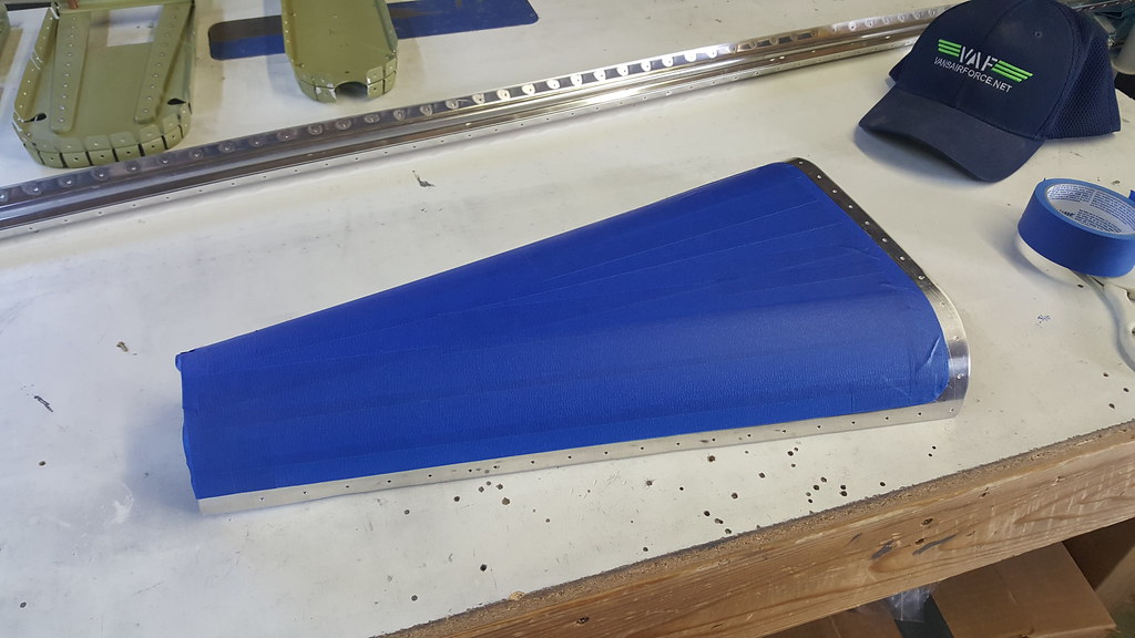

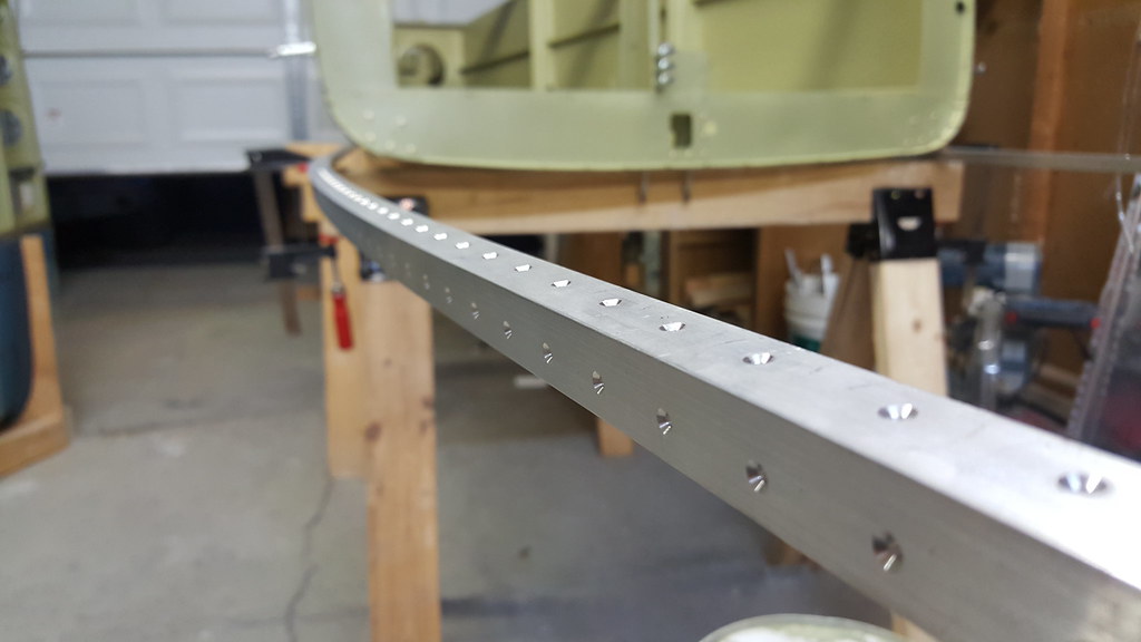

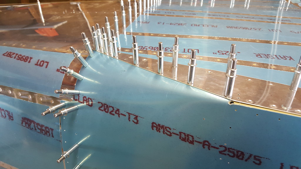

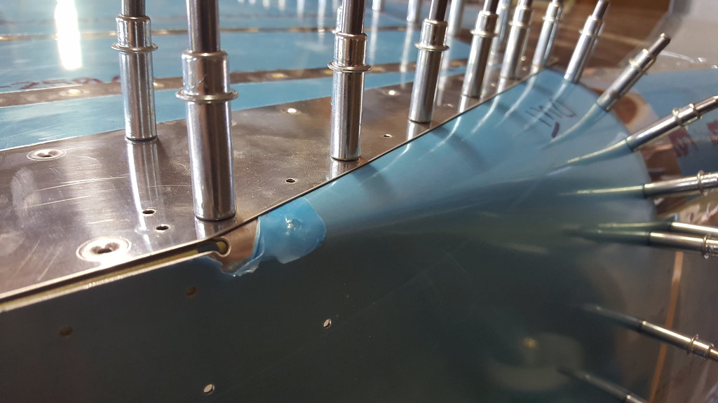

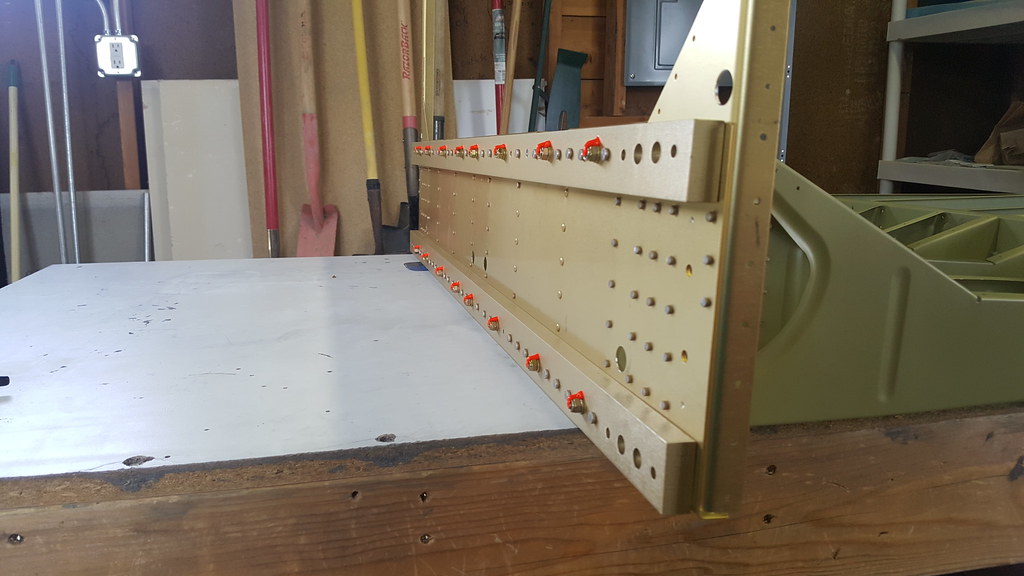

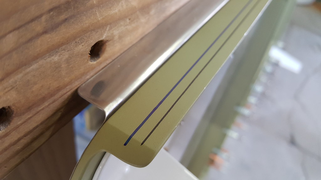

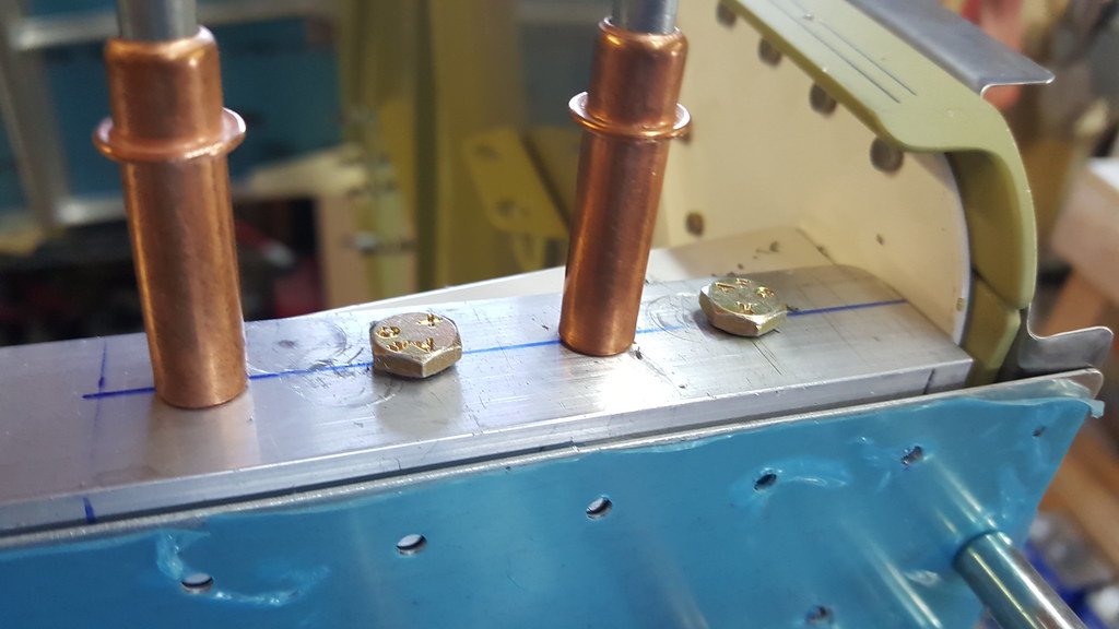

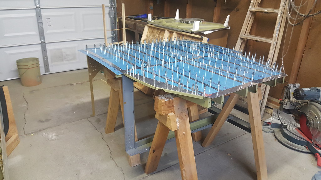

Fuselage work continues, I started the day with doing the conical bend. Not gonna lie, this had me stressed a little as I have seen countless threads of people getting cracks while doing this. There is a simple fix for the cracks but I would rather just avoid them altogether.
I did the bend in two passes, no more as you will eventually start to work harden the metal. The first pass was with a 4x4 as the edges have a nice fillet to them.
20180718_112338 by Jereme Carne, on Flickr
After there was some bend I switched to an angle as you have to bend past 90 degrees.
20180718_112519 by Jereme Carne, on Flickr
Here is how the left side turned out.
20180718_114840 by Jereme Carne, on Flickr
20180718_114845 by Jereme Carne, on Flickr
And the right side...
20180718_114902 by Jereme Carne, on Flickr
Overall I think they came out quite nice. I about crapped a brick when I saw those hole line up nicely especially after pondering the fact that the whole process took less than 15 minutes per side. They may need a little tweak eventually depending on how the baggage bulkhead fits.
Also worth mentioning that I thoroughly deburred the reliefs before bending.

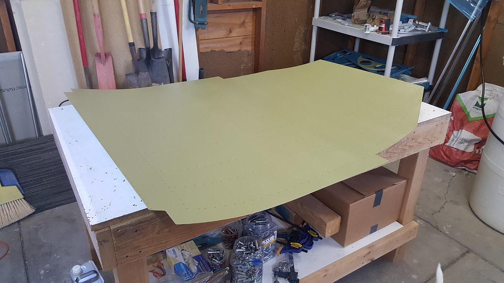

Well I wrestled with the firewall today. I'm not sure if I was supposed to flute the stainless or not but I did since the middle was bowing out a little. (after doing some research it looks like you are not supposed to flute here as the piano hinge for cowl resides there, so if you are reading this don't flute here! If however you have like myself, we are not alone, get the squeezer out with some flat sets and flatten em out. Live and learn) I have also read on many many blogs that the forward fuse section is a freakin land mine of potential edge distance problems. Therefore, I am going to mark everything with black for minimum edge distance and blue is what I always use for what I'm actually shooting for. This already paid off today as the top left firewall bracket was very very close to this minimum.

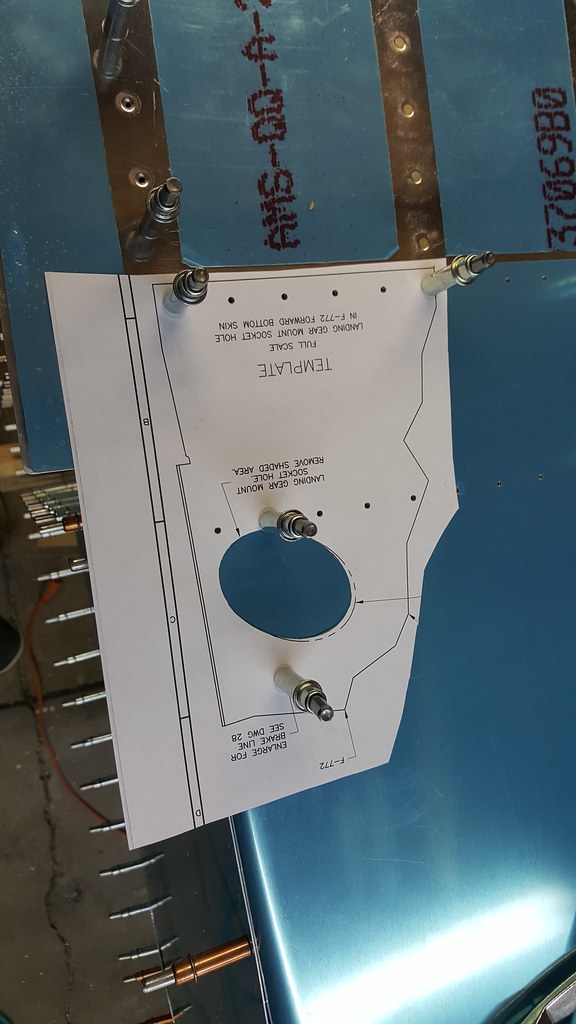

I also started the cut outs for the gear leg mounts. It got to about 10:15pm and I thought I better stop making noise. We will finish these tomorrow.
20180719_213213 by Jereme Carne, on Flickr

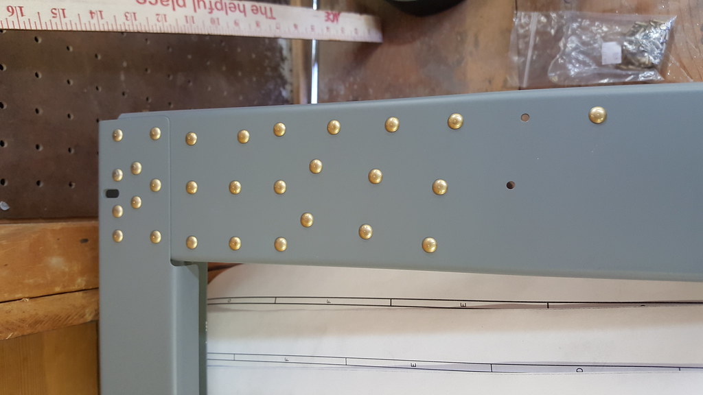

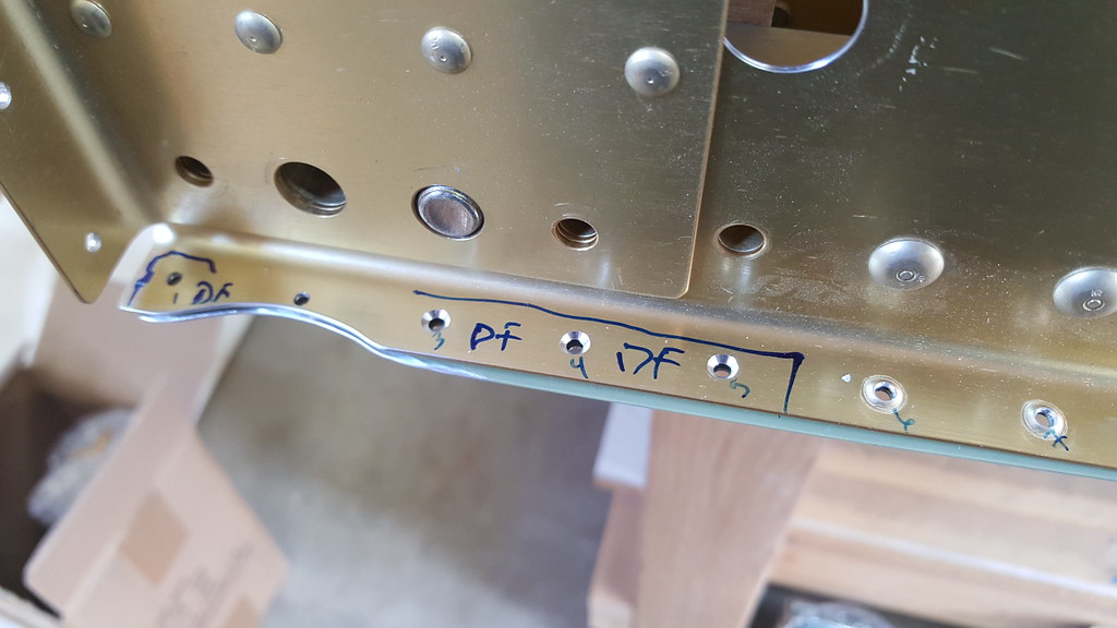

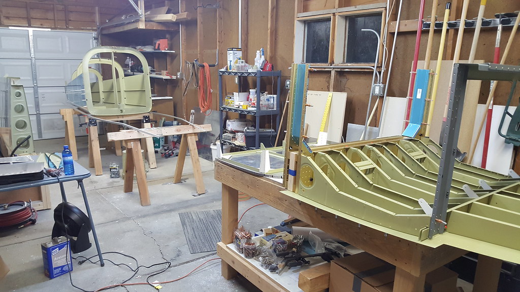

Man I tell you what, this forward fuselage was a tricky one. I made it through the whole thing without having to order replacement parts (so far).
There are quite a few spots that could get you in trouble with edge distance problems, just take your time and measure accurately.
Edge distance came out nice on these guys but it was time consuming to make sure I got it.

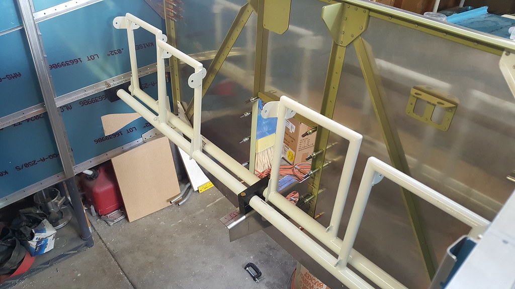

Kinda fun installing the rudder pedals. I drilled three positions for these guys, although I know I'm probably going to need to the most aft one since I'm flippin short! :)

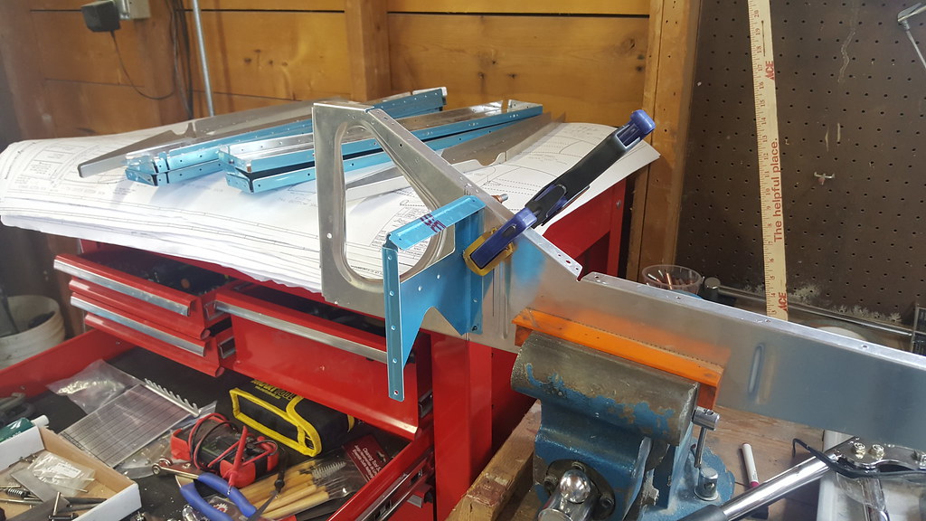

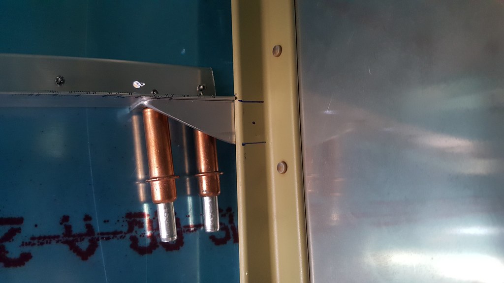

If you don't own a right angle attachment or drill it's time to get one if your approaching this part of the build, I had to use it in quite a few spots.
20180723_181241 by Jereme Carne, on Flickr
My right angle attachment couldn't get on the the aft most hole in these cover brackets so I got creative. Not in the picture was me with my other hand holding a cleco against the middle part of the drill bit to keep it straight instead of bowed.
20180723_184006 by Jereme Carne, on Flickr

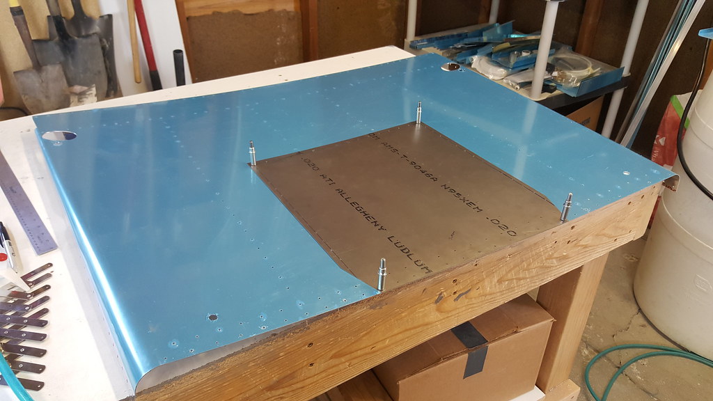

Well I'm deep into the deburring process of the forward fuselage (only two more skins and the longerons to go!

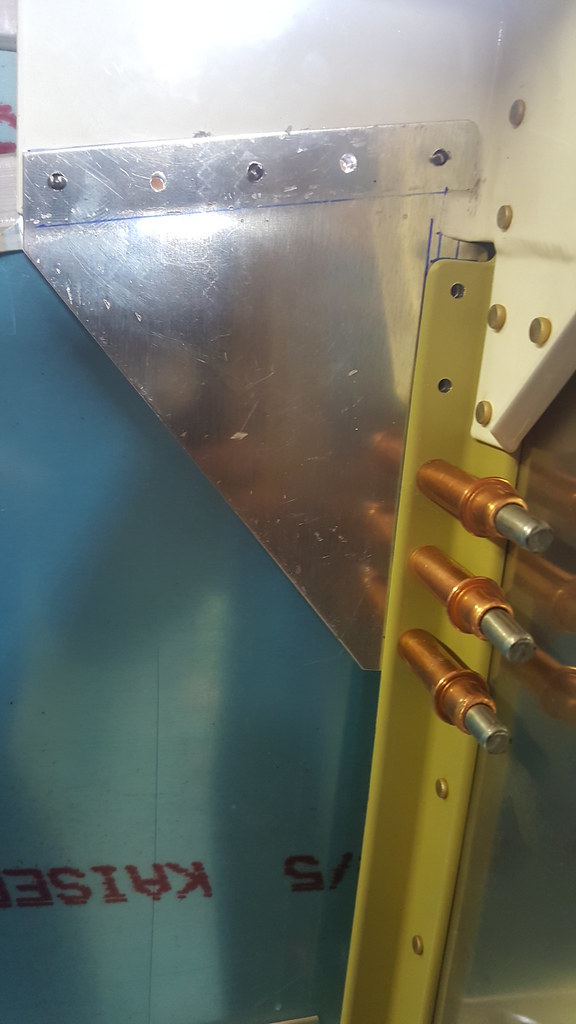

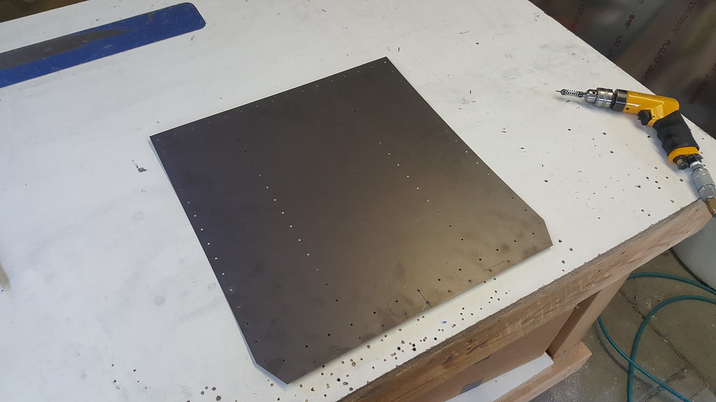

I thought I would post about how I made a small titanium belly skin in case of in flight fire. I have seen pics of the damage that can occur and the aluminum belly skin will often times melt where the cowling air exits, makes sense. I have heard of a few people doing this mod but I have yet to see it on a build log for a -7 so here it goes.
Also a big shout out to TMS titanium! They straight up spanked McMaster on pricing of this stuff and have tons and tons of different sizes to choose from. Packaging was quite nice as well.
Size: I made mine about 16 inches wide by about 18 inches fwd to aft. In the pic below you can see I had to trim the front corners a bit due to edge distance issues.
20180726_120741 by Jereme Carne, on Flickr
Fabrication: I found that it sheers very easily on a foot sheer but drilling it is different than aluminum for sure. It seems to like a slower speed and a little harder pressure. I don't know if this is accurate but that's what worked best for me. I then placed the 0.020 titanium on top of the bottom skin and match drilled it to the skin.
20180726_120946 by Jereme Carne, on Flickr
Then I moved it to the bottom and here you can see the final result. Not an overly big piece but I think it will do the job quite nicely. If anyone sees any problems with this I would love to hear!
20180726_123641 by Jereme Carne, on Flickr
I would say put it under both your feet, and add the fire barrier to boot!
"Firemax" Aircraft Spruce
I'll be slapping that stuff on the firewall for sure, been researching the Dan H threads on this. I think however I will go with titanium to cover it as the stainless foil looks like garbage (in my opinion) on the firewall (not a fan of the wrinkles). I didn't put the fibrax on the bottom but I was mainly just wanting to keep potential fire out of the cockpit on that one.
Prep for priming and painting of the fuselage parts is coming to a close. At this point all I have to do is debur the longerons and the aft fuselage holes. Tomorrow I will start priming and painting.
To countersink for the double flush rivets I had to really butcher my brand new right angle attachment. Oh well, it's not the first time...
20180727_152802 by Jereme Carne, on Flickr
The plans have you do double flush for the first five rivets on each side; however, I found with my gear that the first hole won't interfere, the second hole is pretty much pointless to put a rivet in, leaving only three to countersink.
20180727_152818 by Jereme Carne, on Flickr
Countersinking the longerons wasn't as bad as I thought it was going to be. Thank goodness for my Nova air drill, man I love that thing.
20180727_211231 by Jereme Carne, on Flickr
Seems like building an airplane is a two steps forward one step back kinda thing. :)
20180727_211843 by Jereme Carne, on Flickr
Your progess is awesome! Keep it going while you have the momentum. Also Thanks for mentioning Nova drills. See they're $120. Did you get the 4000 rpm? Did you get the keyless chuck?
I followed Dan's advice as well, to a degree, and determined that I am going to put firemax on the inside of the firewall and on the bottom skin inside under the second floor skin I am going to add.
Heat is what we are trying to keep out for the most part I believe, and fire of course ultimately.
I am going to call you "The Machine" from now on.
Because that is what you are, a Machine!
You primed all that and riveted it all in a few days!

Kent what do you mean inside? I just want to point out that if it's inside the cabin (aka on top of the 772 forward bottom skin) that would be a big big no no. Dan H has pointed out that this stuff smokes a lot when heated up and you certainly don't want that in cabin. I think however you probably meant under the skin but on top of the new skin and I just didn't understand properly. :)
