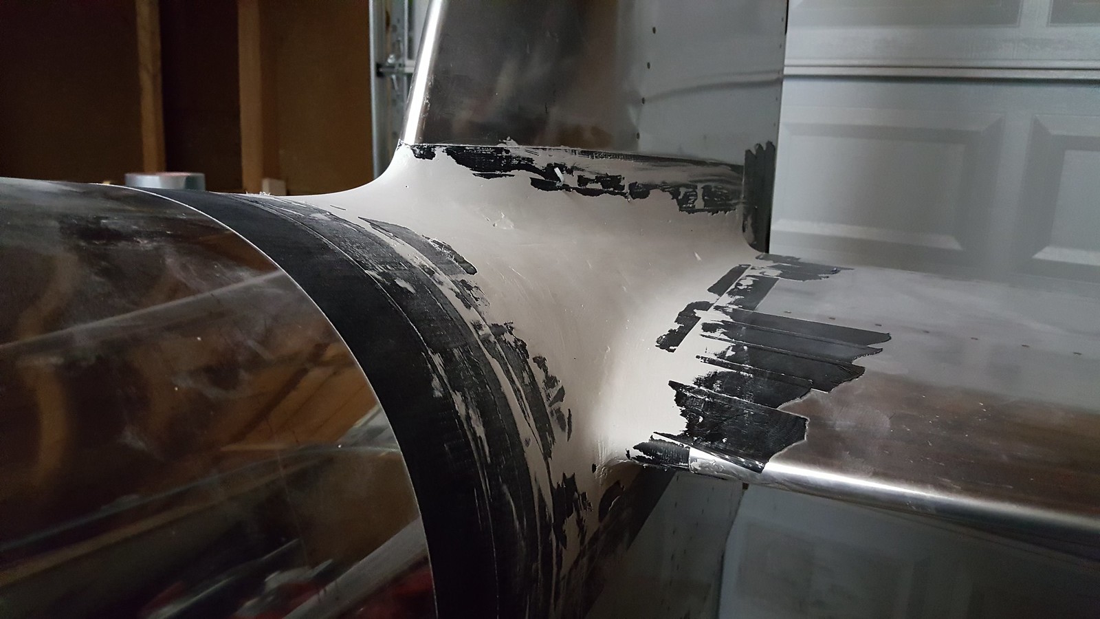

Glad to hear I'm not the only one Bob. I do think in the end I will be happier with the results. I was also planning on extending the bottom a few inches to go with less screws. I'm also thinking about doing fiberglass bottom sections too but we will see on that one.
Just a couple of small divots to fill in and a little more smoothing around the base of the hs but I think it's ready for lay up. It looks rough around the edges but I assure you it's smooth.

I see some waves there in the plaster. That will require filling - extra work and extra weight. Get a flexible sanding block of some kind and drag it at 45 deg each way to highlight the high spots. Much easier to fix in the plaster than in the final fairing. A true surface is more important than a smooth surface since this is a male mold. I know this is a ton of work to get to this stage, I've done it. That extra 2% at the end makes all the difference.
Will you coat the plaster with anything?
Thanks for the feedback, I'll go ahead and touch things up a bit. I know I'm probably going to have put a thick layer of micro on after the fact but mind as well get it as close as possible before hand. The picture may look a little different than in person as well as the multiple coats have somewhat of a different color as well.

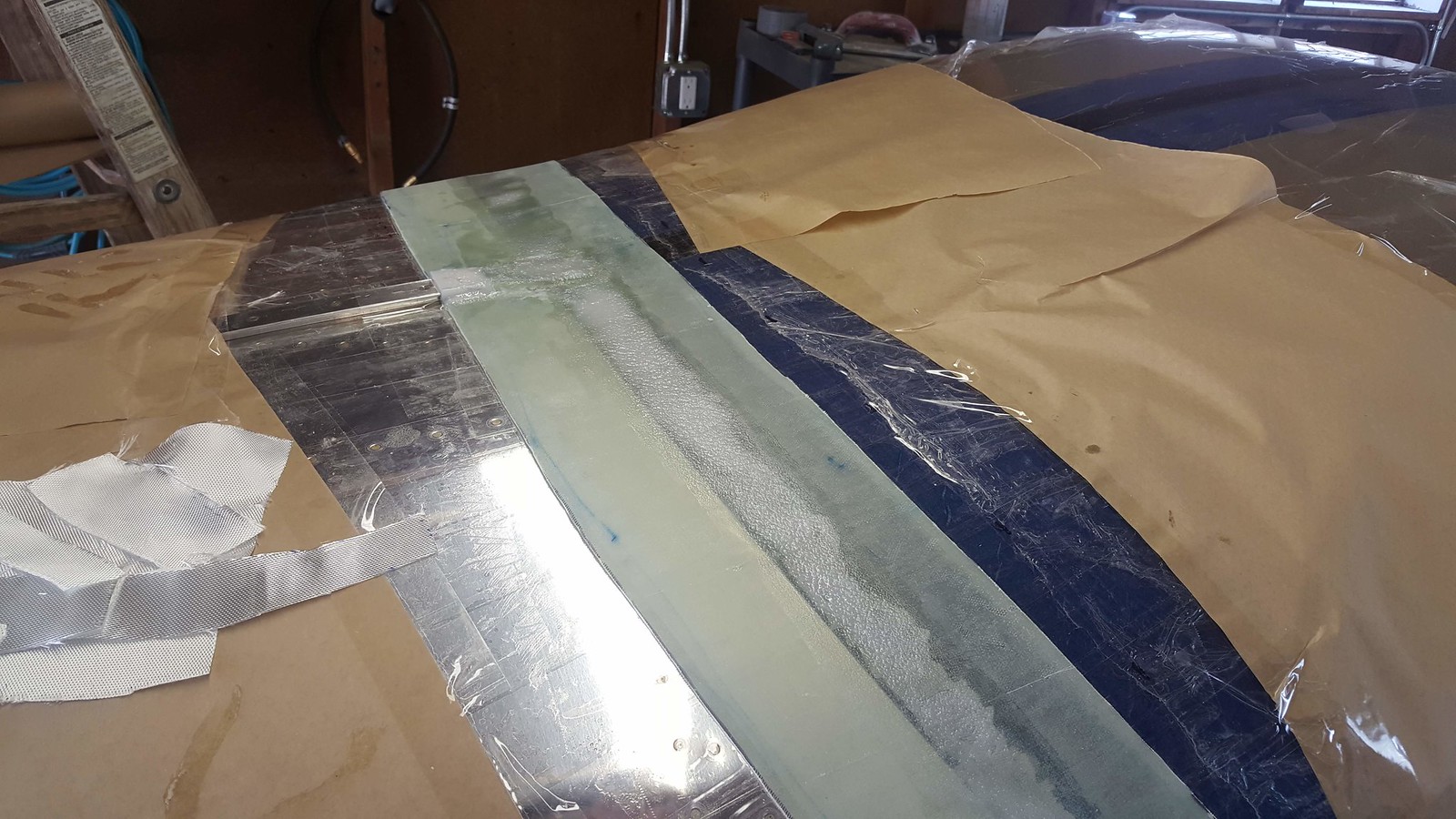

I was planning on waxing what you see (and taping a little more) before laying the fiberglass but would also like some recommendations if you have em.

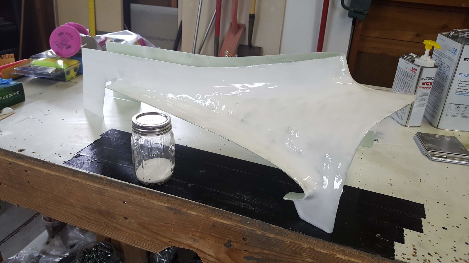

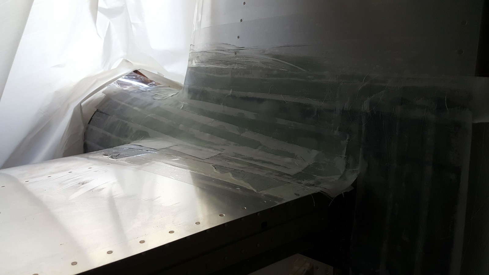

After making a little plastic hut around the tail of the plane it was time to layup the fiberglass. I first ran some tests and let them cure for a day so I didn't screw my large hours on making the mold because I knew it wasn't going to make it two rounds of layup. I used 4 plies of 7781 from Spruce for the layup, the part is quite strong after the fact. I waxed the mold after some more tape work and went to town. I used 4 mil plastic and wet the fiberglass between two layers of the plastic. Then I cut the pieces to size (a little larger than needed) and laid them on the plane. I overlapped in the middle by a few inches, it didn't leave as much of a hump as I thought it would, sanding and micro will take care of it no problem. Finally, I applied the only peel ply I had which was two inch (man I wish I had wider for this one!) The next day I popped the part off, the wax I used worked perfect and let the part go like it was no big deal.
Here it is all laid up. If you look closely you can see a bubble towards the top, it came off the VS about 1/16-1/8", I will fill the back a little and sand it down, no big deal. This was the only spot that it didn't fit perfectly to the fuse.
On a side note, it sure looks ugly at this point. haha :D

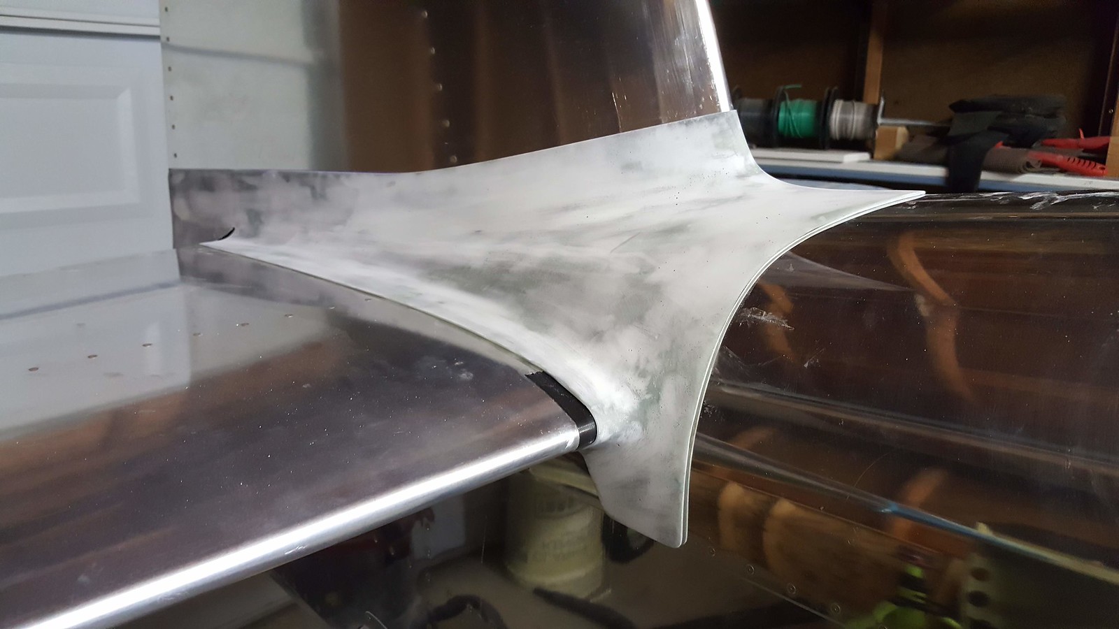

Here is the part after some trimming was done. As you can see I still have to extend the forward parts down and aft a few inches to really close it up. I simply couldn't get the fiberglass to lay down in this area nicely as one large sheet (probably because there was four plies in one?).
20190505_165526 by Jereme Carne, on Flickr
Overall I am really happy so far with how the part came out, it may not look like it yet but the contour is pretty dang good! The flat sections in the back came out a little wavy for my liking and I don't think I can use micro alone to fix it so I may have to do some trimming and re-glassing of that area but that's no big deal, it is nice and flat back there; or at least it will be. ;)

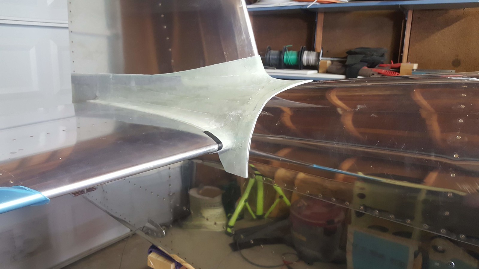

First up, I continued working on the empennage fairing. This thing is turning out to be emensly time consuming but oh well, good practice and I should get superior results. I did not like how the tails of the fairing came out on the first lay up so I did some sanding, forming, and layed up some new ones. These ones came out so much better!
20190608_141814 by Jereme Carne, on Flickr
Next I had to extend the front portions down and aft an inch or so.
Fiber glass is quite fun when you take an ugly beast like this...
20190610_140304 by Jereme Carne, on Flickr
...to this! That Dremel Saw Max I got works great on fiberglass!

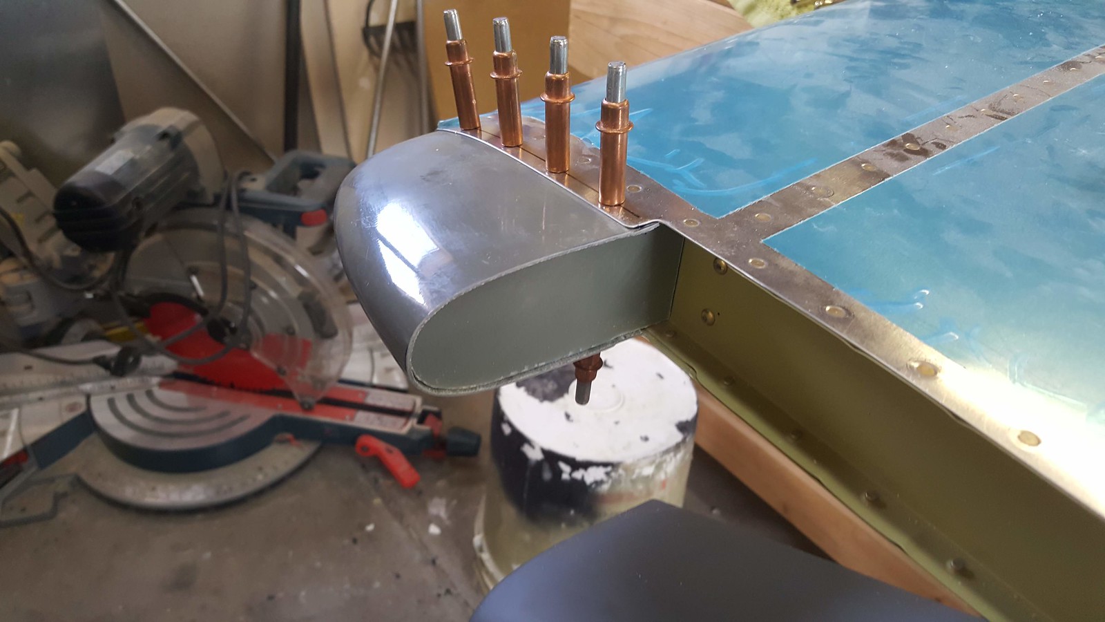

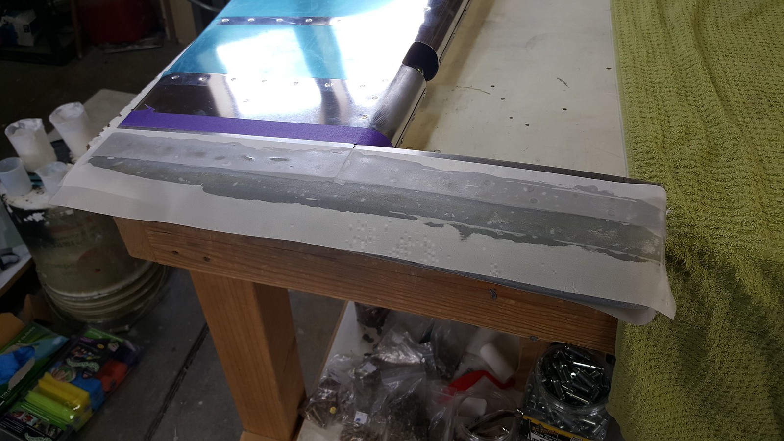

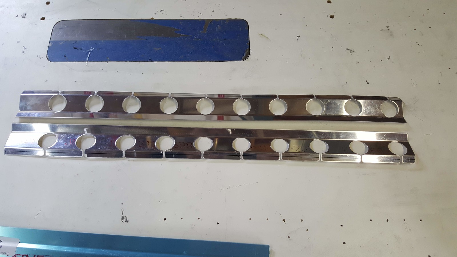

I also continued working on the tips for the elevators and rudder. I sanded the gel coat off of part of the tips since I plan on bonding them to control surfaces. Extra work? Absolutely! Personal preference that bonding looks better? Yup!
I also made backer strips out of 0.025 and bonded them in with epoxy.

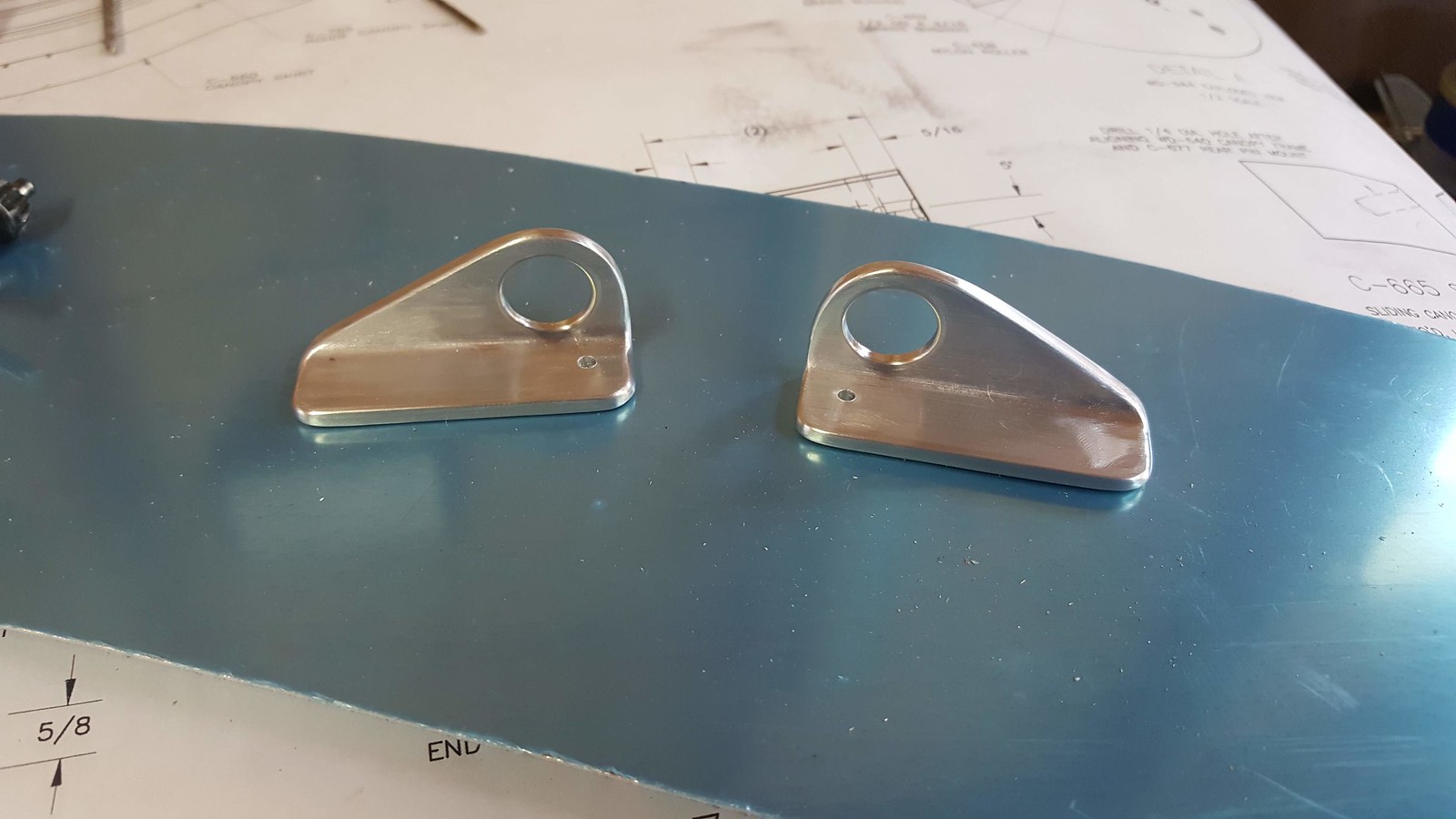

Finally, I am slowly working off and on on the canopy. I made the C-791 canopy skirt braces. These took a fair amount of time with deburring.
20190608_163510 by Jereme Carne, on Flickr

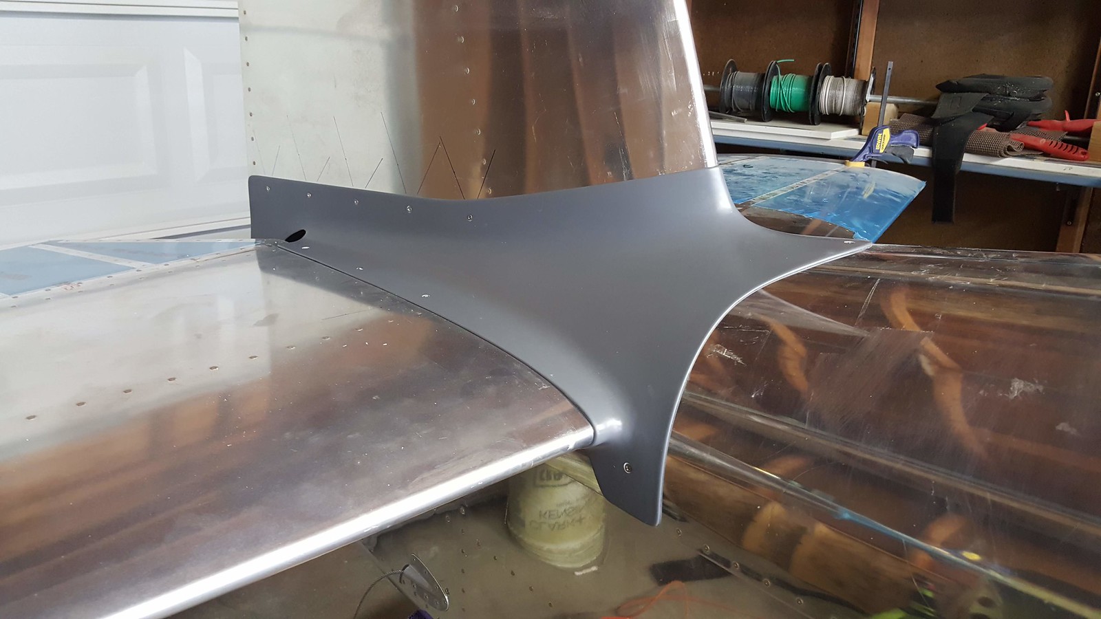

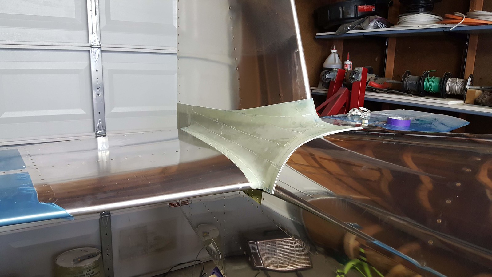

The fiberglass work continues! After the empennage fairing was all laid up how I liked it it was time to lay on some micro. As you can see in the pic I should have got it a bit more on the dry side but it worked out just fine.
20190611_123511 by Jereme Carne, on Flickr
Once the micro was cured it was off to the races with sanding blocks. I used these blocks with great results. Spray adhesive and sandpaper of choice was used (mostly 80 grit).
This is it after sanding, pretty ugly so far eh? :)
20190614_215244 by Jereme Carne, on Flickr

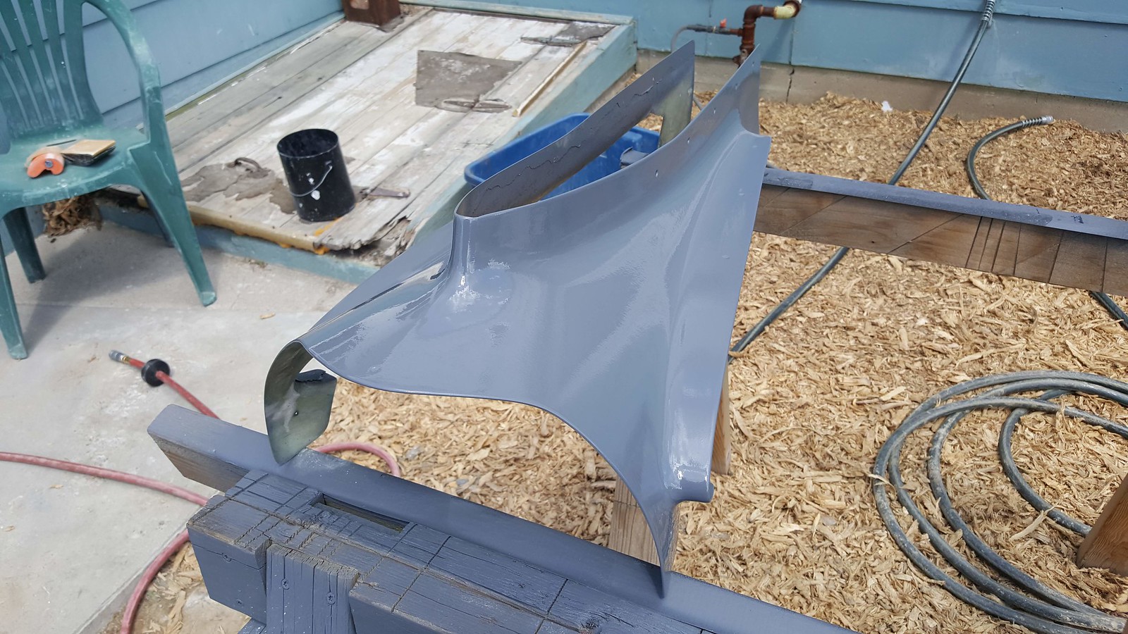

After the main sanding I located and drilled the screw holes I wanted and went ahead with countersinking. Then I laid down a bead of epoxy with cab-o-sil on all the seams after taping the tail yet again. The epoxy mixture squeezes out and bingo bango you got a perfect conforming edge. Next I did four coats of epoxy brushed on and squeegeed off with a credit card to fill pinholes. Once cure there was a bunch more sanding to make it perfectly smooth and get rid of any marks/pinholes.
...and finally the day had arrived, priming.
20190618_145531 by Jereme Carne, on Flickr
All in all it came out great and I'm really happy with it! It was a great learning experience and I feel I am now fairly competent with fiberglass. A big shout out to Dan Horton for his awesome posts on how to do fiberglass!
One more shot of the fairing on the plane.
20190619_122951 by Jereme Carne, on Flickr

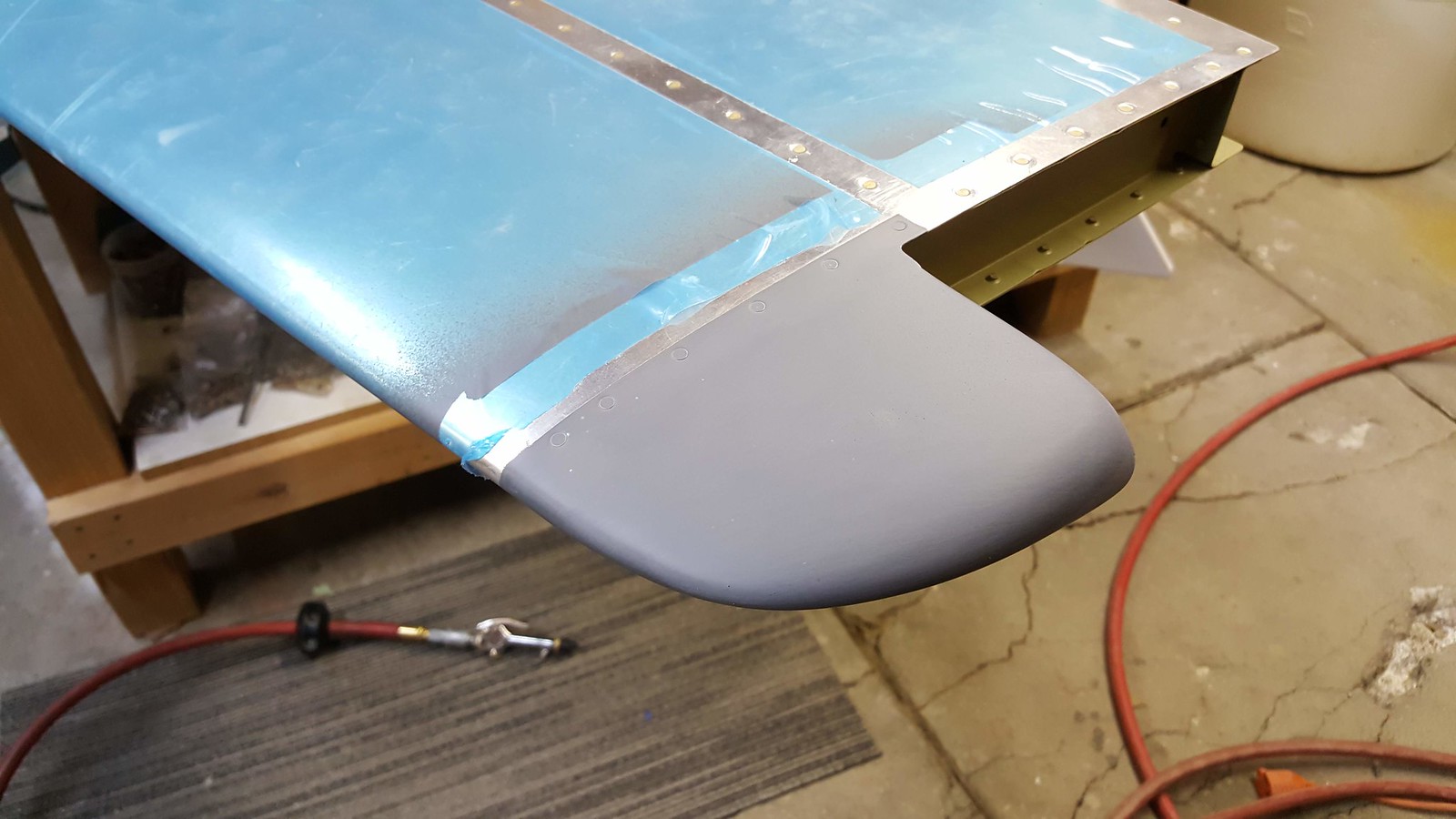

P.S. I also got the tips bonded and primed onto the rudder and elevators but I will just let this post sink in for a few days first. :D
Ok I finally finished all the tips and here are the results. I strongly recommend to people to do the tips when the weather is warm (unless you have a heated shop) and don't wait until the plane is almost done. The tips take a lot of time, way more than a person thinks. If my plane was almost done and I had to drop this many hours to finish them I might have cried. haha However, if you aren't blending them in like I did it will take way less time.

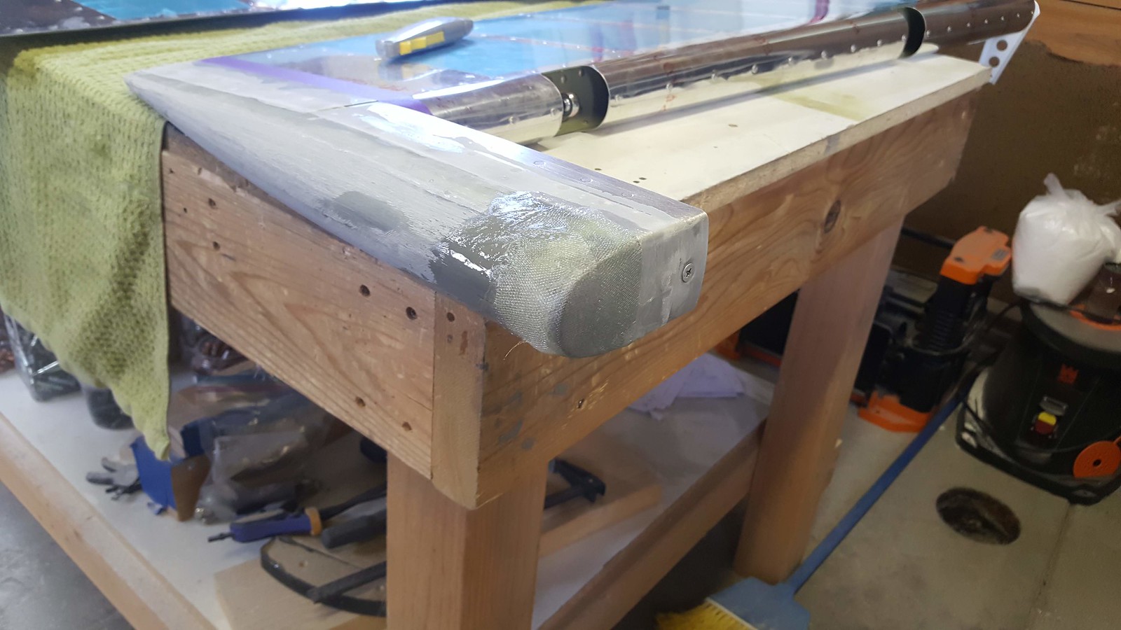

First, I laid fiberglass anywhere it was needed (elevators).
20190612_155246 by Jereme Carne, on Flickr

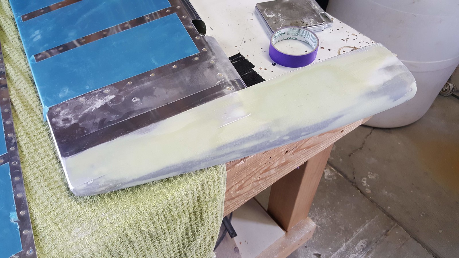

After curing and sanding the elevator tips I laid down a 2" wide layer of fiberglass that is only 0.003" thick, very thin stuff indeed.
20190611_161559 by Jereme Carne, on Flickr

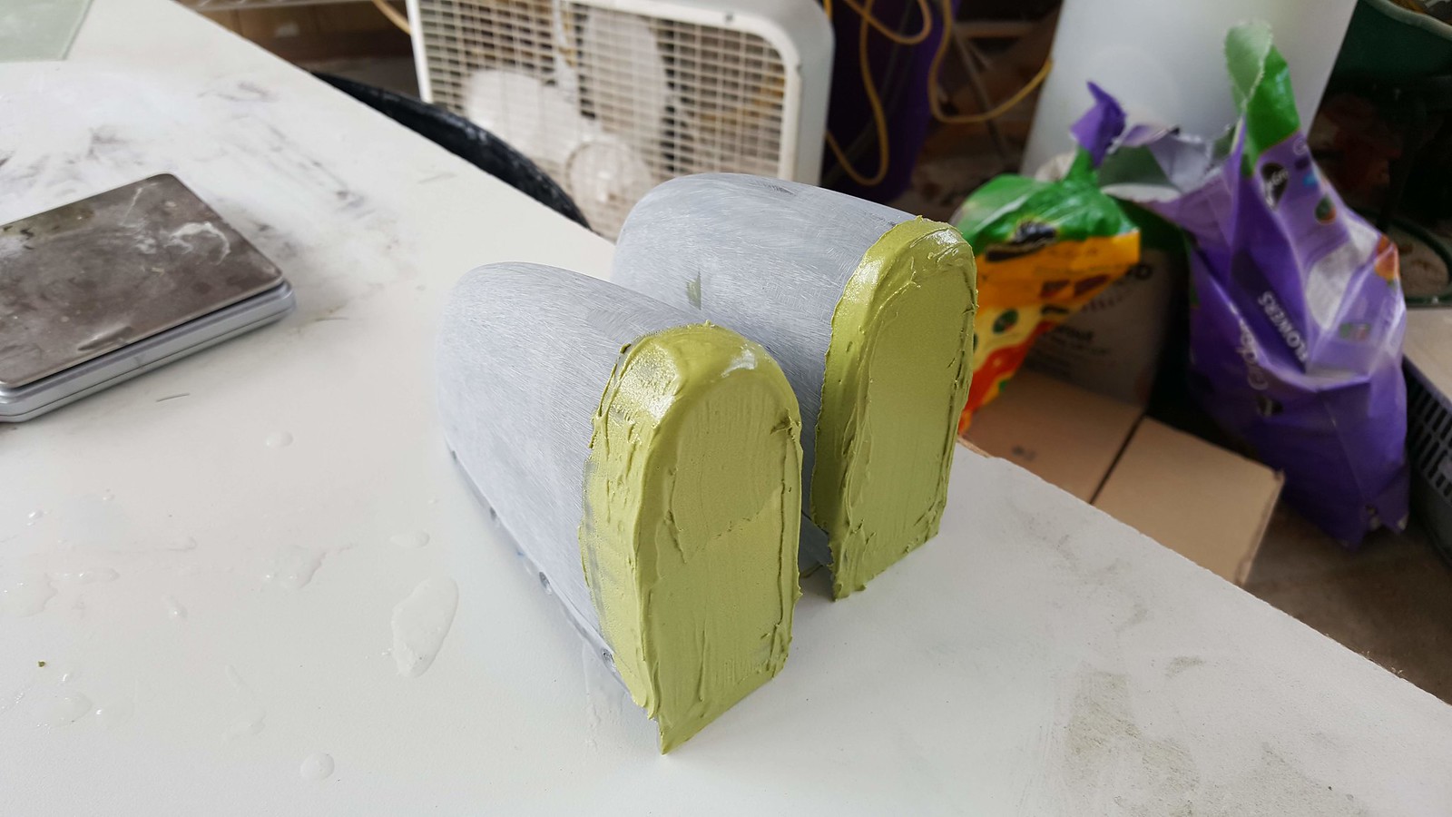

After curing and sanding the taped seam I then put a nice coat of micro on the whole thing.
20190612_155238 by Jereme Carne, on Flickr
After curing and sanding the micro I switched to Evercoat Rage Gold. This stuff is ready for sanding in about 20-30 minutes instead of a day as with micro. Some may scoff at using this stuff but I know many people that have used this and there planes have been flying with it for a long time. To be honest I don't even know why a few peeps have beef with this stuff? I personally would highly recommend it and it's meant for fiberglass too.
20190617_101139 by Jereme Carne, on Flickr
Here sanding is almost finished. Looking pretty good.
20190617_180404 by Jereme Carne, on Flickr

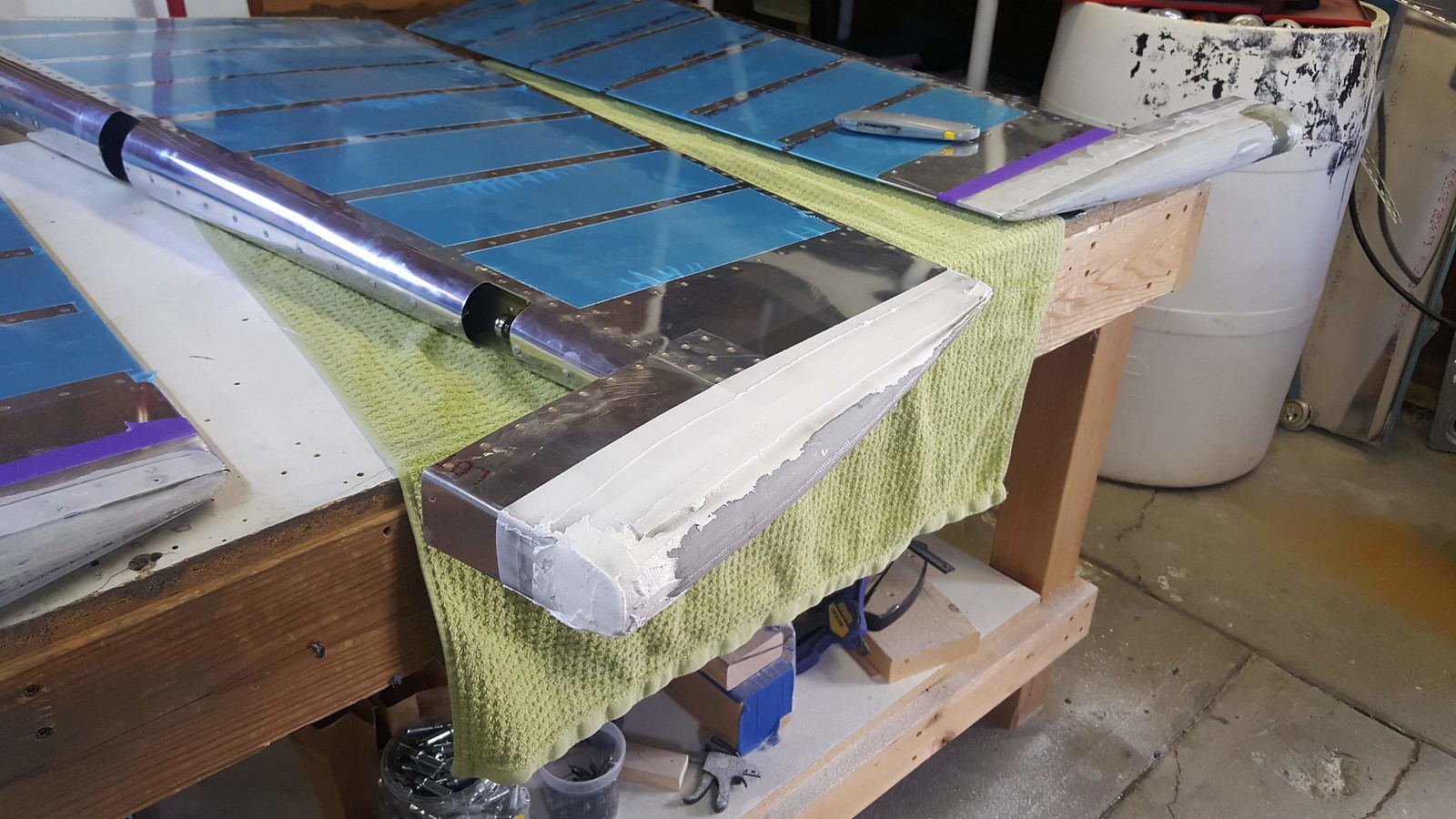

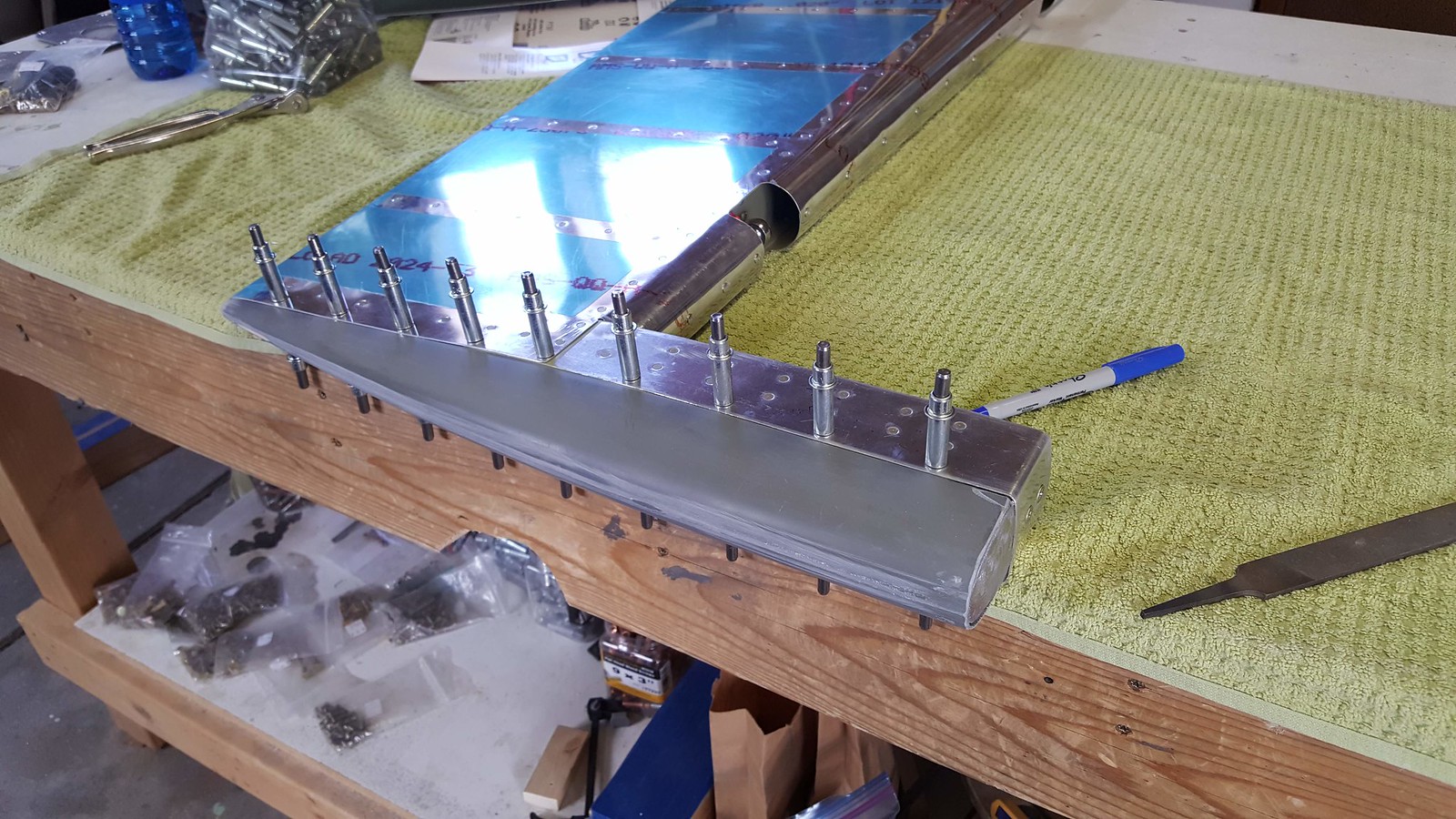

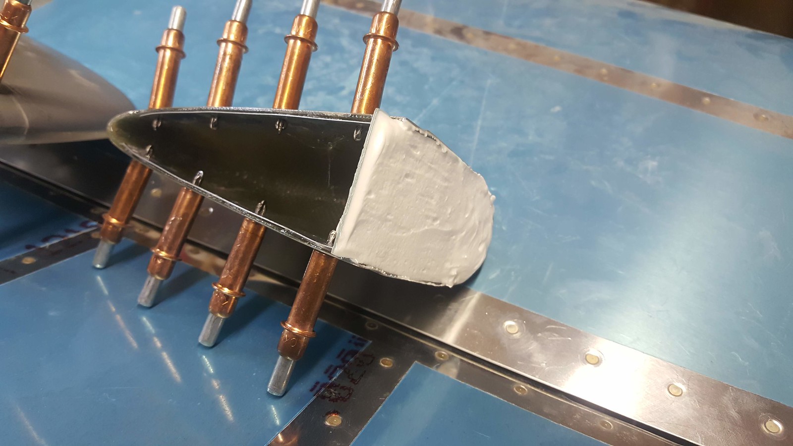

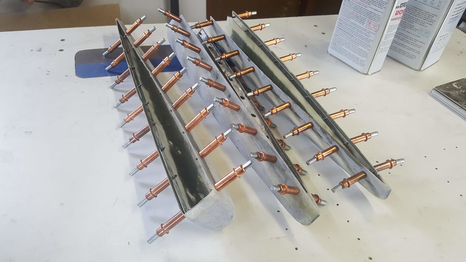

Next it was on to the VS and HS tips. First you need to close out the tips. There are many different ways to do this but I chose to use some flat layup I had out of 4 plies of 8.9 ounce. Shape it to fit, 5 min epoxy it in the correct spot and then I put a bead of flox on the inside with two more layers on top of that to really seal it up.
20190624_141921 by Jereme Carne, on Flickr
Nice I put a coat of micro on the area shown and epoxied in the metal backing strips. Van's doesn't tell you to put a metal strip there but after countersinking the fiberglass it is quite thin where the rivets go through.
20190624_212039 by Jereme Carne, on Flickr

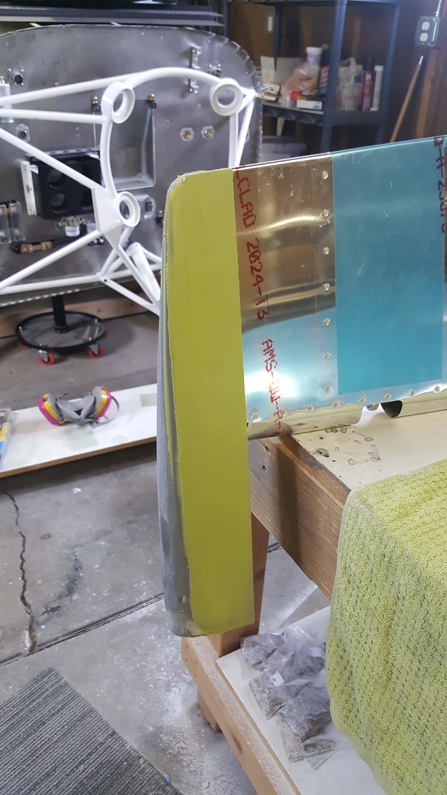

After curing and sanding I put a layer of Rage Gold on. Almost all of this got sanded off in the end.
20190625_110728 by Jereme Carne, on Flickr

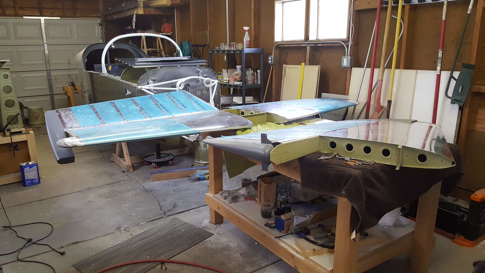

Here are all the parts being worked on. A full bench for sure.
20190625_164614 by Jereme Carne, on Flickr
Finally it was on to primer. I busted out the Kirker epoxy primer and sprayed any remaining parts. Here you can see one of HS tips. I still need to do a little detail sanding and fill a few tiny pinholes but they are all good to go.
20190627_230640 by Jereme Carne, on Flickr

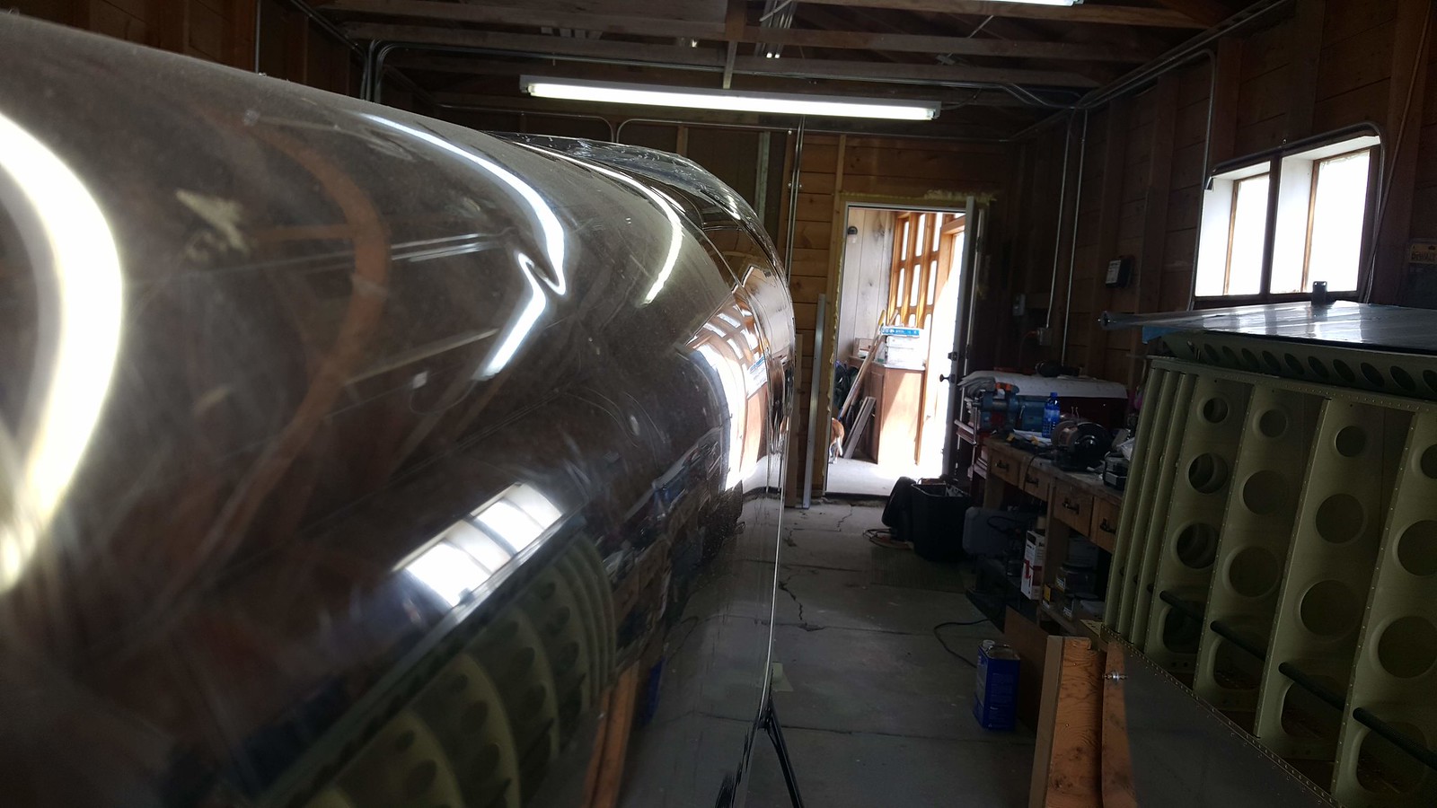

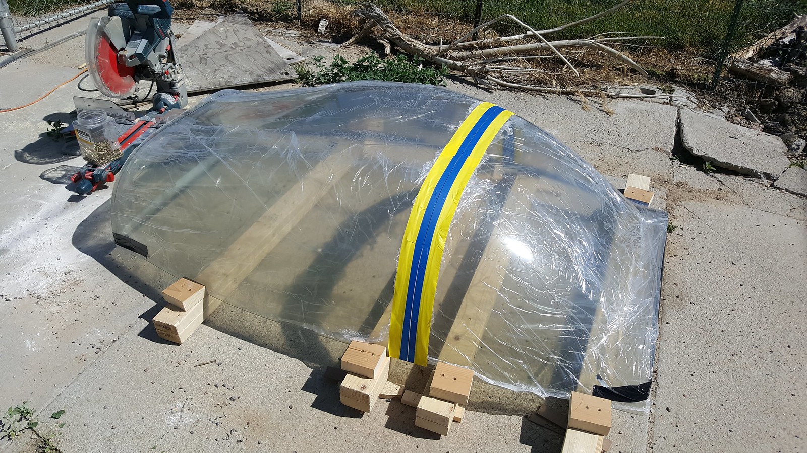

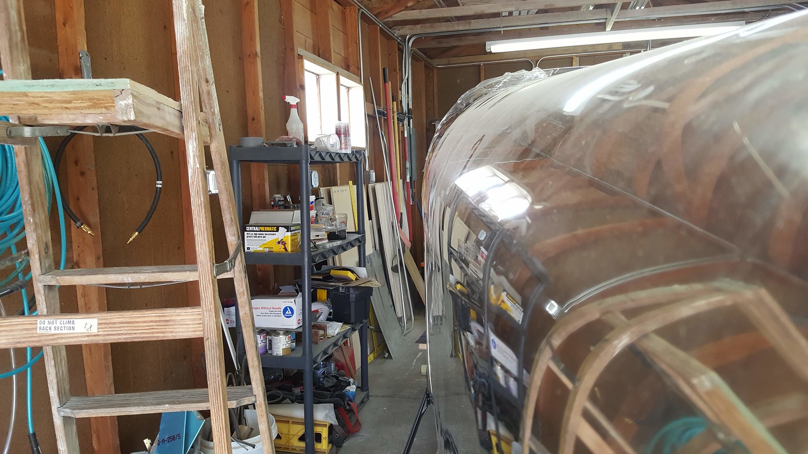

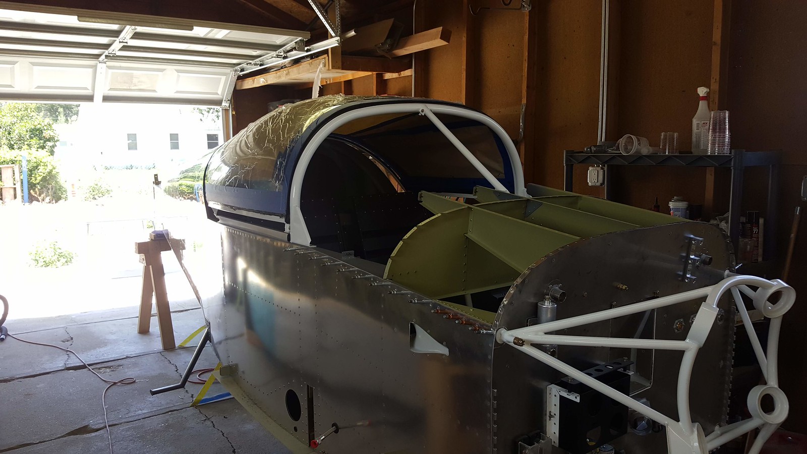

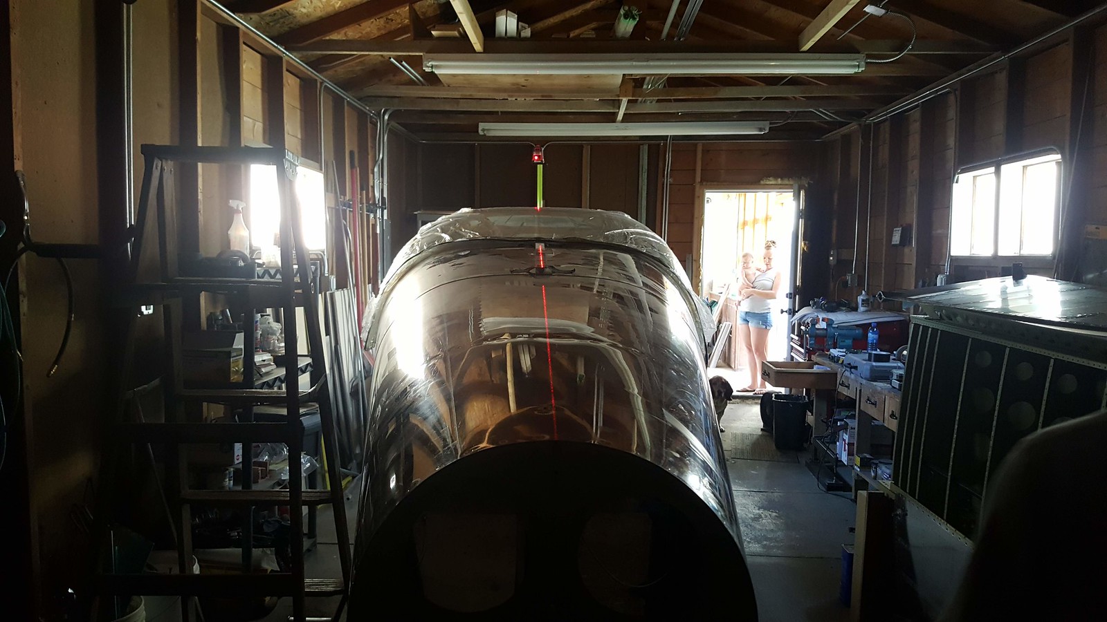

Finally it is warm enough to start working on the canopy. I had my dad come over to help me move it around. All we did was put a centerline on the outside and mark for the hole to be drilled for the handle. Tomorrow I will start cutting the canopy. :eek:
20190628_184244 by Jereme Carne, on Flickr
I spent quite a bit of productive time in the garage today. It was finally time to start cutting the canopy. I have dreaded this step as many other have before me. In the end it wasn't too bad. I still have plenty of cuts to make but this was a big one.

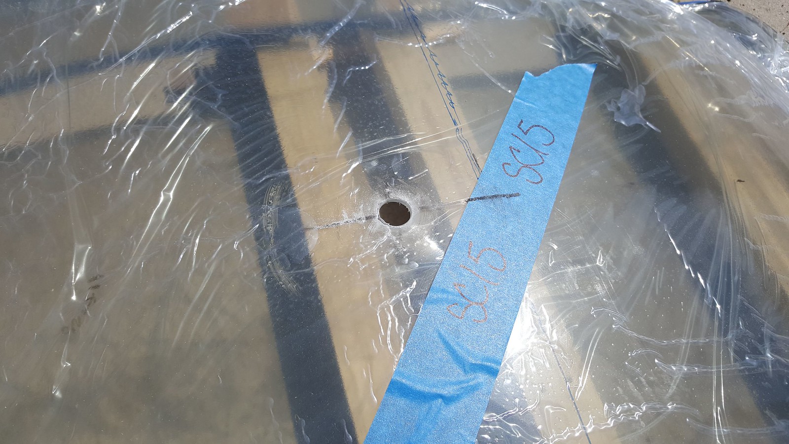

After sanding the edges up to 240 grit I drilled and sanded the hole for the canopy latch handle. I thought drilling a hole in the middle of my canopy would make me feel all frightened inside but this was the easiest part of today. I used a unibit and it went through it no problem at all.
20190629_155635 by Jereme Carne, on Flickr

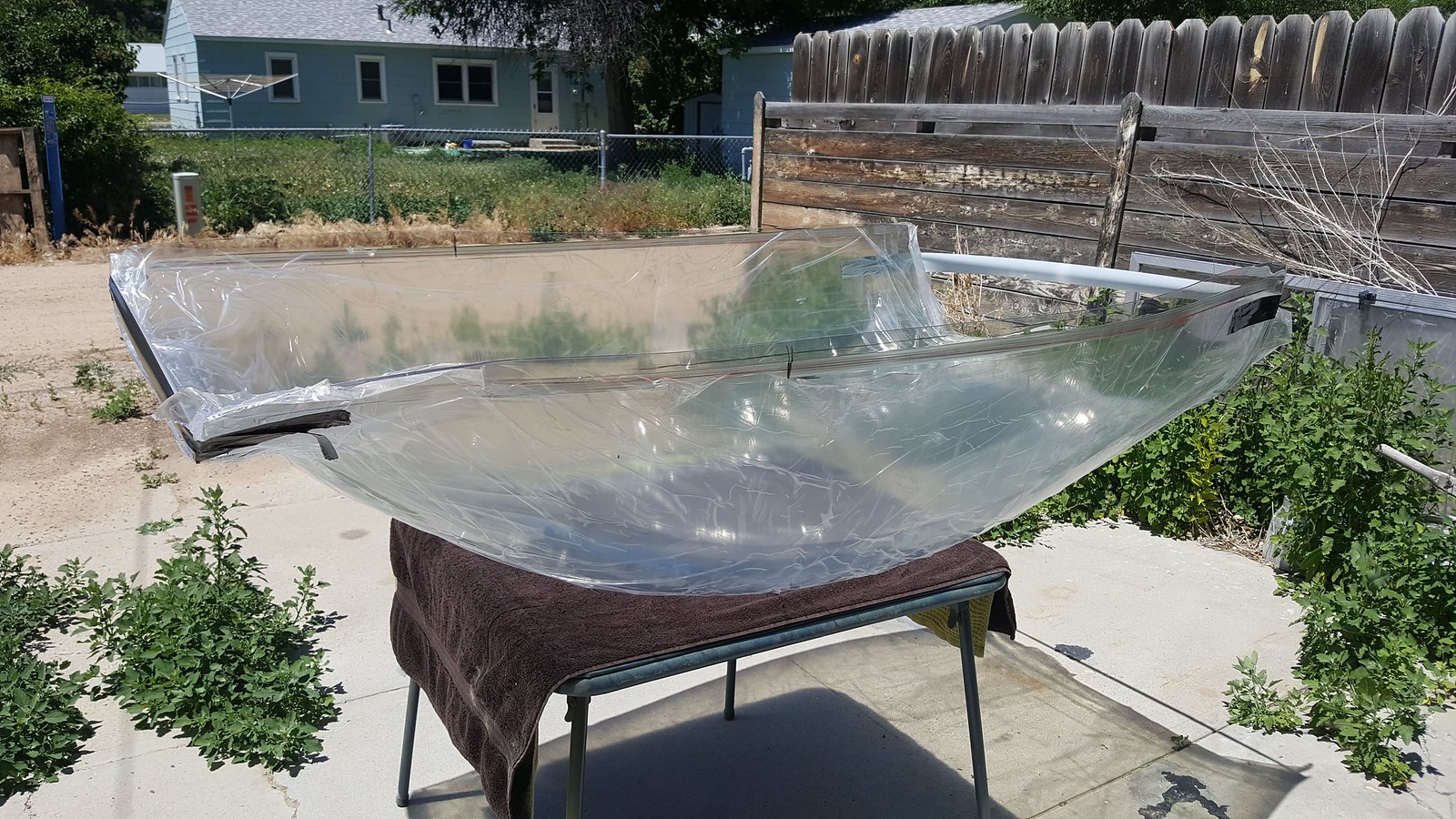

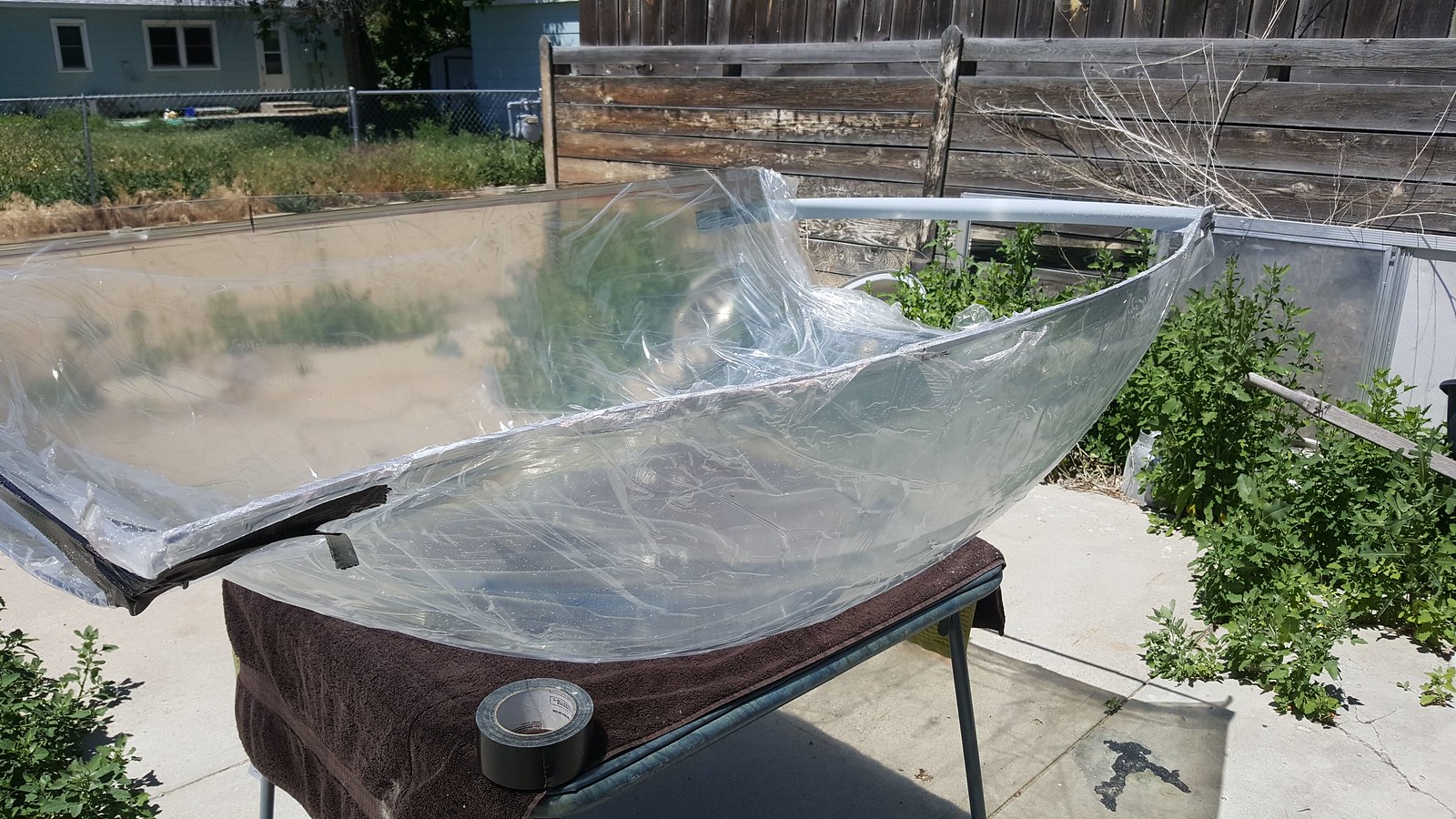

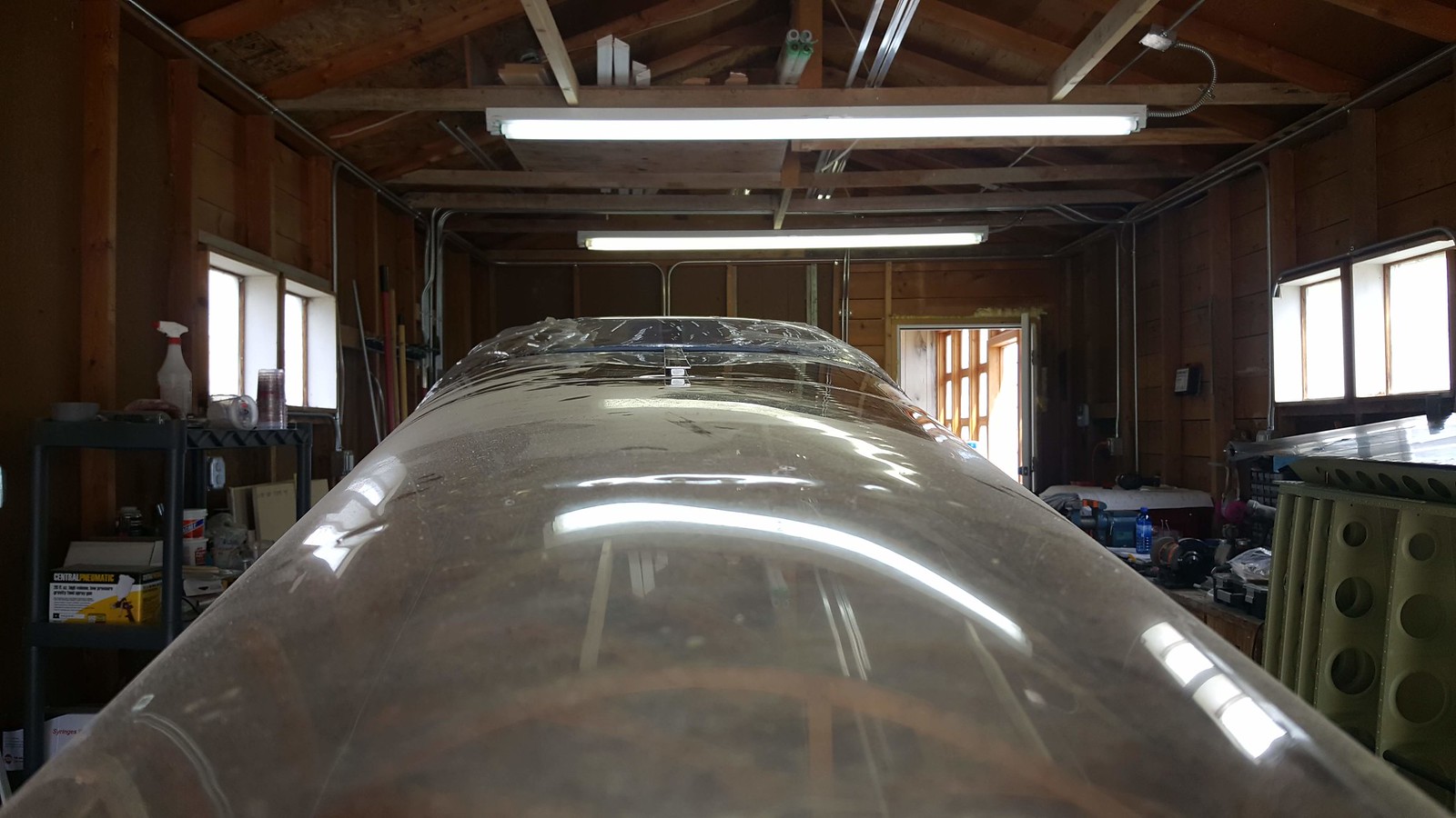

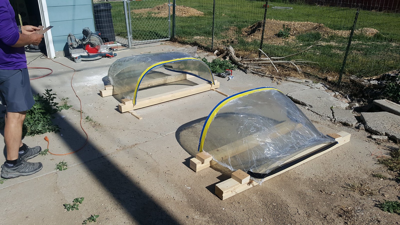

Next I clamped the canopy frame in the plexi bubble so that I could mark the cut line for the "big cut". After the line was drawn on the inside of the canopy I put lines of tape on the outside so that I could easily follow it with the saw.
20190629_161139 by Jereme Carne, on Flickr
Finally, it was time for the "big cut". It wasn't as stressful as I thought it was going to be and it didn't take as long either. The Dremel Saw Max with the SM500 blade goes through plexiglass like a hot knife through butter. Tip: spend as much time as it takes to make the canopy sit with as little stress as possible and install stops to prevent it from wanting to spread out.
What a beautiful sight; I mean not as good as it being completely finished but I'll take this victory! :D
20190629_170938 by Jereme Carne, on Flickr

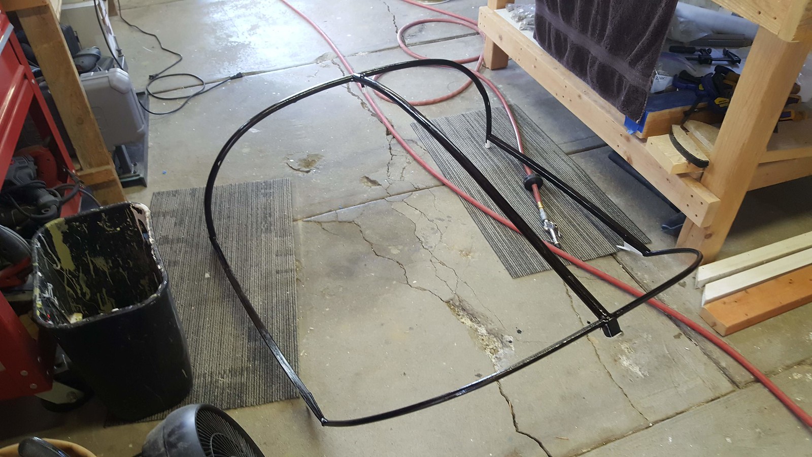

After the cut I busted out my variable speed belt sander and cleaned it up with 120 grit followed by 240. This is smooth enough to start moving the pieces (so I've been told). Once I moved the pieces I spent some time on the windscreen wet sanding it with 400 grit and rounding the edges a bit since I won't be cutting this piece for a little while.

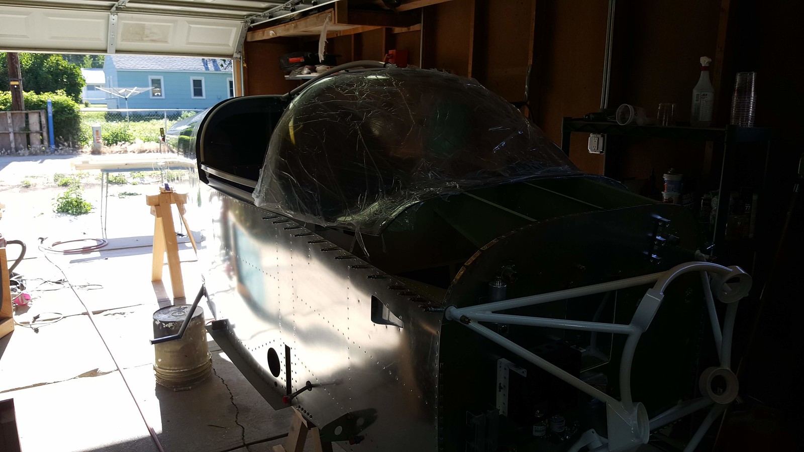

I also placed the canopy frame back in the large half and clamped it down. I made marks for my next cut. I will try and cut the aft bow section tomorrow and hopefully finish up all my cutting on Monday.
Took this next pic just for fun. It seemed like the best place to store the windscreen temporarily.
20190629_181617 by Jereme Carne, on Flickr
P.S. can you tell I neglect my house duties from time to time based on the weeds growing? Haha I call it priorities and I don't think mine are mixed. :D

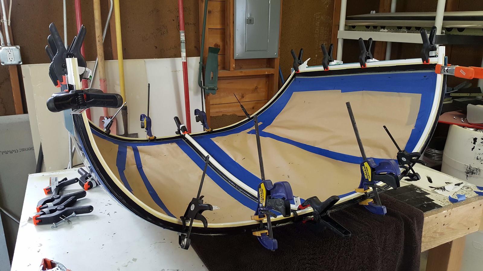

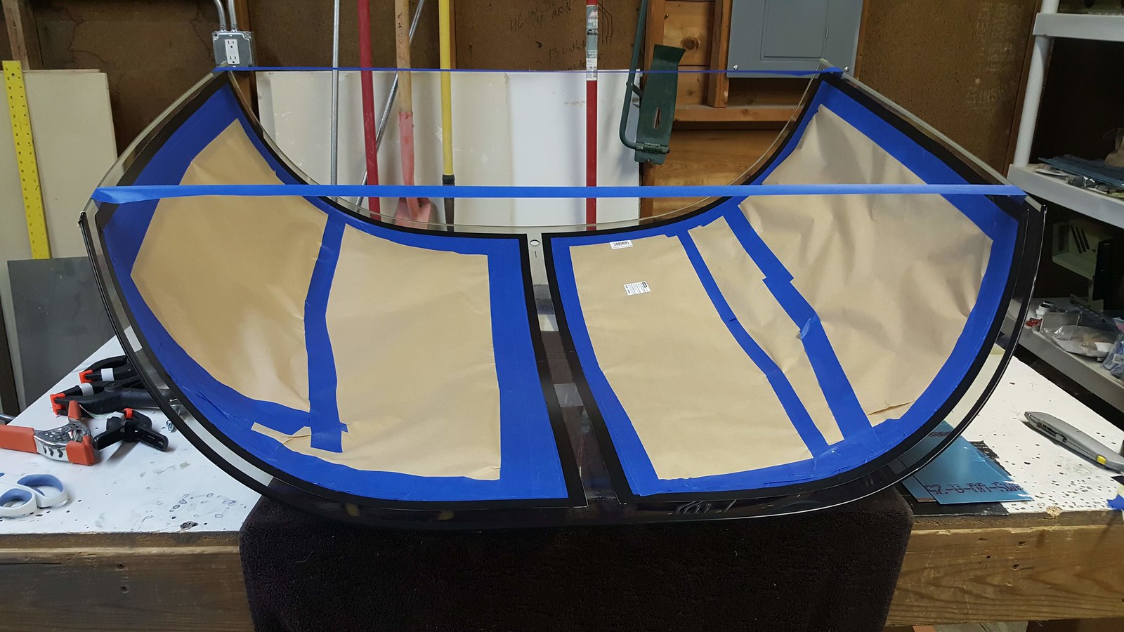

The canopy work is going strong in this garage. After making another big cut on the aft end and a couple on the sides the canopy was almost ready to be glued on. I sanded the edge of the plexi all the way up to 600 grit which took me most of a day but you want it smooth! After the sanding was done I clamped it to the frame, took some measurements to make sure I didn't need anymore pre-bend, and masked off the canopy.

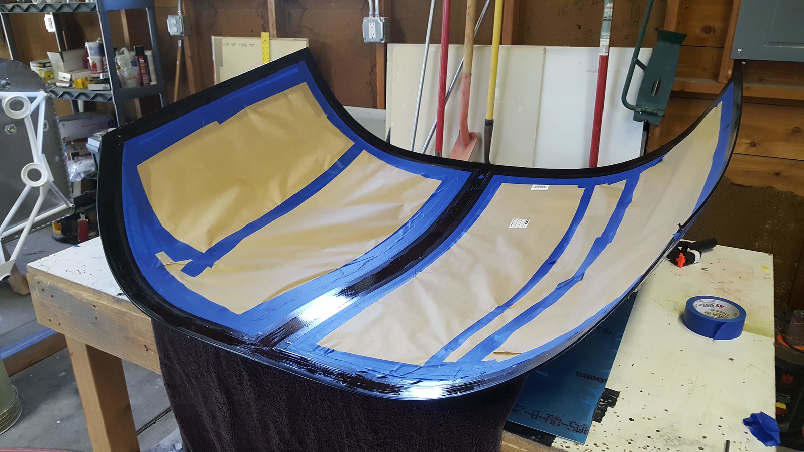

Here is the canopy ready for masking.
20190701_165520 by Jereme Carne, on Flickr
All masked and ready to go. I used 3M fineline tape followed by electrical to the same edge and then painters where appropriate.
20190701_224826 by Jereme Carne, on Flickr

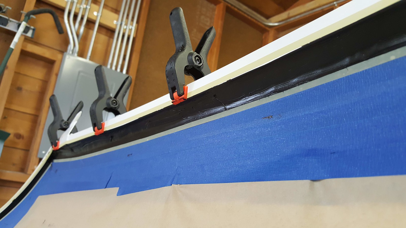

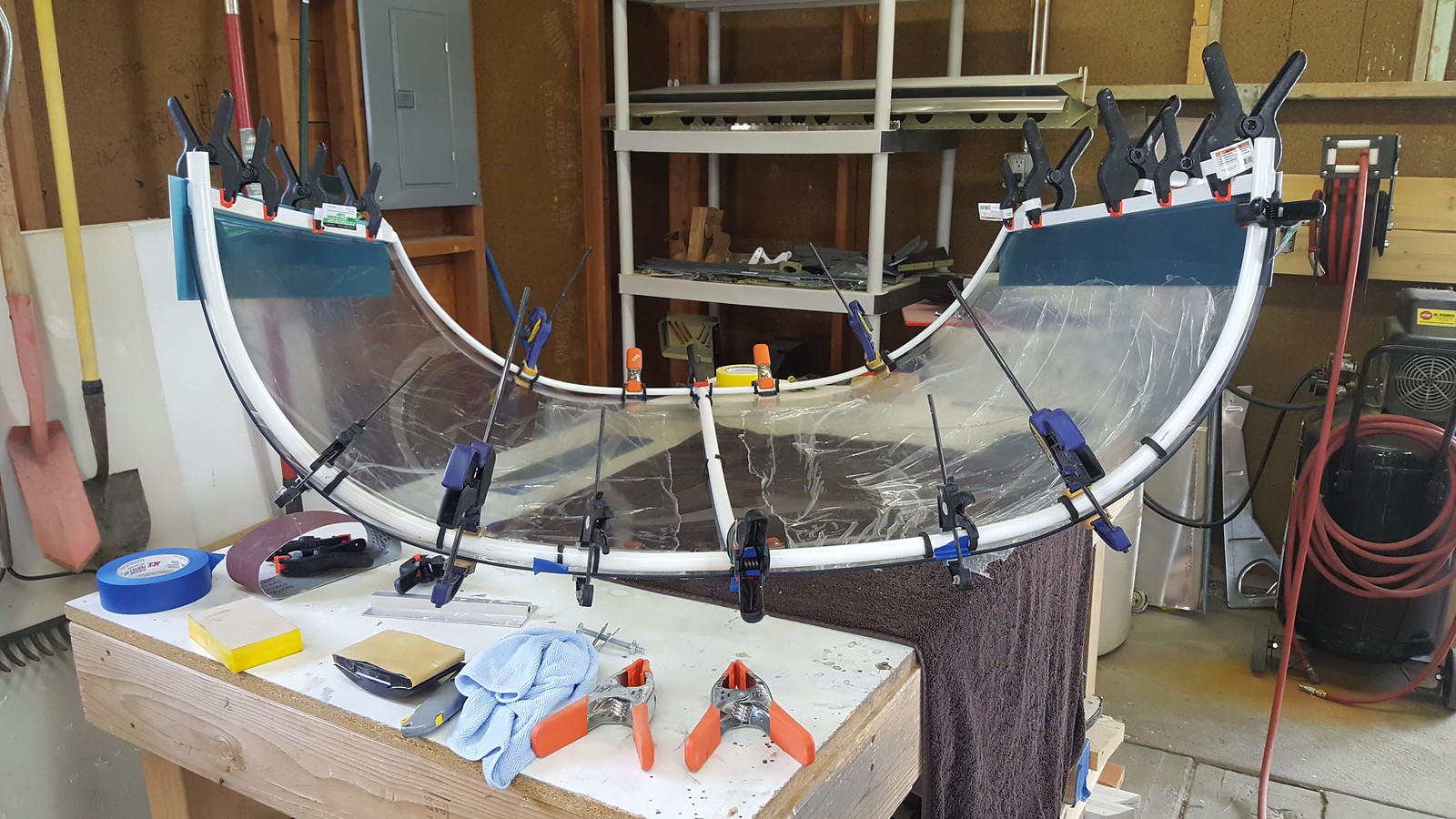

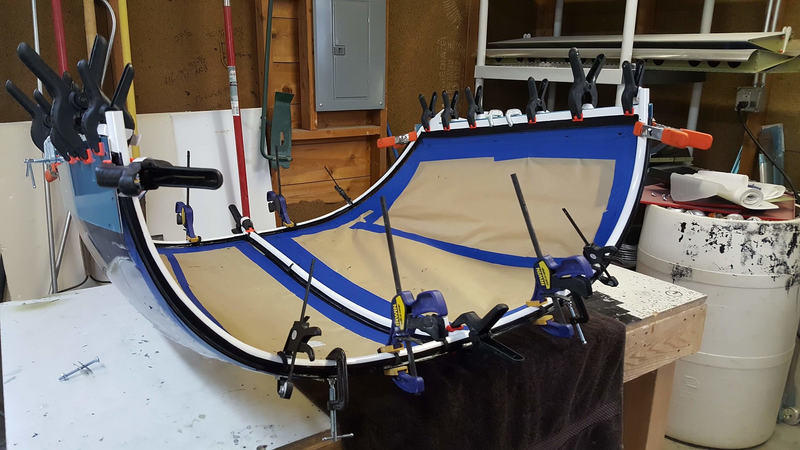

Soon it was time to start the Sika process. I first scuffed everything with maroon scotchbrite and some 150 grit here and there. I then used a damp microfiber cloth to wipe up any dust. Then the aktivator was applied (Sika 205). After waiting 10 minutes it was onto the primer (Sika 209D).
Here are the parts primed and ready to go.
20190702_120505 by Jereme Carne, on Flickr
20190702_120510 by Jereme Carne, on Flickr

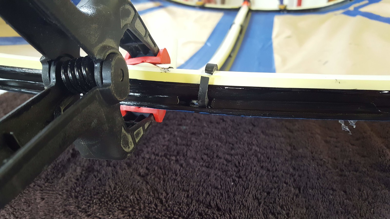

After 30 minutes from primer being applied I clamped the frame on with spacers and started running the Sika 295 UV beads. In the pic below you will notice I used hand clamps and not spring clamps on the forward and aft bows. If you use spring clamps the canopy gets distorted in areas which also locks stress in. I used these clamps with light pressure to try and avoid that as much as I could.
20190702_131834 by Jereme Carne, on Flickr
Here it is after tape removal.
20190702_140704 by Jereme Carne, on Flickr

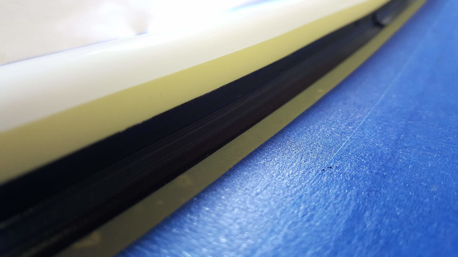

Here you can see the first bead is held just off of the spacers so you can pull them out easy.
20190702_131840 by Jereme Carne, on Flickr
This is the elusive side bow area. I say that because I had a HECK of a time trying to find out how people addressed this area. Some use the C-759 inside canopy skirt and some don't and opt for a big bead. I took the ladder route. To be honest at 160PSI for Sika it wouldn't surprise me if this method is stronger too. (although both are plenty strong)
20190702_131854 by Jereme Carne, on Flickr
Lastly, here is one of my first coat beads. I read a lot of people say that Sika is hard to get a nice bead with; I did not get the same feeling. It just seems about the same as your typical Alex caulk that you use for trim, relatively easy to spread nicely.
20190702_131848 by Jereme Carne, on Flickr
This is all just a first coat and I have to do another "pretty" coat in a few days.

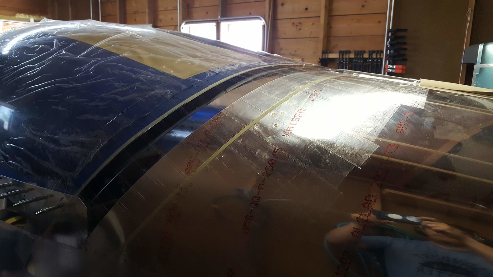

Canopy work continues. The main focus the past few days has been to get the canopy ready for layup of the fiberglass skirt. I think I may be able to start that tomorrow.
After putting a finish coat of Sika on it was time to put it on the plane and see how it all lines up. Overall I am very pleased with it. The only squawk is that the front is a little narrow by about 1/8" of an inch. No big deal, it still slides nicely, I may shave off a 1/16th from the rollers eventually but right now I'm happy. When I put the canopy on the plane I also put the windscreen on with the proper spacers so I could measure how much of the forward roller tubes needed trimmed. I needed to trim a 1/4" to get the canopy down enough to perfectly line up with the windscreen. After that I installed the roll bar bolts and the support. I also installed the track after positioning it such that the aft side of the canopy lines up nicely with the turtle deck.
20190707_135249 by Jereme Carne, on Flickr
Here are some pics of how it conforms to the turtle deck skin, quite happy indeed.

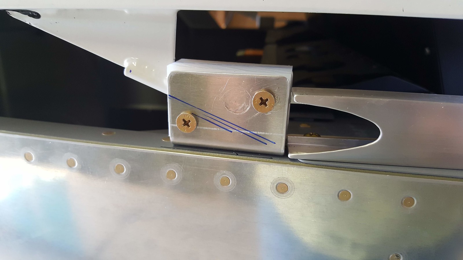

I also followed the directions on installing the C-677 pin mounts. It wasn't as difficult as I thought it was going to be. (yes I know they still need countersunk) :) The aft lower bolts that hold the block in doesn't have much clearance to the pin so watch out for this when you install them.
20190707_164410 by Jereme Carne, on Flickr

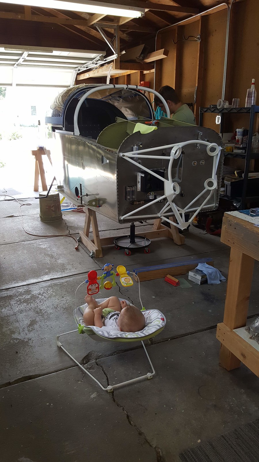

Bonus: When the wife says watch the kid for a moment and there is no dust/chemicals flying in the garage it's time for a teachable moment. :D

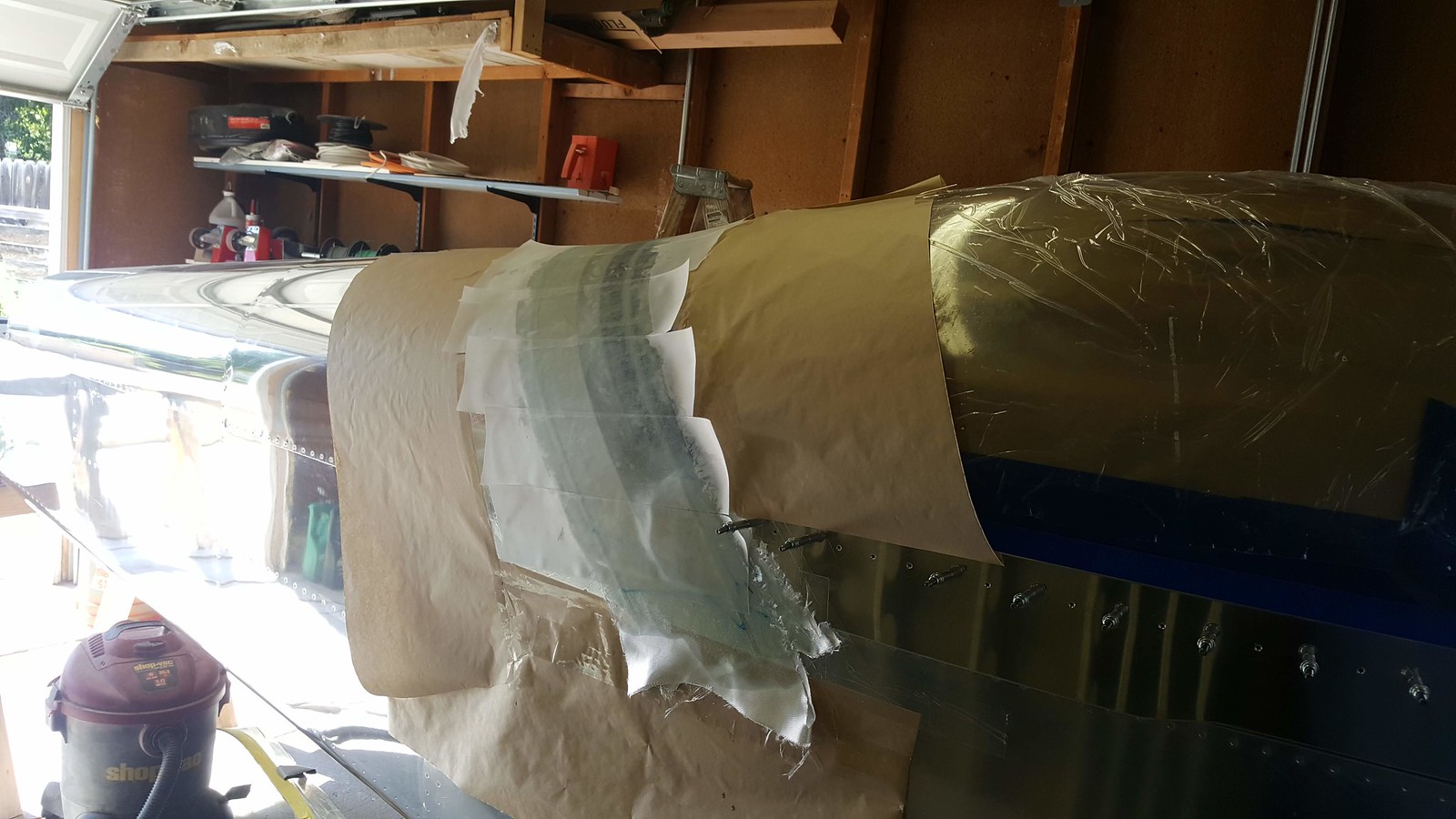

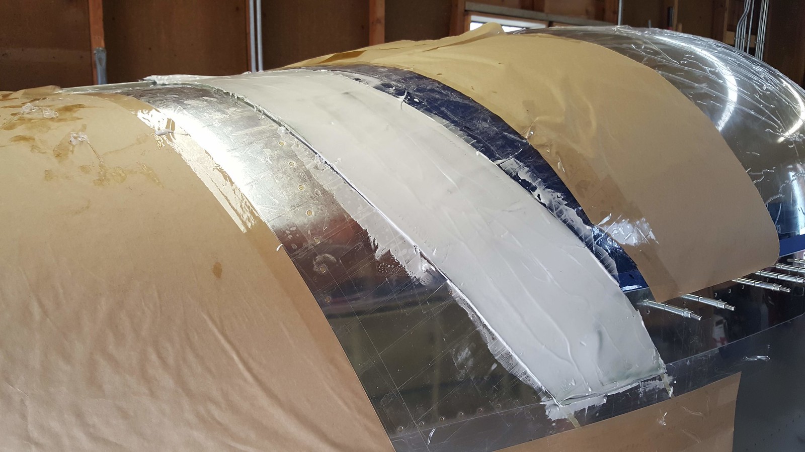

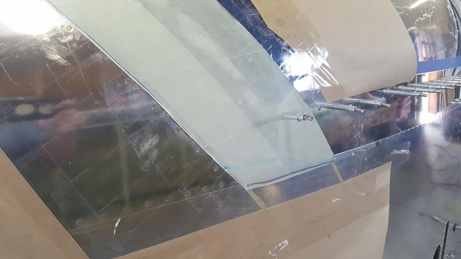

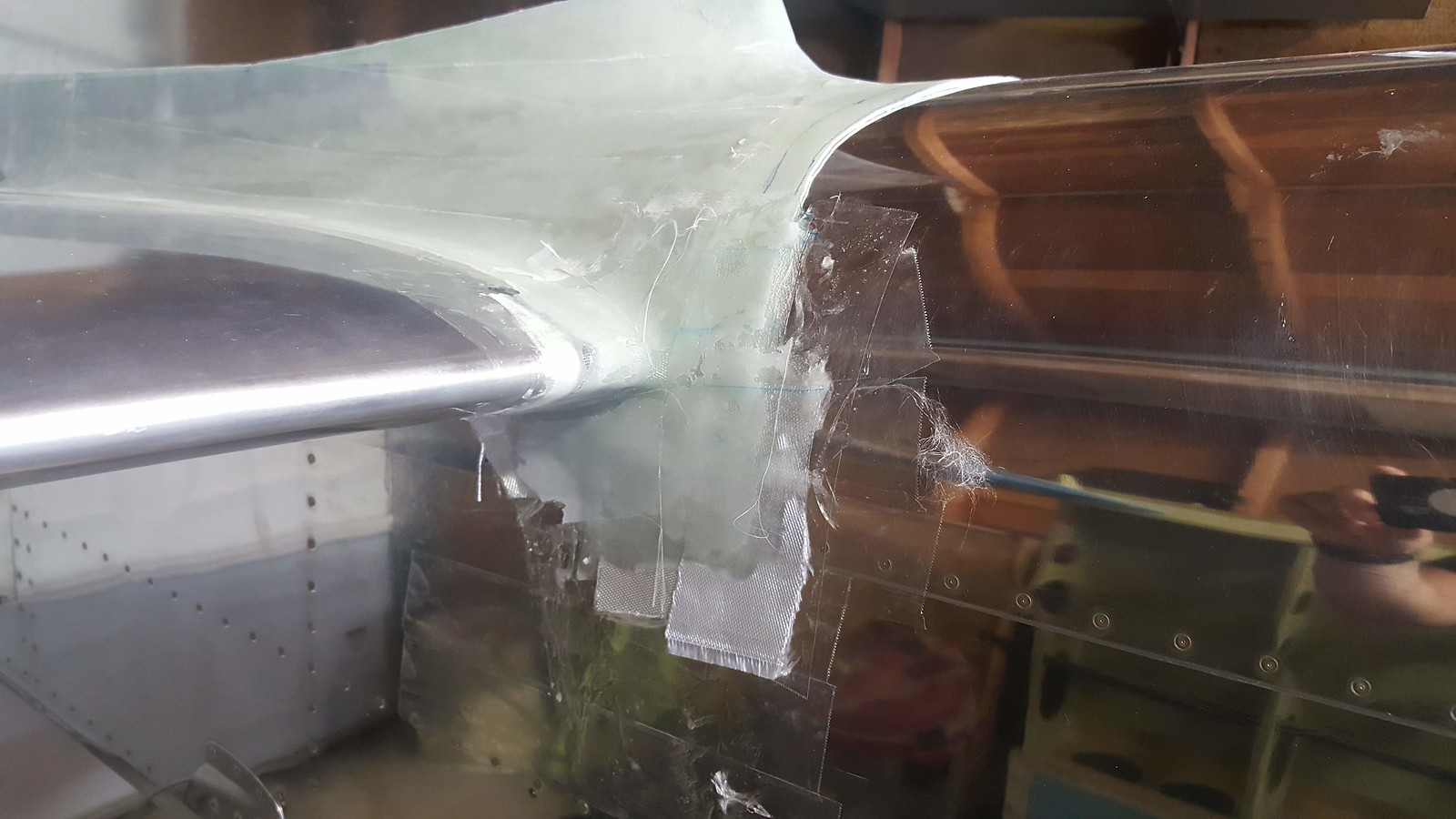

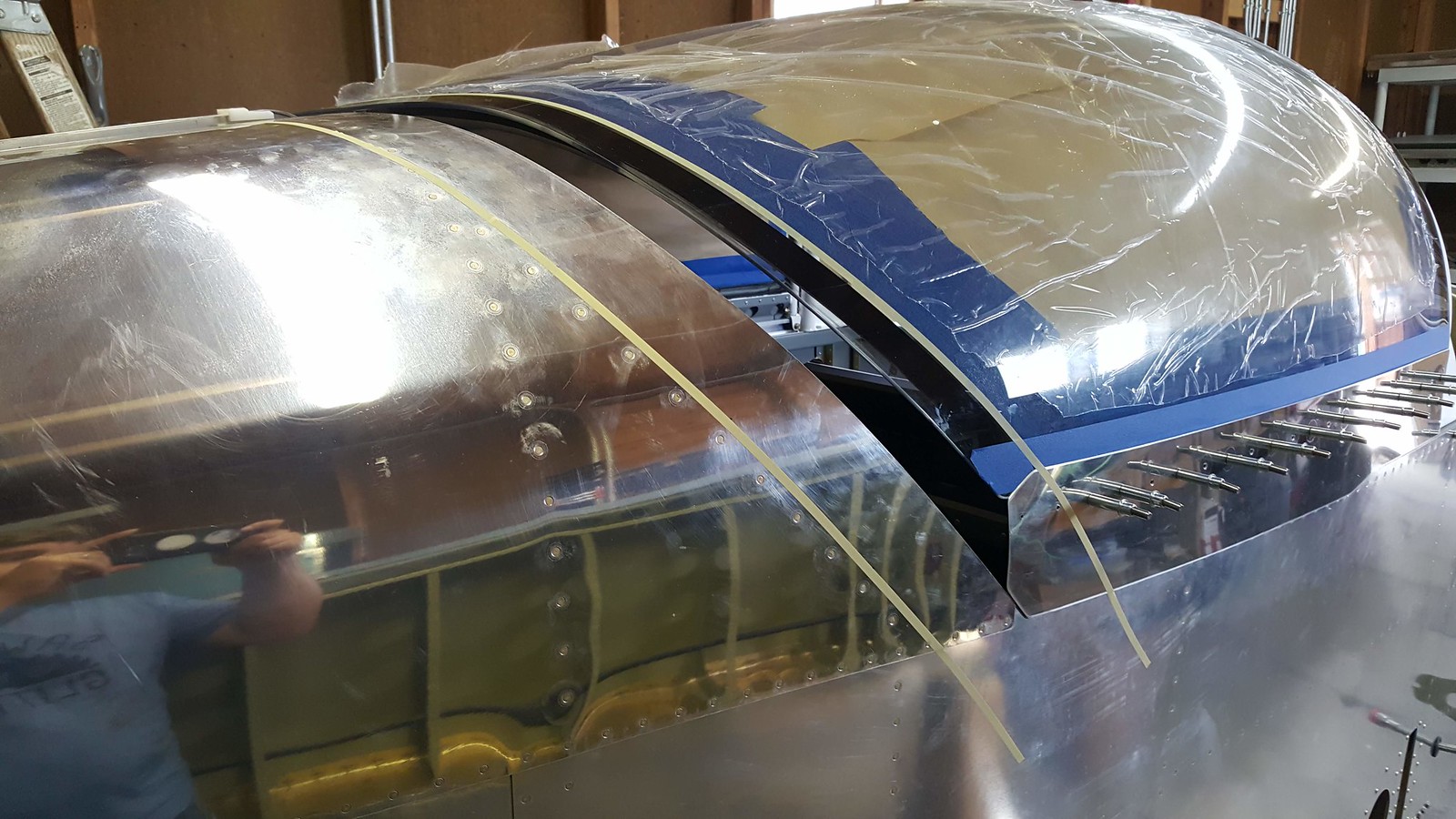

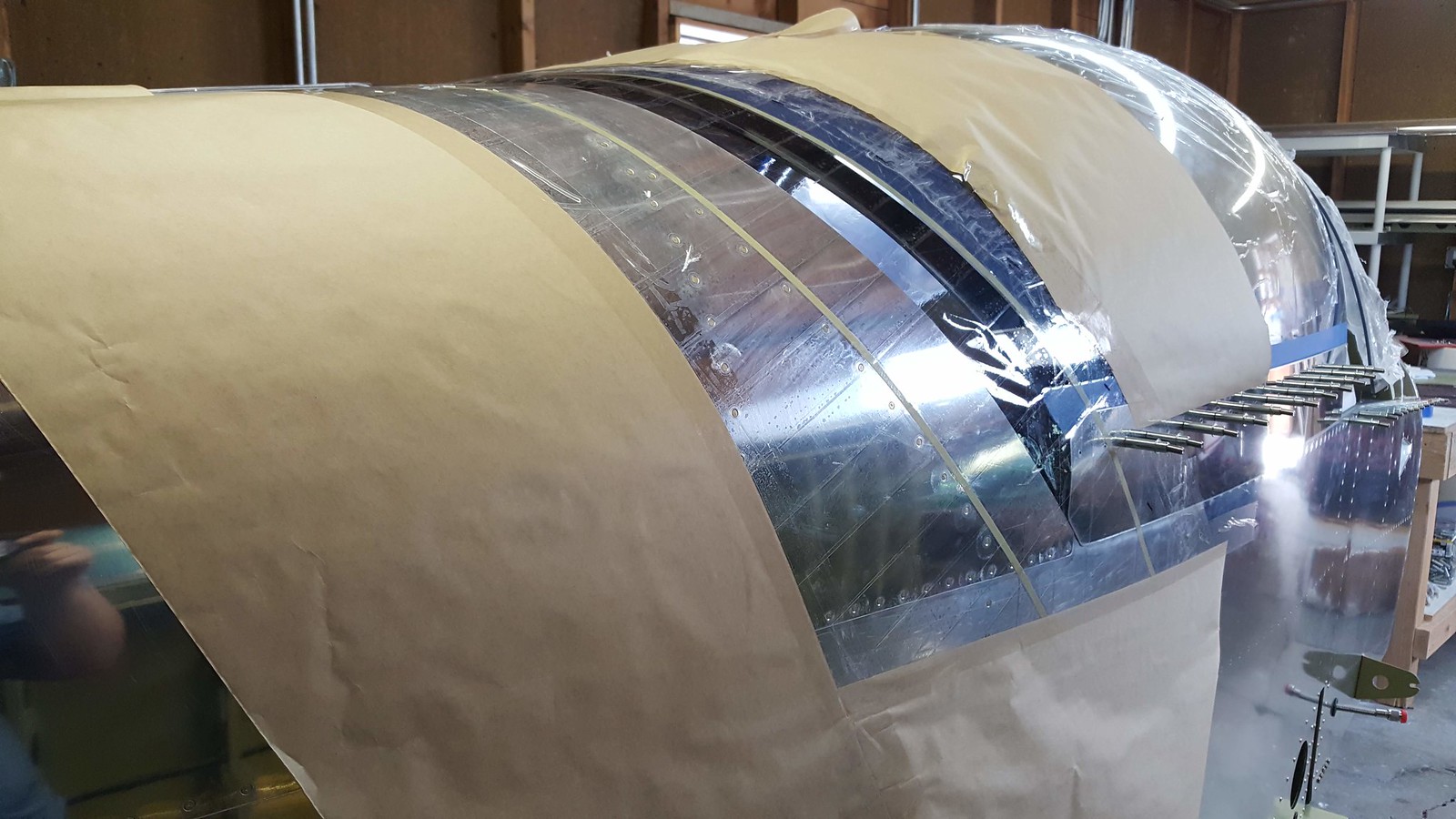

Well it's finallly time to do the canopy skirt dance. The plan all along was just to take the time to do a skirt for the whole shebang but I held up the aluminum side skirts and said "daaaaang those fit too good to throw away!"
Therefore, I started by putting the aluminum skirts on and painting the inside of them except where Sika will go just for a little extra. Then it was time to start taping things off for the rear skirt layup.
20190709_111537 by Jereme Carne, on Flickr
Another picture or two of taping.
20190709_124105 by Jereme Carne, on Flickr

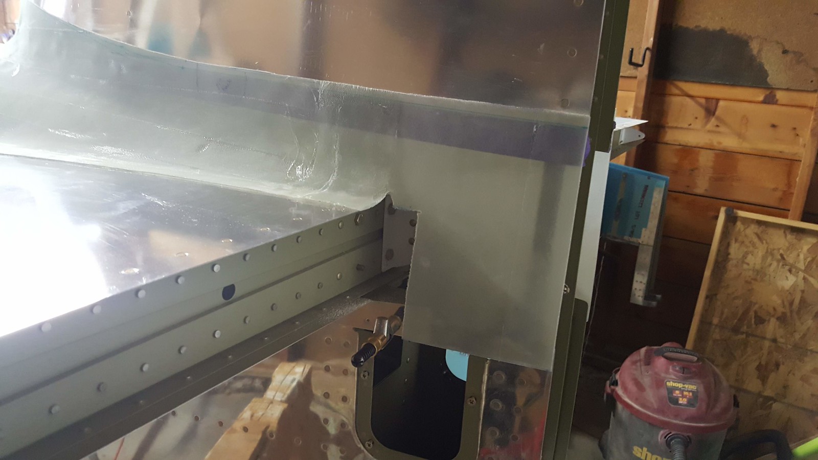

As you can see in this next pic the tape gets a little saggy where the gap is. I put another tighter layer on and it seemed to help quite a bit. If I could do it again I might even consider putting some quick setting stuff over the first layer where the gap is and taping again.
Also, make a mental note of the side skirt and how well it fits the fuse and canopy.
20190709_124404 by Jereme Carne, on Flickr
Remember that mental note you made? In the next pic it looks like the layup is really being pushed out by the side skirt. It is a little fatter there but for the most part the picture is playing tricks on you.

Next up since I still had some time to play with I fabricated a couple of handles to rivet to the canopy for easier opening.
20190709_165315 by Jereme Carne, on Flickr

Fiberglass work continues on the rear skirt. First I popped it off and trimmed the edges. Don't do anything with that tape just yet though, more to do.
Tip: I'm not sure how you guys and gals are doing it but I have found that skipping any wax and PVA and laying up right on top of clear packing tape has always resulted in the EASIEST way to pop the fiberglass off (easier than when I used to use wax). Seriously the part releases so well it's satisfying to watch. However, disregard that comment if you are doing fiberglass in molds, different ballgame as I understand.
20190710_111626 by Jereme Carne, on Flickr
After sanding the inside a bit and exposing any trapped air bubbles it was time to start doing a bit of filling. I had one section on the right side that got a little saggy. I filled this region with a flox mixture. You can see all the area I had to fill on the whole fairing, not too bad, just make sure to get that tape nice and tight! The valley was not very deep at all, I probably could of just used micro but why not go with flox.
20190710_111632 by Jereme Carne, on Flickr
After doing some work around the doghouse area I put on a nice thick coat of micro on the whole fairing. Time for some sanding tomorrow.
20190710_180039 by Jereme Carne, on Flickr

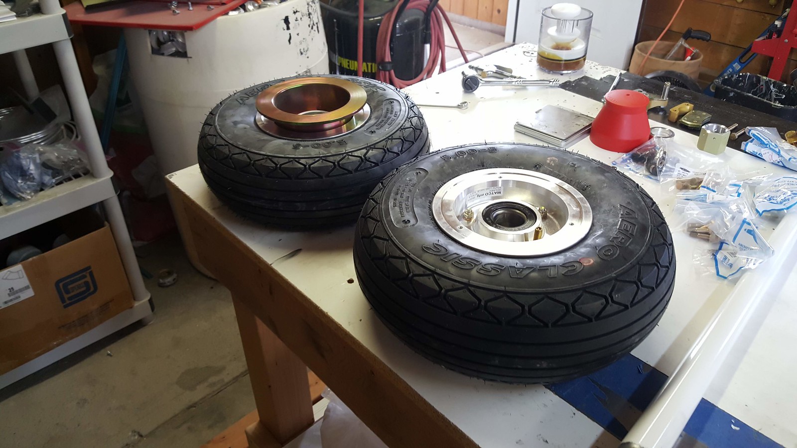

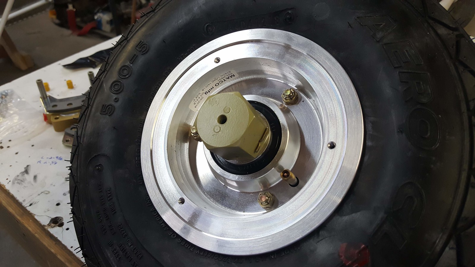

While I wait for epoxy to cure I figured I could work on the main gear. Glad I did as this does take a few hours to do. First bolt the brake flange on. I ordered shorter bolts and AN363 nuts as recommended by some on these forums to hold the brake bracket on. I figured I mind as well do this since first flight will probably be without wheel pants but who knows, I will cross that bridge when I get there.
20190710_181928 by Jereme Carne, on Flickr
Next, mount the tires. Slap some tire talc in there and put things together. I can already tell that this is the part of the build that is going to get fun!
20190710_181922 by Jereme Carne, on Flickr
After packing and seating the bearings I got the axle nut set right per the Matco instructions and drilled the gear leg for the cotter pin. Drilling through that hard steel is a bear! Put the brakes back on and on to the next side.
20190710_201551 by Jereme Carne, on Flickr
