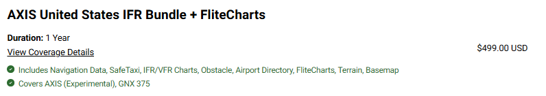

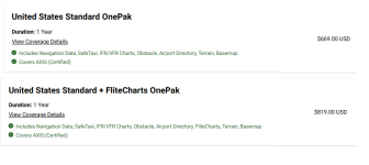

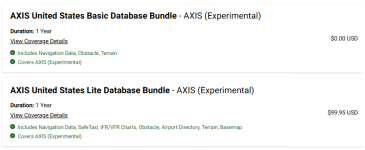

To clarify some of the requests regarding database levels and subscriptions with the AXIS displays:
Even though there are configuration modules for each display in an AXIS installation, the system still operates on a single system ID. Therefore, one database subscription is purchased for one system ID. This is true for past G3XT installations and current AXIS installations. For IFR equipped panels, you would typically have one system ID for the flight displays, and one system ID for the IFR navigator(s) due to these products requiring different levels of navigation databases (VFR or IFR), along with optional charting packages. In these installs you would have the choice to purchase only the required IFR navigation database subscription for the IFR navigator(s), and the charts (or not...), for the GDUs or other charting source (EFBs like Garmin Pilot/ForeFlight, or your classic paper printouts).
When there are multiple IFR navigators and PFD/MFDs in modern IFR aircraft and owners desire 'all available data on all available screens/units', the OnePak offerings are a great option to cover this need, because the a la carte priced options then become a costlier selection at that point.
Added layers of data requirements take place when we start combining IFR navigation units into PFDs along with adding expanded features like full control of flight plans from PFDs to external IFR navigators via HSDB. (Example: you can now fully control the flight plan, load and activate approaches on a GNX375 or GPS175 completely from a base experimental AXIS GDU due to this HSDB interface and one source flight plan.) This capability creates a requirement that the PFD and external IFR navigator share a consistent IFR level navigation database, so they agree on what they are actually controlling/modifying.
Now that that's out of the way, let's break down some examples. For simplicity and a much shorter post I input packages for the US.
Please visit the FlyGarmin.com aviation database pricing page and input all installed equipment to receive available packages and other a la carte pricing. That will look like the below for the provided example groups following.
View attachment 122771View attachment 122776View attachment 122777
Navigation Database = All GPS waypoint information data meeting either VFR or IFR level requirements (there are different levels for these use cases)
VFR/IFR Charts = VFR Sectionals and IFR Enroute (High/Low) Charts
FliteCharts = Garmin Terminal Procedure Charts (Arrival/Departure Procedures and Approach Plates)
Basic AXIS Display Installation (VFR) - GDU 116Bx
One system ID and subscription, no matter how many displays are installed. These include options for (free) VFR level basic Navigation Data, or options with advanced features like SafeTaxi, VFR sectionals, and Airport Facilities Directory.
IFR AXIS Installation - Federated Panel (PFD + Traditional Radio Stack) - GDU 116Bx + External Navigator
In a common base GDU (116Bx) + non-chart displaying IFR navigator install (GNX375 or GTN650Xi), there are 2 system IDs. It was previously common to update the IFR Navigation Database only on the navigator and chart packages on the PFD/MFD (previously $299 + $199), but with these systems now connected via HSDB and utilizing a one source flight plan, all units need to have an agreeing IFR level navigation database subscription (including the PFD, even if an experimental base unit). The below database package was created for this need. This provides all required IFR level navigation databases and listed information on the display and non-chart displaying navigator.
If you had a chart displaying navigator like a GTN750Xi and desired FliteCharts on that GPS/MFD unit as well, you would likely be selecting a OnePak, similar to the next IFR example below. This would give you all available services on all units, although it would still be an option to only update the basic level navigation database and not have the mapping/charting availability (uncommon on GTN750Xi installs, but more frequent on GPS (175/375) and GTN650Xi installs).
IFR AXIS Installation - Integrated Panel (PFD acting as the IFR Navigator, one system ID, all displays) - GDU116 C/NC
These are the wholly TSO certified flight displays, so the entire unit is a certificated piece of equipment but installed in an EAB aircraft (just like your previous GPS/GTN Xi unit was). You will need to input these devices in FlyGarmin as AXIS (Certified) units to receive proper database selections. Databases can still be a la carte for these displays, but when adding desired features together (like all IFR navigation databases and mapping/charting capability in one single display) the OnePaks are the best pricing option. The AXIS (Certified) display models that include the integrated IFR GPS capabilities do not accept the AXIS (Experimental) bundles. However if you had a supplemental GDU 116Bx experimental display installed, it's services would be included under this package.
We will have members of our Database Sales Team/Pilot Ops group available at OSH to talk through these many options for your aircraft to equip you with the best available option for your desired mission.

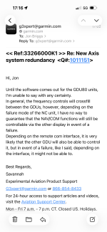

Regarding reliability, seems like 2 Bx screens and a GTNxi (650 or 750) are better than one NC and one Bx as it eliminates the NC as a single point com/nav failure. Am I missing something?
I've been thinking the same thing. Although in your scenario the GTN is still a single point of failure but at least you don't also lose your PFD and the same time.
With only two axis screens (one NC), if you lose your PFD then you are flying without a certified navigator and using either the MFD or the G5.
With two Bx plus a GTN, if you lose your PFD then you still have the GTN screen plus the G5 and MFD. If you lose your GTN then at least you still have your PFD with GPS.
If money is no issue and you want ultimate redundancy then you can buy two NCs plus an 8" screen in the middle. Now you have redundant navigators and the pilot worst case has to fall back to the center 8" screen. But we are at almost $20k more than the dual Bx plus GTN.
I’m no expert on this but my understanding of the system architecture is that with the NC version you have effectively separate LRUs in one box, and each LRU has an independent power supply.
So with 2 screens, one NC and one BX, if the screen on the NC fails the other LRUs in the NC box will be available on the BX. So the NAV/COM functions should still be available.
Can someone correct me if I’m wrong, because this is the set-up I’m hoping to run.
With the removal of the need for a center stack, does it make sense to run three screens? One NC, One BX and an 8 inch in the middle? With that setup and a second ADAHAR would you need a G5? Seems like that would give you a reasonable amount of redundancy.

Emailed them.
They say until the software comes out for the 80PX they can’t say for sure.

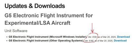

There is a disparity between the Installation Manual and Garmin's current software version for the G5. In preparing the AXIS upgrade from the G3X in Appendix F, the instructions are quite clear about ensuring all installed LRUs are loaded with their most recent software versions; otherwise, the AXIS system will not be able to interface correctly. For the G5, the minimum software version should be v8.70:
However, Garmin's most recent version is only v8.60:
Is another release coming soon? Thanks for reconciling this discrepancy.
