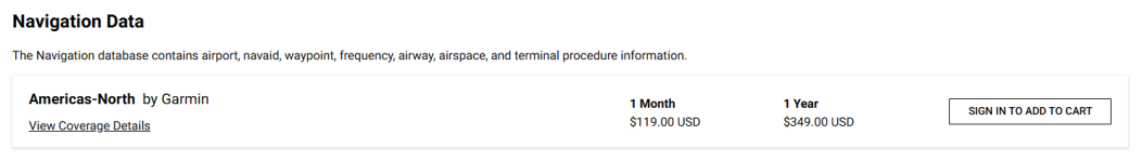

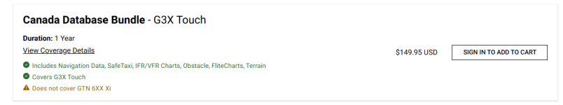

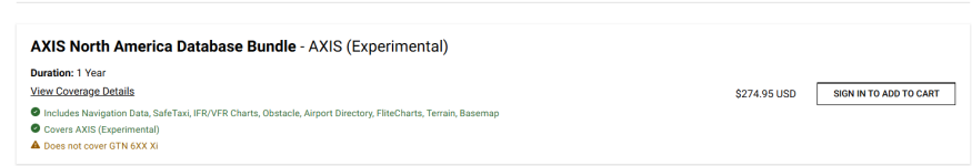

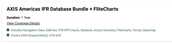

For a configuration with 2 x GDU116Bx + GTN 650xi, connected over HSDB, would the following separate database subscriptions allow for IFR flight plan syncing/editing?
For Axis:
For GTN:
Can you confirm ?
Looks to me like that is the bundle with AXIS VFR nav data so no ability to modify IFR flight plans on the AXIS.
'AXIS United States IFR Bundle + Flitecharts' is US$499 per year but I cannot find an 'AXIS North America IFR Bundle'.
Try changing your selection to the certified AXIS. I was just looking at it.
The bundle naming and search/display on flyGarmin is not the most straight forward.
Having two different databases named 'Navigation Data' for AXIS experimental units
and which you load depends on whether you have an external IFR navigator is prone to mistakes.
It does appear that 'AXIS North America Database Bundle - AXIS (Experimental)' is the VFR nav data.

VFR Navigation Data will be clearly marked in the 'View Coverage' drop down selection. VFR only Navigation Data is only available in the US.
You are correct that in order to modify IFR flight plans with the single source flight plans of AXIS (when connected to an HSDB enabled IFR navigator like GTN Xi or GNX 375), matching IFR-level Navigation Databases are required. In the above example, Americas - North is the proper Navigation Database and matches between the AXIS Experimental and GTN Navigation Only databases. That information would also be listed under the 'view coverages' link.
The additional example you gave narrows the selection down to US only. That covers US Navigation Data (IFR level) on all devices, with FliteCharts for the PFD (approaches/procedures). That was created to keep pricing similar to popular selections today (Data/Charts on PFD + NavData on Navigator). What you were looking for is included in the AXIS Americas IFR Databae Bundle + FliteCharts. You would need to add Canada/USA both to the region selection for that to appear.
Great so with Axis (experimental) North America Bundle ($275) + GTN 650xi Americas North Navigation Data ($350), we have matching IFR level navigation databases in the Bx PFD, Bx MFD and Navigator allowing for full FMS level flight plan sync/editing between the 3. This keeps the database position neutral with a similar G3X ($275 North America bundle) + GTN (Americas North Nav data $350) configuration. 👌Garmin.
It would be great if Axis experimental also had a matching Canada only bundle to the G3X bundle below:
