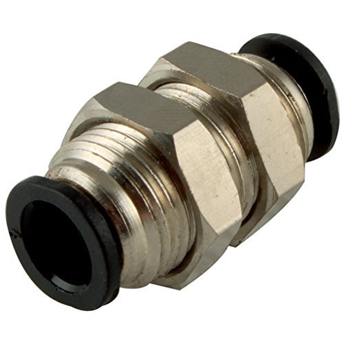

Has anyone found a source of the connectors/pitot rivet in the uk as I've now spent hours trying to find them?
Looking at mcmaster's site I was wondering if using something like this at the wing root would be any good (is there space to fit it in the attachment plate)?

I've managed to find the parts easily in the US, I'm just having issues finding them in the UK (or someone who ships from the US) :(
I did find one uk site but after an hour of searching I still wasn't sure if I was buying something that would work, I was up to about ?80 (~$125) just for the pipe and connectors (they only sell in large quantities) so thought I'd ask on here in case someone had found them.

The only suppliers I have found so far in the uk are
http://www.coleparmer.co.uk/ only seem to sell large quantities.
I have just found the following that might work (still looking but off to bed in a bit so will continue tomorrow).
http://www.omega.co.uk/ - These look better, still haven't found the Dynon connector on there though (1/16 pipe to male 1/8 DPT I believe it is) or somewhere to get a static rivet from in the uk (may end up using a normal one)
My current list is looking like the following.
From Omega I think these might be the start of the kit
TYTT-18116-25 - tubing - ?20 tubing
FT-PMCD16-01-12 - ?13.50 bulkhead connector
FT-PMC22-01-12 - ?6.70 builkhead insert
It isn't finished yet and I'm not sure if I have the right connectors for the wing root connection so feel free to point out mistakes/changes that might be better.

Update to this is I found a dynon connector (I think) - ?8.92
http://kinesis.co.uk/kx-vaporsafe-barbed-tubing-connection-1-16-id-tubing-x-1-8-npt-polypropylene-pk-10-ab-121x.html

Any of the many Industrial Supply sources have these style fittings.
MSC, Grainger, McMaster-Carr.
If unable to find advise and I will locate part numbers and source.
Bulkhead push to connect connector
While looking at the bulkhead connectors available from the vendors who's links Joe provided yesterday (thanks Joe), I ran across this inexpensive bulkhead fitting for 1/8" OD tubing.
http://www.mscdirect.com/product/details/84425867
Could not find a spec on the type of tubing acceptable for use with the fitting other than "works with most thermoplastics" ... so was wondering if the Tygon tubing Joe pioneered for use on the AOA is too soft for this kind of fitting? Guess at $8.50 a fitting it is cheep enough to get one and give it a try.
Any thoughts?

A salesperson at US Plastics probably could advise what fittings are compatible with what tubing. Tygon makes as many different types of tubing as Ford makes vehicles. So the Tygon part number will be needed before questioning the experts.
For those in the uk I managed to find a similar thing on amazon after much searching, it is a lot harder to find these in the uk.
I haven't tied it yet as I'm still building the wings.
http://www.amazon.co.uk/gp/product/B00QSQAE7E?psc=1&redirect=true&ref_=oh_aui_detailpage_o00_s00
From post 44, works great.
All of these are the part numbers from mcmaster.com:
1 each 5047K12 Moisture-Resistant Acetal Sngl-Barb Fitting Adapter for 1/16" Tube ID X 1/8" NPT Male Pipe $1.10 each
This is the fitting that adapts from the tube to the 1/8 NPT female fitting on the Skyview ADHRS. It was available in a single quantity. In Joe's original post, he made this by melting another inflation needle into a plug.
1 pack 51525K211 Plastic Quick-Turn (Luer Lock) Coupling Nylon, Female X Barb, for 1/16" Tube ID, packs of 10 $3.41 per pack
1 pack 51525K121 Plastic Quick-Turn (Luer Lock) Coupling Nylon, Male X Barb, for 1/16" Tube ID, packs of 10 today $3.83 per pack
This is the disconnect fitting at the wing root. It was not available in a single quantity so I have given away a few but still have some left over.
I pull the wing out a few inches, then disconnect the fitting.
25 ft. 5006K51 Abrasion-Resistant Clear PVC Tubing 1/16" ID, 1/8" OD, 1/32" Wall Thickness, $0.15 per foot.
Total of all from mcmaster.com $12.00 plus shipping
