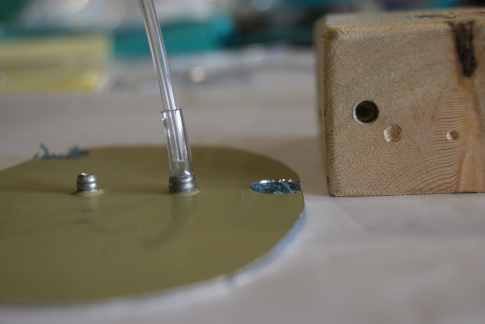

Installed the tubing for an AOA probe and used an LP4-5 rivet for the probe. Positioned it per Joe Gores' recommendation. After calibration, performed power-off stall and landing. AOA functioned very well. Leading edge is clean, rivet looks like it belongs there.
Do you have any pictures of the LP4-5 rivet installation? Does the tubing fit on the back of the rivet location ok?

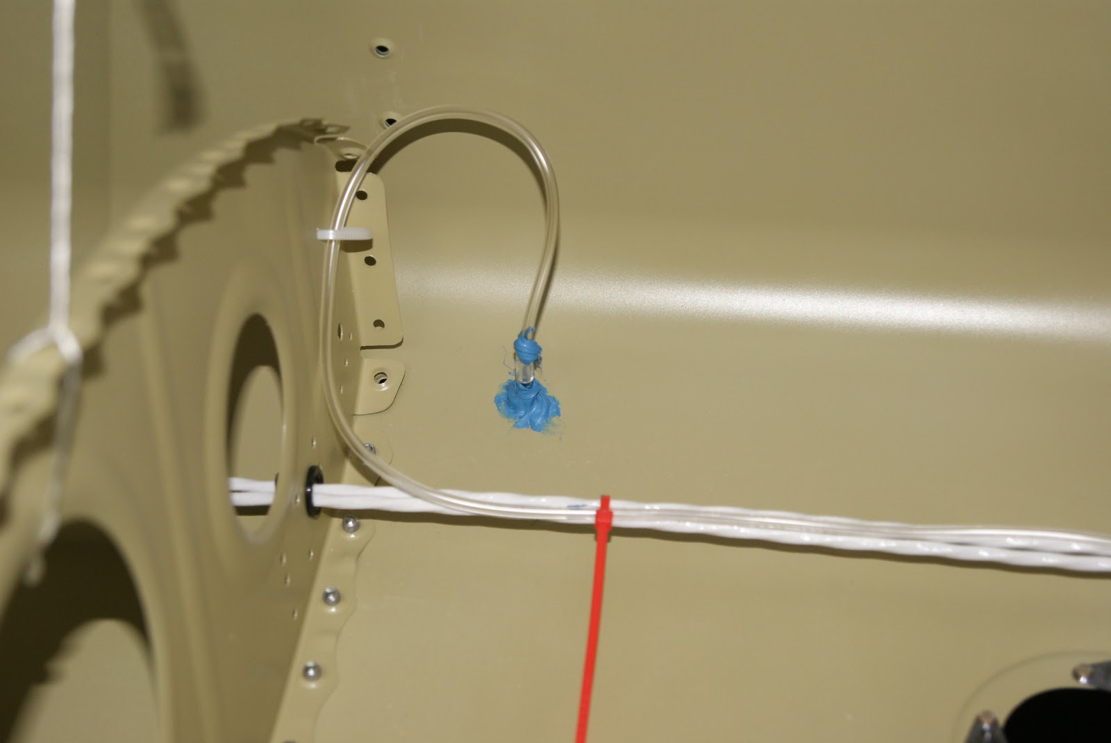

I?m building E-AB and using flush rivets that are in size, equivalent to LP4-3 rivets. In the link to the first photo below you can see how I attached the AOA tubing onto a rivet with the mandrel removed using a block of wood with a hole in it as a backstop during my initial testing. Basically, I used a 1/8? ID vinyl tubing sleeve slid over the shop head of the rivet which made a very snug fit. Next the tiny Tygon tubing was forced inside the 1/8? tubing making another tight fit.
As viewed in the second photo bellow, during final assembly, sensor safe blue Permatex silicone sealant was placed around the base of the rivet and the 1/8? tubing sleeve slid over the rivet to seat into the silicone. Then silicone was slathered over the outside of the 1/8? tube/rivet junction and the Tygon tube to 1/8? sleeve junction and let to dry for a couple of days before securing the tubing in final position. Hindsight being 20/20, should have placed some tape around the area because I made quite a mess while trying to insure a good solid seal around the rivet ? had a blob of silicone on my gloves I didn?t notice and ... well you can see the results.
http://4.bp.blogspot.com/-bf0AsxsrklU/UUKMfxFUU2I/AAAAAAAAEJQ/xndtg_eTXMY/s1600/DSC03738.JPG
http://4.bp.blogspot.com/-_fDIzx1L1II/UUTjGmW6eEI/AAAAAAAAEJg/eqKPHX8Yw9Q/s1600/DSC03740.JPG

AOA photos
I just finished my 12 ELSA and am considering installing the AOA. Can some one post or show me a link to a series of photos of all of the steps including the in / on wing installation?
Ben Barron, this is the thread, start back on page 2. Eventually you'll get to the McMaster-Carr parts list. Leave a little slack at the wing root for the quick disconnect, it comes out through the panel with the wing electrical connectors. You can just lay that 1/8 tubing in the lightening holes if you wing is Already built, fish it through to the stall switch cover plate area with a stick.
