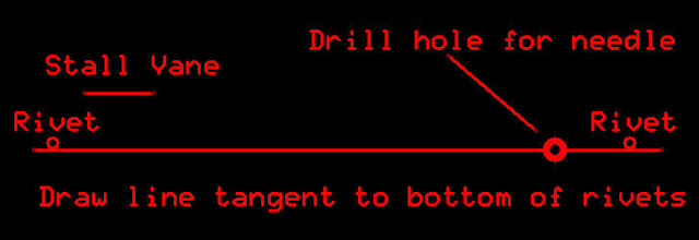

I hate to sound dumb, but I'm still a little confused. You guys are all talking about mounting the AOA tube at 60 Degrees. When I look at Joe's pictures the protractor shows 30 degrees. What do I do? If I drill the hole as he showed will that be the 60 0r 30 degrees?
I like the idea, have all the parts, but I don't want to install it in the wrong place.
Looks like 30 degrees DOWN from a line horizontally parallel to the ground, or 60 degrees UP from a line vertical to the ground. Looking at the probe, the slant face is about 30 degrees DOWN from a line measured through the center of the probe.
Johns4689, use the layout for the hole location as provided by Joe Gore's post and the angle will take care of itself. It's approximately 30 degrees off the chord and sixty degrees off vertical. Do it as Joe shows and it will be fine.
Dick Seiders
I agree with Dick. For the RV-12, use the drawing that I made to locate the hole. It is not necessary to measure any angles. Find the two rivets in the drawing. Hold a straight edge against the bottom flange of those two rivets and draw a horizontal line. Drill a hole on that line. I located the hole far enough away from the stall vane so that the AOA probe would not be in the way for working on the stall vane.
For other aircraft, it will be necessary to measure the angle.
