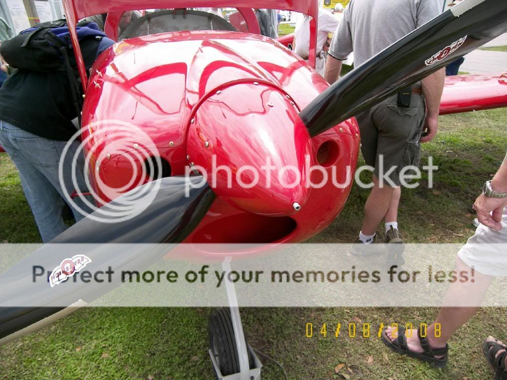

Remember that the Van's RV-12 pitot tube has a "custom" bevel on it to make it work properly. That would need to be engineered on any replacement.
--Bill
AOA probe bevel
If Van's pitot tube has a bevel, then maybe it is the Dynon combination airspeed and AOA probe that has one straight port and one angled port.
Joe
It's just a tube. Here are a couple of Jerry's Sun 'n Fun pictures:
--Bill

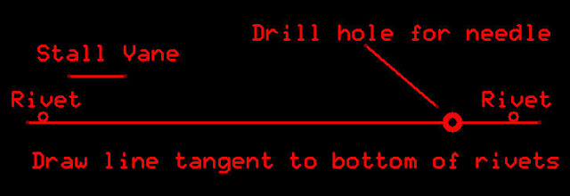

Homemade AOA probe for Dynon
I installed a homemade AOA probe on my RV-12 wing and connected it to the Dynon D-180. It works great! Total cost is about $10.
Parts list:
2 sports ball inflating needles
1 plastic plug with 1/8" NPT threads
1/16" I.D. 1/8" O.D. Tygon tubing available here:
http://www.usplastic.com/catalog/search.aspx?search=57102&page=1
See pictures for location of hole to be drilled in leading edge of wing. Put a dab of 5-Minute epoxy glue on the needle, and stuck it into the hole from the outside of the wing. A piece of tape held the needle in place until the glue set (24 hours). The hole should be drilled in the same rib bay that is accessible through the stall vane access cover. The Tygon tubing is a tight fit over the inflating needle. No clamp is necessary. The plastic plug is used to make a bushing to adapt the inflating needle to the AOA port on the back of the Dynon D-180. After cutting the square head off from the plastic plug, ream out the hole in the plug to 1/4". Put the inflating needle in a vise, threaded end up. Use wood to protect the needle from the vise jaws. Briefly heat the needle with a torch. Push and turn the plastic plug down onto the needle threads. Too much heat will damage the needle or plastic. The object is for the needle threads to melt their way into the plastic plug. A tap could be used instead of heat, but the taps are an odd size, difficult to find, and expensive.
http://www.tapsndies.com/catalog/item/6890755/6851684.htm
I routed the Tygon tube along the inside of the fuselage instead of through the center tunnel.
Another needle (with the threads cut off) can be used as a coupling at the wing root if desired.
After calibrating the AOA per Dynon D-180 installation manual, the AOA indication appeared on the screen and I began using it. Even though I have never used AOA before, I found the display easier to interpret than airspeed numbers. On that very first flight using AOA, I was able to land on a very short private strip without floating off the end of the runway.

I do not know if the probe needs to protrude or not. The way that I did it works. A flush port may or may not work. If you install the 15160 static port and it does not work out, there will be a 1/4" hole in the wing. You could try using a rivet like those installed on each side of the fuselage for the static system. The advantage of the inflating needle is its perfect size for connecting the 1/8" Tygon tubing. Another option is to cut the threads off from the needle so that it looks like a nail. There would not be much sticking out. But who knows if a flush probe will work? It is worth a try. You could always replace it. Nobody notices my AOA probe because it is slightly under the leading edge of the wing. When I want to show it off, I have to point out its location. A protruding probe is less likely to be filled with paint or wax.
As for the glue bead, I waited for the glue to thicken before applying so that it would not run. I spun the inflating needle in the hole to get a uniform glue bead. If I were to do it again, I would use a much smaller amount (one drop) of epoxy glue so that it would not show.
During construction I had installed extra plastic bushings in the wing ribs for future projects like this. The tubing can be pulled along with wires and share the same bushings if there is room. That should not be a problem unless the wires need more room for ventilation. I doubt that the wires get that warm though.
