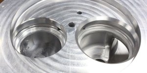

Scott, does this version incorporate the oil-cooled valve seats of the cut-from-billet Continental heads? If not, it may account for the lower oil temperature.
(Photo below, annular grooves for oil circulation. They form a passage when the valve seat, not shown, is shrunk into the head.)

Thanks for the link Dan, fascinating article, hopefully this will lead to an available diesel option, especially for us here in Europe where Avgas is $6 to $7 a gallon and Jet A about $2 to $3 a gallon (although the tax man has an interest in Jet A sales for GA).

Dan,
The CD230 I flew did not have the billet cut heads.
I do not know about the internals of this engine but I believe the head is oil cooled. You can see the oil lines to the heads in the attached photo.
