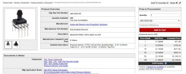

What I will do is measure my cowl delta P at 100 and 150 knots, with density altitude and OAT, with no ducts and both ducts. If there is a measurable difference then I'll do each individually.
Its also worth mentioning that all ducts are not created equal. In both cases I capture the end of the ducts and contain the airflow all the way to where it needs to be, it's not just dumping out nearby.
I ordered a manometer and should have it Thursday but I'm also in the middle of an annual so it may take a week or so before it happens.
If there is enough interest I can pretty quickly make a circuit board and sensor definition file that would allow anyone with a Dynon to use a general purpose input to read cowling delta p in real time.
It seems like there is a dearth of data on this sort of thing but there really isn't any good reason why. It would probably be a significant help to anyone trying to determine if their various CHT fixes did anything useful.
I'll report back.

Bill, plan B, in case you get tired of the manometer.
I had pretty good success using a sensor when measuring the nozzle air bleed deltaP for a constant flow FI system. Used a Honeywell sensor and a Dataq DI1000 to feed my laptop. I'd need to dig back through the sensor configurations to see if they have one with a suitable range for plenum deltaP. Only real catch is needing someone in the back seat to run the laptop, just because there isn't enough room to operate it on the front pit of our RV8's.
Pretty darn accurate. The two attached plots are live intake port pressures for 720 degrees of crank rotation at 2400 RPM, i.e. the wave action in the intake tube and sump plenum.
https://www.dataq.com/products/di-1100/
