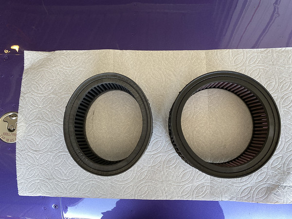

VAFers have well documented the K&N filter shrinkage. Mine has lasted almost 12 years and it has shrunk a little, though my need for replacement is due to the rubber seal portion having hardened like a rock. Time for a replacement.

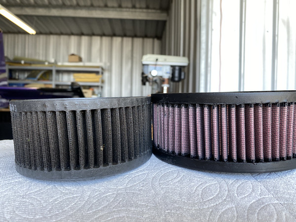

So I ordered a replacement filter No. E-3260 for the o-320. Looks like this filter also shrinks during the manufacturing stage. :) This new one is about 0.160" shorter than my older one. Anyone see this too, or am I just lucky? :rolleyes:
This means I need to add additional proseal to the bottom lip of the emergency air intake.

The dimensions for both models are specified to be 2.5" in height. The new filter measures 2.24", while the old one has shrunk to about 2.4". The E3260 fits the bottom aluminum plate of the filter assembly perfectly, just like the original, therefore I believe I have the correct filter. I will double check my measurements though, and report here if different.

I checked the box the filter came in, and it looks like the filter number and bar-code was placed over a previous sticker. I tried peeling it off, and it in fact looks like the previous sticker was an E-3250 (look at the 2nd image, with the 2 labels partially removed, exposing the back of the 2nd label... E-3250).
I purchased this filter via Amazon, full-filled by them, came in from California to Canada (could not find that filter in my part of the country). Called K&N tech support regarding the dimensions and my suspicion it was mis-labeled. I informed him that I had purchased the filter from Amazon and that I had started modifying the filter for my off-road vehicle. After checking the specs, the tech took down my contact information and said they would check their stock for quality control, and after checking one filter, they would send one to me as a warranty issue. Wow! Nice on K&N for owning it.
I may have wasted some time and effort on ordering and modifying the first filter, but am pleased they are sending me a replacement. Hopefully I will get some flying done this summer, as my annual inspection has been dragging out for too long now.

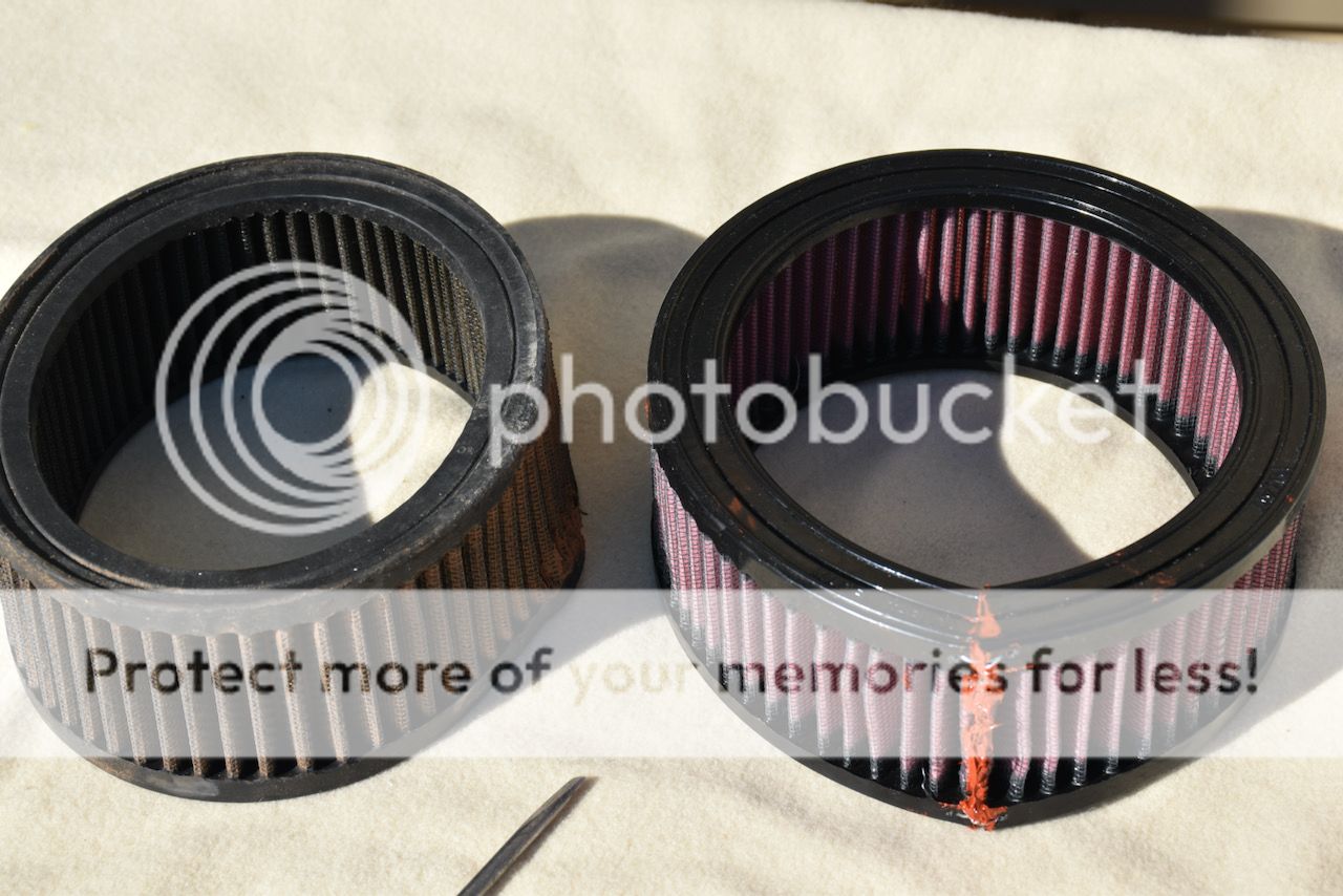

I replaced mine last year. Got the new one from Van's. Here they are side by side. The original lasted 6 years.

There is an aluminum plate that fits on the bottom of the filter. Over time and flight hours, the filter's rubber components shrink and make it so that plate becomes a difficult fit. The rubber has hardens over time, likely to exposure of fuel mist. My old filter had close to 1100 hours.

Just received the replacement filter (E-3260) from K&N. Looks like they took one off from the production line since the date code indicates June 21st.
Advice: Make sure to actually measure the dimensions of your new filter, as the box may have been mis-labeled as mine was.
Measured the thickness to be 2.46". Good enough to start hacking away at it so it will fit under the carb. Kudos and thanks to K&N.

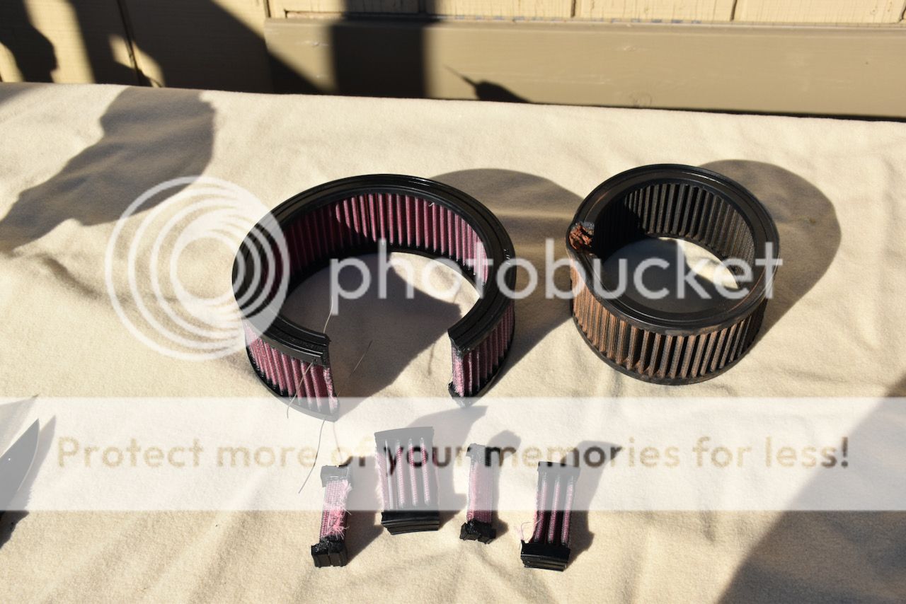

I change filter every two years on average. I was unlucky this time ACS sent me a bigger one. Exchange/return would take a lot of time I decided to do a surgery to it.
Sharp blade, safety wire to stitch, a bit of RTV and I have correct diameter :)

I would keep an eye on that RTV seam. Any contact with fuel would turn it to mush. Injesting a blob of RTV could cause a problem. It might just pass through the system or create a problem. I think there was a previous post about an RTV blob getting stuck in a portion of the venturi in the throat of the carb causing a power outage. Take care!

I agree. That is not a good solution. Good chance of a piece of RTV or a piece of safety wire being sucked into the fuel servo. That's an area of extreme vibration. There's so much vibration of the air filters that it's not uncommon for the filter to wear right through the bottom of the filtered air box.

Like Mike said, keep a VERY close eye on that RTV. I seem to remember a post on this forum quite some time ago about a guy that did something similar and eventually the RTV disintegrated and got sucked into the throttle body and ended up with a rough running engine and had to clean rtv debris out of the engine.
You fly to some pretty isolated places so maybe waiting for the correct size filter might be a better idea. Just my two cents.........
