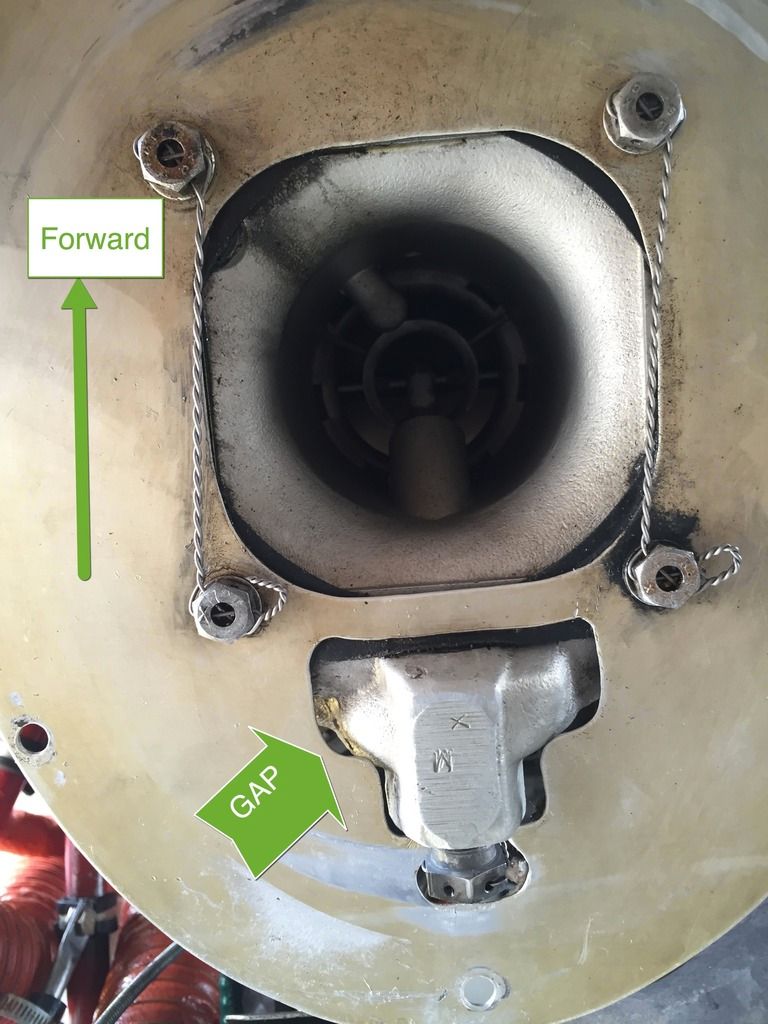

I need some help figuring out how to best seal around the area of the carb bowl drain boss - see arrow. The photo is of the underside of my updraft carb with the filtered air box plate attached.
I guess the first question is, do I even need to worry about it? It's not a large gap but I'm concerned about it because any air coming through this area will come into the interior circle of the round K&N filter and have an unfettered access to the carb intake (bypass the filter). The builder had some rubber baffle material RTV'd to the top of the plate in an attempt to seal the gap. It came loose and that sent me down the path to finding an alternative. I want to be careful with the solution to make sure I don't use anything that can get sucked into the intake should it come loose or deteriorate. In the photo, you can see a gasket between the plate and the carb body. I won't be reusing that - going metal to metal - but not doing so will leave a little bigger gap around the forward area of the carb drain boss.
Thanks in advance!

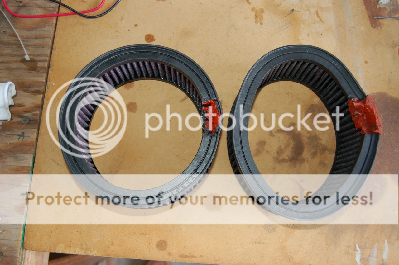

In Vans building instructions there is a method to seal that spot. You have to cut out a piece off your round filter and form a seal with RTV. I don't have the instructions close by but do a search you will find how to do it. It will look something like this. Old filter to the right I replaced it after 1,000 hours.

Hi Randy,
Actually the OP is asking about a different issue.
The air filter interference that requires trimming and remolding the filter is only on O-320's using an MA4-SPA carb. (the pump is from the accelerator pump). An O-360 with a MA-5 carb. does not have the same filter interference.
The need for sealing the hole needed for the float bowl drain bump in the carb. body exists with both model carbs and the install manual specifies sealing this with a bead of tank sealant around the perimeter on the top.
Remolding the cutaway portion of the air filter for an SPA carb. is also specified to be done with tank sealant.
Red RTV is not fuel resistant. It says right on the package "not to be used in/on fuel systems".
