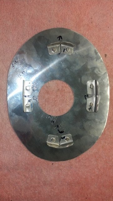

Add a piece of 0.032” aluminum to the bottom of the air box. Add four pieces of aluminum to help prevent the filter from going conical while you are at it.

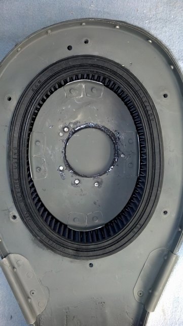

I made a template in SolidWorks. It's for the FAB-320-1. If it's useful I could make a template for the for the FAB-360/540.
I put wings on it to keep the filter from swelling outward at the bottom.
PDF here

If you rivet a aluminum plate into the bottom of the airbox, ensure that if the rivets/hardware should come loose they are either held in by the filter itself, or sit outboard of the filter.
We don't want any loose stuff being sucked up the carb / servo and thru the engine. Or just getting stuck in the butterfly...
