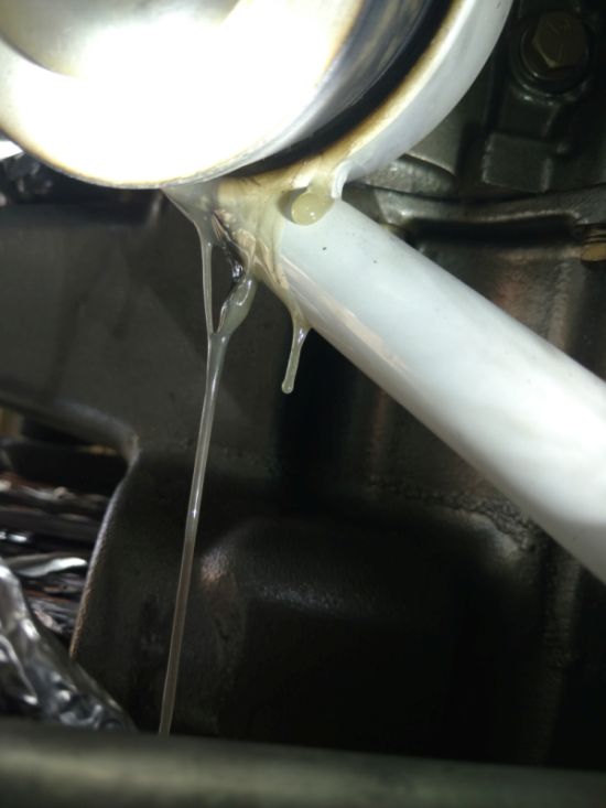

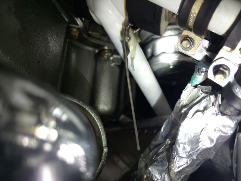

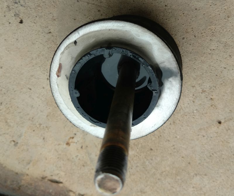

Engine seemed a bit shaky recently, so today the cowl came off for a look. Problem wasn't hard to find:
The liquid was squeezing from an isolator:
Bring out the wrenches...
These are the bottom isolators. Don't have the top pair out yet. Lord J9613-40, about 830 hours on a 390 with a BA Hartzell.

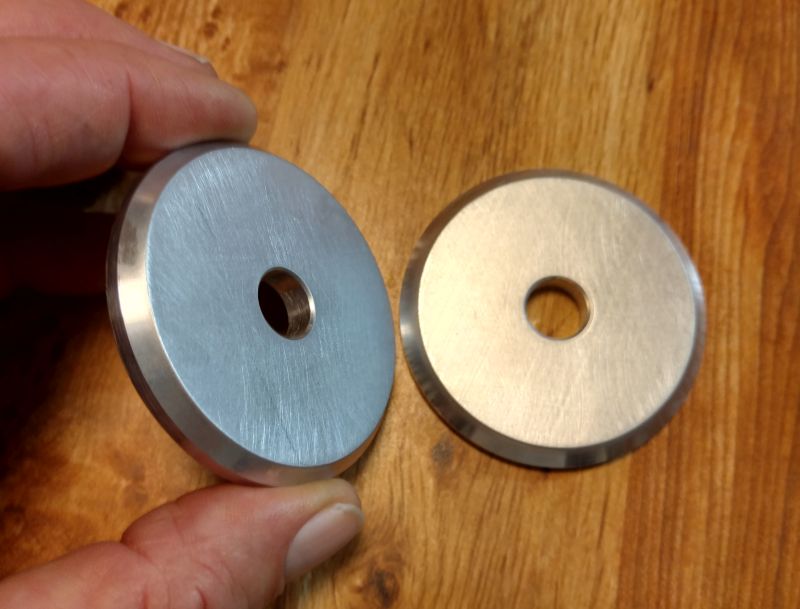

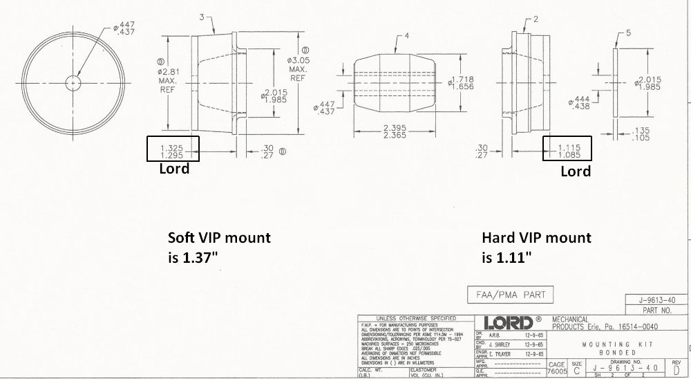

Fit: The VIP acro isolator set (50016-08) is simply two compression assemblies, each 1.11" thick. The standard isolator set (50011-20) currently sold by Vans and others is a 1.37" thick softer assembly, combined with one 1.11" compression assembly. We normally put the thicker soft mount on the forward side of the upper dynafocal rings, so replacing it with a thinner hard mount requires inserting a spacer about 1/4" thick. You can do it with big washers, or machine some from aluminum. Without them, the spinner will be a 1/2" or more too high if you're replacing standard isolators.
This is a Lord drawing, with VIP dimensions noted:
Spacers:
BTW, a few of the VIP mounts had some excess rubber in the center of the big molded-in steel end plate. The center spacer tube (not shown) is tensioned against the end plate, so this excess rubber should be removed. No big deal, 30 seconds with a pocket knife.

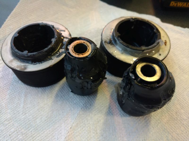

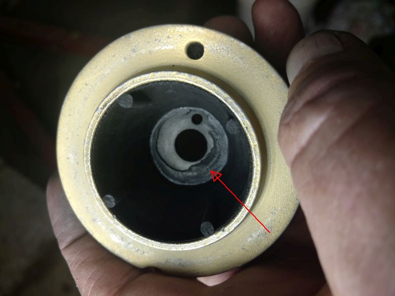

When the inner spacers pinch the gel bag against the inside of the isolator rings, the ends of the bag will be peeled back if the engine moves in the mounts. If I had to pick (caution, opinion), I'd say they sagged enough to pinch the bags due to a combination of four factors.
The first two are pretty common. #1 is calendar age, about ten years since hung, and eight flying. That's probably beyond the manufacturer's suggested replacement interval. Shame on me.
Second is supporting an IO-390, heaviest of the 4 cyl models, with a metal Hartzell. There is a very large difference between this combination and an 0-320 with a Catto, yet it's the same isolator part number. Seems logical that big motors will need new isolators at shorter intervals.
Loading is a little less predictable. This one sees 3.5G on an irregular basis. Some RVs never pull G, some acro on every flight.
The unusual factor is heat. I operate with lower cowl temperatures which are somewhat higher than average.
Just one other data point (therefore anecdotal). I just pulled an engine - Superior XP400 - from an RV14A for the Superior recall. One of my 4 mounts had failed with the other 3 in excellent condition. Time in service is 21 months and 380 hours - mostly cruising but some mild acro. The failure was eccentricity of the stiff discs with a ruptured gel donut. While it looked like it could have been an installation error where one of the interior tabs on the disc snagged/pinched the membrane on the donut, I now believe because of the eccentricity and this discussion that it is a similar failure mode to what Dan has described. These 390/400 engines can move a lot, and can shake pretty violently at start/shutdown.

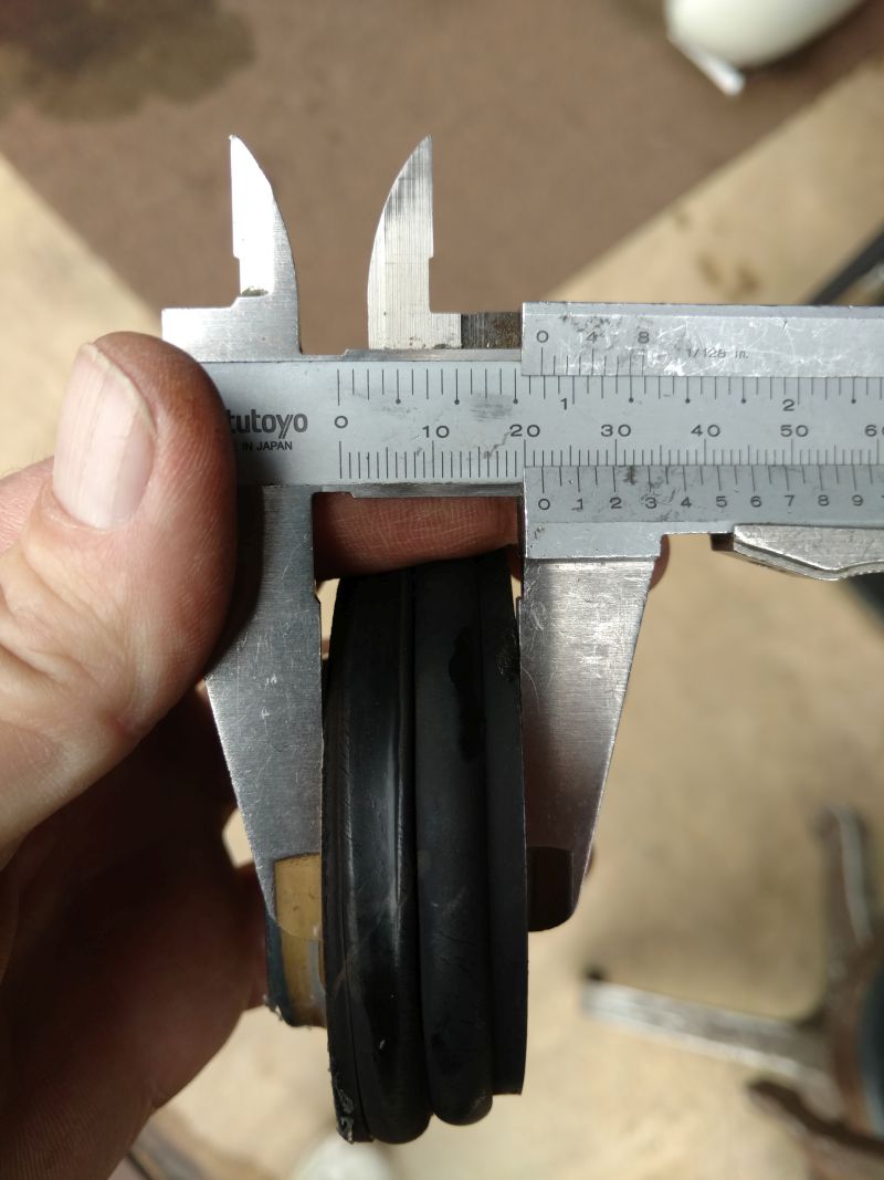

Example of the eccentricity due to sag. You can see how there is very little room remaining for the center spacer and gel bag, and the raised ribs can't help:
Thickness of this bottom compression element is way down too, about 0.86" rather than the original 1.115"~1.085" spec range.
