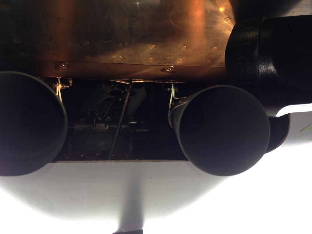

Finally back at it after vacations/work/family etc commitments.
From the previous posts I seemed to have picked up .8 knts and better cooling, I believe the cooling is better because the air is moving more efficiently through the exit. I believe the speed (perhaps its not/further test should show) is because the exit ramp/bump actually reduced the size of the outlet. How much I'm not for sure, I do know I had less room vertically to position the exhaust pipes with the ramp/bump in place.
Pic of the ramp/bump slightly narrowing the exit area, the seam between the bottom skin rivets and ramp/screws depicts the smaller area.
