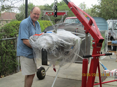

I didn't find the engine install to be much of a challenge at all - I did it in about 45 minutes with one helper, hanging my IO360M1B on a 9A, using just a Harbor Freight engine hoist for lift.

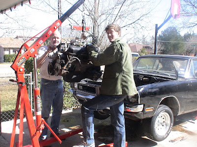

The two things that helped most when I mounted the engine solo were the tilt thing on the top of the Harbor Freight hoist and the experience of about 10 engines changes on the Dodge Dart project. This took 2.5 hours but that included a break for lunch and 45 minutes modifying tools for tight access.
Same spot, same hoist but with a helper.
