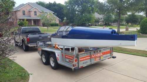

What is it about the 6's that makes the wings more difficult to remove than others? I am trying to plan ahead, The shop I am building in is plenty big enough to completely assemble and complete the plane, however, I would have to remove the wings to transport it to the airport. Sure would be nice to be able to get it mostly done at my own shop before having to move it. Don't the wings need to be installed before drilling and mounting the tail parts?

There are around 100 bolts to remove!

the go-thru spars with multiple layers of the -3, -4, and -6 coupled to the close tolerance bolts make the install/removal of the wings tedious.
Yes you have to fit the wings to fit the tail feathers, and drill the rear spar holes. But you don?t need to install all bolts at this stage. I remember just installing 4 of the large NAS bolts on the top steel plates and the same on the bottom ones for the rigging.
Use some lube and have someone wiggle the wing whilst you hammer the bolts in and later out.

The wing spar to fuselage interface is entirely different on the older models. Also, on the 6A, the main gear towers share bolts with the spar, so the gear has to come off to get the wings off.
I had my wings on twice when building, once for the gear fitting, the second for the rear-spar drilling and other wing-fuselage interfaces. For fitting you don't need all the bolts and you can use hardware-store stuff rather than the close tolerance, so it isn't as bad. The wings get in the way, so you don't want them on unless required.
When I took my 6A to the airport, it was already painted. Do as much as you can at home, it is a lot easier.
