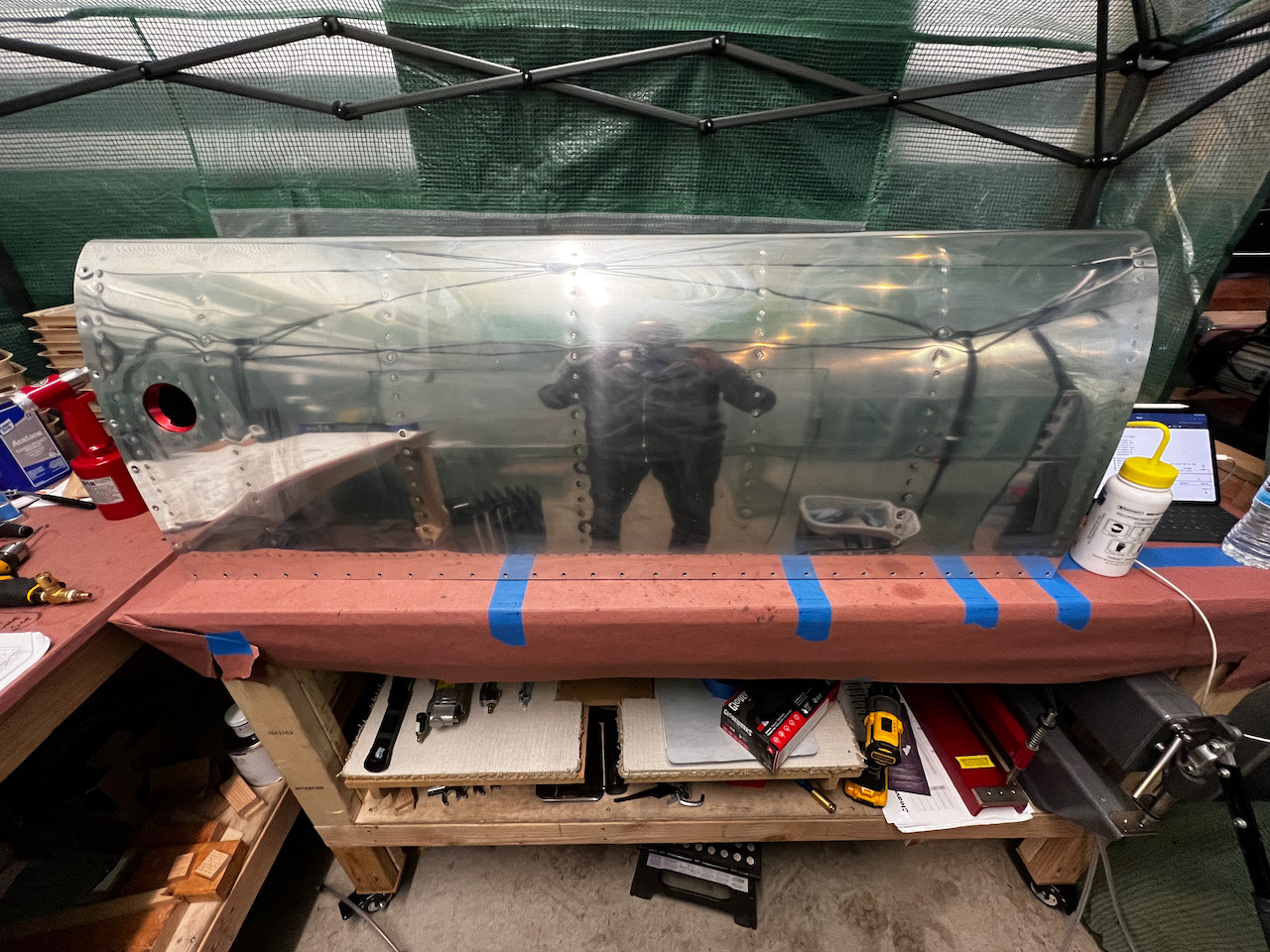

this weekend I sealed up the rear baffle of the left tank. Using the pneumatic sealant applicator was a complete luxury, but I highly recommend it for those not trying to stay on a budget. We'll see how it actually turns out next weekend when I do the pressure test. I'm gonna close up the access port tomorrow. What's the current consensus on using the cork gasket or not?
Full lengthy post is here but below are some pictures otherwise.
This applicator is the best! I bought the knockoff from Aircraft Spruce and it worked great.
Bead is nice and clean using the applicator, but I think it was a little larger. I made it a bit smaller on the bottom side (the more critical side for fuel path)
Nice bead after rivetting it all together:
Brackets on and rivetted:
And the final product!

Default Gasket
Donít use the cork gasket
Just pro seal.
Donít over tighten the screws as it can squeeze out the sealant
Good luck!

Thanks Jim! That's the route I ended up going this evening. I'll post soon about it, but looks like it went well. Pressure test this saturday!
Thanks for the tip!

I'd put a dab of proseal on those pop rivets if I were you. Cover up the "pull hole".

Thanks for the tip Stu! (btw, I watch all your videos..really enjoy the content!)
My understanding is that those rivets are special and have no "through hole" for a leak path. AD-41H and AD-42N. Is that incorrect? or is there something that happens over time that causes these to fail?
Thanks again!

You are correct about the AD41H rivets. Older kits call for LP4-3 which is different.
You should be fine
