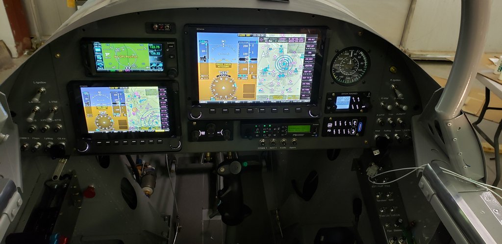

Hi,
Planning my panel and would like to position switches and buttons in a logical order for starting/shutdown.
Those of you with dual P-Mags, what is your sequence?

Both pMags on, prime (if cold) using the boost pump, then hit the start button. I use a toggle switch for each ignition and a starter push button - hate old school key ignition switches.

We have a standard ignition/start switch.
On the switch panel with all the lights, strobes, avionics etc, we have 2 switches for the P-Mags.
All our switches are switch breakers to avoid duplication btw.
Master on
Mixture rich
Fuel pump on - throttle advance to show fuel flow.
Fuel pump off - Leave mixture rich.
Throttle 1/4" open
Keep the start key turned until it starts......
Bingo every time when cold !

No Alt or Avionics switches? If so, when do they get turned on?
Alt is in the Cessna split Master Switch.
Avionics Master after start.
Carl
Exactly as Carl on my RV-8/IO-360/AFP200/Dual Pmags:
Master/Alt on
L and R Pmags on
Start button
Fly
So, you want details!
Sequence:
- Left master on
- Right master on
- Left vital bus on (brings up the left EFIS and power to flaps and COMM #2, it will be on during engine start)
- Right vital off (leaves the right EFIS off but more importantly leaves the expensive GTN-650 off as I do not have confidence that it is immune to voltage sag during start).
- Flaps up
- Left ignition on
- Right ignition on
- Throttle cracked open, mixture at ICO
- Boost bump on
- Mixture to full rich for ~5 seconds to prime, then back to ICO (no prime for hot start)
- Start button, crank engine, mixture to half open after engine start
- After start, right vital on.
- Lean to just before engine stops (minimizes plug fouling and stuck exhaust valve issues.
