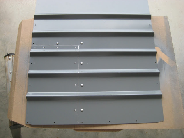

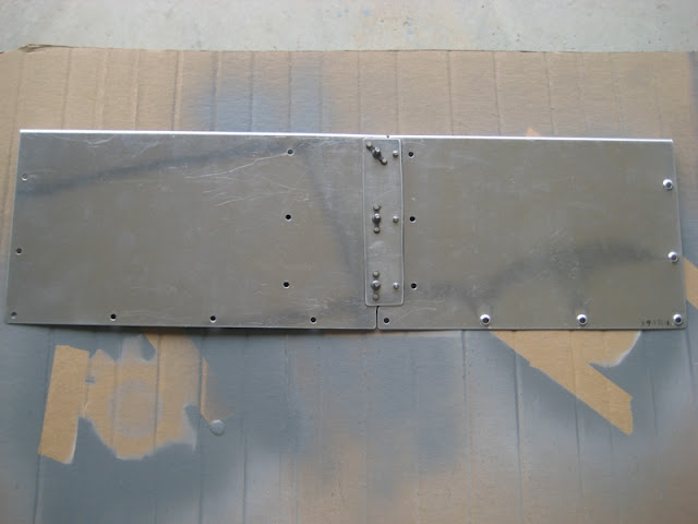

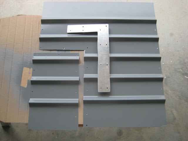

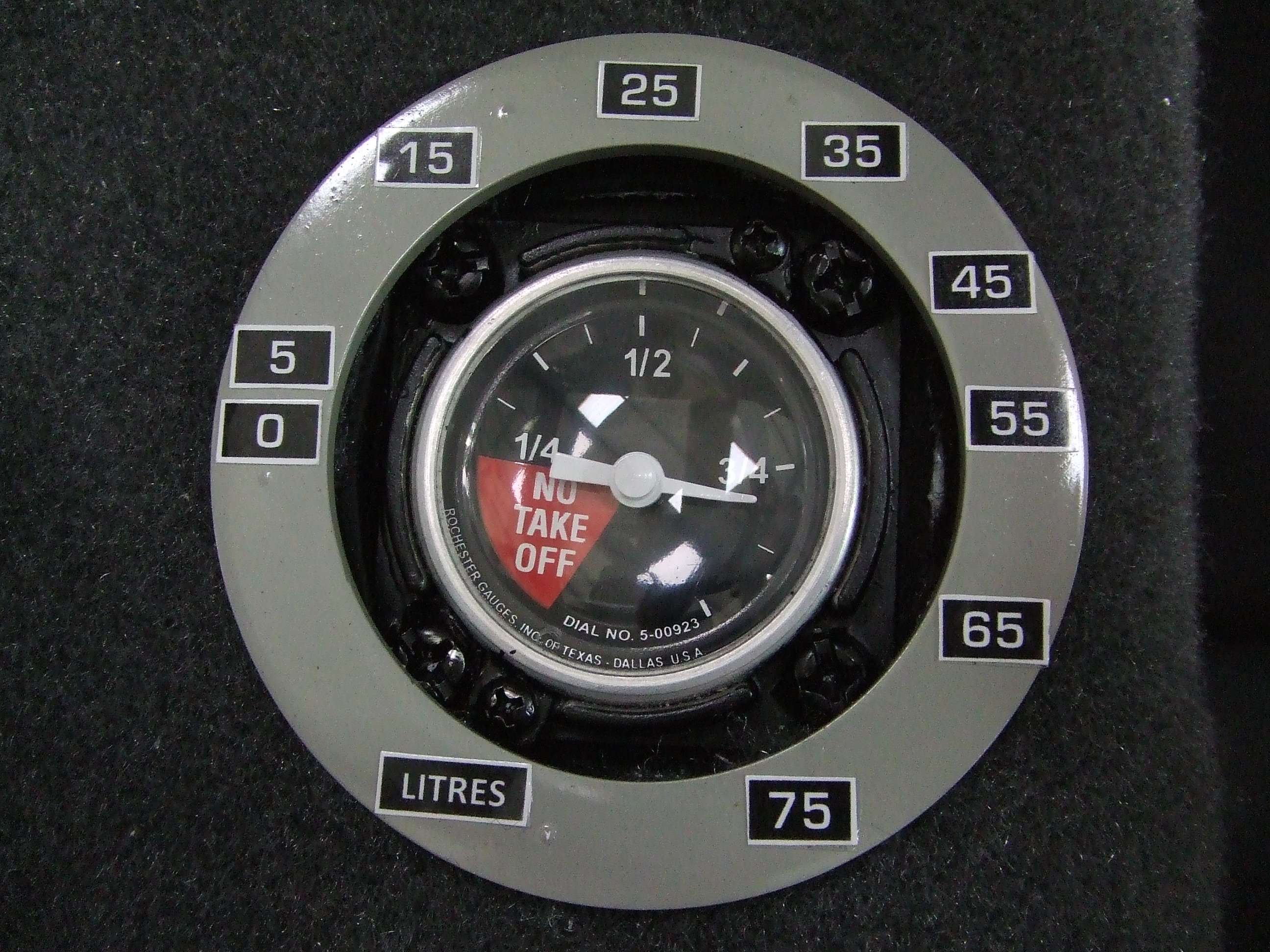

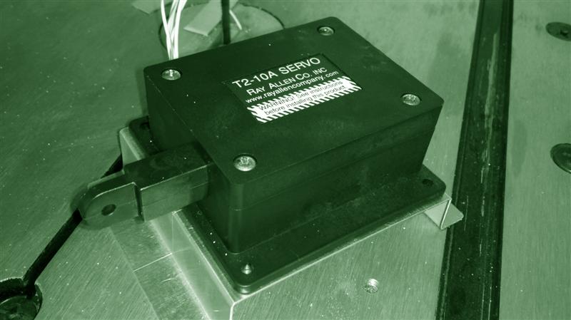

I have added the following to N167SW: Ray Allen G303 stick grip (PTT trigger plus elevator trim on the stick), I'm swapping out my Garmin 495 for a 695 (in progress), Closed the tank sight window, added the Moeler mechanical guage, and modified the ribbed tail cone close out (behind the tank) so that an inspection can be done without having to remove the tank. At annual, in June, I plan to redo the Rotax throttle cables, so that they will be spring loaded to idle, not full power, the way they are now. The latter just strickes me as a ground accident waiting to happen.

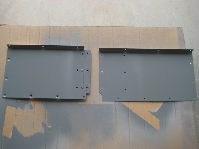

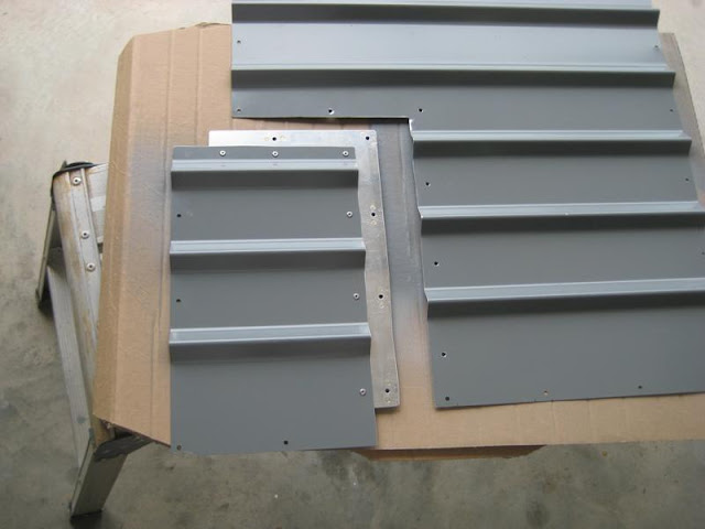

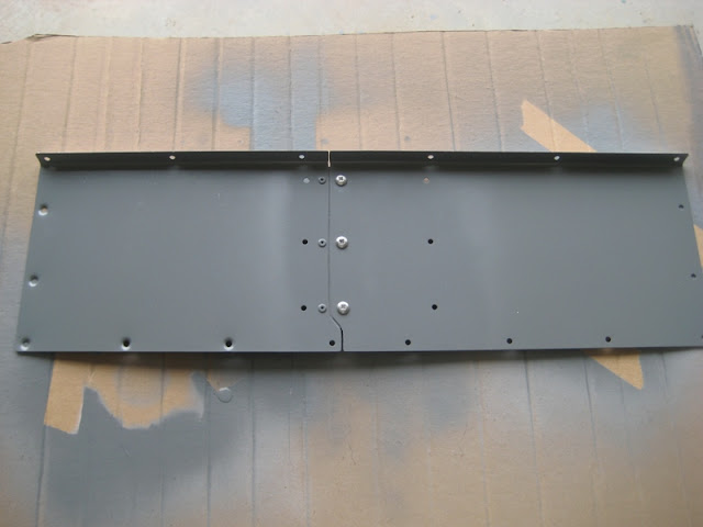

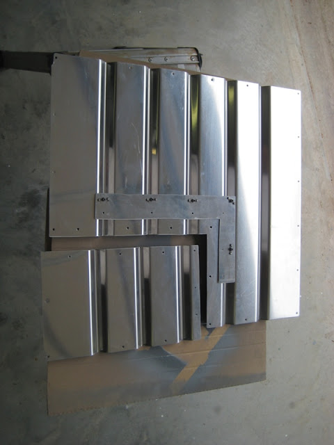

Steve could you post a few Pictures of how you modified the rear access panel
so you can open it without removing the Gas Tank.

John, the airplane is in Nebraska, being painted. When it gets back, in about 2 weeks, I'll try and post some pictures. Steve
