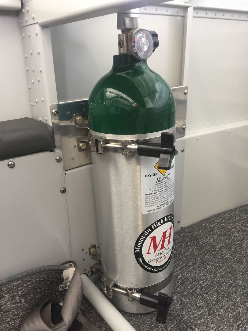

Even though the large Al-647 bottle does fit under the seat back with 1/4 inch clearance with the regulator I decided to mount it on the right forward side of the baggage area for easier access.
I wanted to tuck the bottle as far forward as possible for W&B as well as baggage space. This put the mounting hardware right in line with the flap weldment. Good news was the flap weldment had 5/8 inch clearance from the cover plate and a doubler/nutplates/bolt was just over 3/8 inch. The foam chunk and lines mimic the flap weld net movement.
With nutplates and doublers installed.
I used some thin cardboard to make a pattern for the upper mount/covey hole.
Long ago I dented this donor .032 wing skin with a dead blow hammer while dimpling.
I bent some 1/4 inch flanges for strength.
I made a doubler with flanges and lightening holes.
Bottle mounted securely.

Looks good, Andy. I mounted my O2 in the same place.

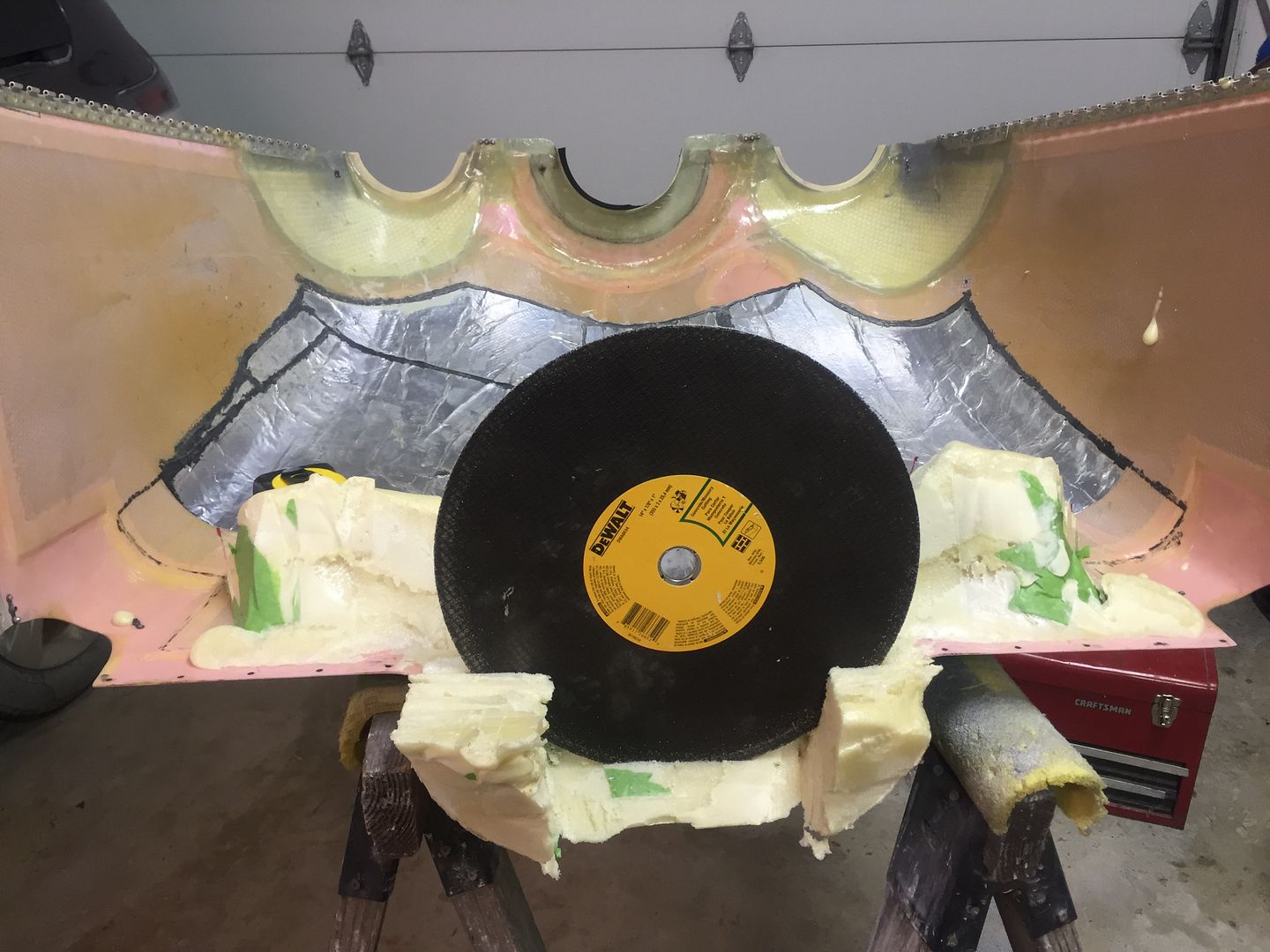

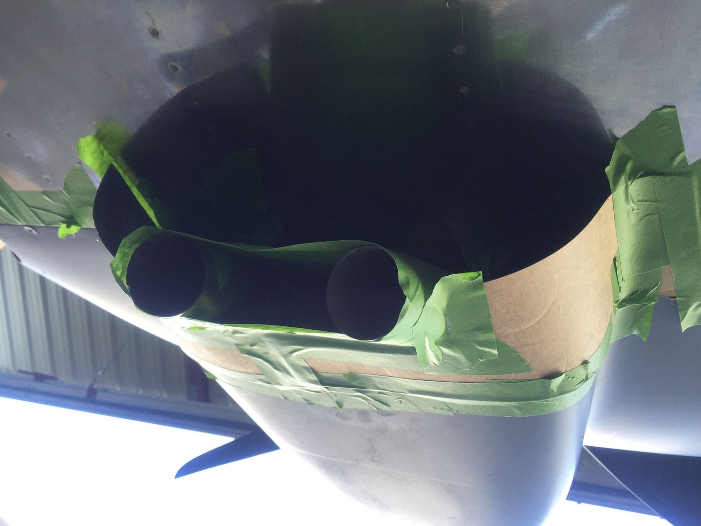

While I wait on an autopsy of my plane power alternator I figured I might as well do some more glass work.
I've been trying to play with different variations of re-shaping the lower cowling exit to get rid of the sharper corners. I installed a lower firewall bump/curve a while back in this thread http://www.vansairforce.com/communit...d.php?t=112941
My current outlet is about 50 sq inches, I'm anticipating more airflow through the new exit and aiming for a 10-15 sq inch reduction on the exit size. I'm visualizing an elliptical exit that has radiused corners glassed into the lower cowling feeding the exit snugged up against the lower firewall bump/radius. Kinda a combo of the kindergarten cardboard sculptures below.
Everything taped/waxed up and ready for some pour foam, my main goal was to get accurate placement of the lower firewall bump.

Not sure the pour foam was a great choice, it took an hour to get the cowl off.
She looks pretty ugly at the moment, I used a large concrete cutoff wheel to cut grooves into the foam as a kind of sanding gauge to rough out the shape. I'm doing a lot more staring and thinking then I am sanding, I hope to have the final shape in a couple more days.
RV 7 590 hours and counting
21’ donation done
  #507
Old 09-26-2016, 10:50 PM
crabandy crabandy is offline
Location: Ottawa, Ks
Posts: 2,421
A little more shaping tonight, using the 14 inch cutoff wheel to cut radius guide marks into the foam worked pretty well for shaping the lower cowl exit. Pretty easy to eyeball a center for the cut and then measure from the cut off wheel to the cowling to keep things concentric. Kinda odd that I actually had a 14 inch concrete cutoff wheel laying around the shop from a totally different project.
You can see parts of the guide marks cut into the foam, basically just sand the grooves to the same depth or gently sand the grooves flush and it shapes itself.
A paper towel roll is close to the same dimensions of the lower firewall bump/radius, trying to visualize how I want these curves to intersect.

  #510
Old 10-09-2016, 01:38 PM
DanH's Avatar
DanH DanH is offline
Location: 08A
Posts: 10,818
Andy, remove all the pour-in-place foam. Been, there, done that. Over time pressure changes cause it to swell in some spots and crush in other others. I had some inside wingtips and had to take it out. Had a bit more in my cowl mod and had to vent that area of the core.
